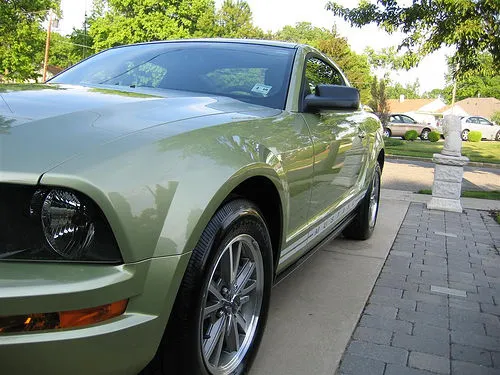

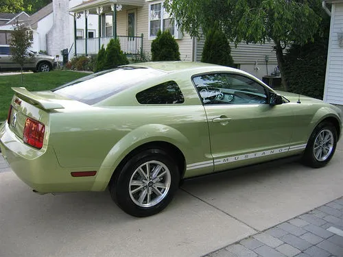

I recently tried the Zaino suite of products and would highly recommend them. Just finished today by applying the Zaino tire dressing to the tires and exterior black trim... really makes the trim pop! I attached a couple pics in case you want to see the Zaino results (it's only a couple coats so it's not a very deep shine). Autopia.org is a very helpful auto detail forum loaded with tons of info on everything related to detailing. That site gave me the courage to do my first claying ever on my Mustang.
