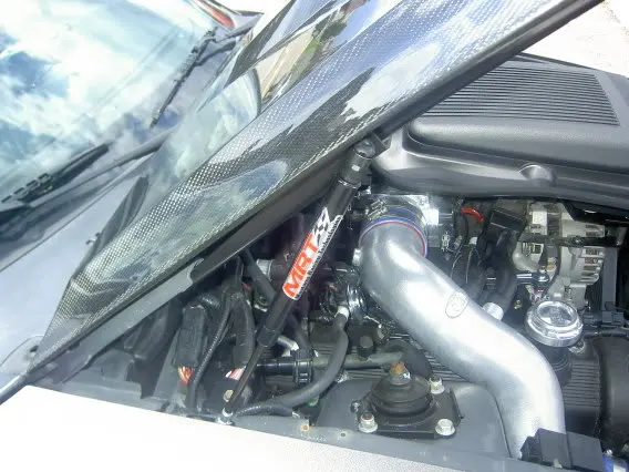

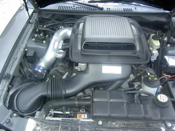

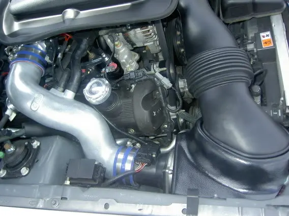

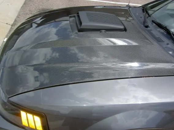

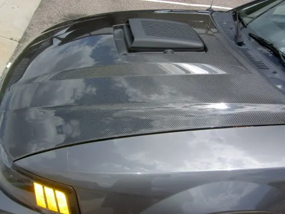

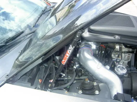

I didn't want to hijack MM, BUT thought I'd show you the pics of mine since I'm back now. I couldn't get the shaker centered due to issues with my engine placement after my QA1 (This will be remedied with either a custom bracket or replacing with a UPR K)
Other than not being able to center the shaker, I'm really happy with the hood and the CAI. Thanks for your input in the prior thread.
I did mine many years ago, but your posting is the first time that I read that anyone else had the problem with not being able to center the shaker. I could not center mine, even with all the adjustments to their extreme.
The problem is that the KK design tries to use the same, long, bolt to go thru two different sets of holes in their front brackets. These holes really need to be off-centered from each other by about 1/2" to 3/4" for the shaker scoop to center with the hood. I ended up making a new front bracket myself. It is sort-of "C" shaped, with one leg of the "C" about 3/4" longer than the other. That provides the required 1/2" to 3/4" offset. I made the bracket out of 1" flat stock I got from Home Depot.

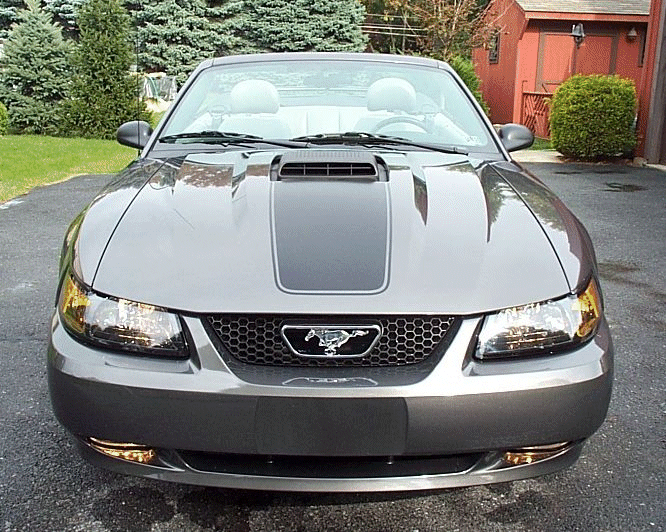

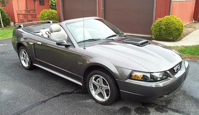

I might as well throw my pics into the mix too. :D

can you post pics of the bracket please? I can't decide if I want to go through the hassle of installing the new k-member or just making a bracket.
The only reason I can't center it is because the QA1 wasn't drilled right for the engine mounts and the engine tilts to the pass side about 2-3 inches. I don't blame QA1 at all, its mostly my fualt for not pumb bobbing and drilling to fit.
