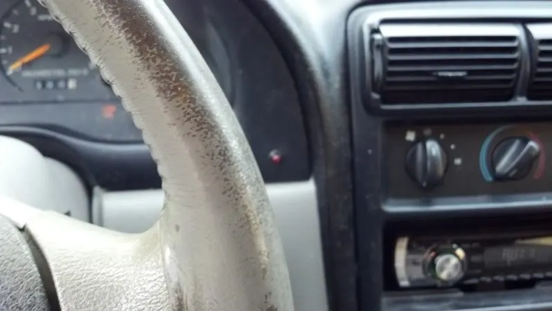

$4.25 flashing led from Orielly lets me know when its armed.

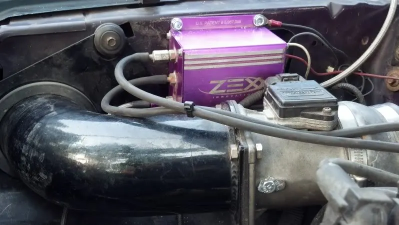

This controler bumps the fuel pressure when you spray via the FPR also has a WOT switch built in wired to the TPS

Not gonna lie, that looks sketchy... haha. But if it works, it works. Just don't get too greedy with it.
Lol wasnt going to get realy fancy with the install considering what the car looks like but i assure you everything is wired up well added an inline fuse for safety Not alot of room under the hood to mount the box. I might make a bracket for it at work next week.
I was looking at those lines... What are the top two? I see the braided line on the bottom.
Either way, it's gotta be fun. I couldn't wipe the smile off my face the first time I sprayed.
vac lines for the fuel pressure regulator. I re routed them when i got done so theyd be long enough. The zex box goes between the FPR and the intake so it can bump your fuel pressure up when you spray. Bottom braided line goes to the nozzle which is on the other side of the maf
Pretty simple install you have a vacuum hookup a FPR hookup, NOS in, NOS out, ground, 12v arm wire, tps wire (middle wire in tps harness is what mine was) you get it all hooked up and turn the system on. There is a learn button you push and hold on the end of the box, The light flashes green to red you open your throttle all the way and let off light turns solid, turn system off and back on now its learned your WOT position. You can test it with the engine and bottle off floor it and listen for the relay to click.
