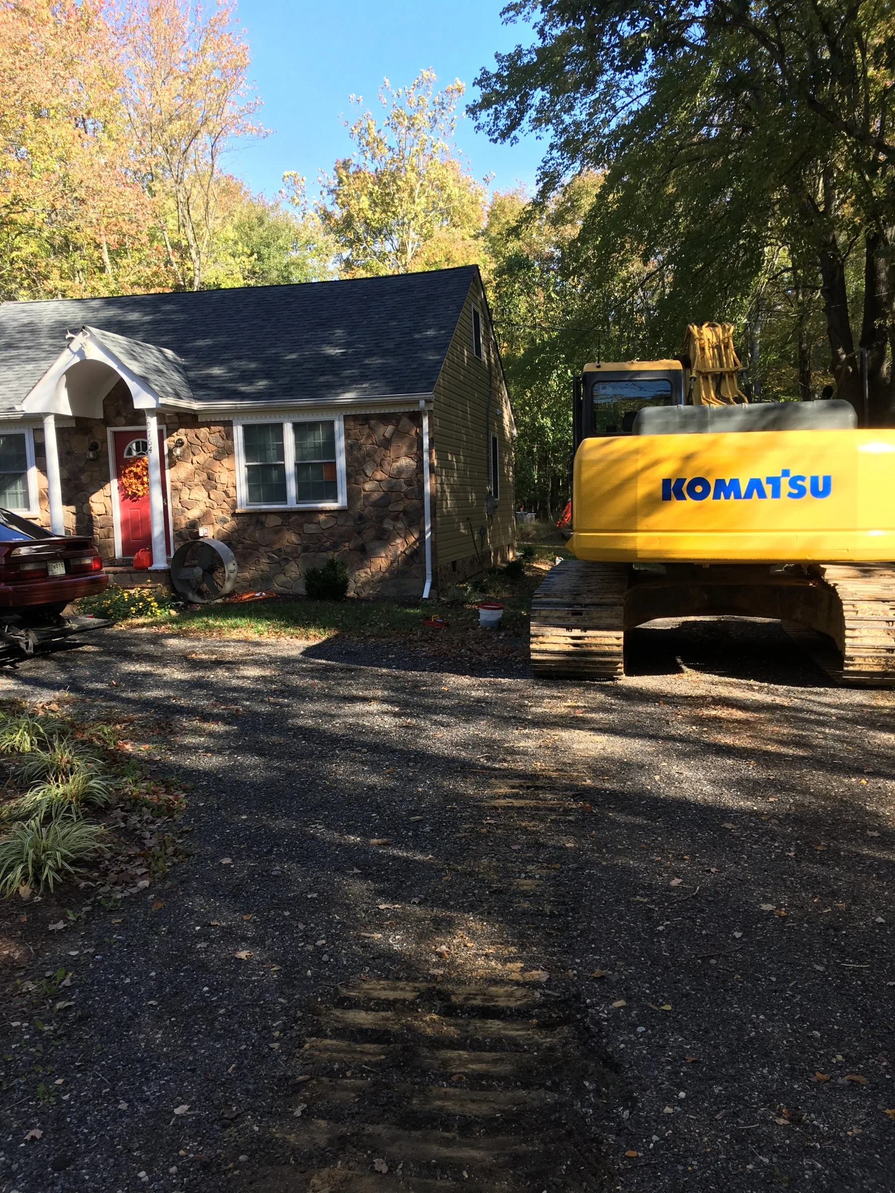

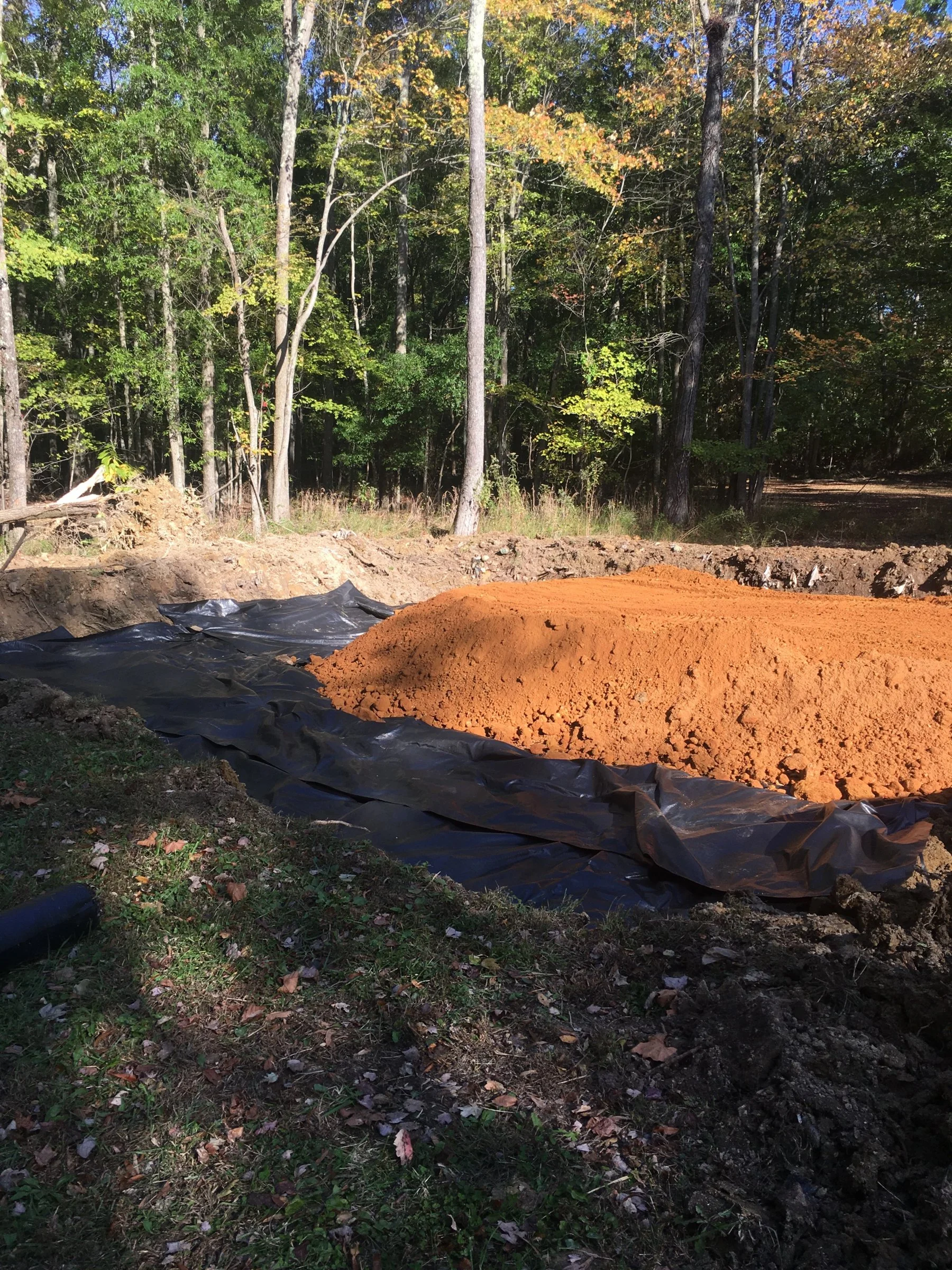

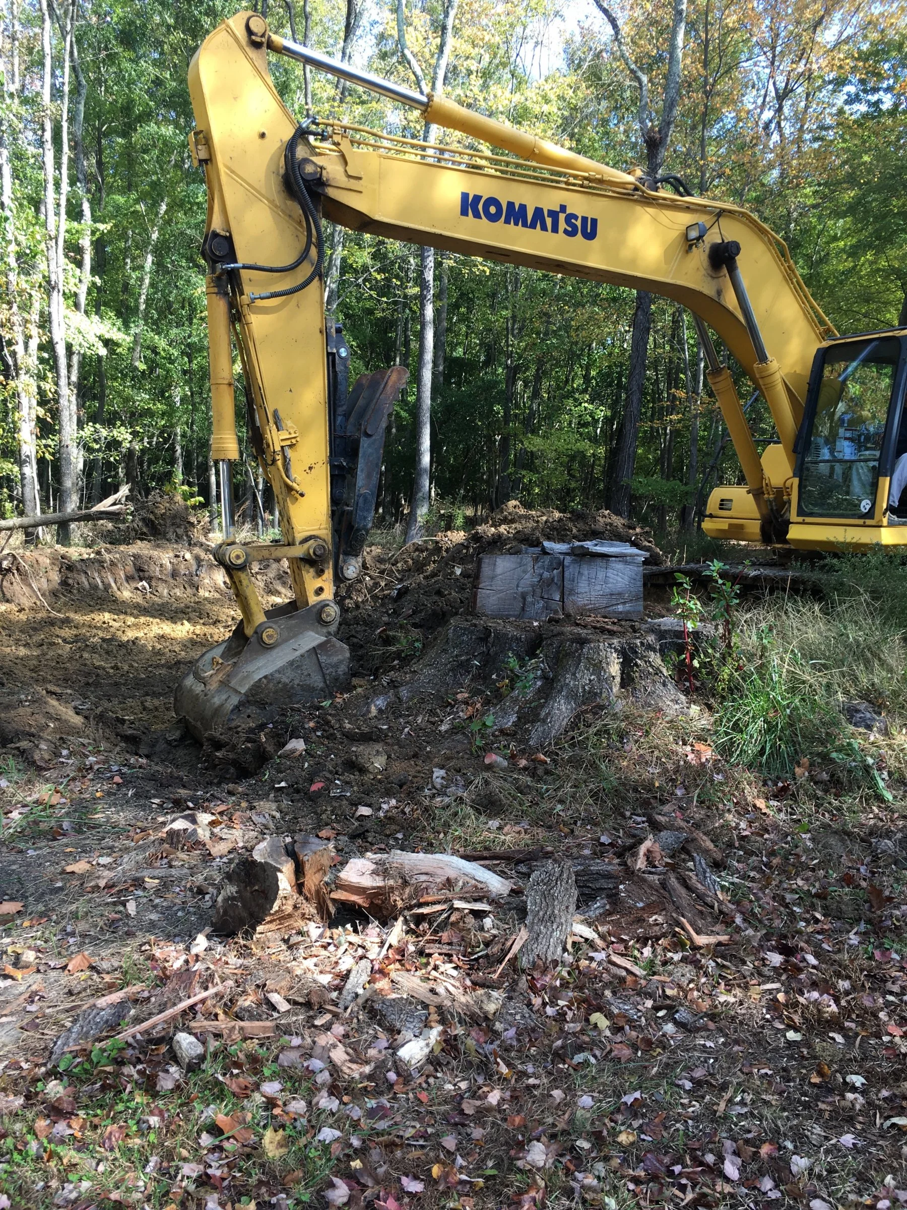

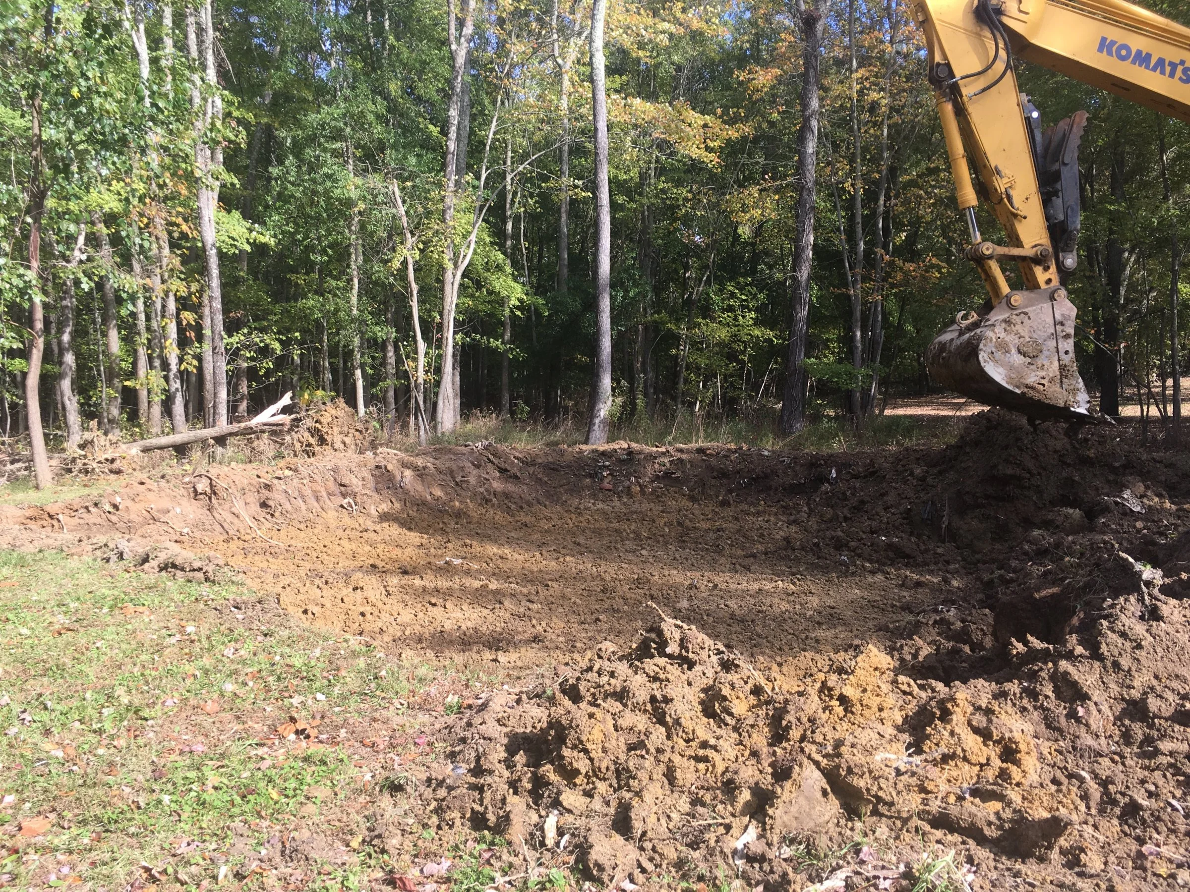

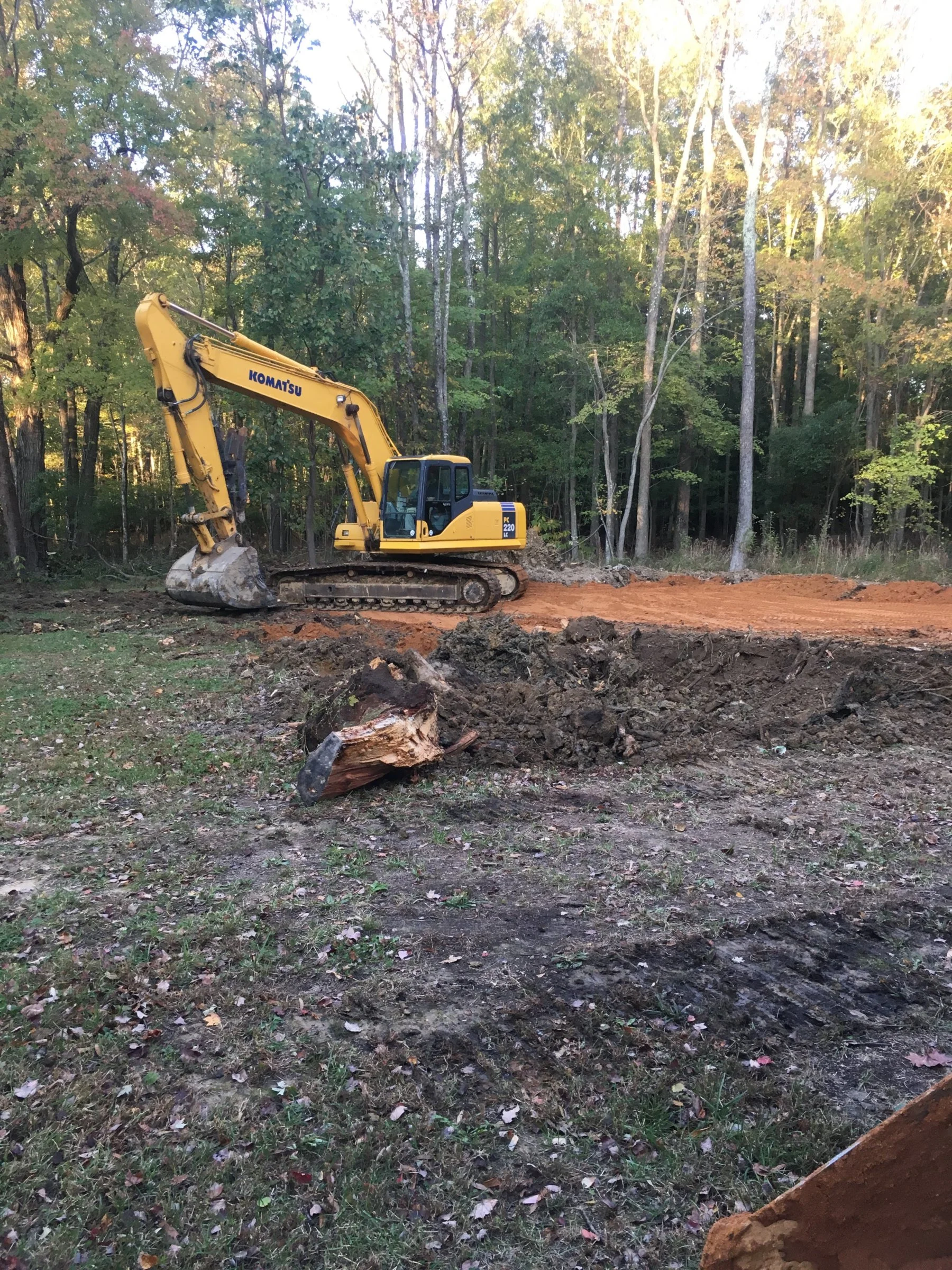

In other unrelated but equally great news I have finally broken ground for my new garage/shop. The garage will be a pole barn style 24-24-12. The benefit of having your best friend owning a excavating company

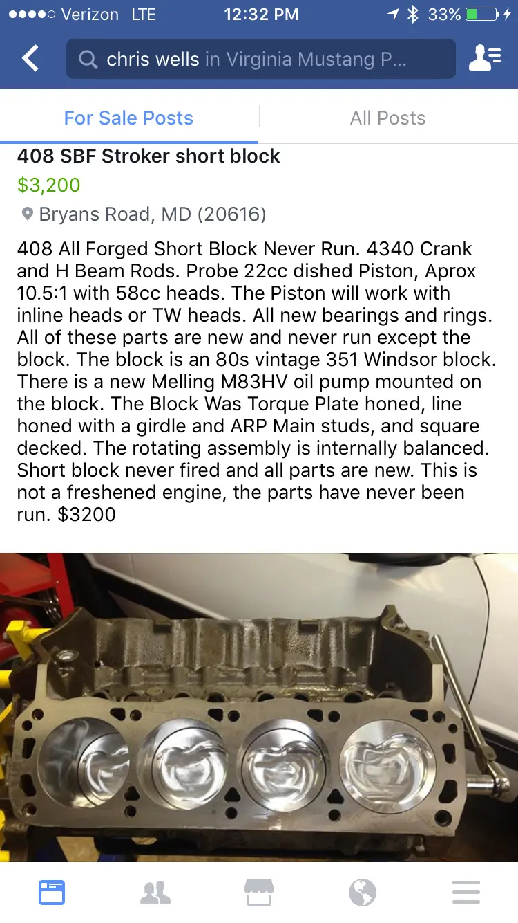

Ehhhhhhh 3800 is pretty close to dart money buddy . There is nothing special about 80s Windsor blocks .It's either do a dart 347 or a buddy of mine is selling a 80's vintage 351 block bored and stroked to a 408 with forged internals torque plate honed the whole 9 yards for 3800 I could probably get it for 3000 but then I would need new heads intake and hotside
I'm not gonna go that route simply because I already have this rotating assembly worst case I'll need a new rod and piston it doesn't sound deep enough for it to be a rod bearing or main bearing. Scat rods and crank and Ross -22 cc Pistons
