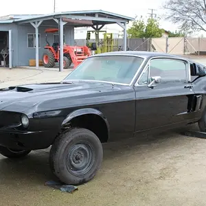

Imported Item
driver side,car was in very good shape just missing front approns and radiator support

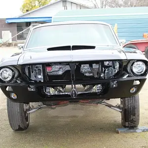

Imported Item
love the made in buckets, install the stock cans,adjusters and headlights and i was done i fit the trunk lit and hood with the adjusters it place so i could see the finnished alighnment
Imported Item
Imported Item
front view looks great
