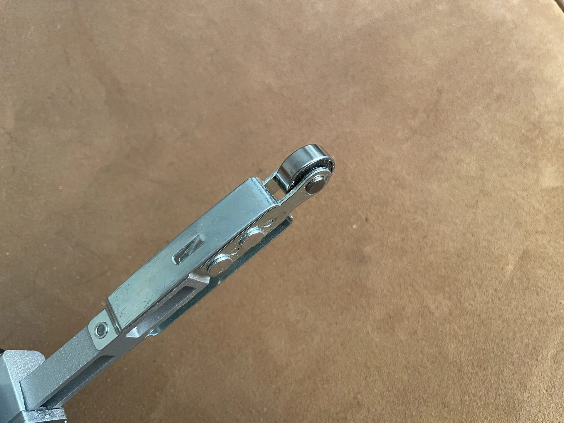

So I ordered a new 1/2” belt sander. I had one from harbor freight before, it got worn out. I decided to upgrade to one from Walmart.
I got a couple boxes of 36grit belts for it too. The belts were more expensive than the sander, lol.
Basically I’m getting everything I need for when I get the next nice weather day. When that happens, I’ll post pictures.

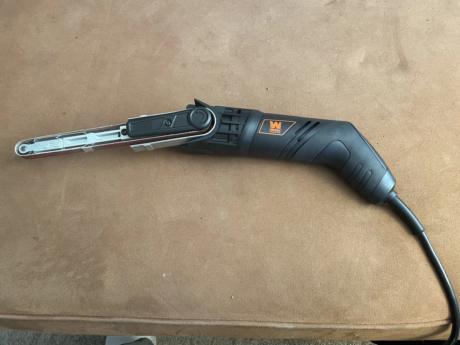

Got my new 1/2” belt sander in today.
The tip is steel, unlike the rubber tip on the hf one I’ve used in the past. Hopefully this means it’ll last longer.
I should have my sanding belts tomorrow.

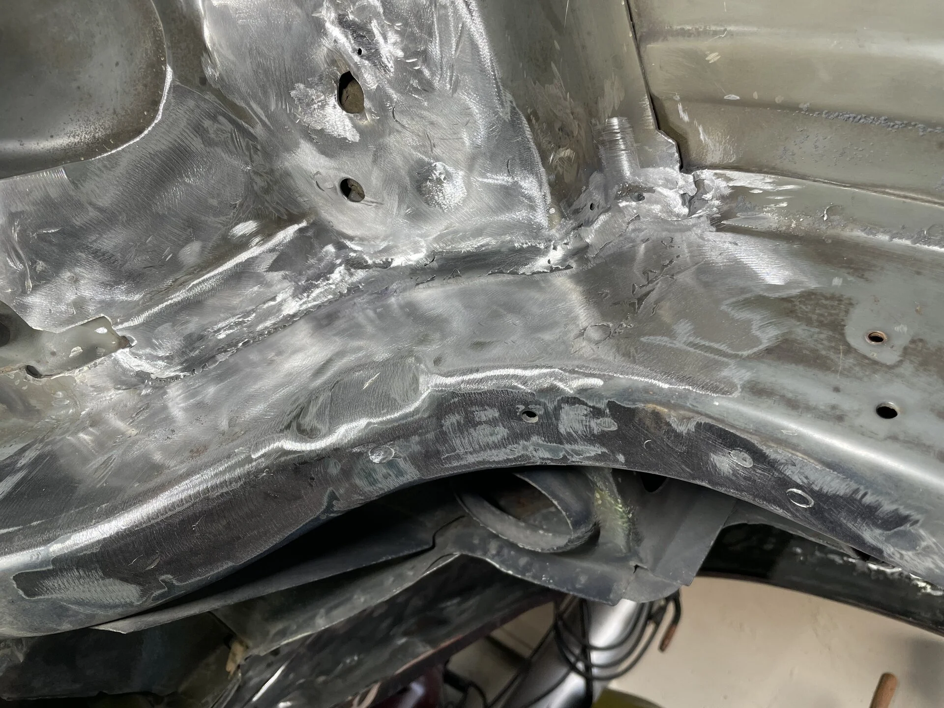

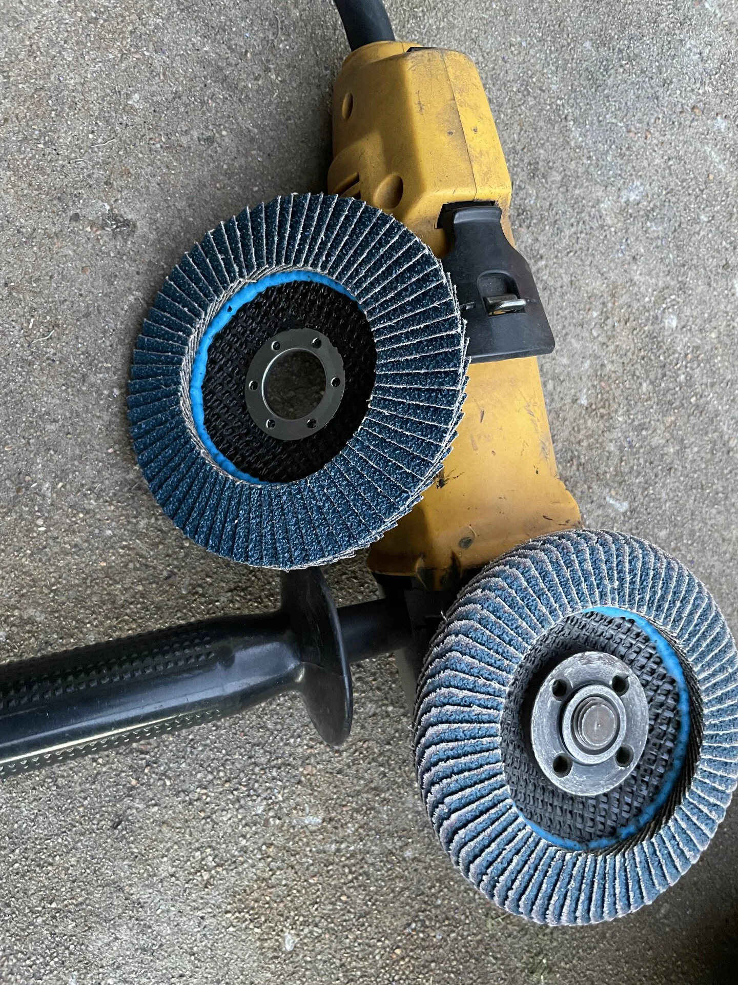

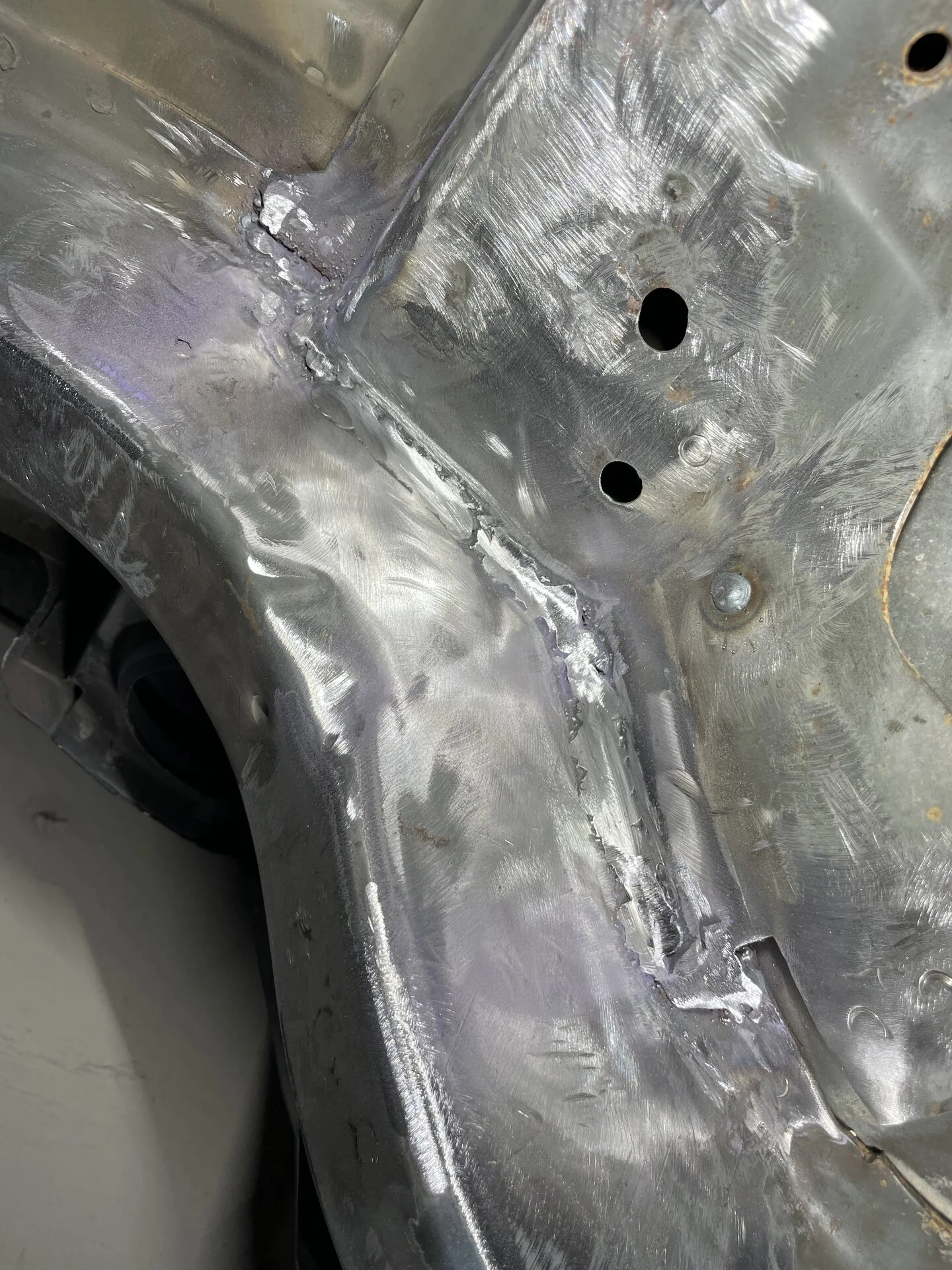

So I actually got out! What a freaking beautiful day.
I mostly got the right subframe dressed. I want to follow up with my die grinder and two inch grinding discs to prep it for a small wipe of bondo. There a couple small areas there I want to address first.
I used my new 1/2” belt sander with 36 grit belts, it did really well. I like this sander much more than the hf version. I also cleaned up a bit with my dewalt 5” grinder and flap wheel.
I was going to stop there, but I couldn’t help wanting to dress a bit of the left frame rail. I just did a quick bit on it. It’ll probably take another half hour to full hour to finish that side.
We’re supposed to have really nice weather the next two days, so I’ll get a bit done. Maybe even a wipe of mud to smooth it all out.

Is the mini belt sander what you use to grind down the welds in crevices and hard to reach areas? I may need to get one of those.
Reactions: Davedacarpainter
Yeah John, it’s also great for cutting out spot welds.

90sickfox said:
I'm glad you are back at it, Dave. I was just about to buy a HF belt sander but am researching options. I'm no where near getting back to Dusty yet. I want to buy a lift first so it'll be a few more weeks.
Buy this Wen model over the hf one Scott.
It’s smaller and lighter. It doesn’t have as powerful of a motor as the hf one, but in use I didn’t notice at all.
When it gets down to it, neither is close to a good air sander. These don’t require a large compressor to drive them though.
Plus both of these are under 40 bucks . Important info when you’ve just blown ridiculous amounts of money on some whiskey….
