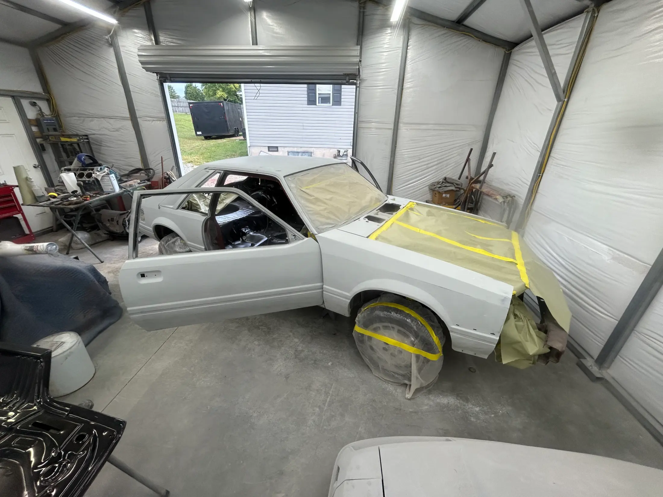

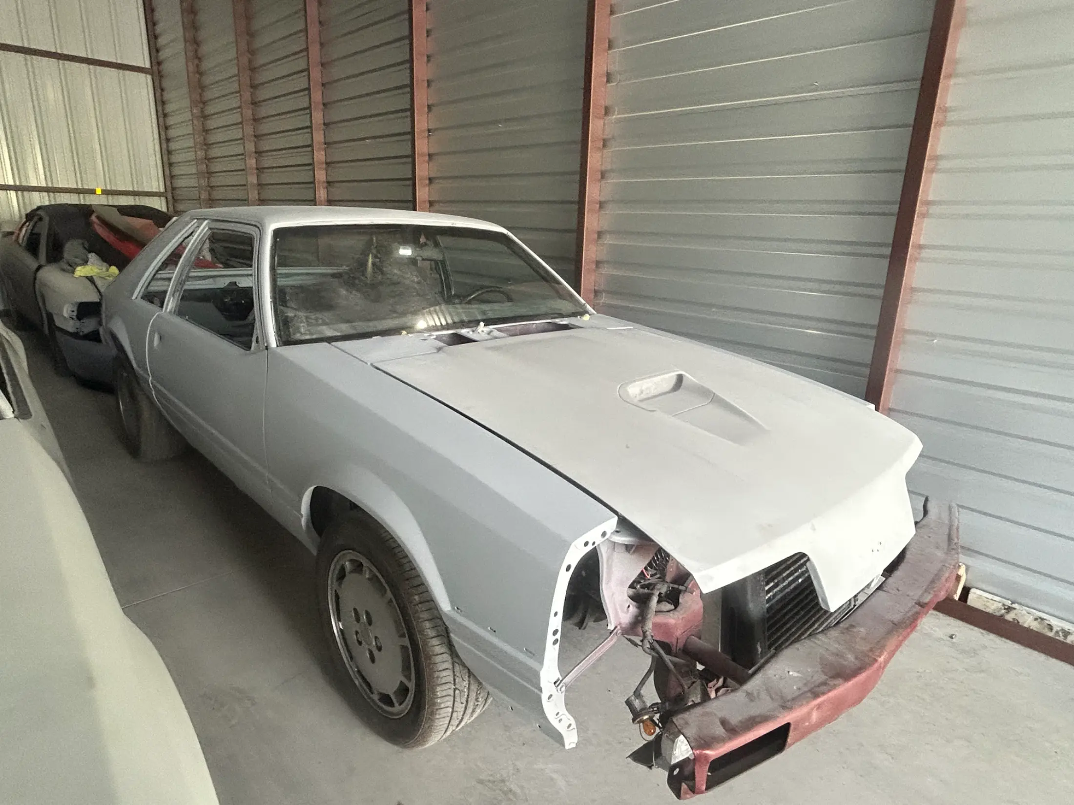

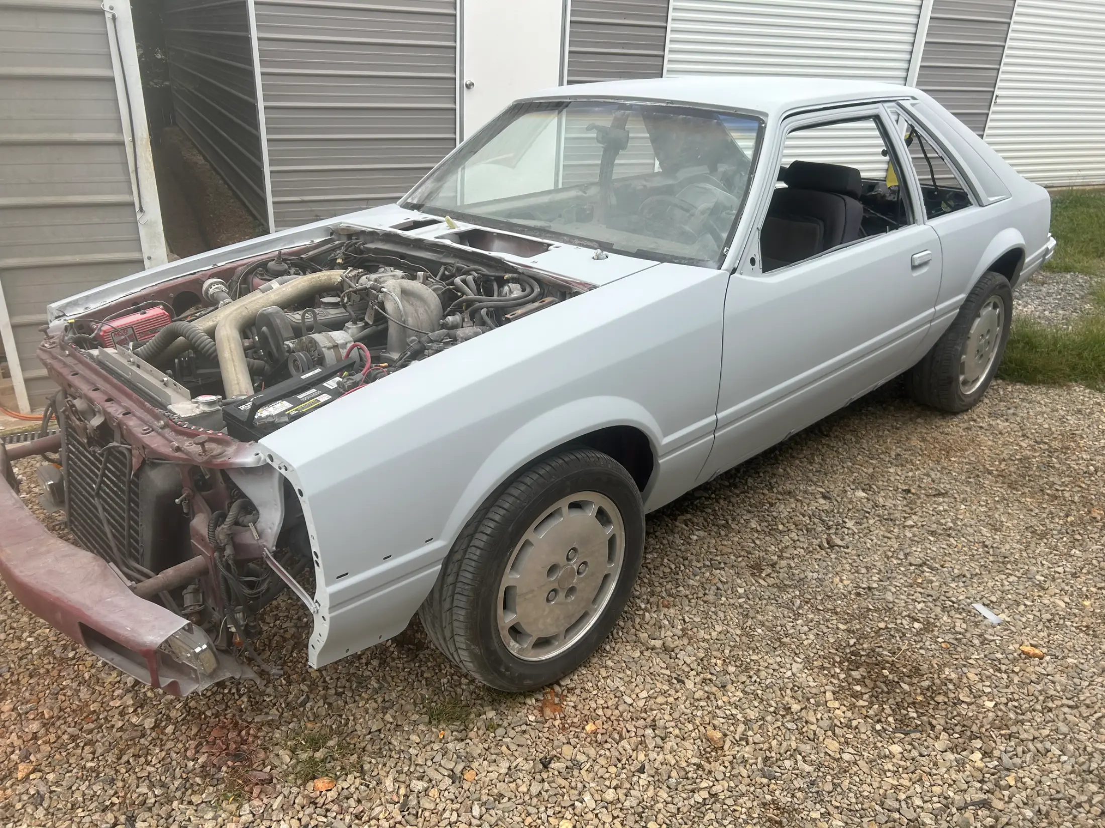

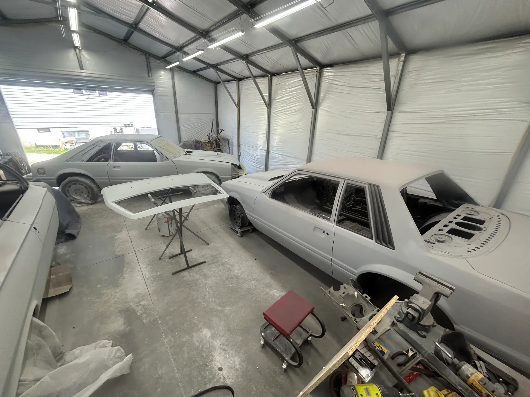

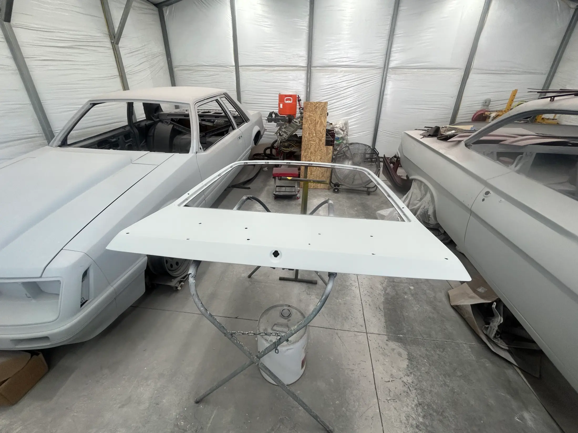

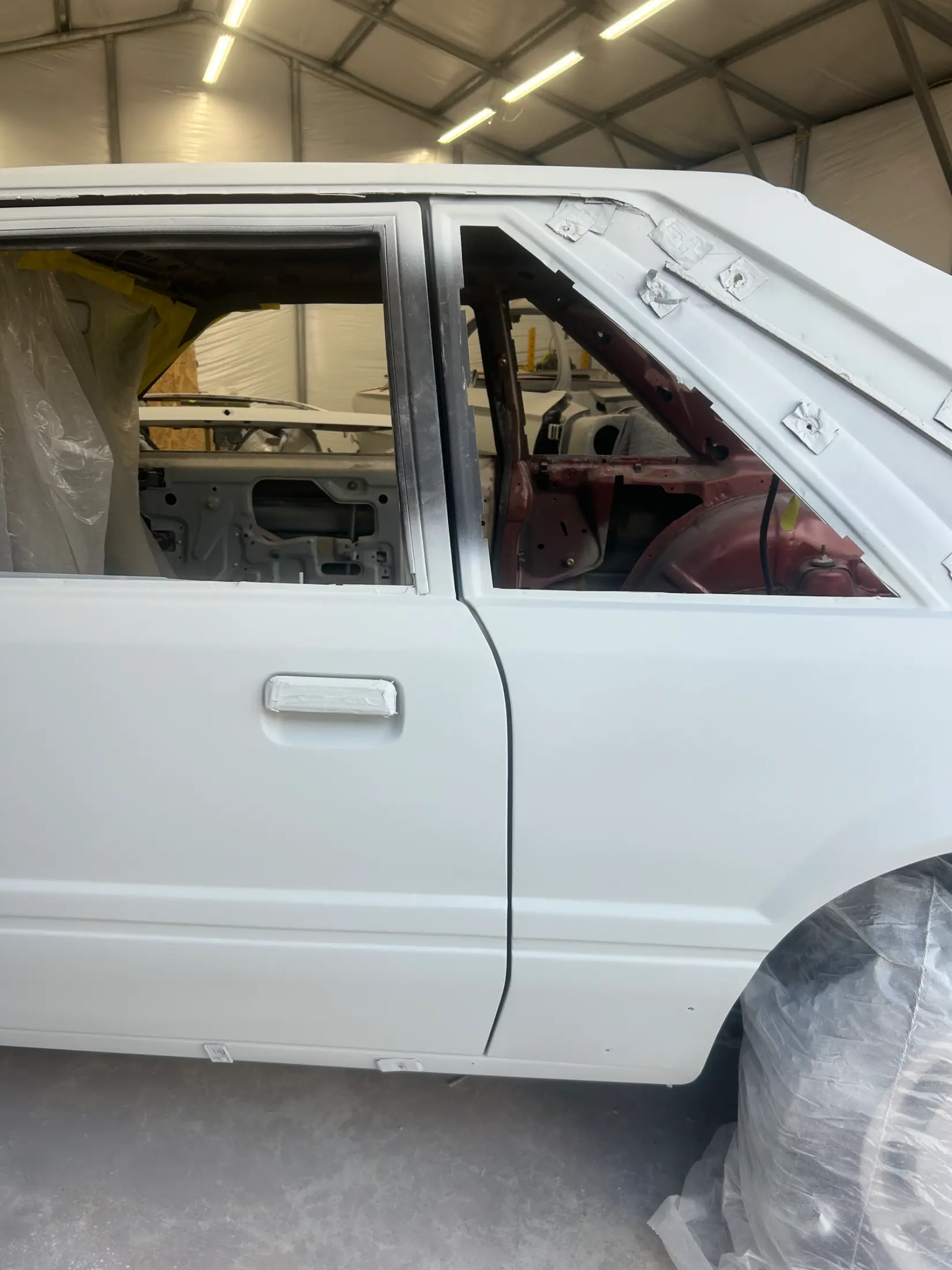

getting close to having the main body ready for the first round of primer

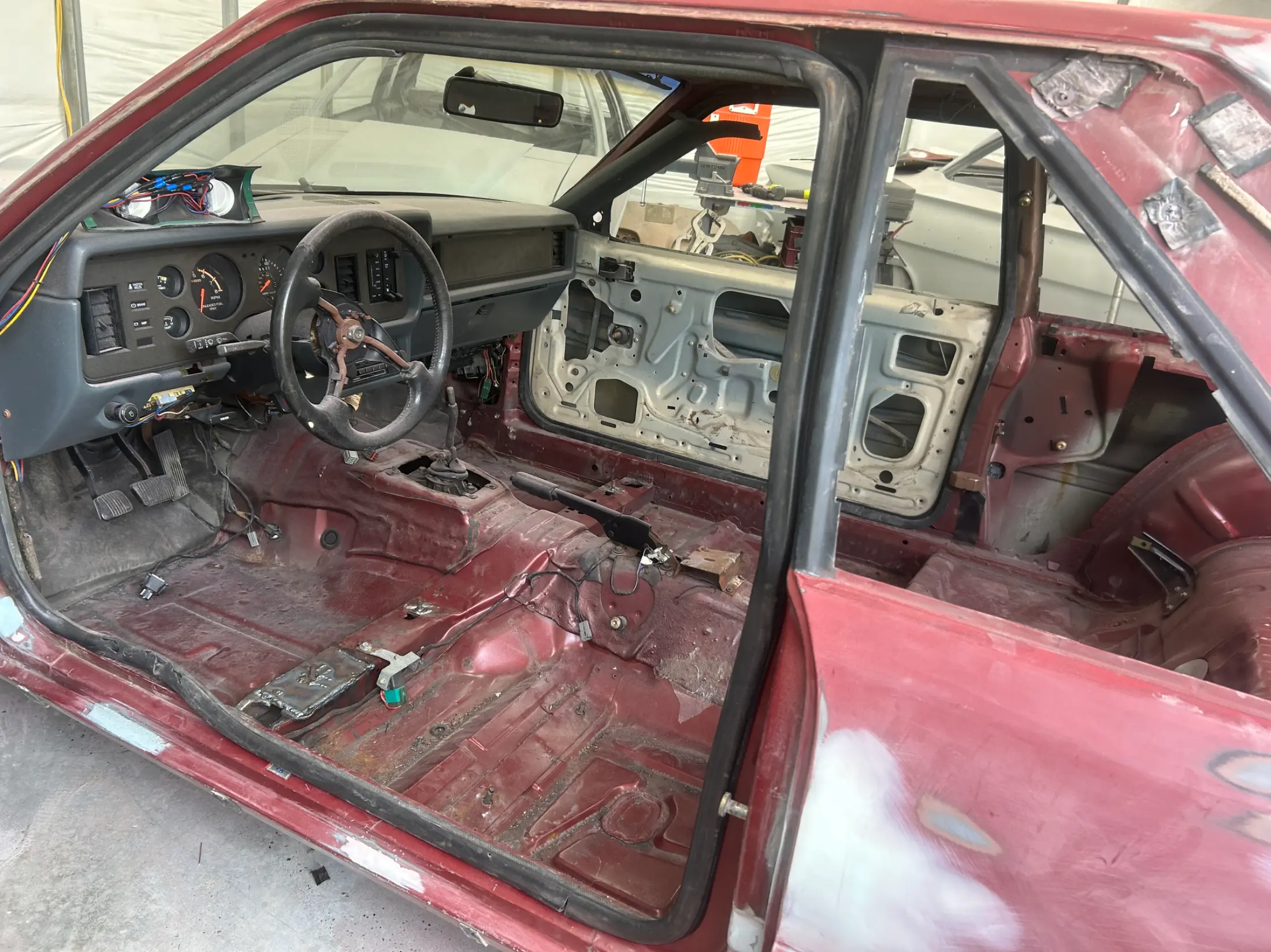

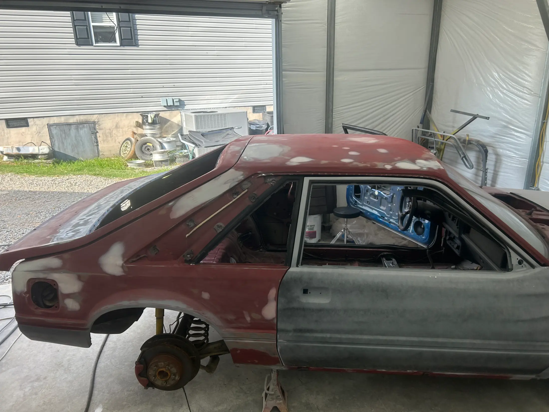

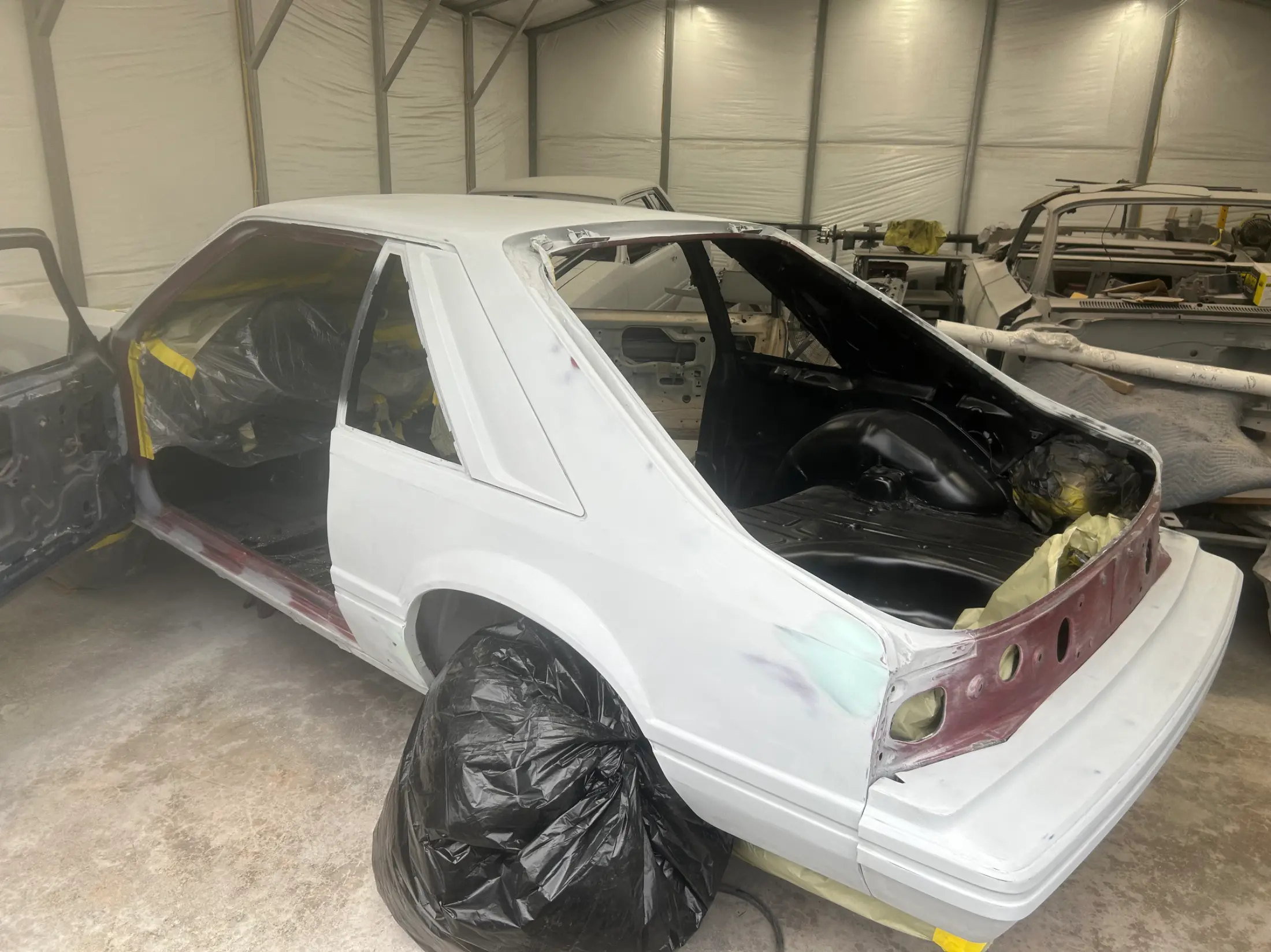

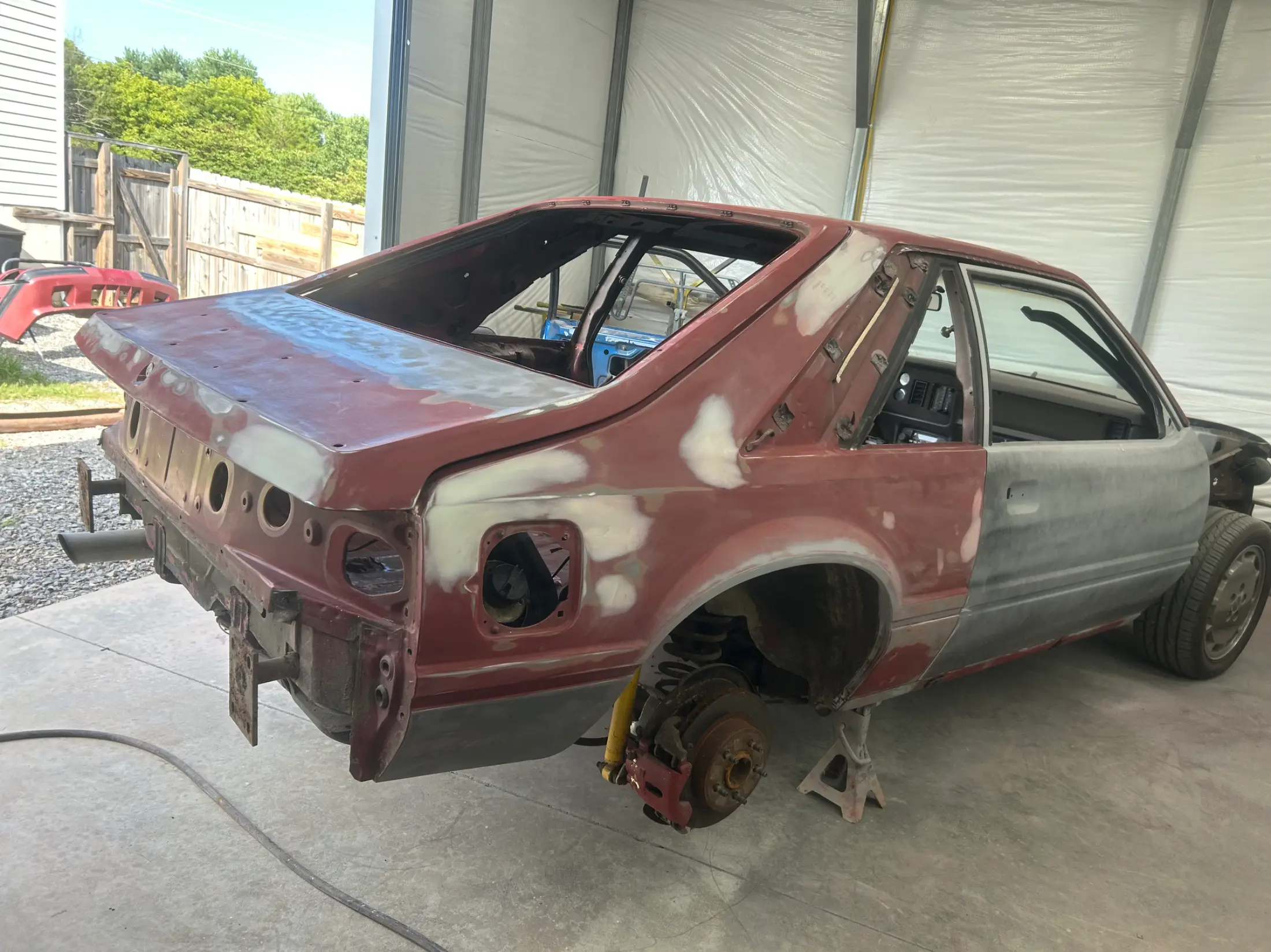

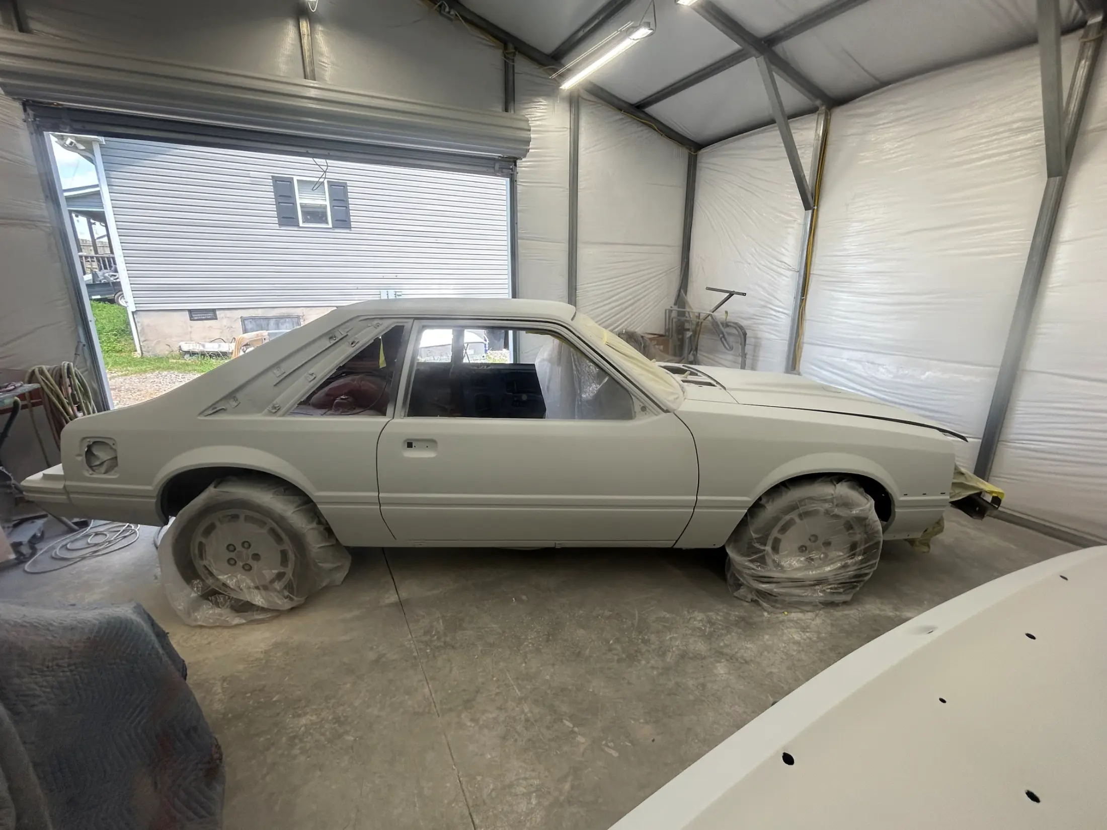

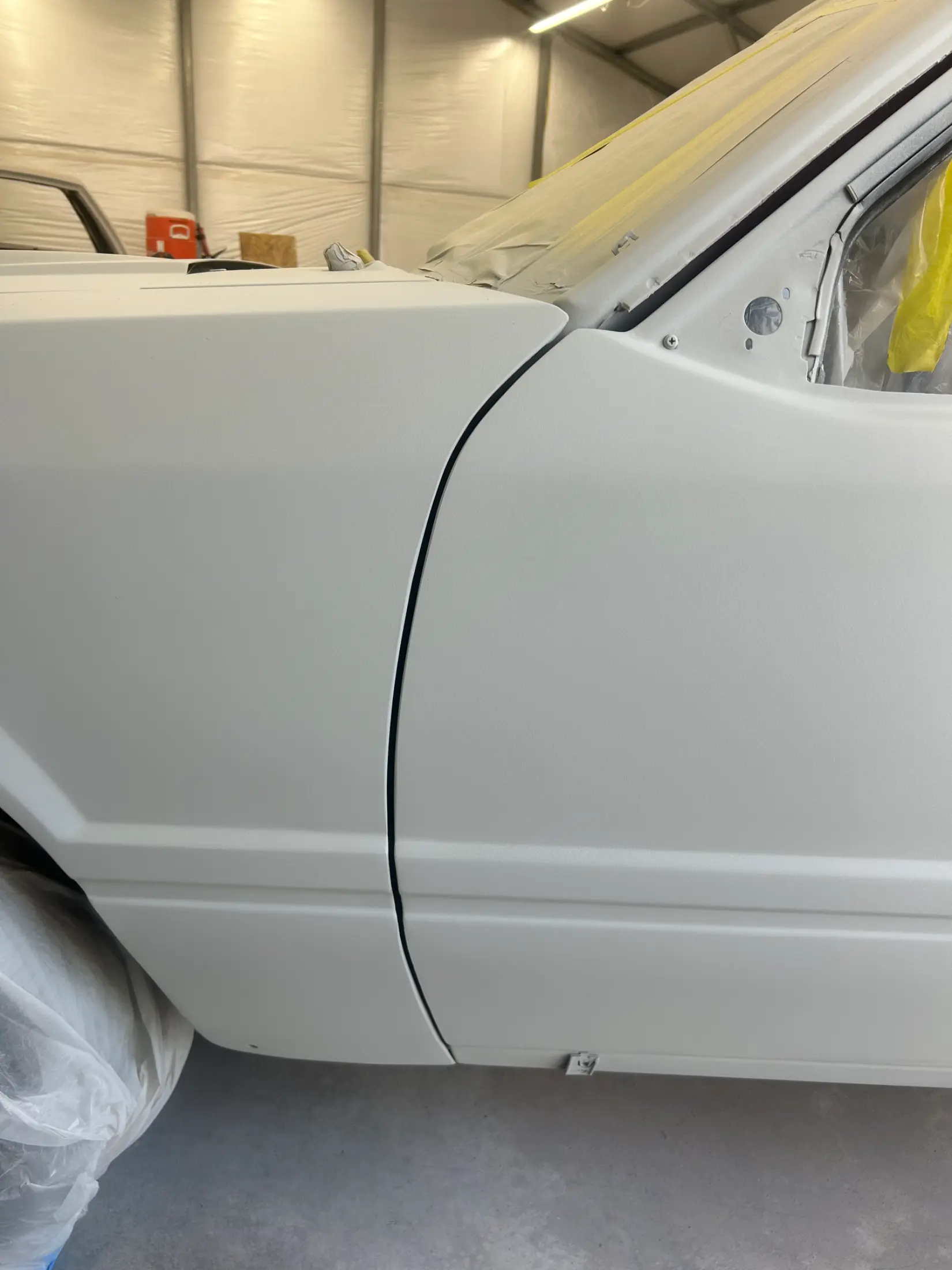

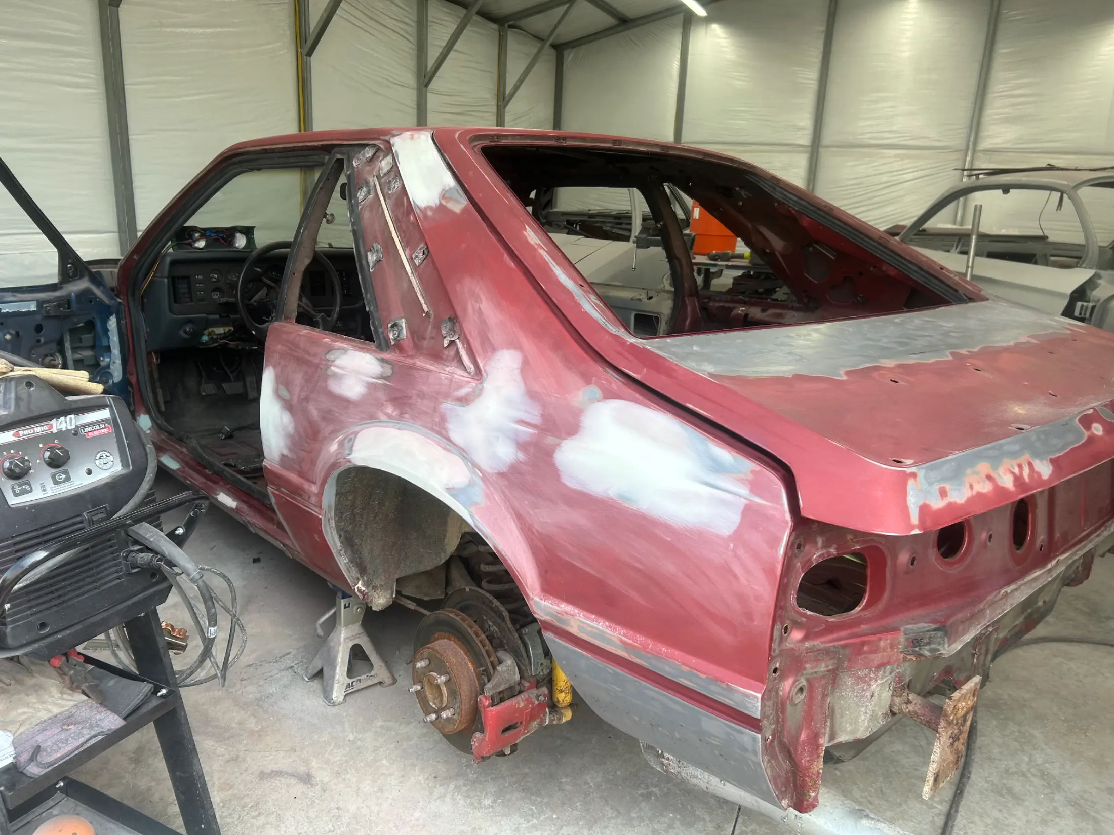

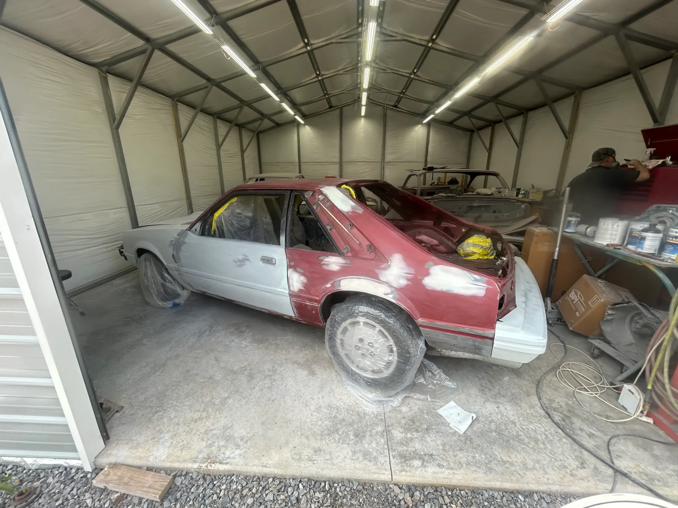

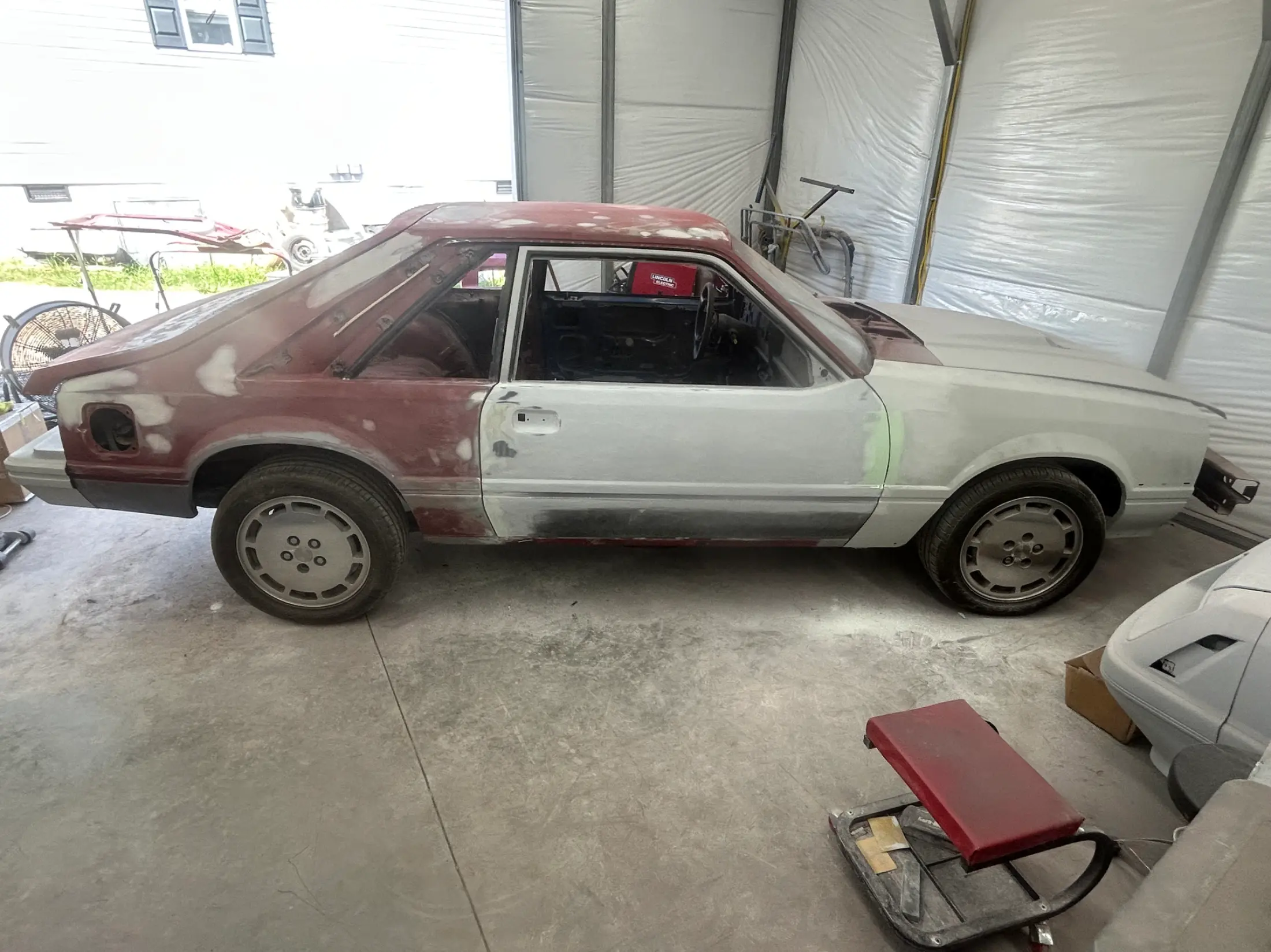

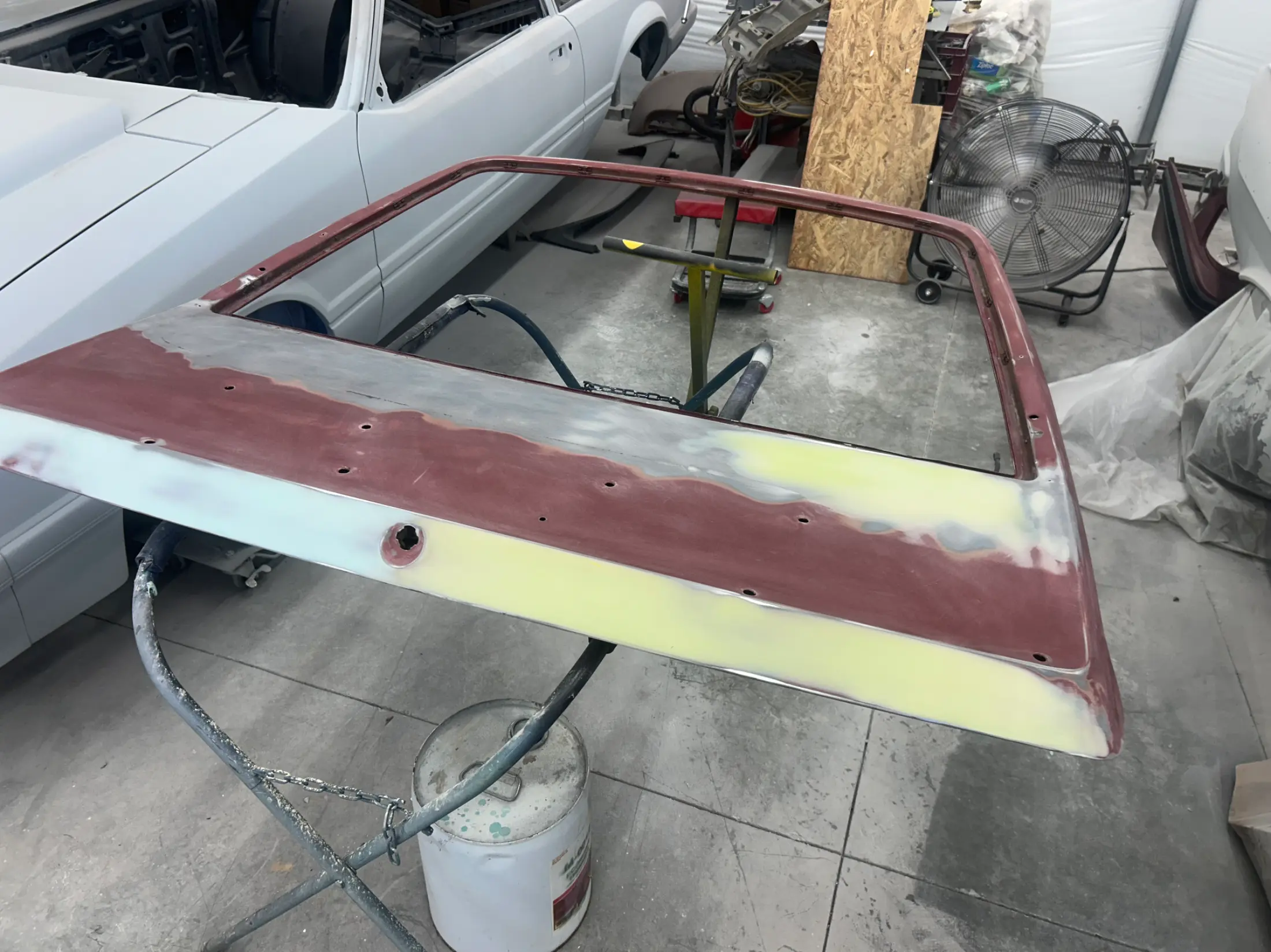

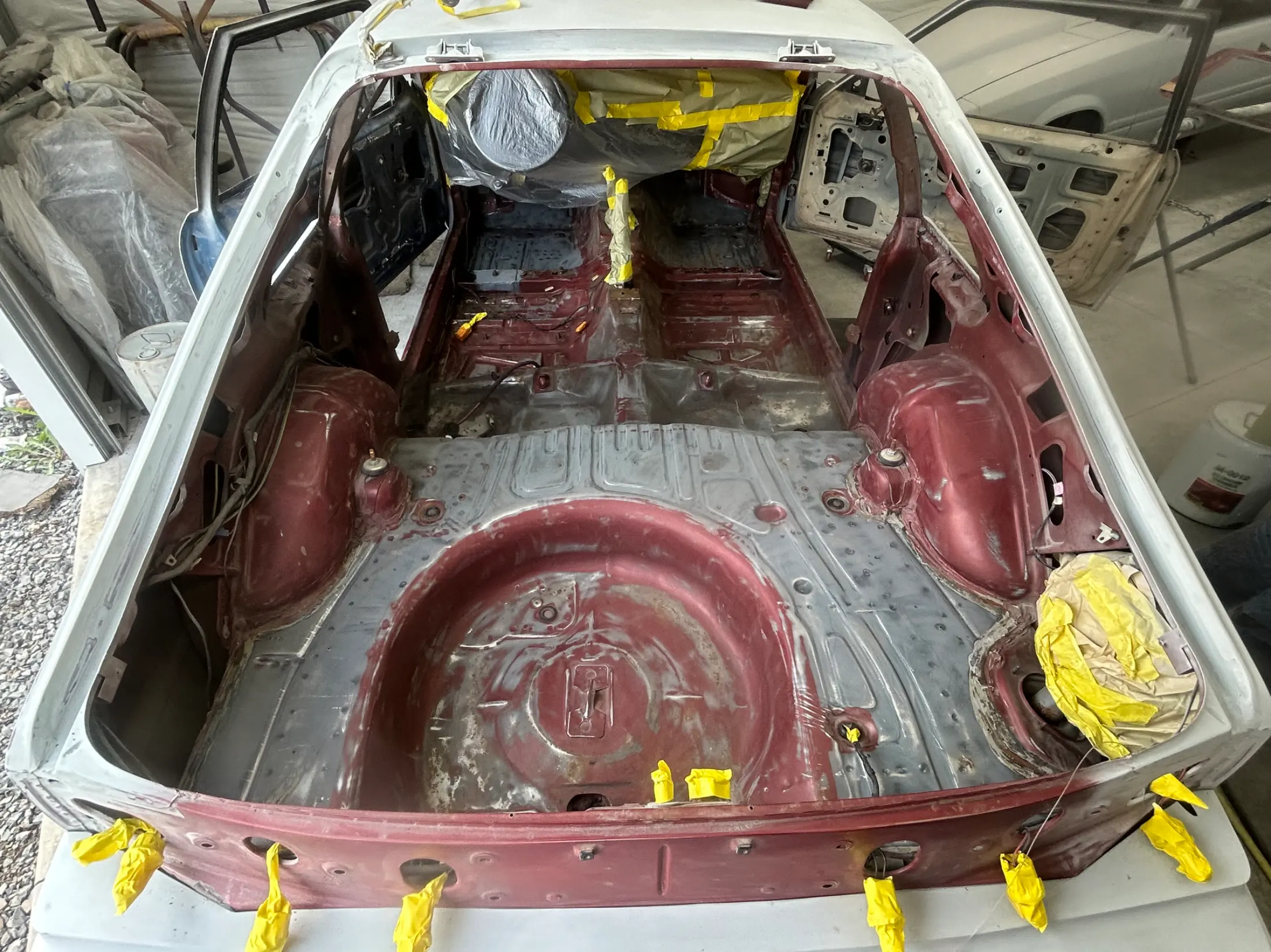

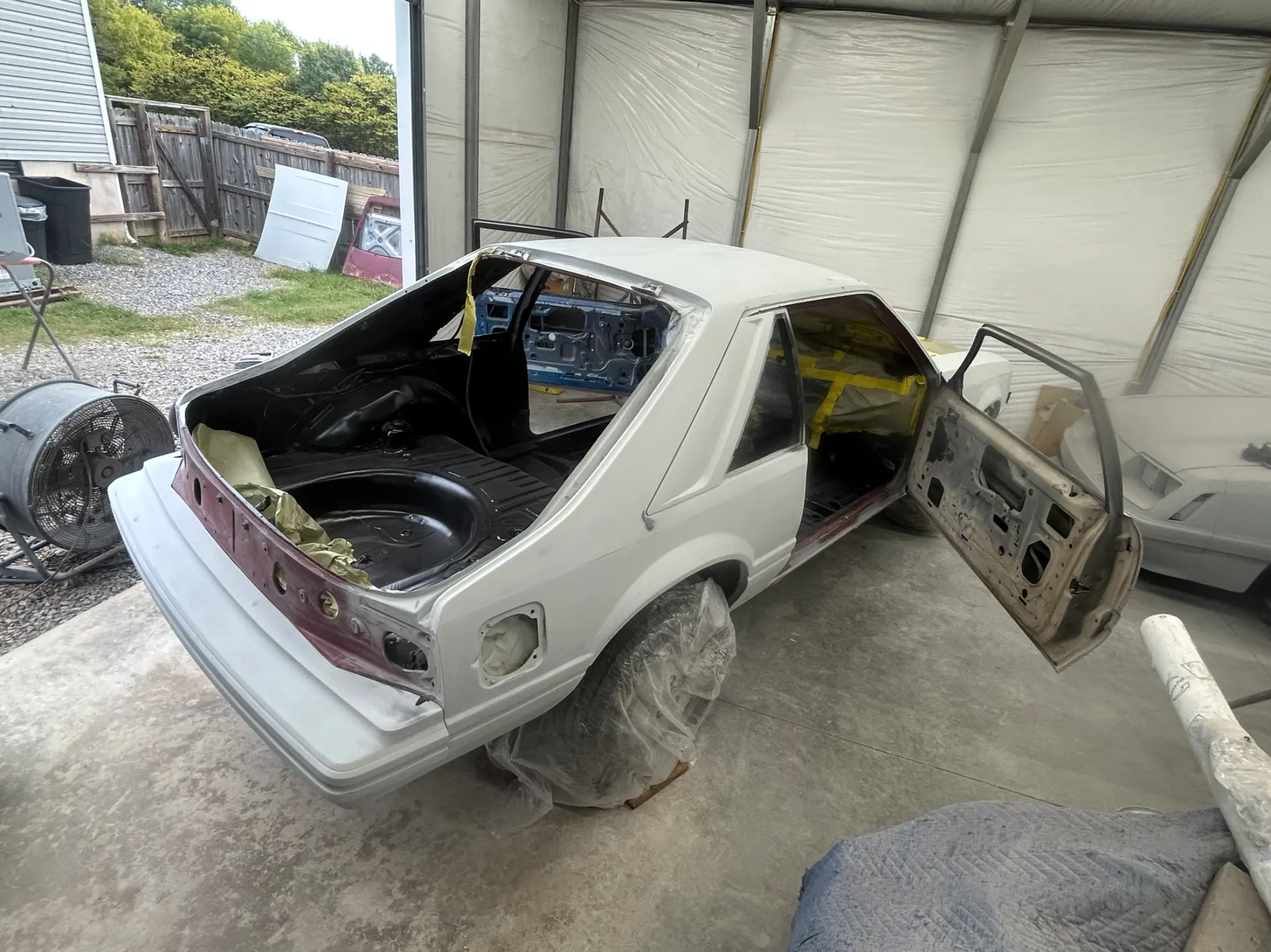

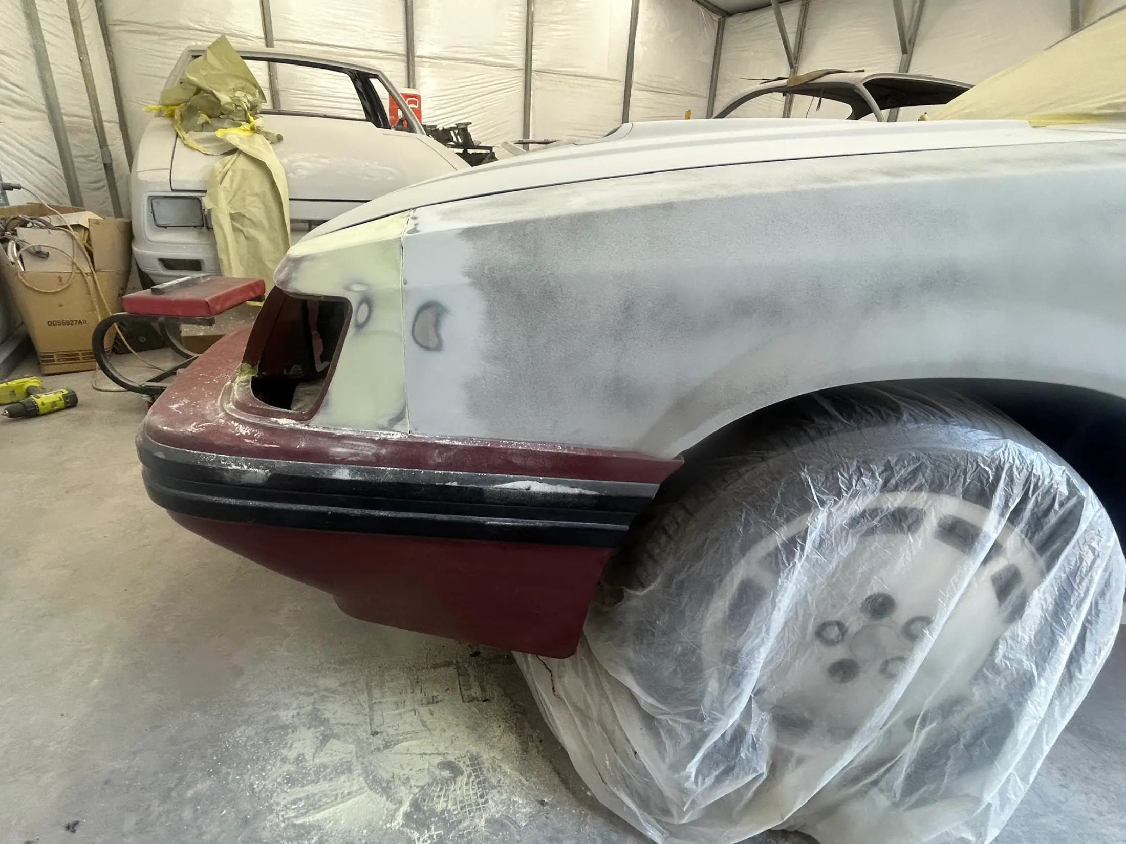

Did a few rust repairs on the hatch. Got the doors gapped to 3/16 same with the bodyworked fenders. Now blocking panel to panel.

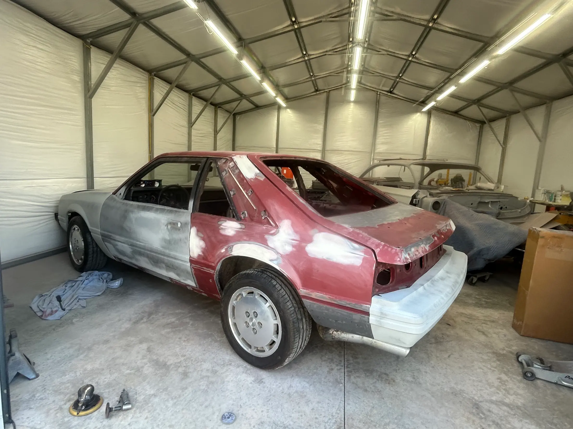

Time for my favorite thing……

Another grey mustang

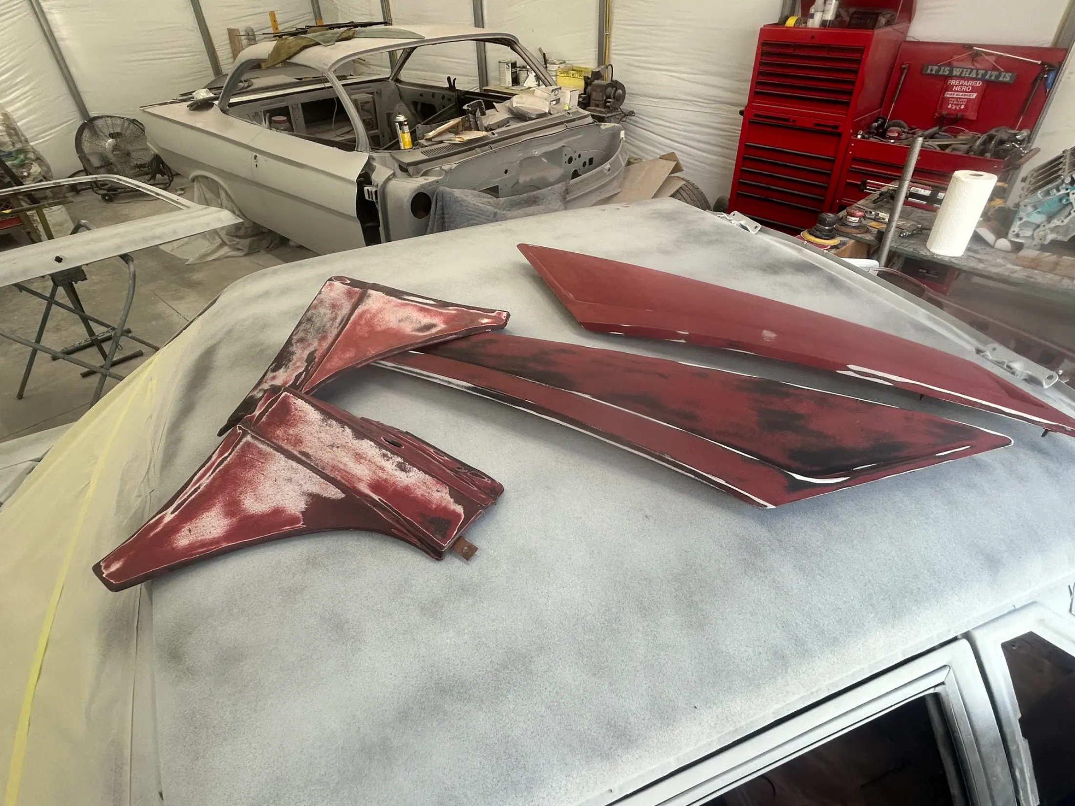

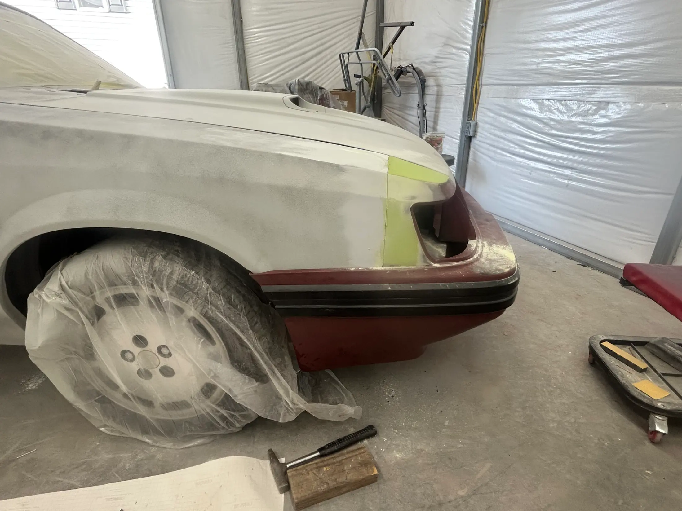

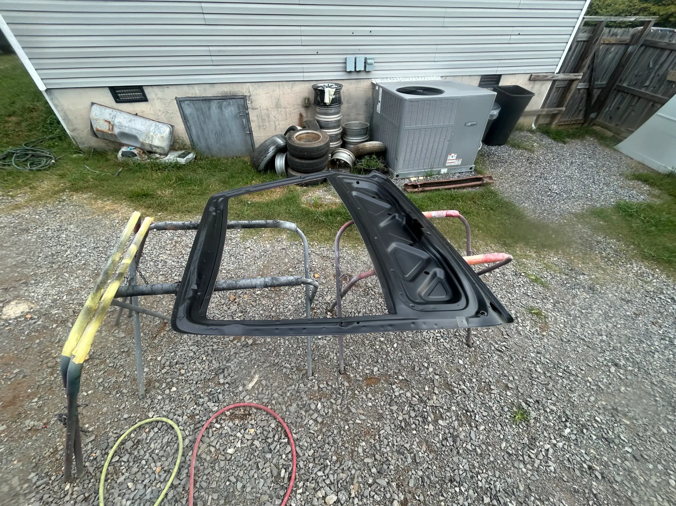

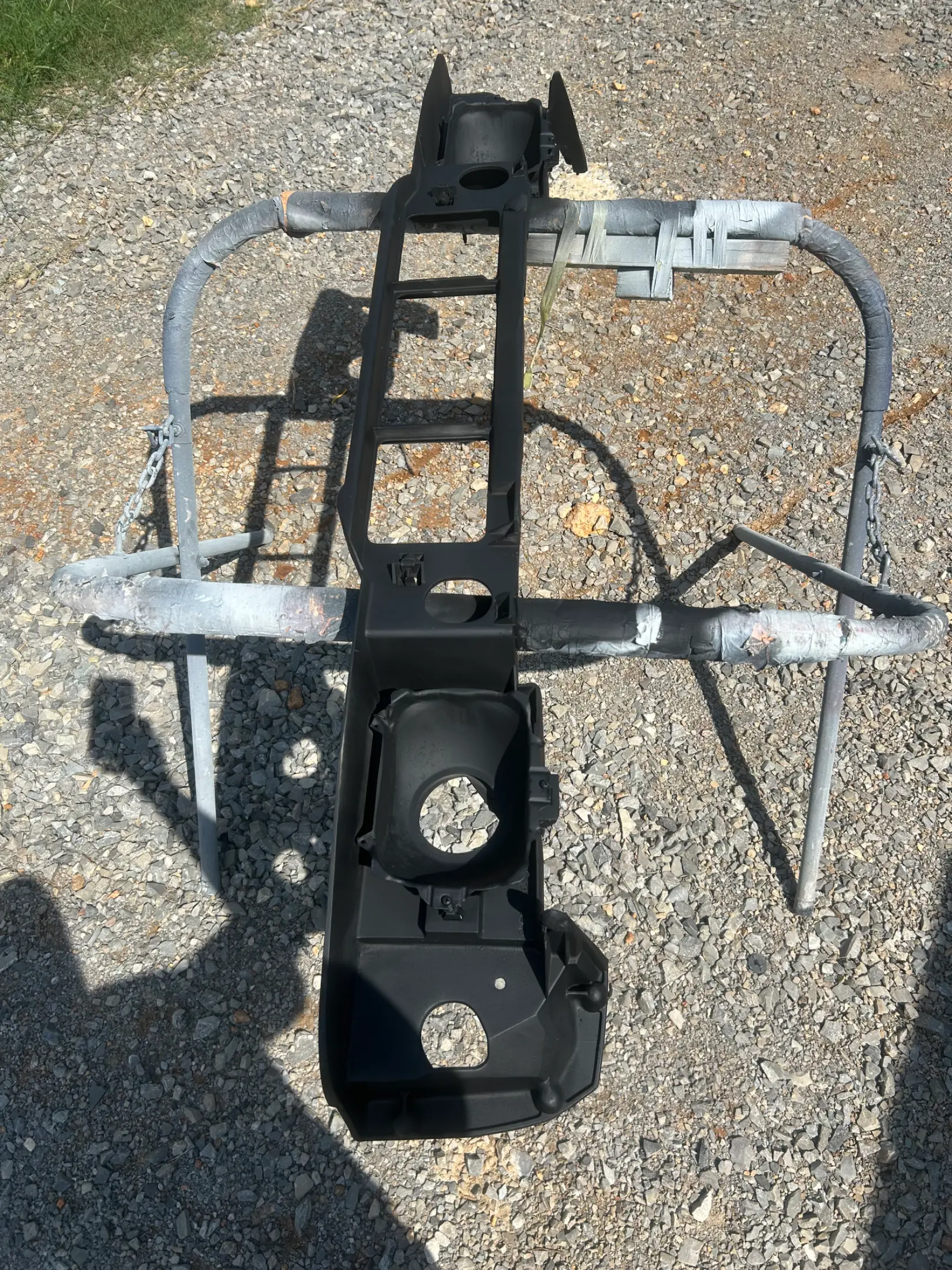

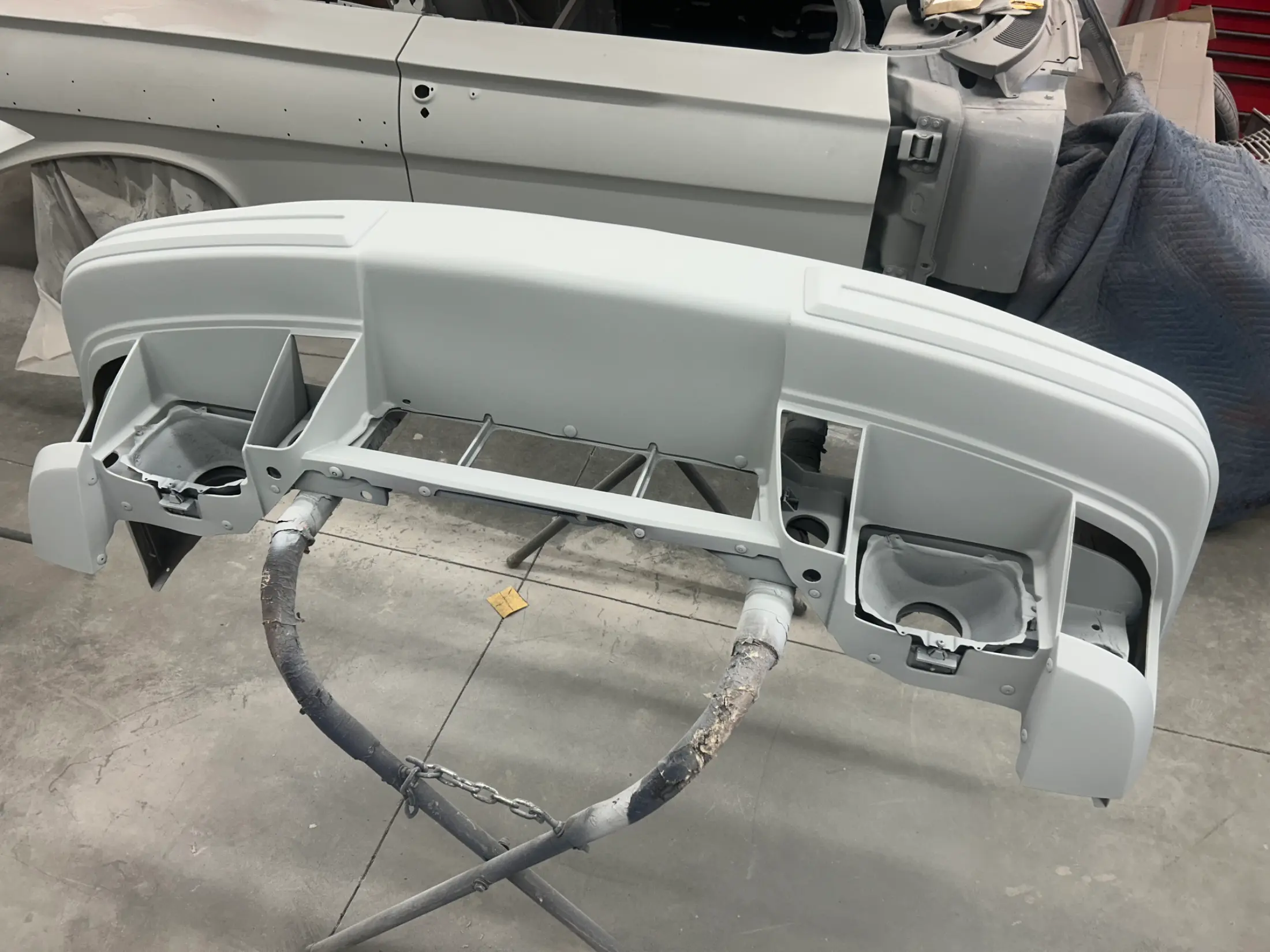

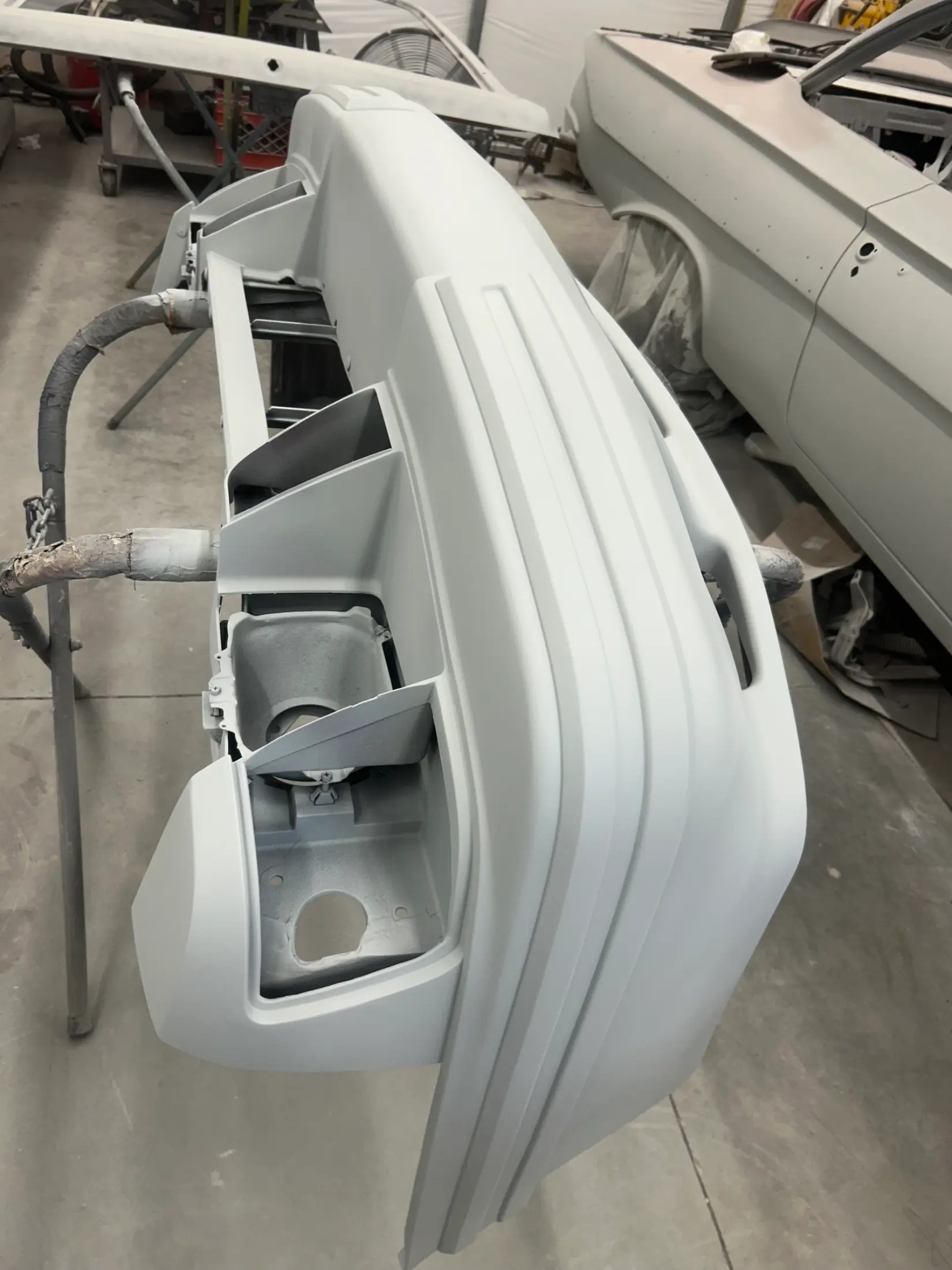

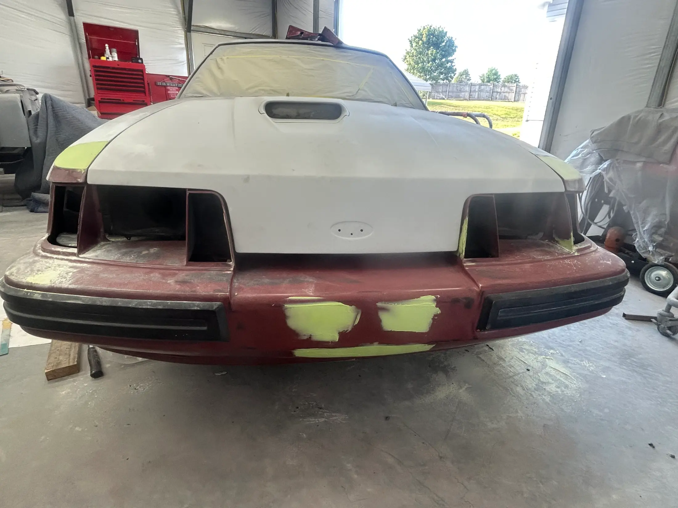

The header panel which I posted a pic earlier in the thread was busted up and in pieces. So I took 3 busted ones and made a good one. Then molded it and made a few in fiberglass. I attached only the ends of the bumper cover and lined it up to the fenders before putting in the rivets to attach the cover to the header panel. Now im bodyworking the bumper to the fenders. Also standing sanding sail panels and spats for primer

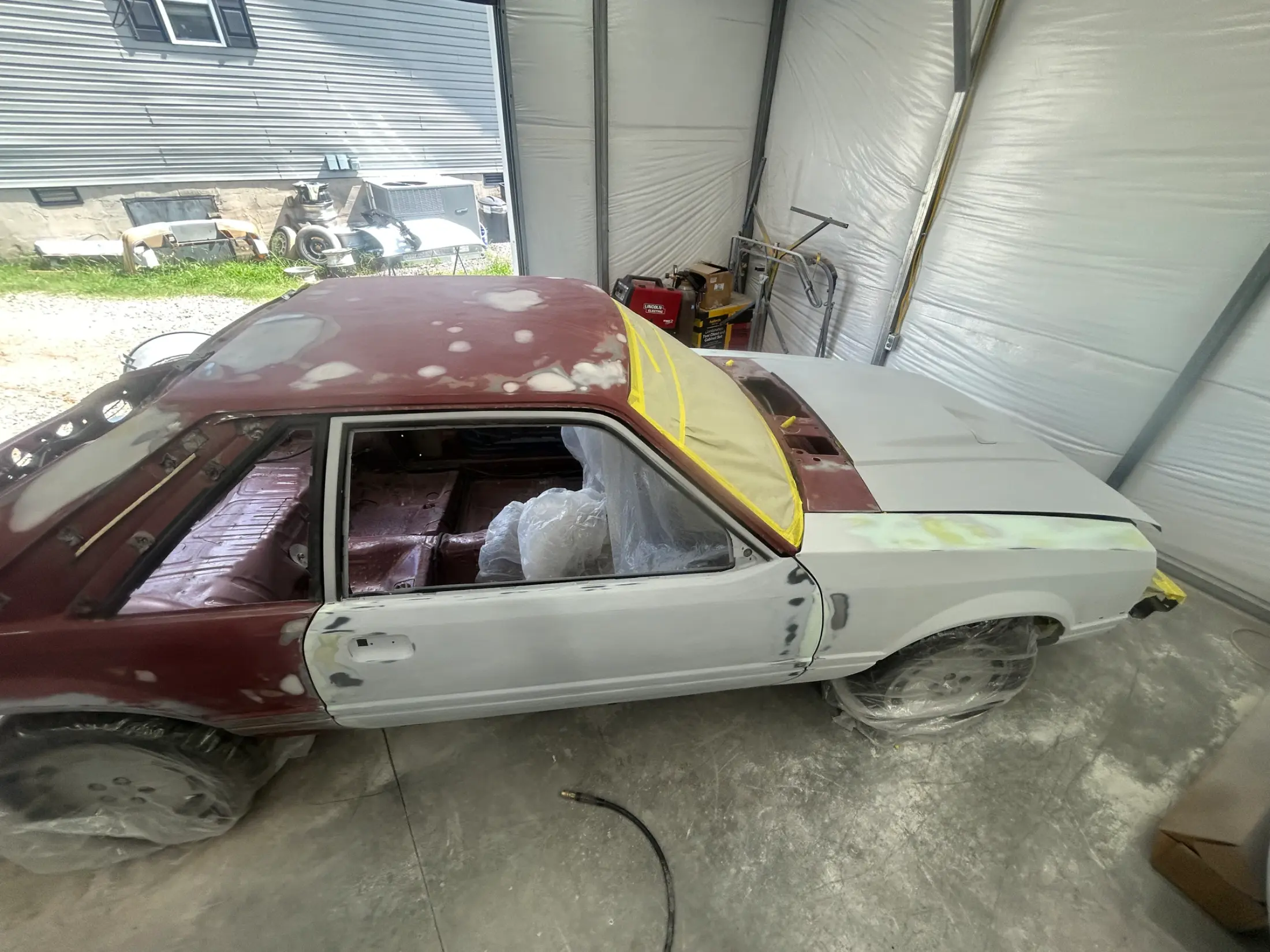

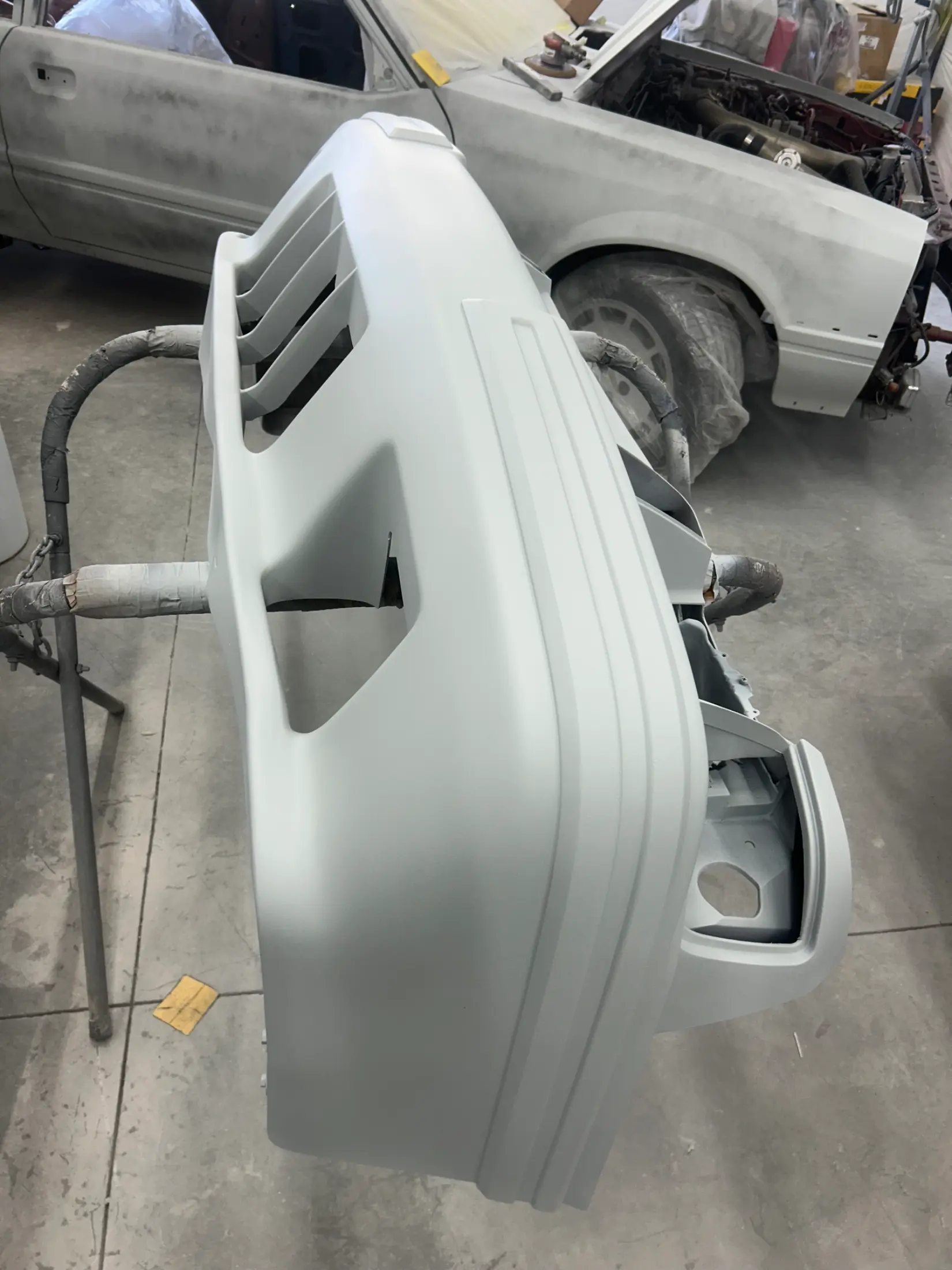

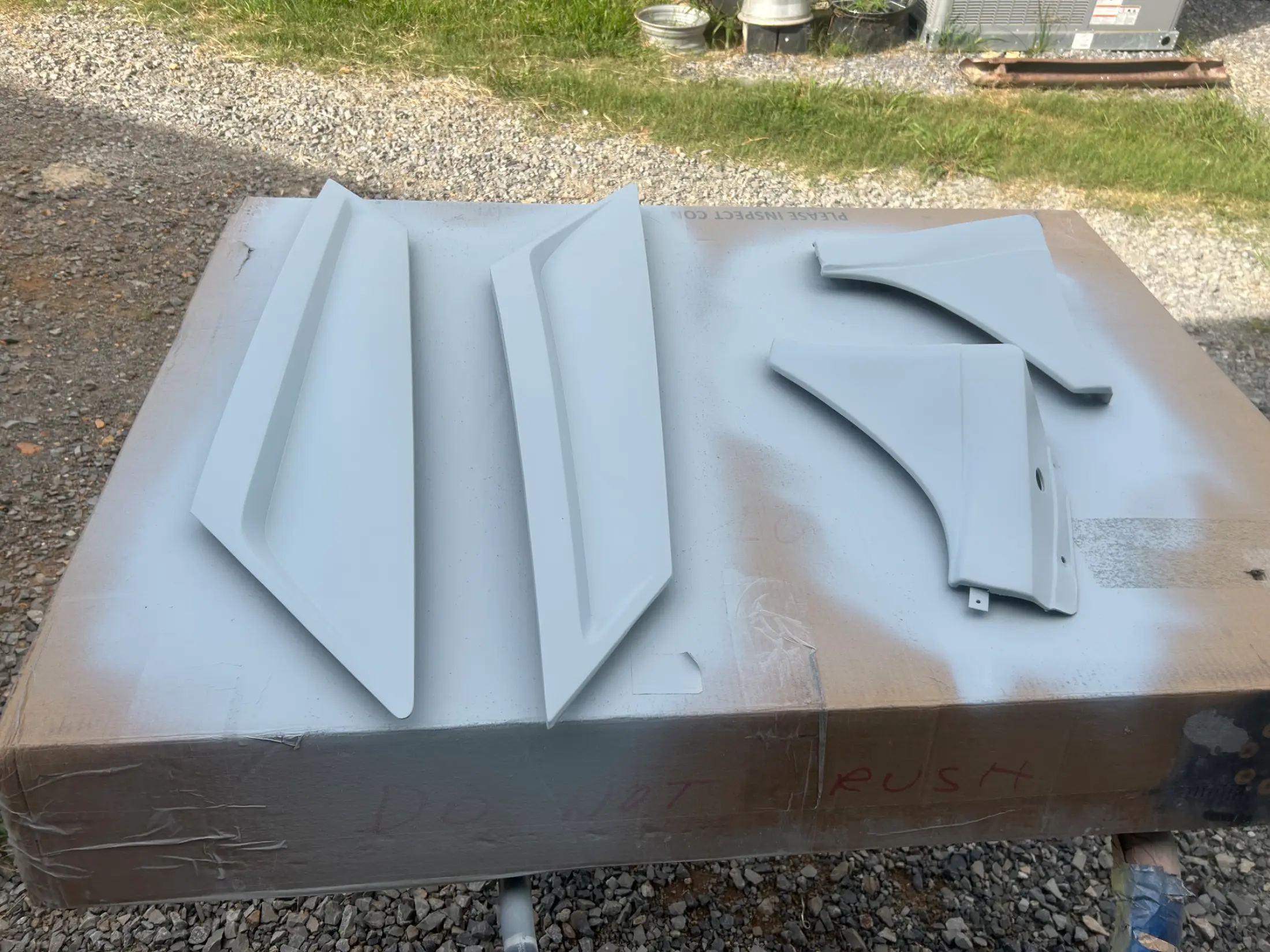

The front bumper was a huge project in itself. But is now good. Sail panels and spats also in primer

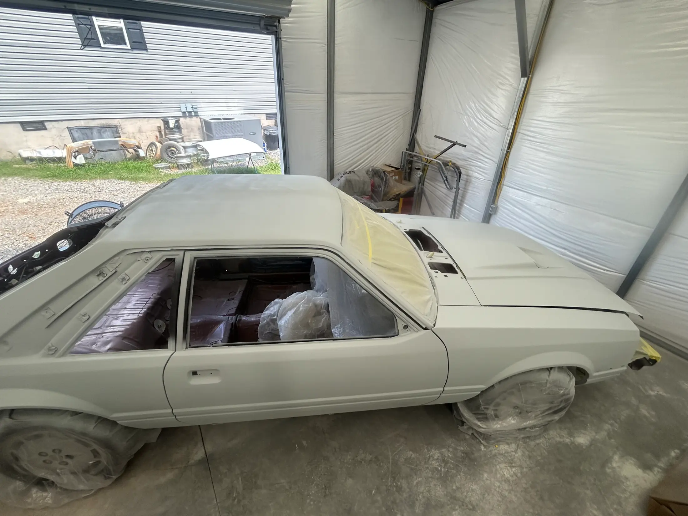

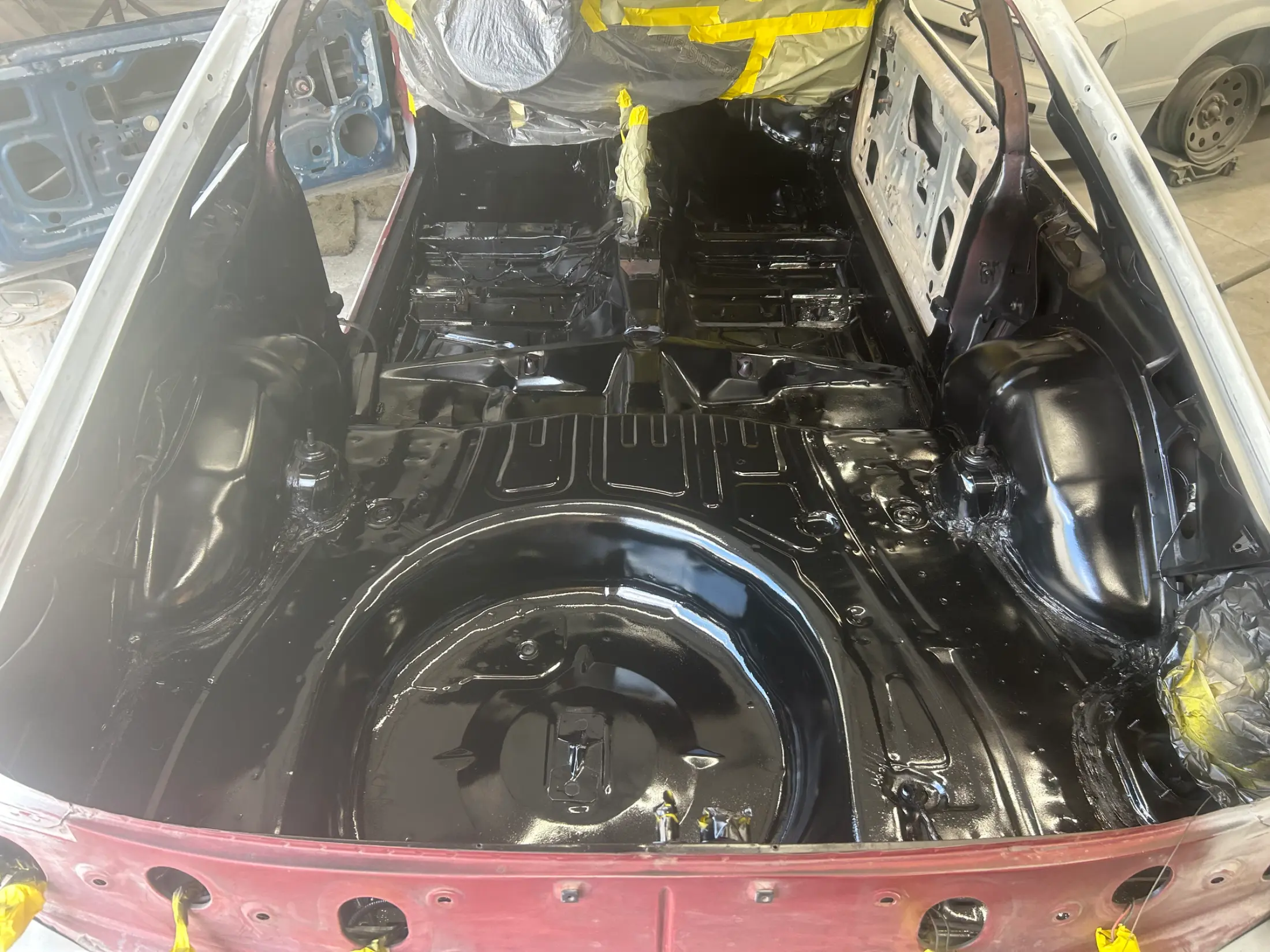

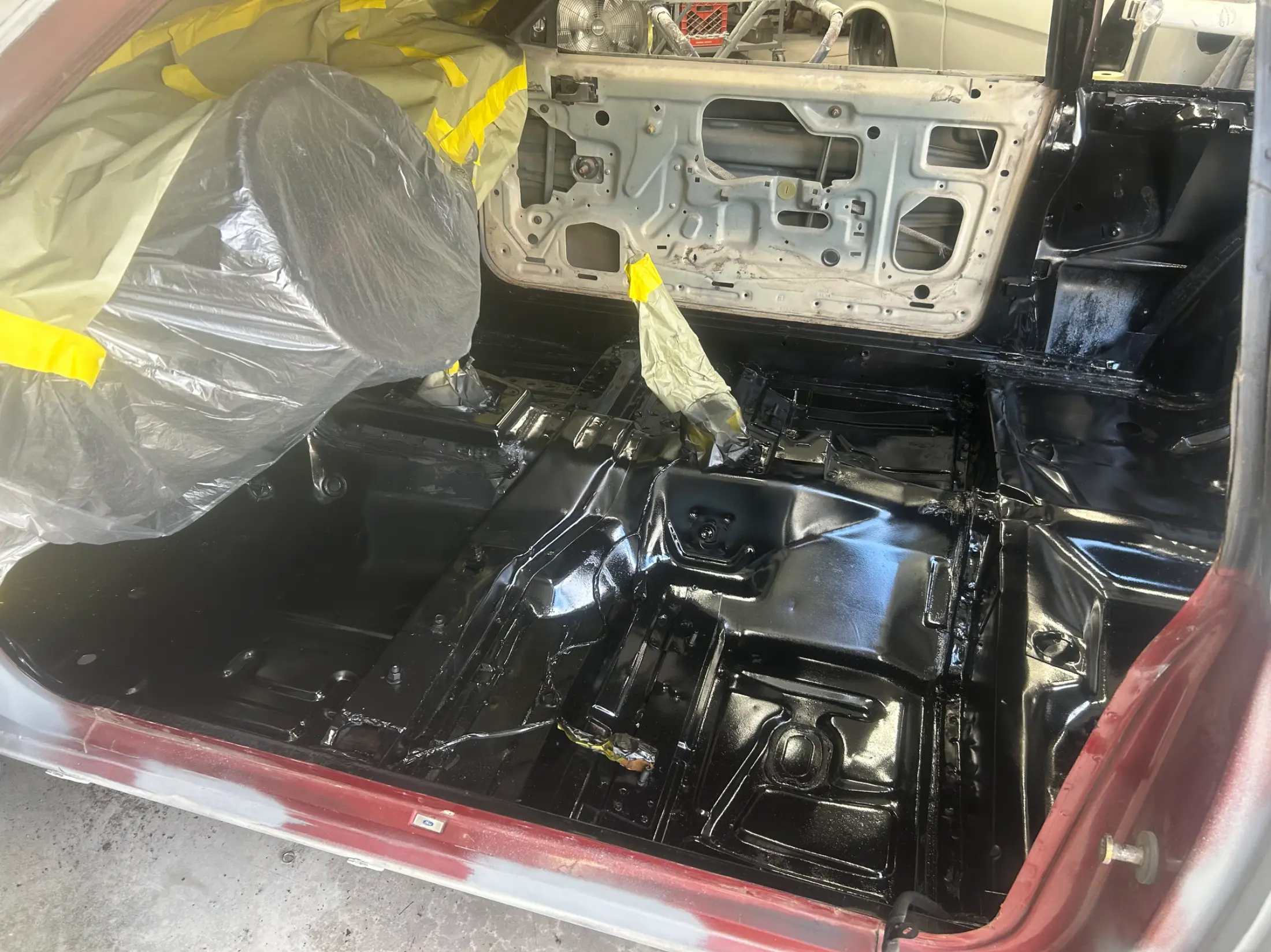

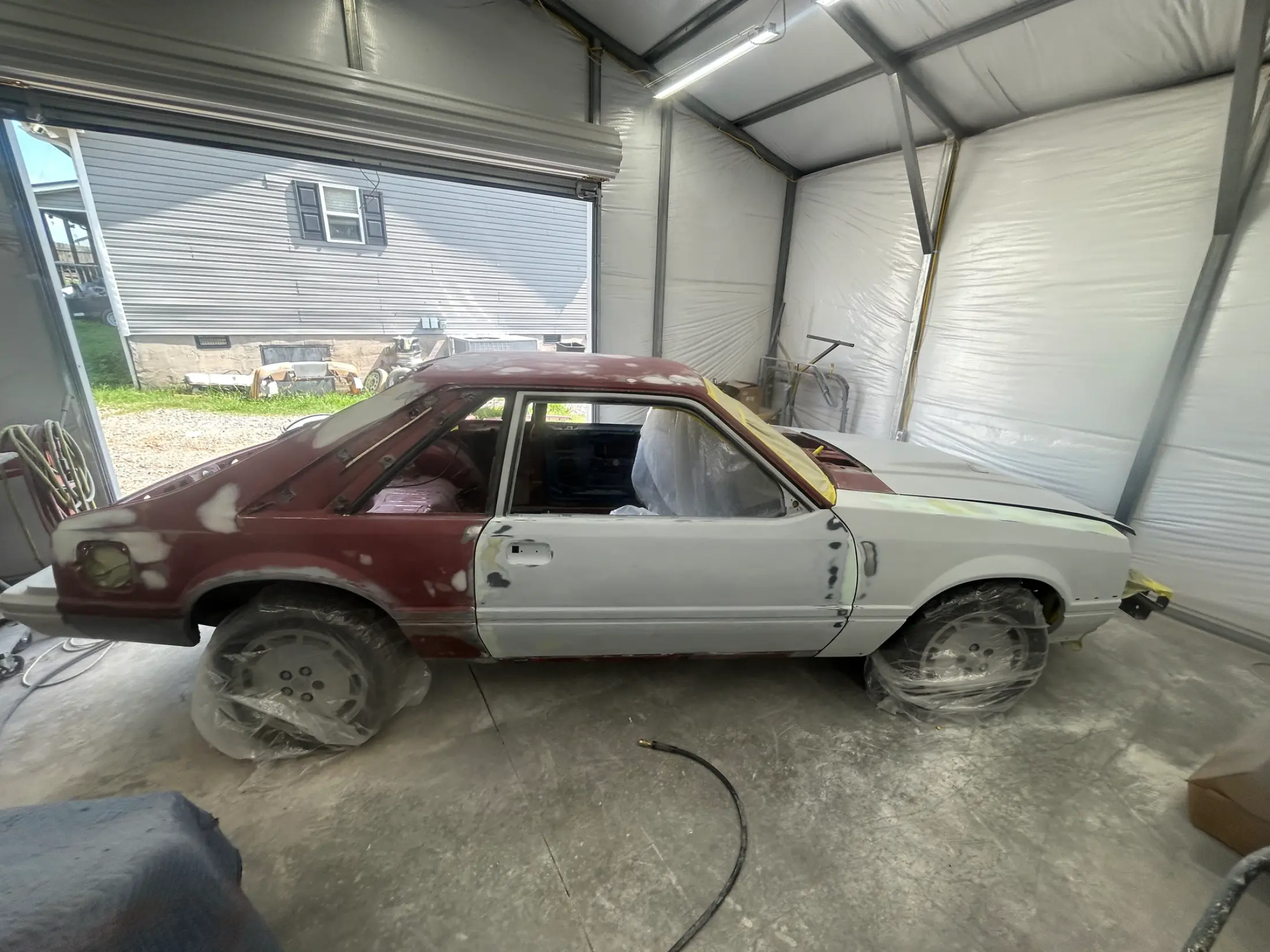

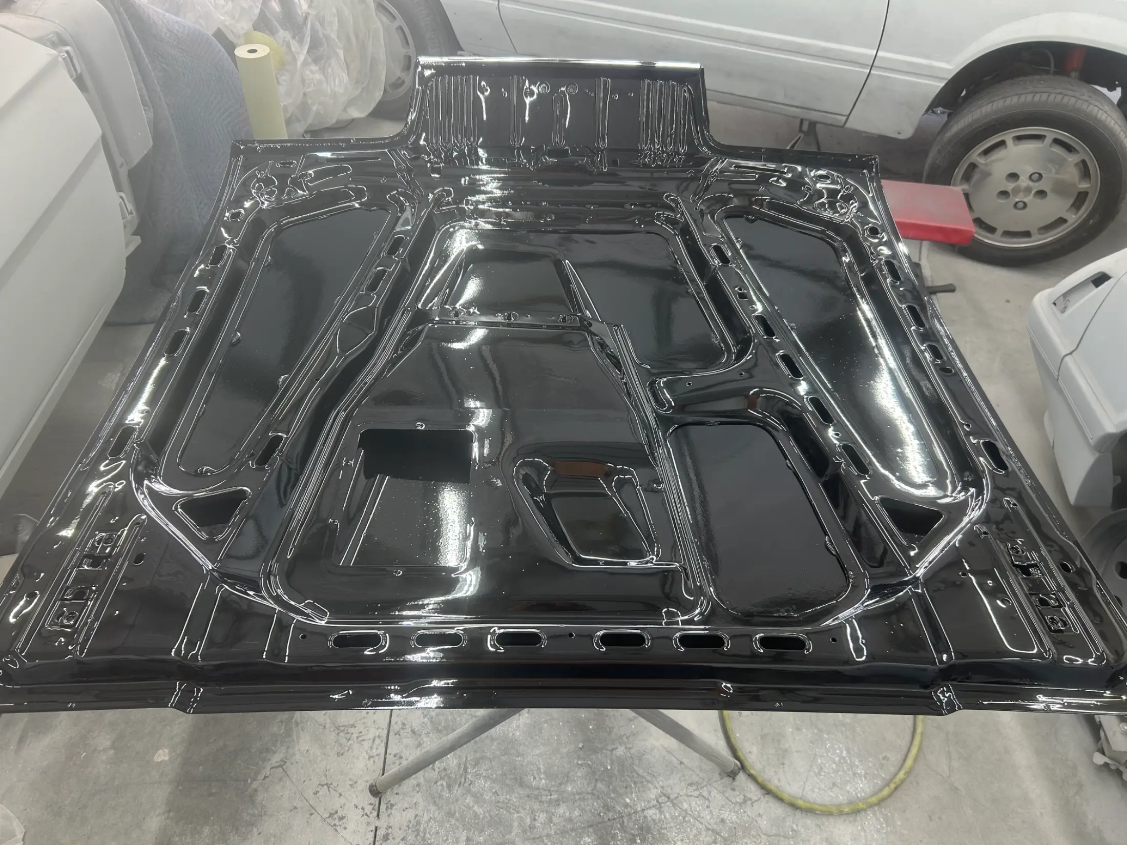

Fixed a few rust spots mainly around the toe board. Sanded and prepped the inside and layed the epoxy to it.

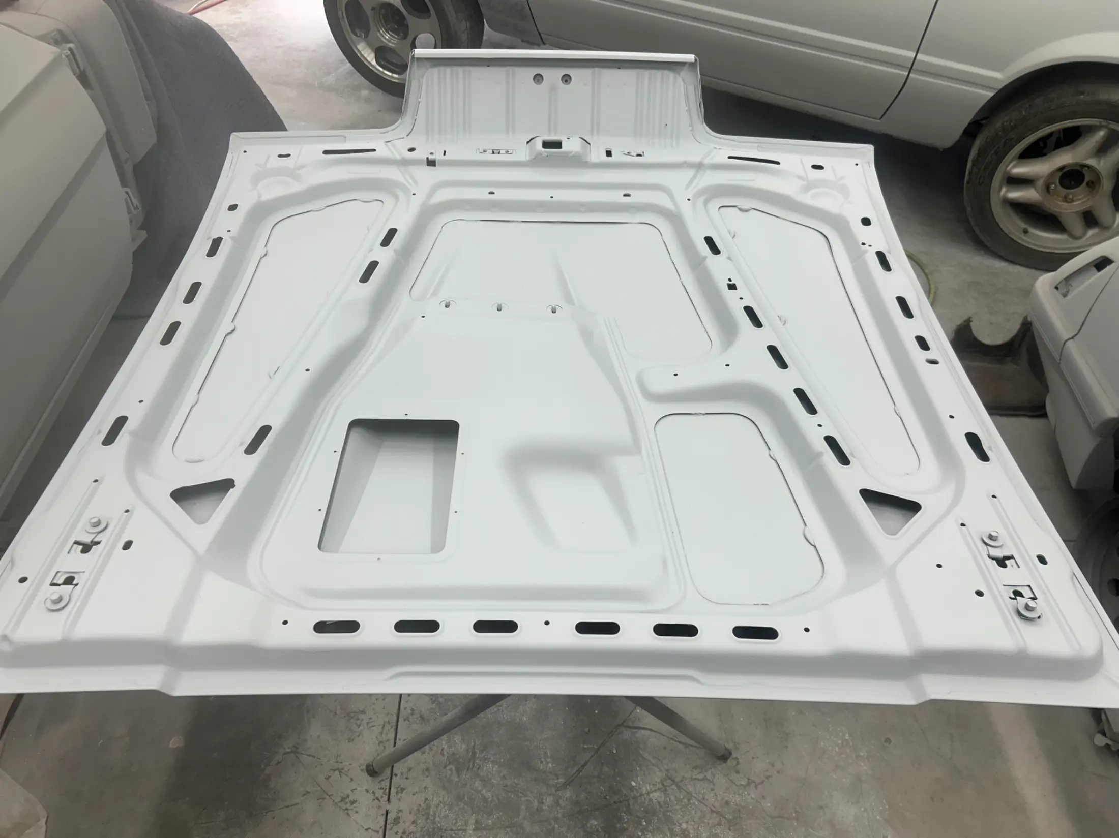

Right after he wet sands and buffs that floor pan
Don't forget the underside of that hood too!

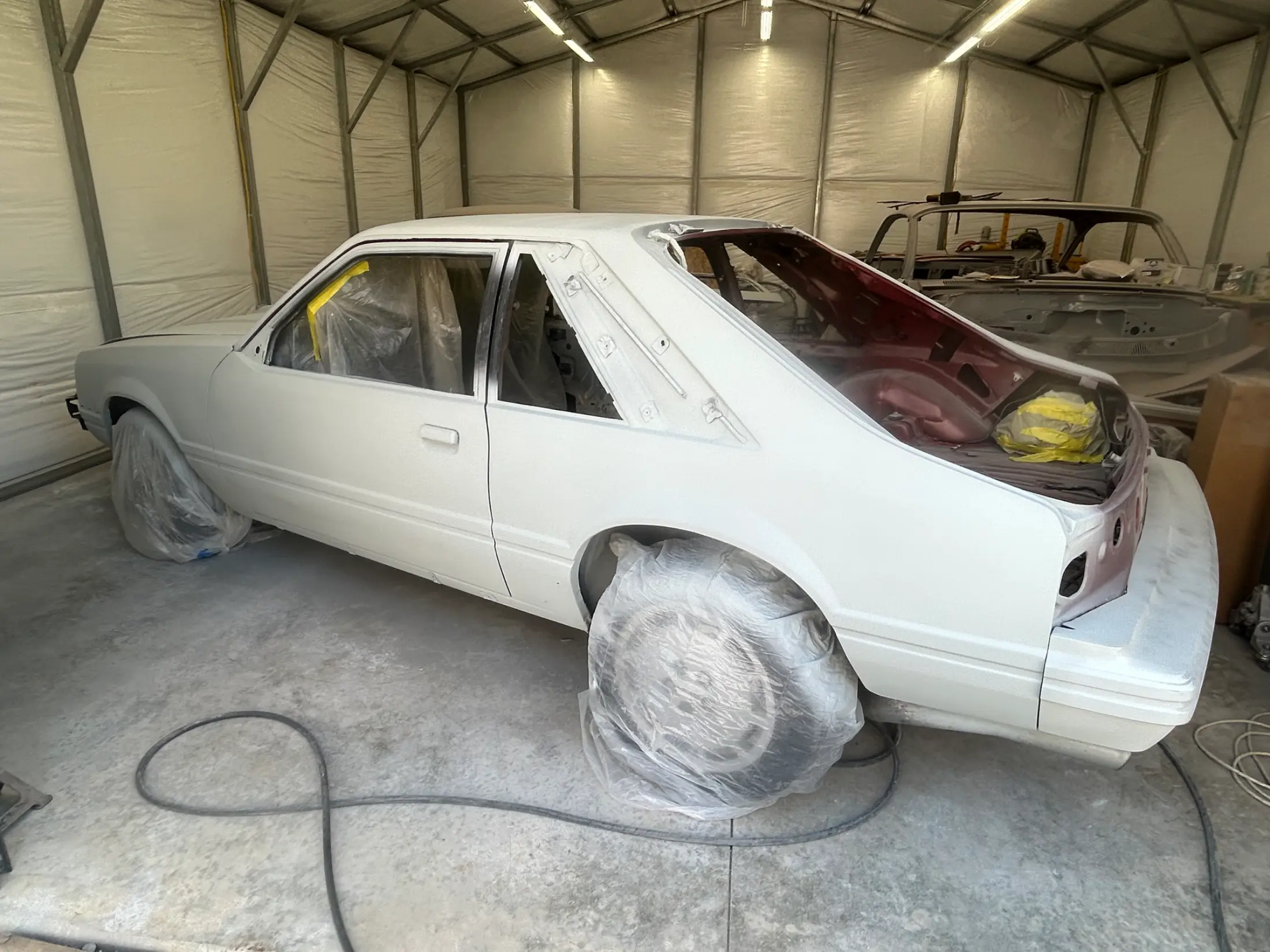

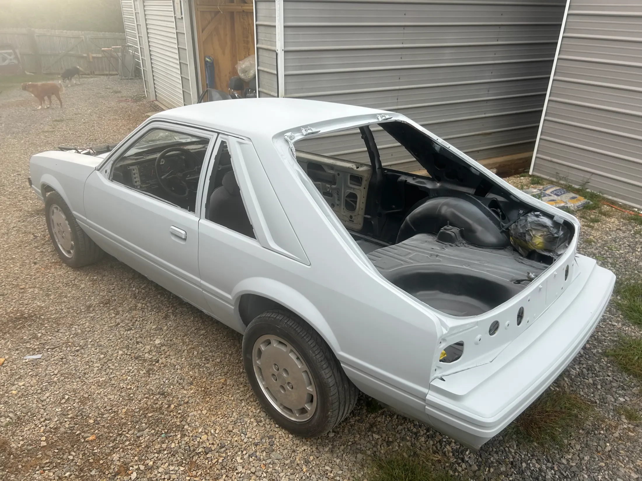

And primer time

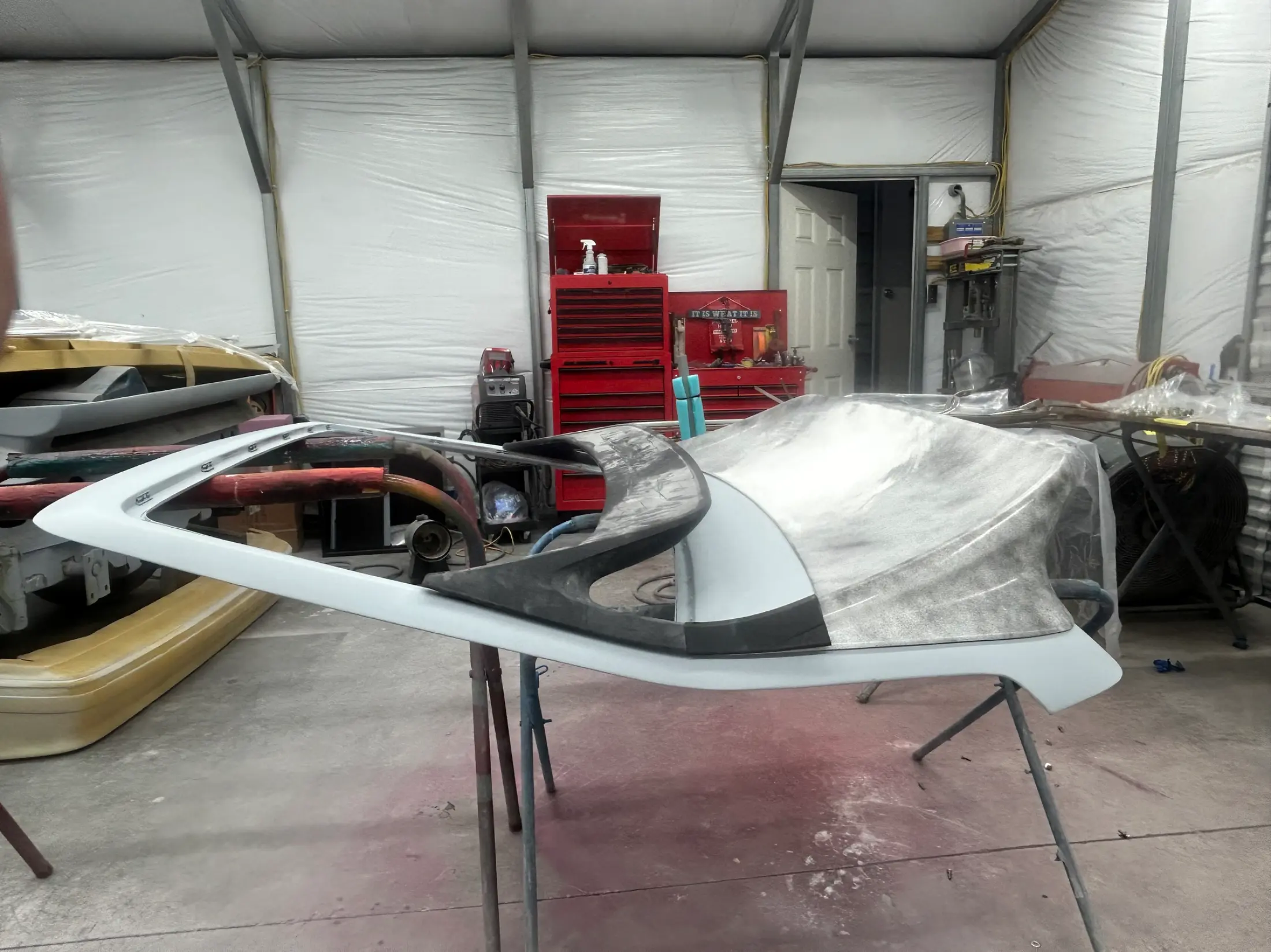

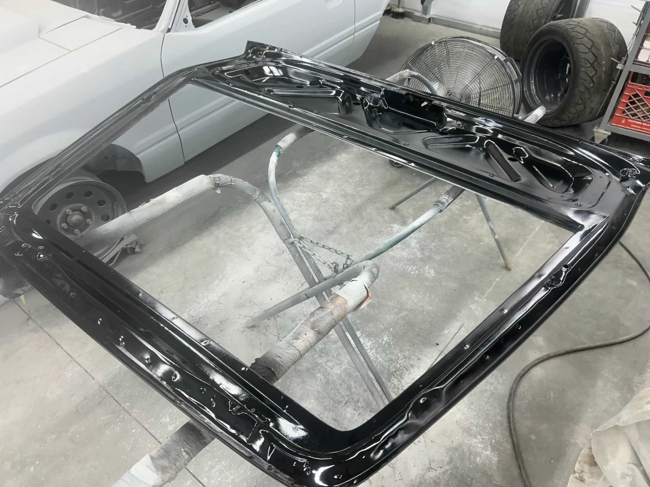

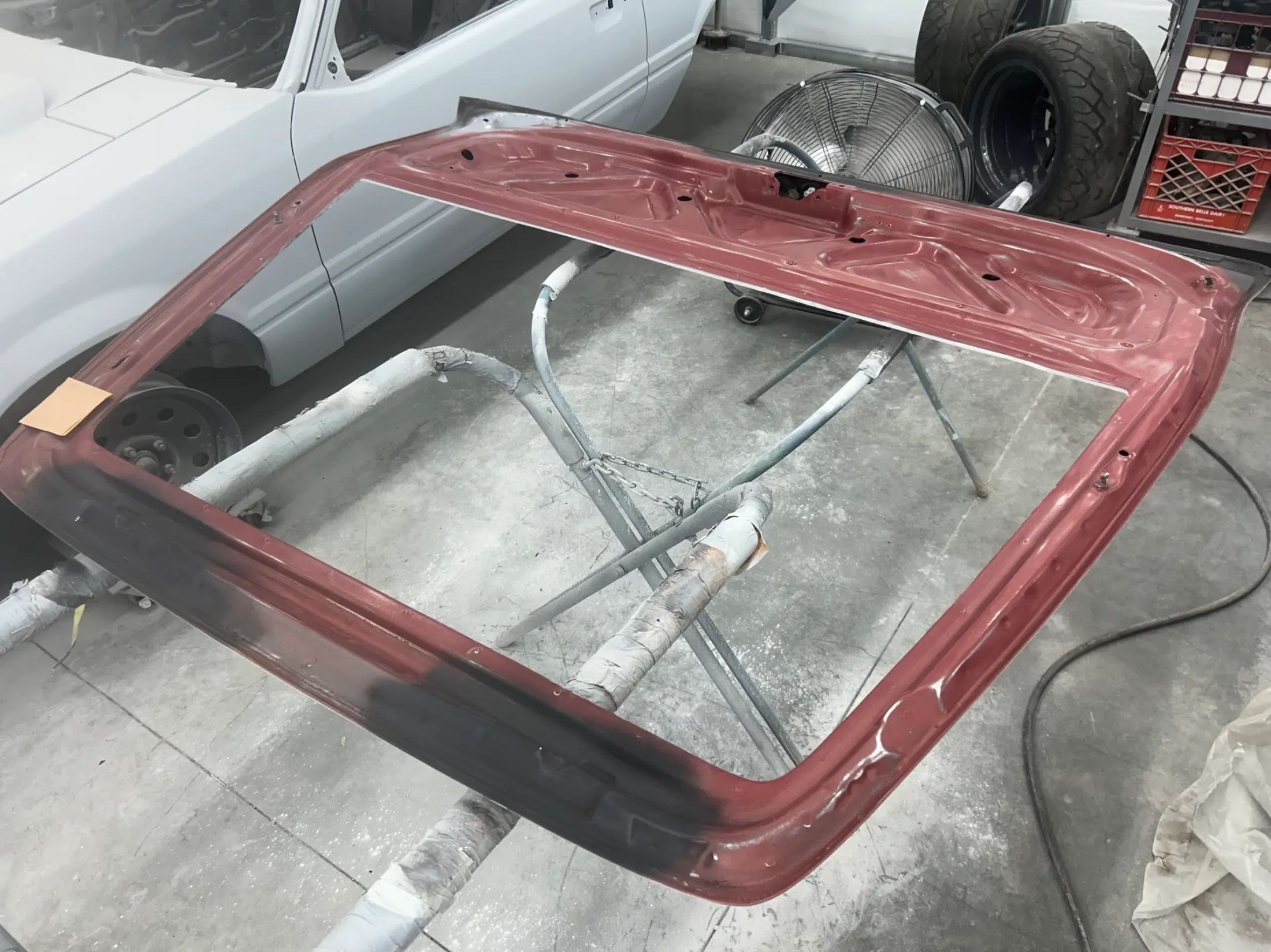

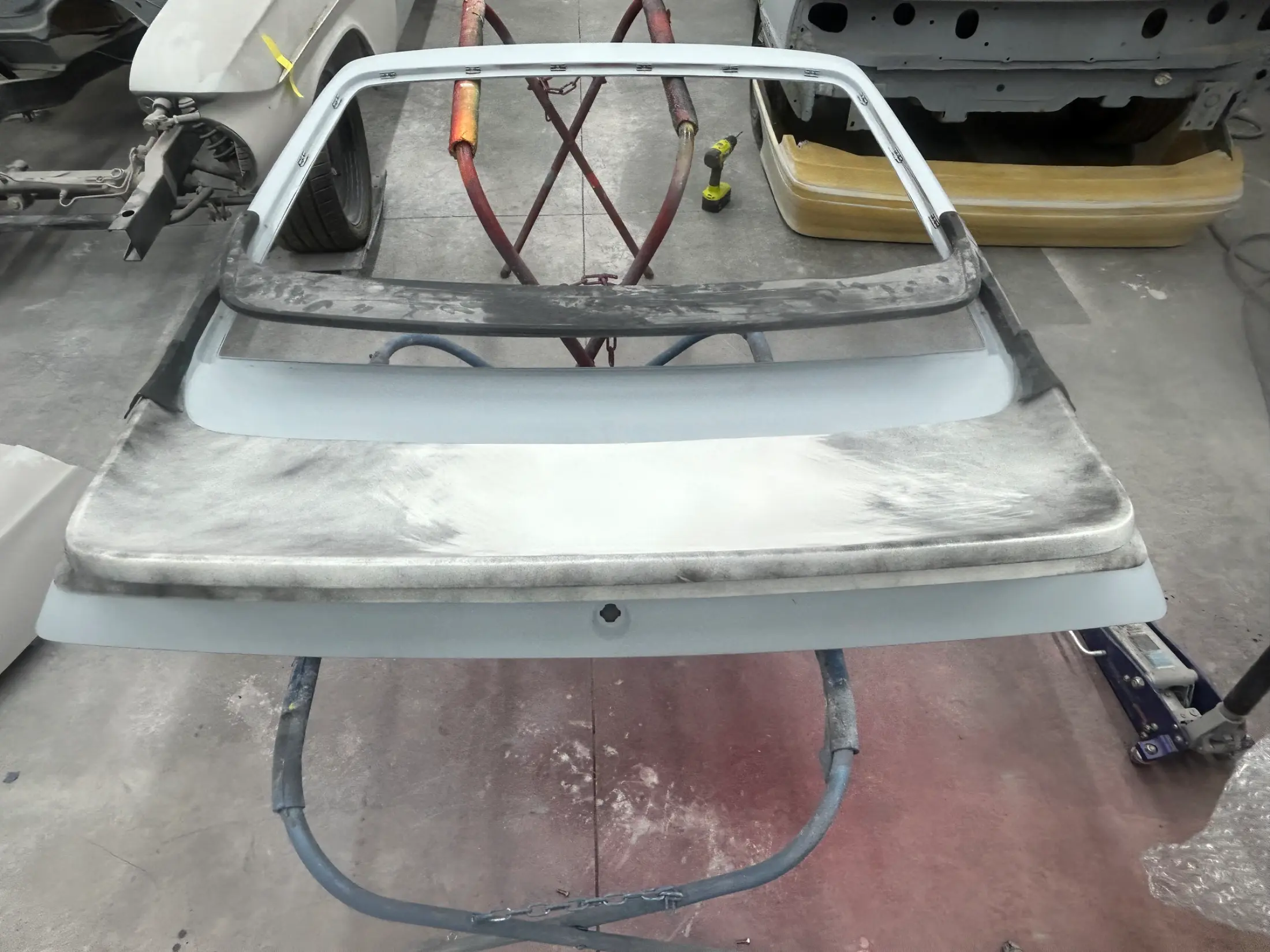

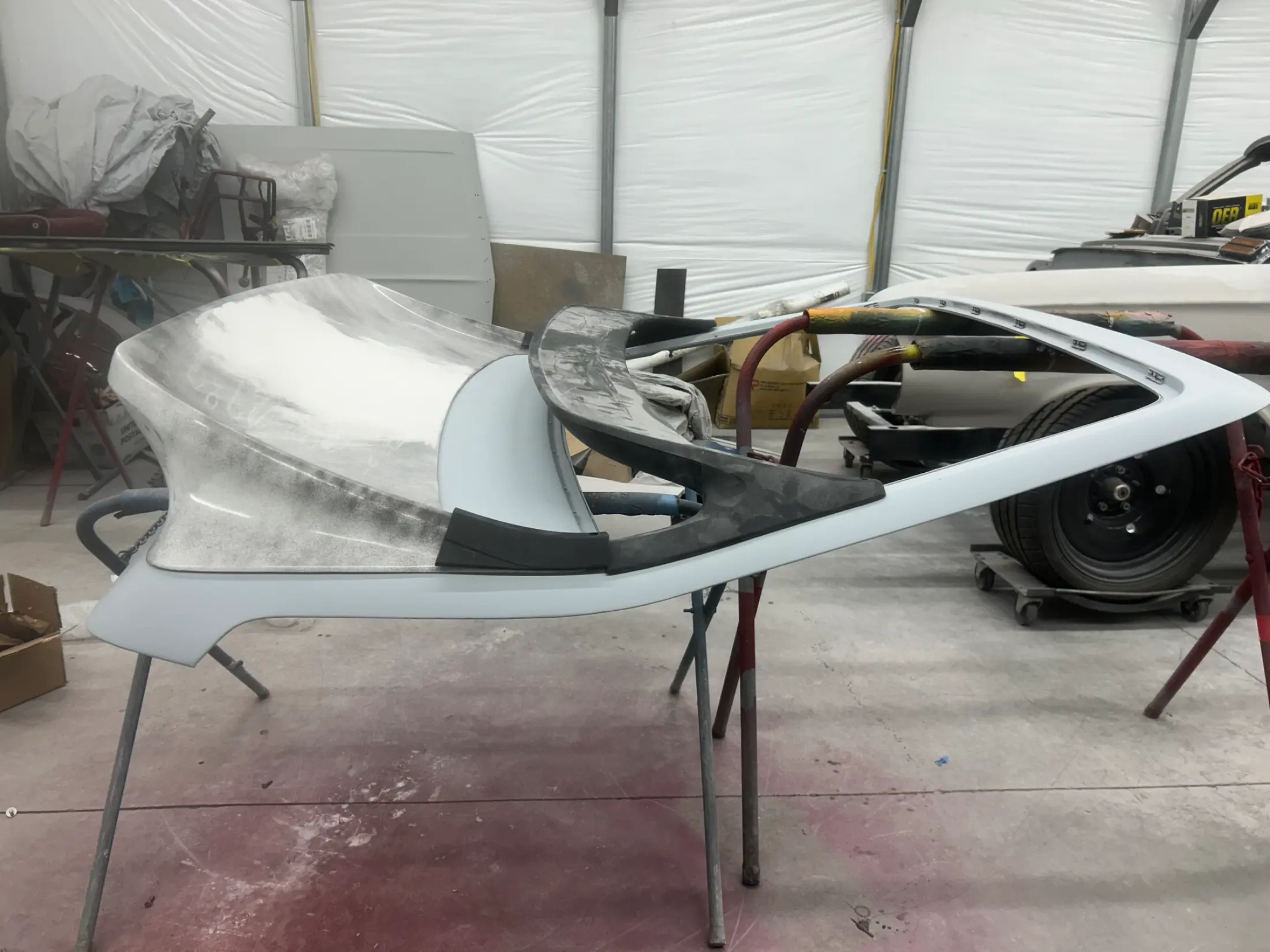

The SVO has been sitting and curing the bodywork out. But I got the hatch out to start working on a better bi plane wing and spoiler setup. Its going to be a one piece with no exposed hardware or holes. Should be fun

Spoiler work.
Once I get this spoiler finished and fitting perfect with the bi plane wing. Im going to make a mold and pop one out in carbon.
