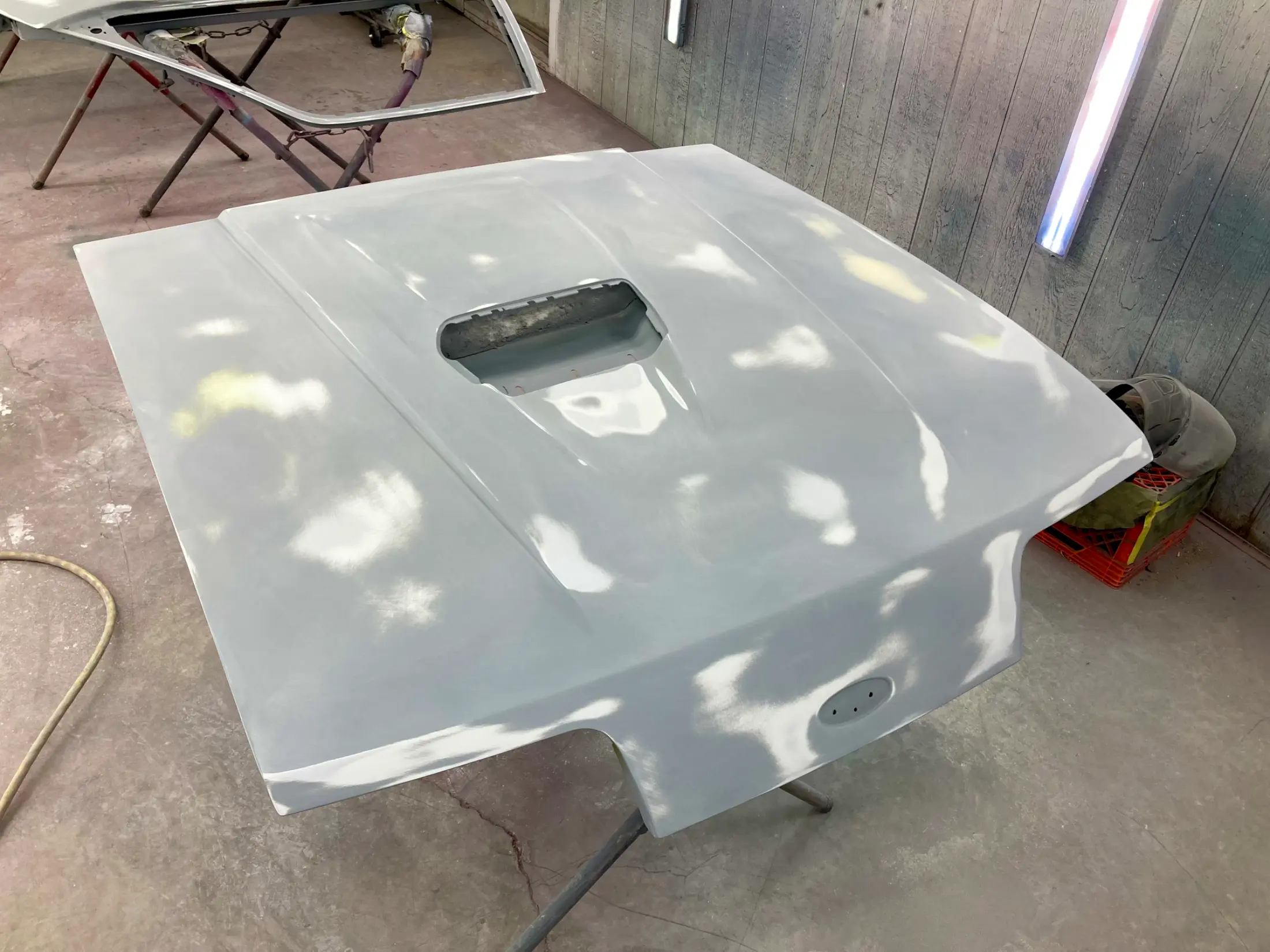

ctandc said:
Reminds me of the old guy I learned what little I know about body work / prep / paint. I'd work on a panel, sanding my fingerprints off. I'd say "It looks ready!" He'd come by, close his eyes, run his hands across the panel, then take out a sharpie and make like 25 different low / hi spots and just say "Not yet."
Yep… Im that guy. Do everything by feel

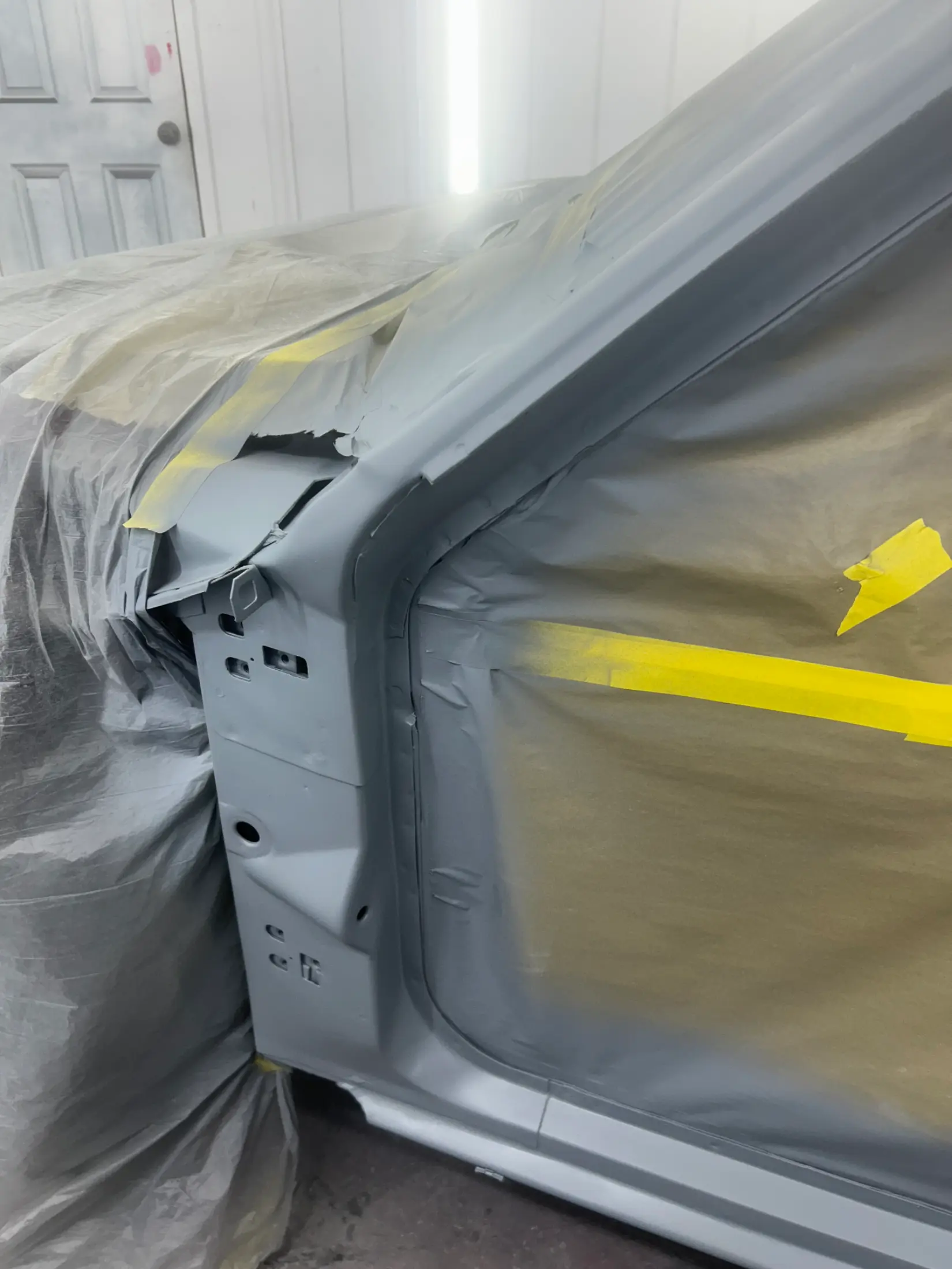

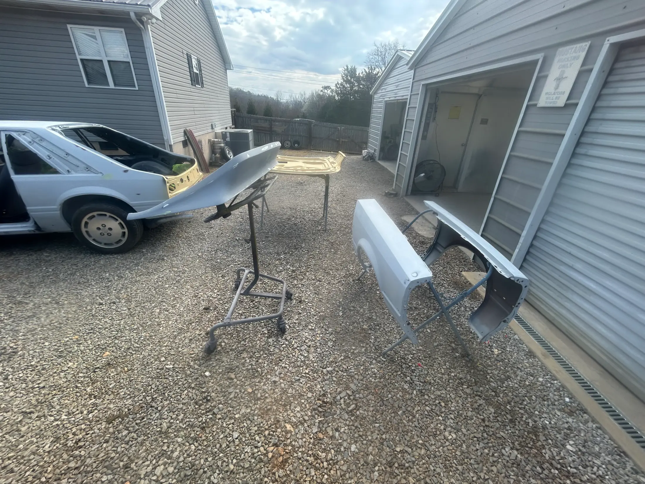

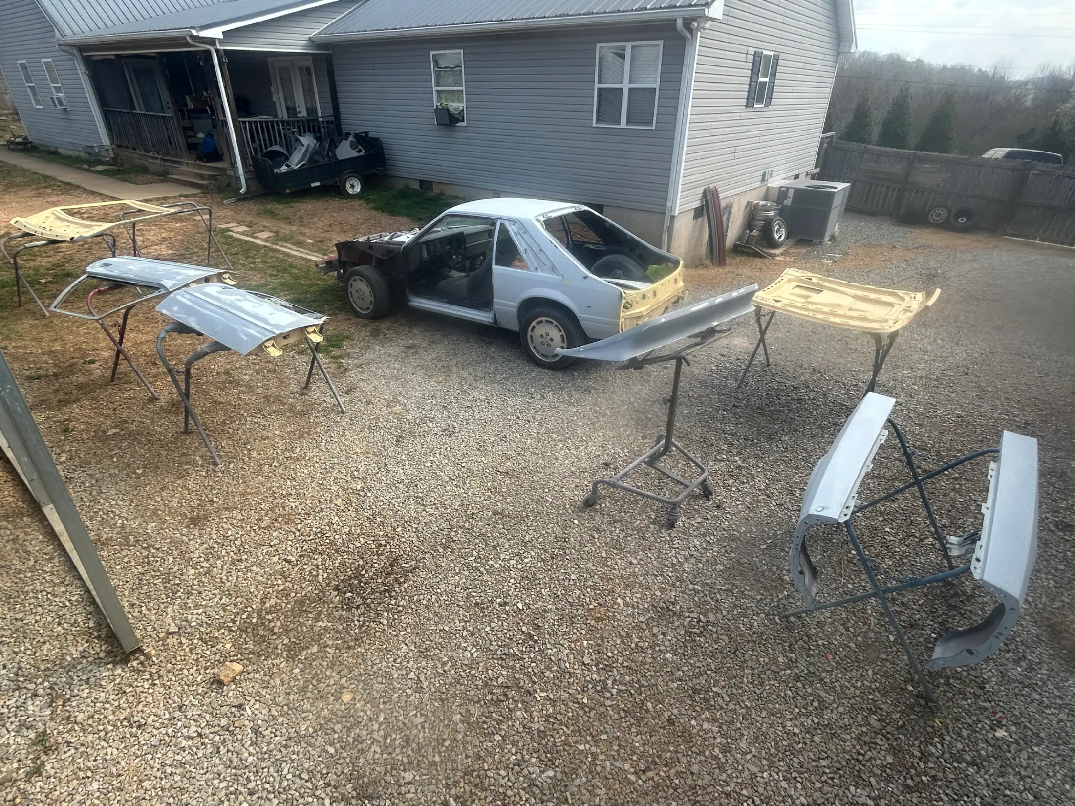

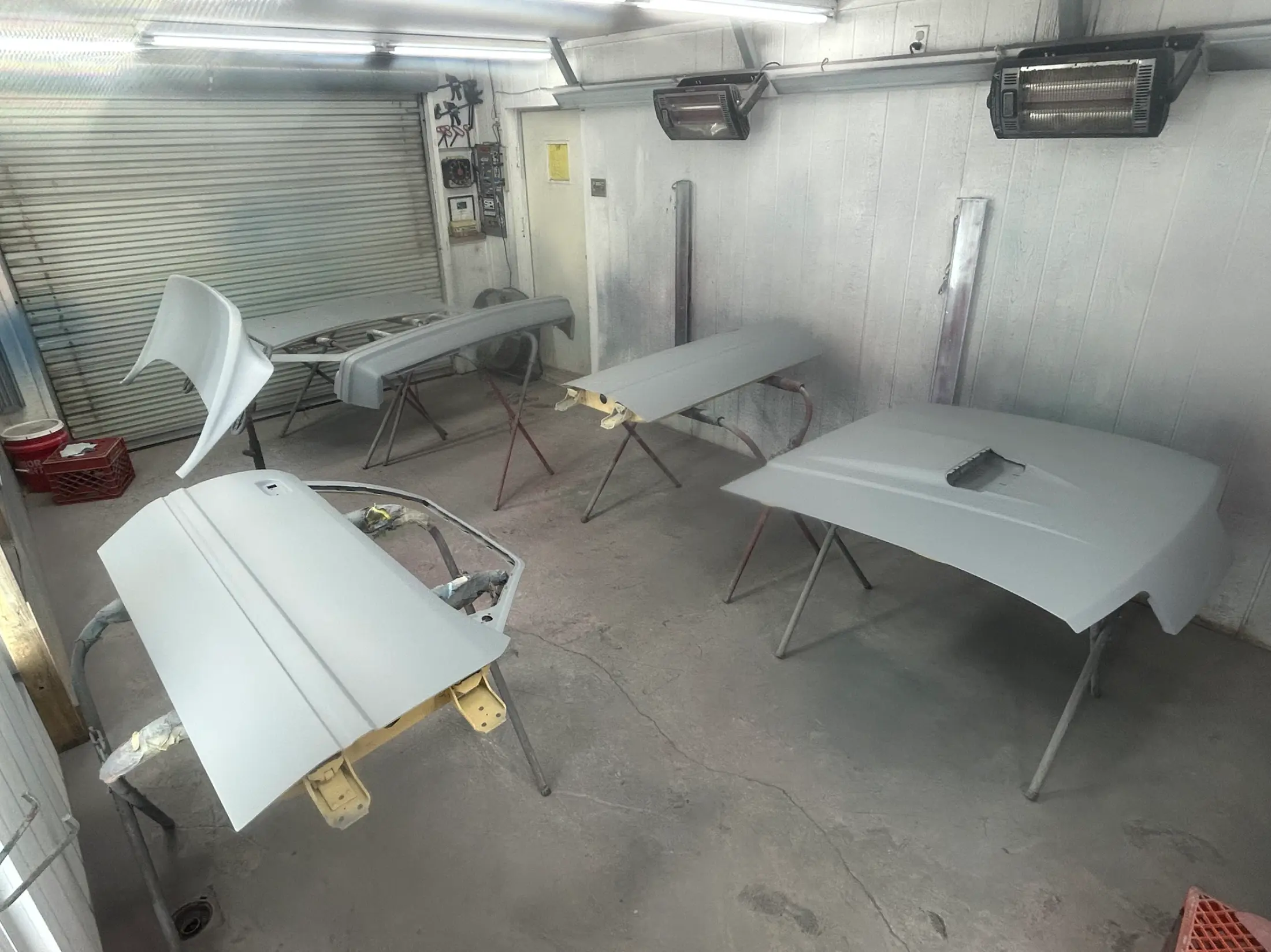

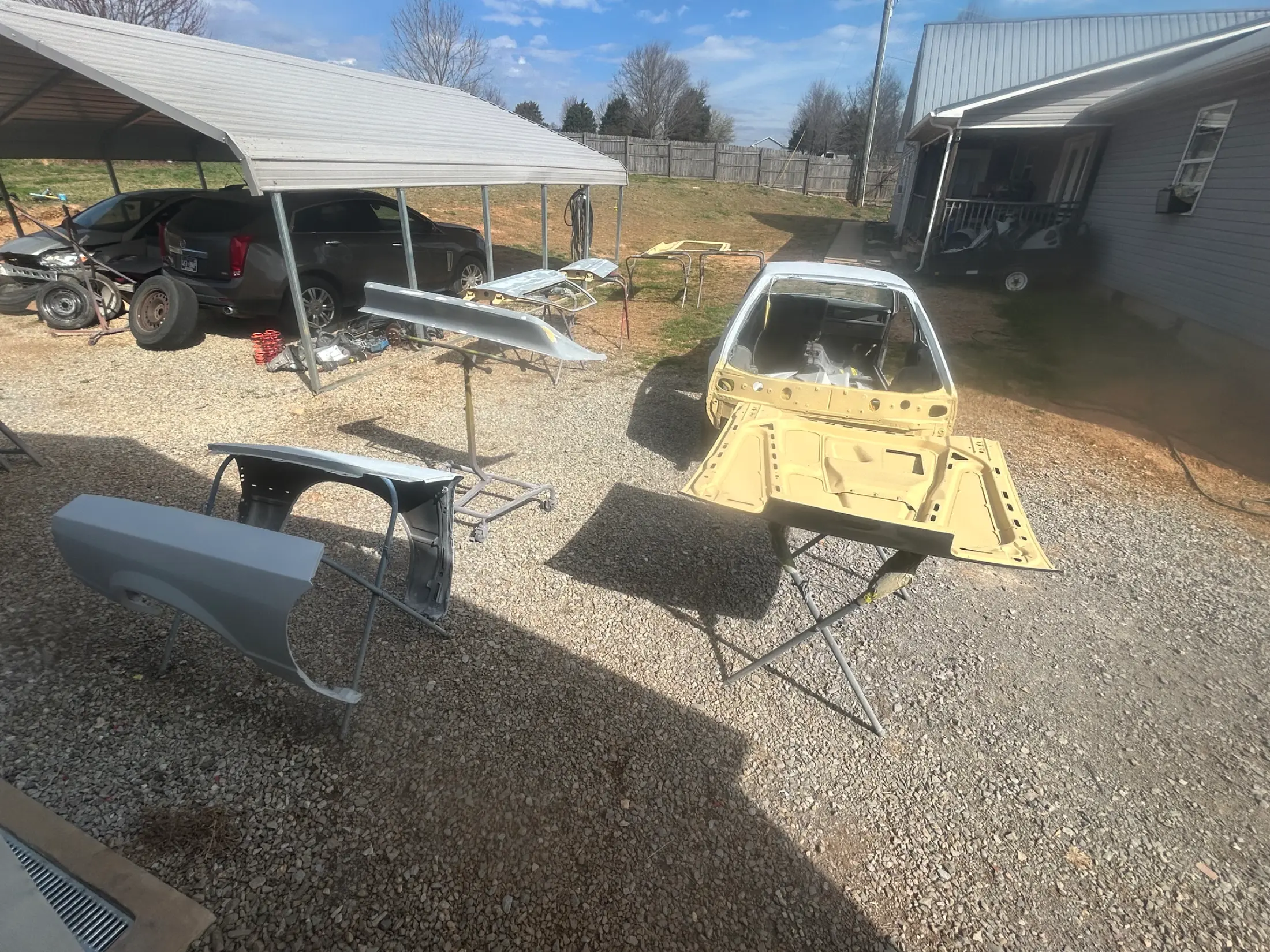

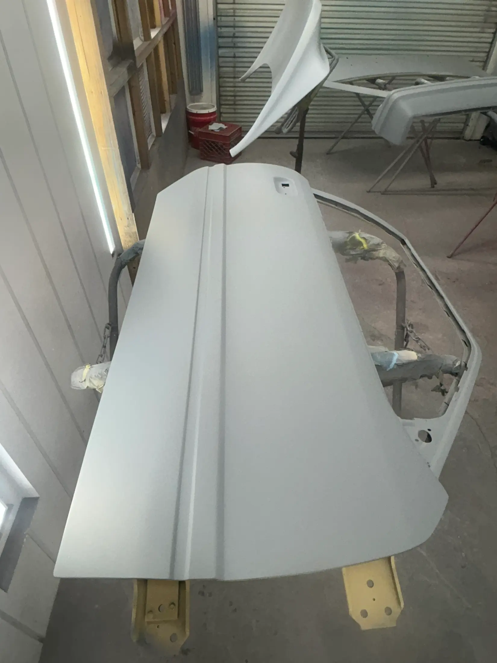

What it takes to do a show quality paint job. An explosion of pieces. Each one gone over and over and over again. Front and back.

Great job. When you can just concentrate on the process - getting the panels straight, prepped, primed..........it's almost zen.
By the way - I know you like Epoxy - do you use high build after epoxy?
What's your brand for epoxy and other primer?

It's nice to see your work area so much less cluttered with cars now that you have your storage areas built out!
Thanks. Everything is stripped to metal and gets epoxy dtm primer. I use SPI epoxy and Spi regular build primer as well
As evercoat superbuild.
Yea. No cars sit outside now. Even project cars that arent nice yet are indoors. The worst thing for any car that isnt being driven is just to sit outdoors.
Looks a bit different than when you first got it!

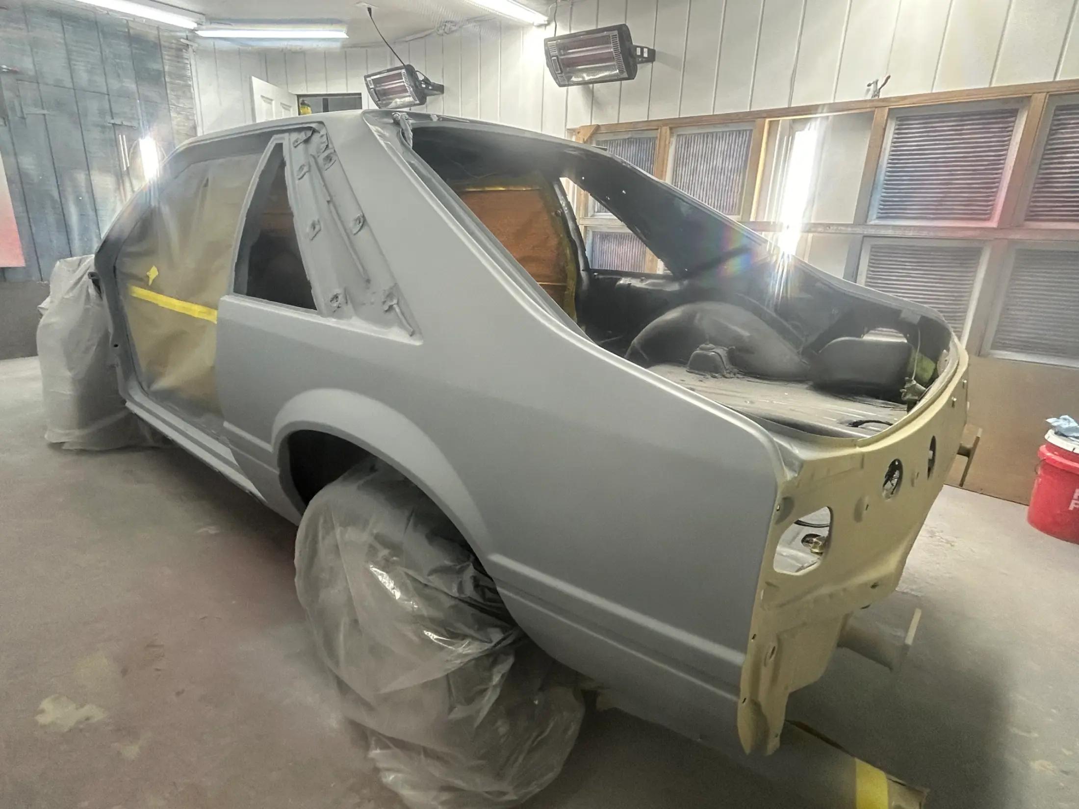

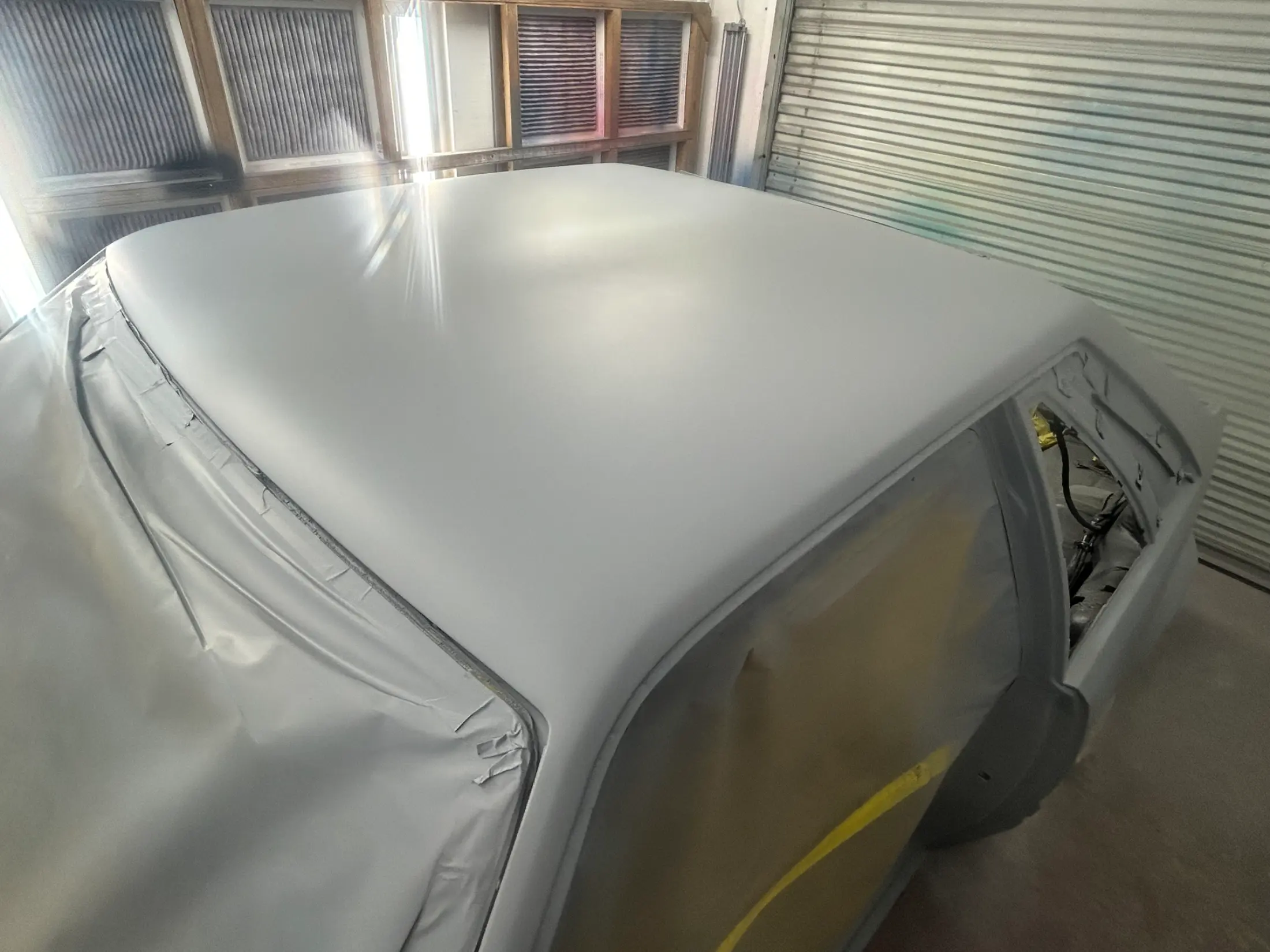

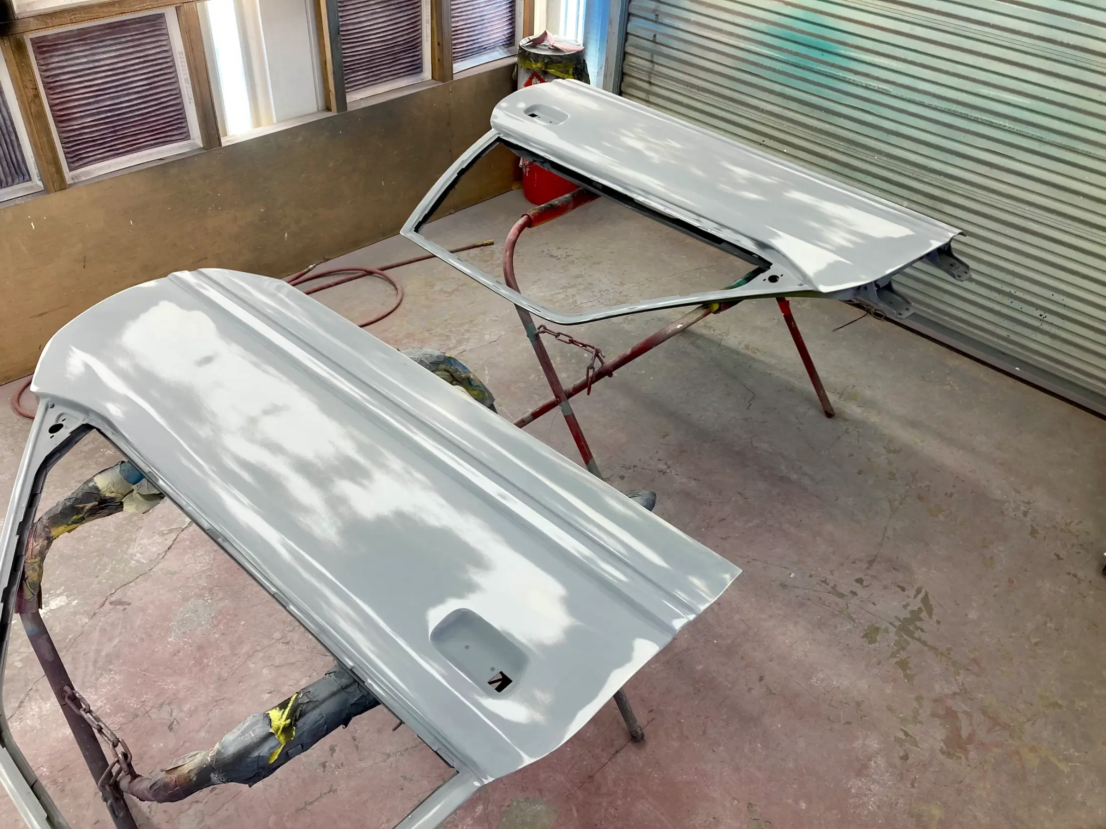

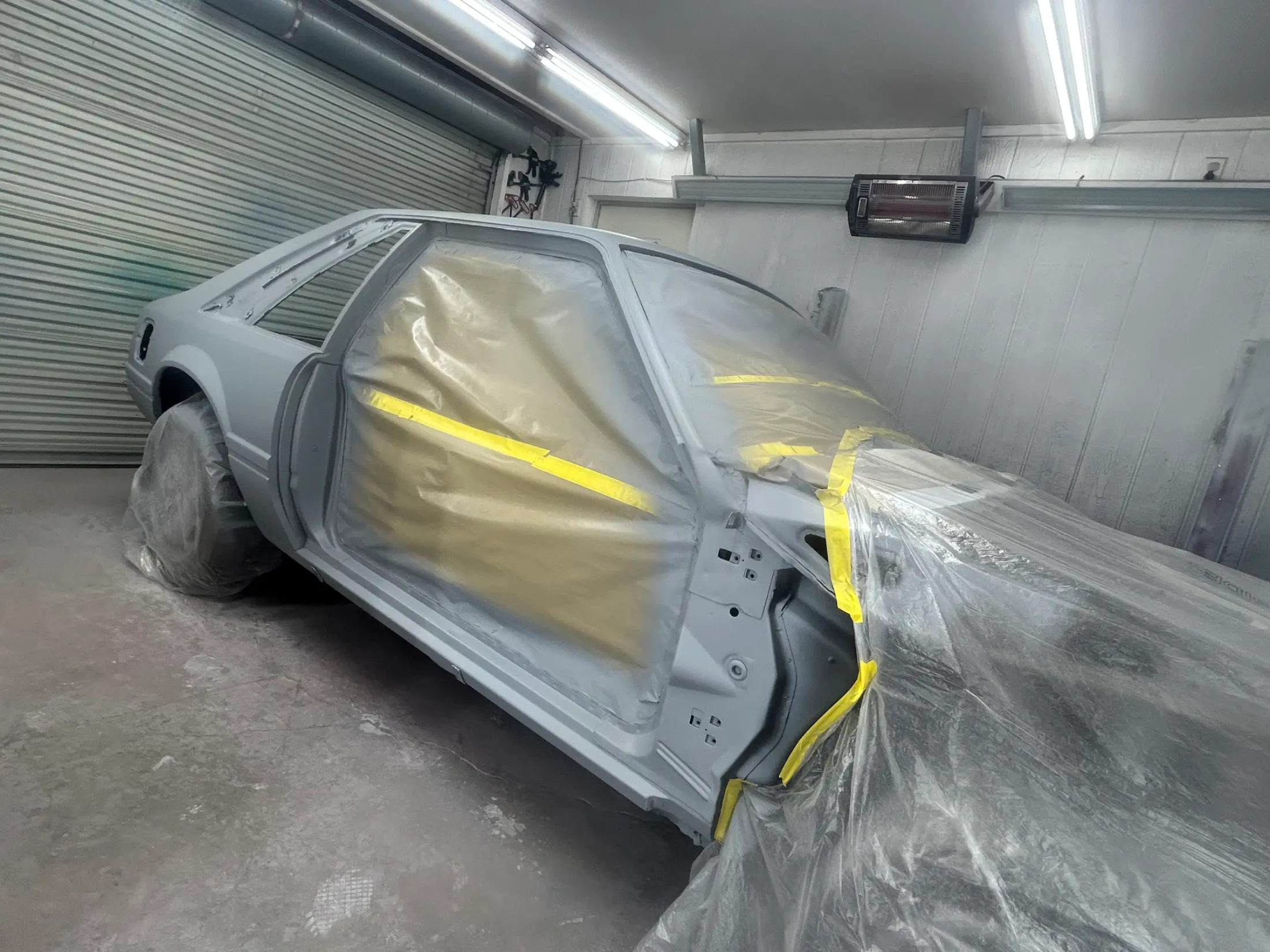

Possibly the last coats of primer for the SVO. Who am I kidding??. Its getting another gallon or 3….. Ha ha!

So now the six month hibernation.

AeroCoupe said:
So now the six 18 month hibernation.
FTFY
Reactions: AeroCoupe and 95steedamustang

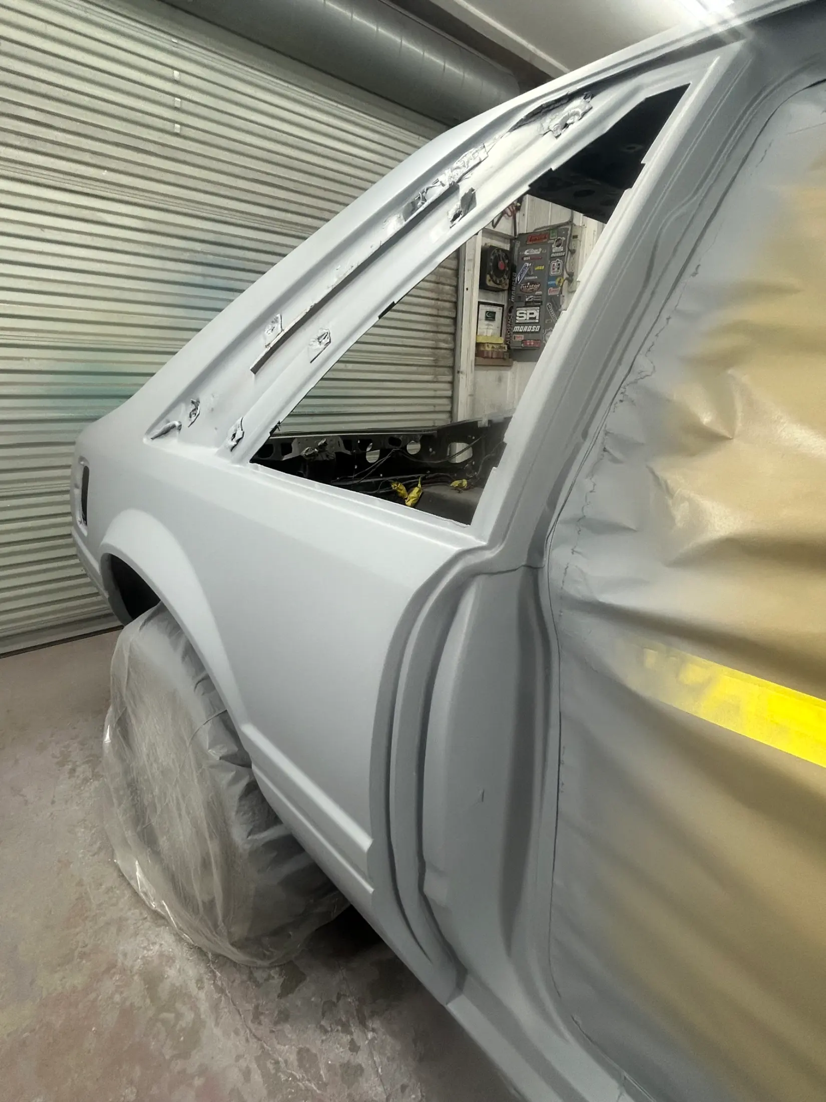

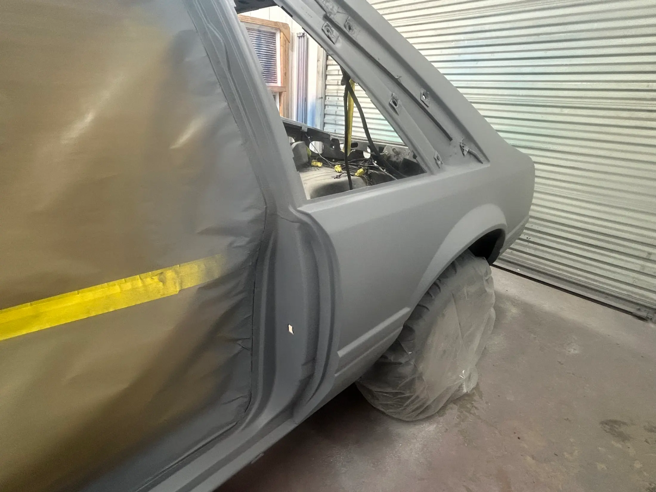

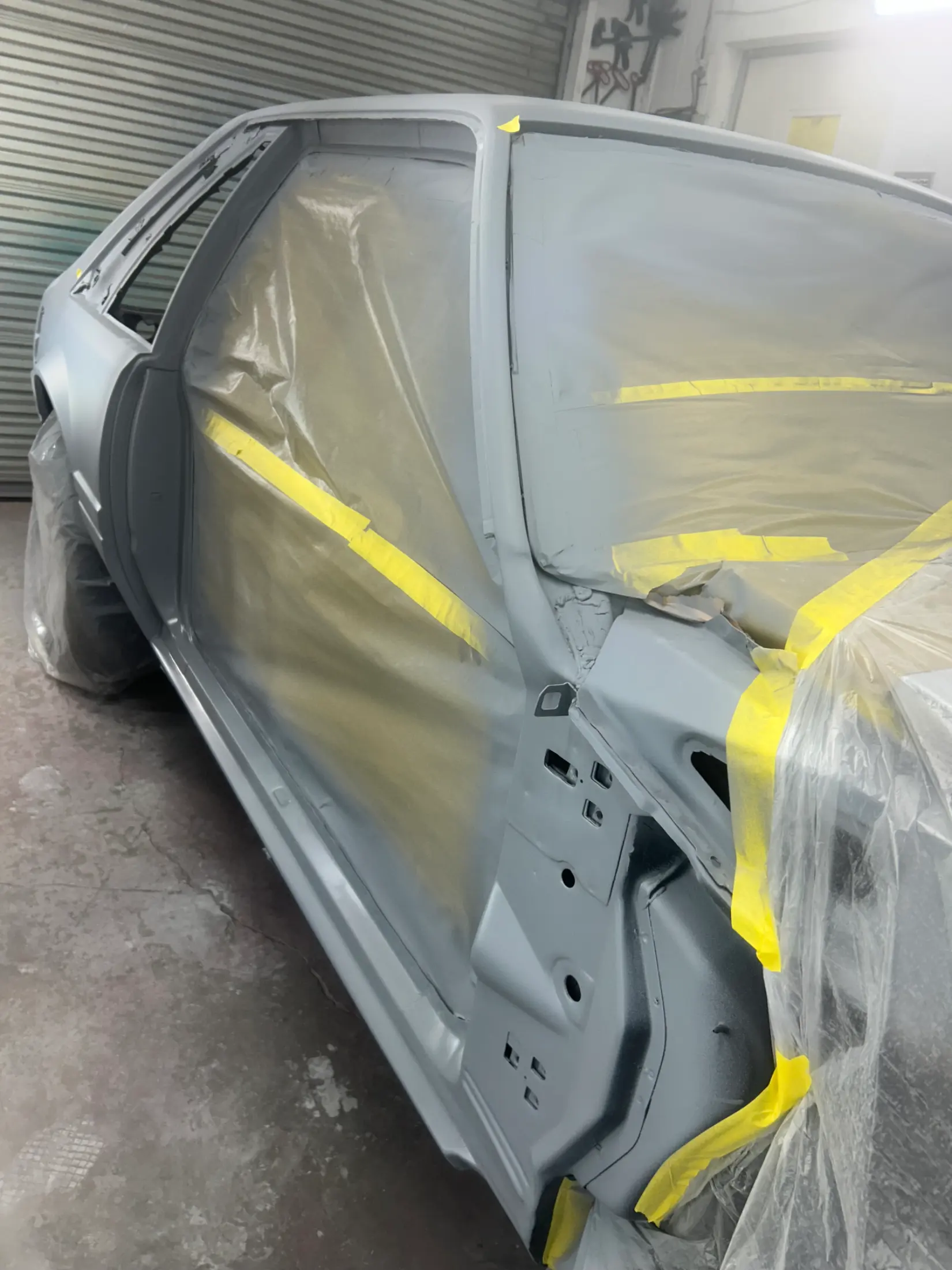

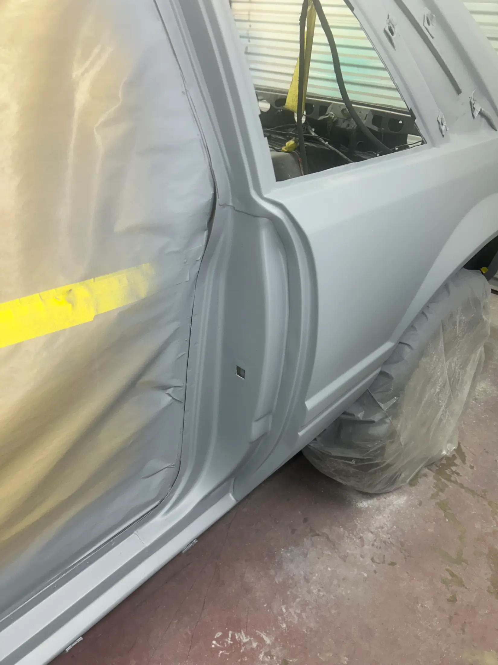

Think this is the 3rd priming for jambs
What is that curved piece that looks like it goes over the wheel well? Doesn't seem to belong on this group, or is that for the cobra?
Reactions: 85GT4V
SorsCode
20+ Year Stangneter
Jun 10, 2003
1,022
432
113
St. Louis, MO
Mar 15, 2026
#120
  • Mar 15, 2026
  • #120
It’s an SVO so it’s a fender flare.
