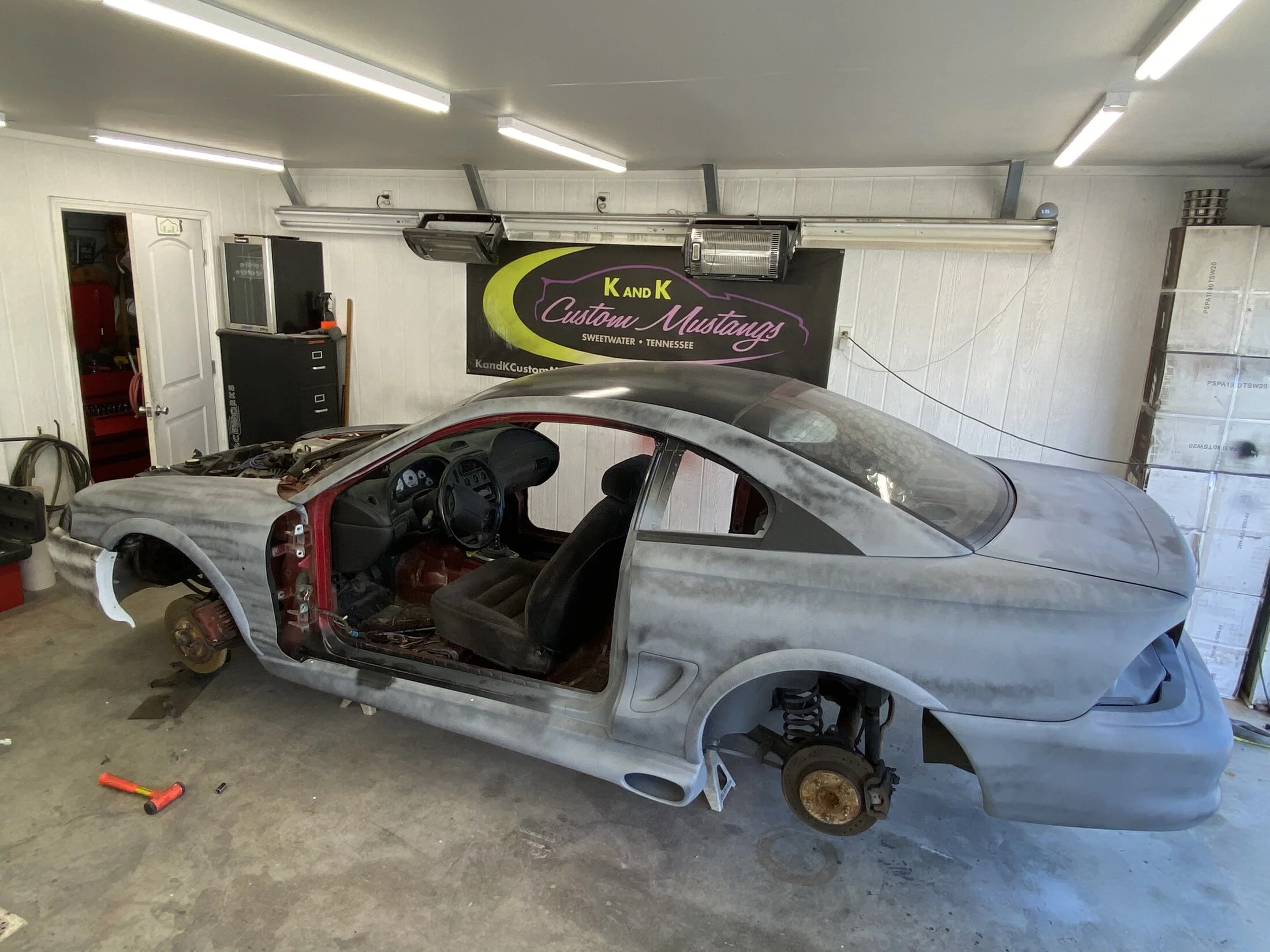

Epoxy time. And some 2k primer fir skirts.

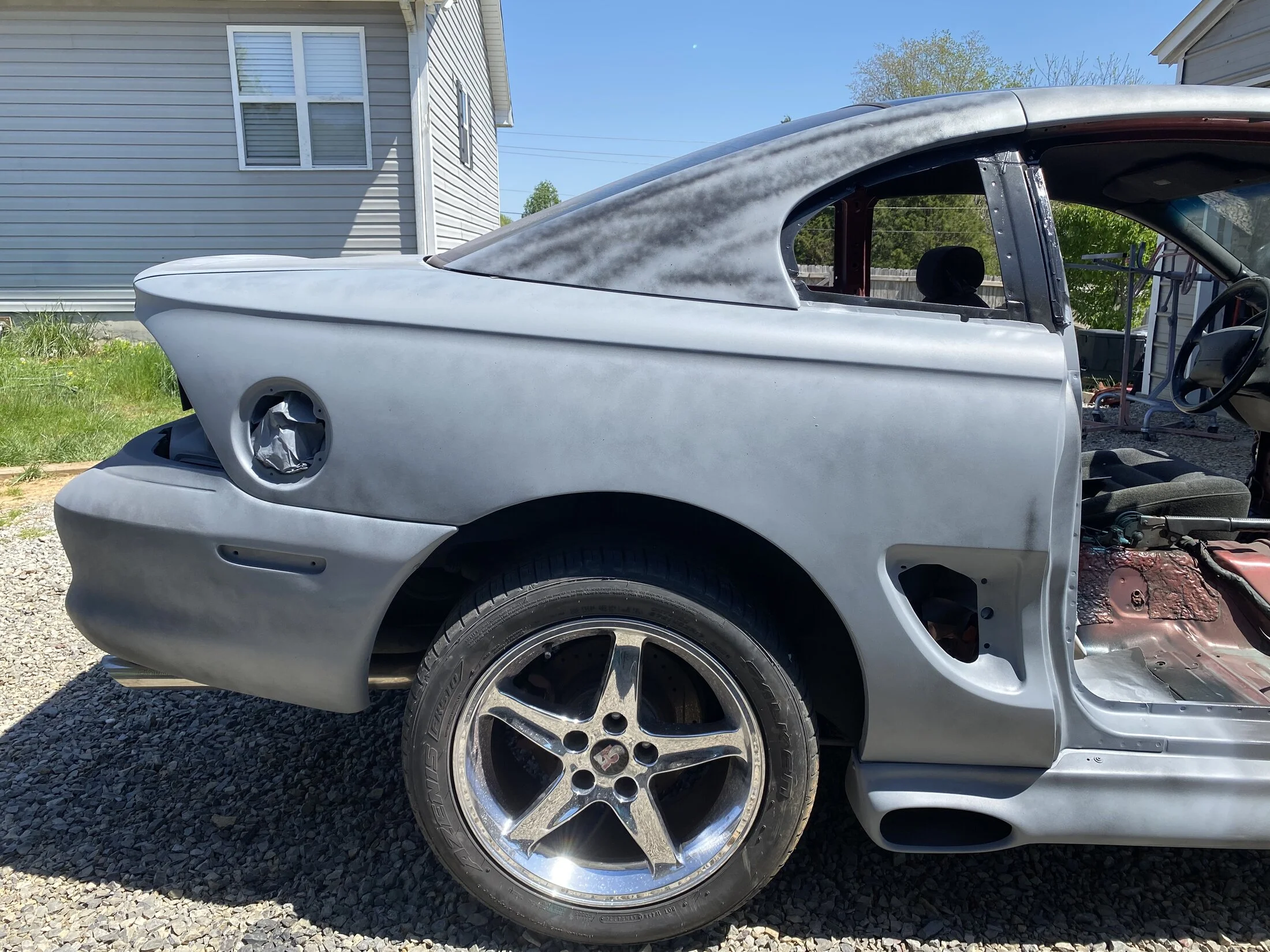

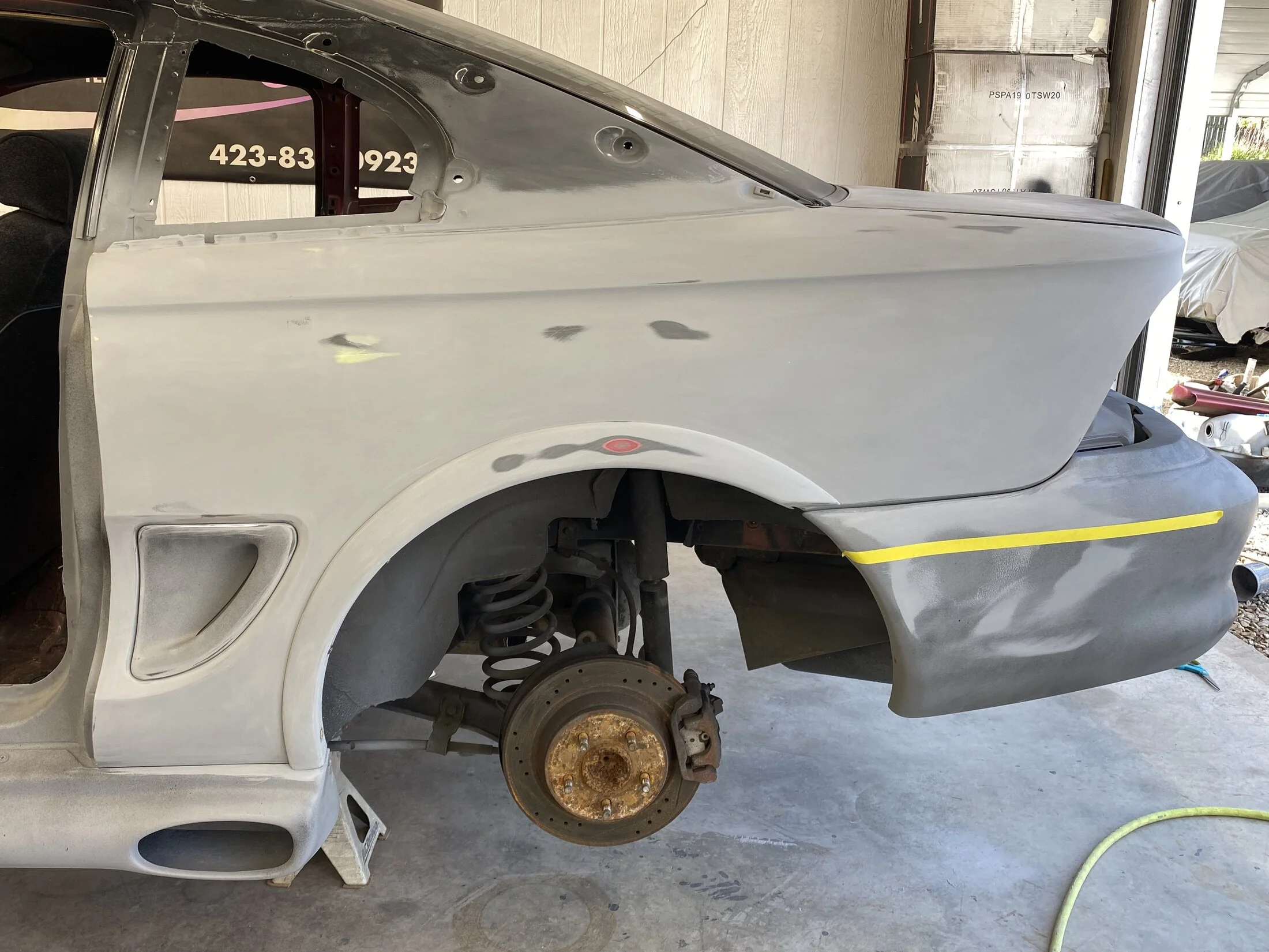

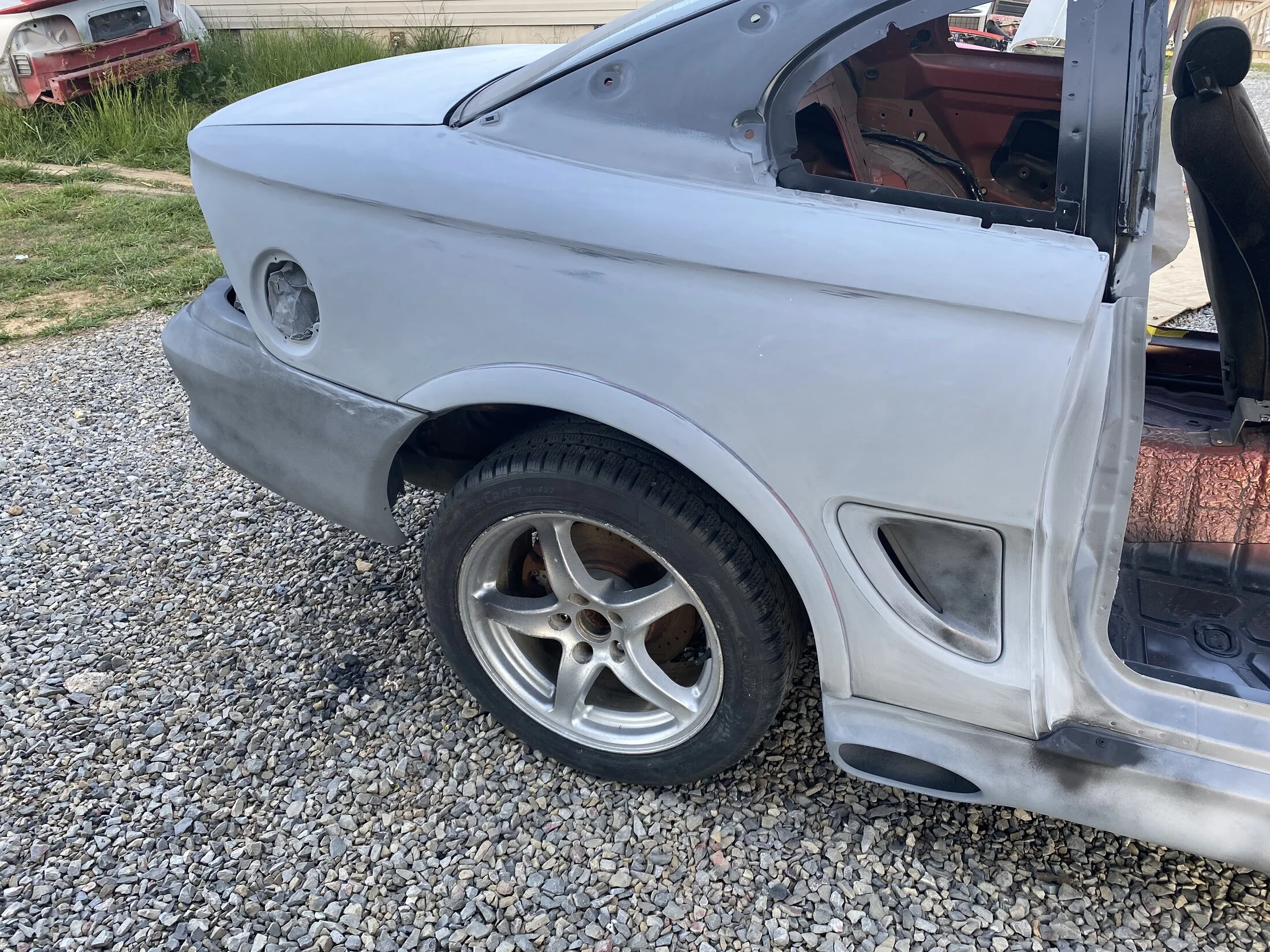

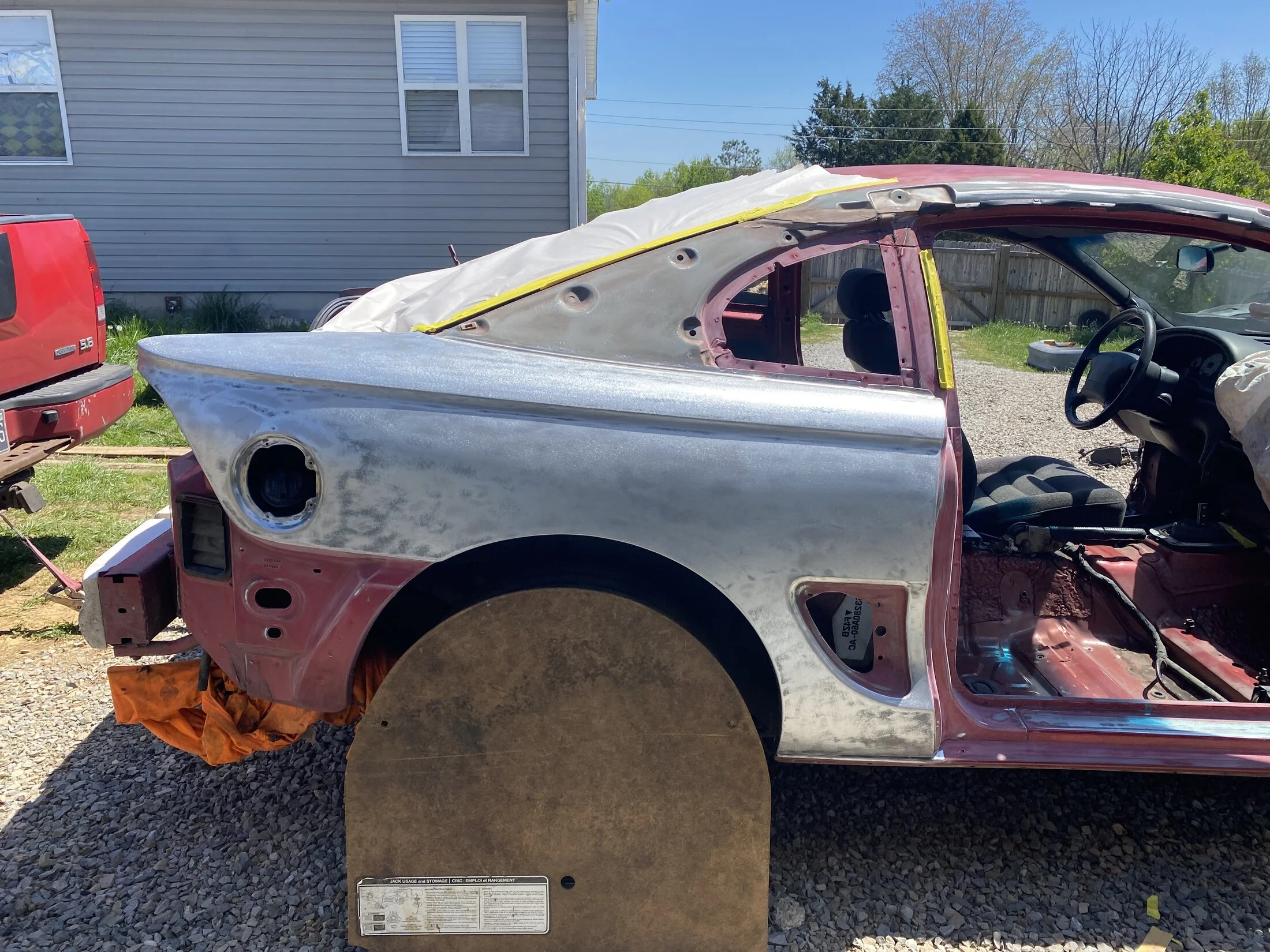

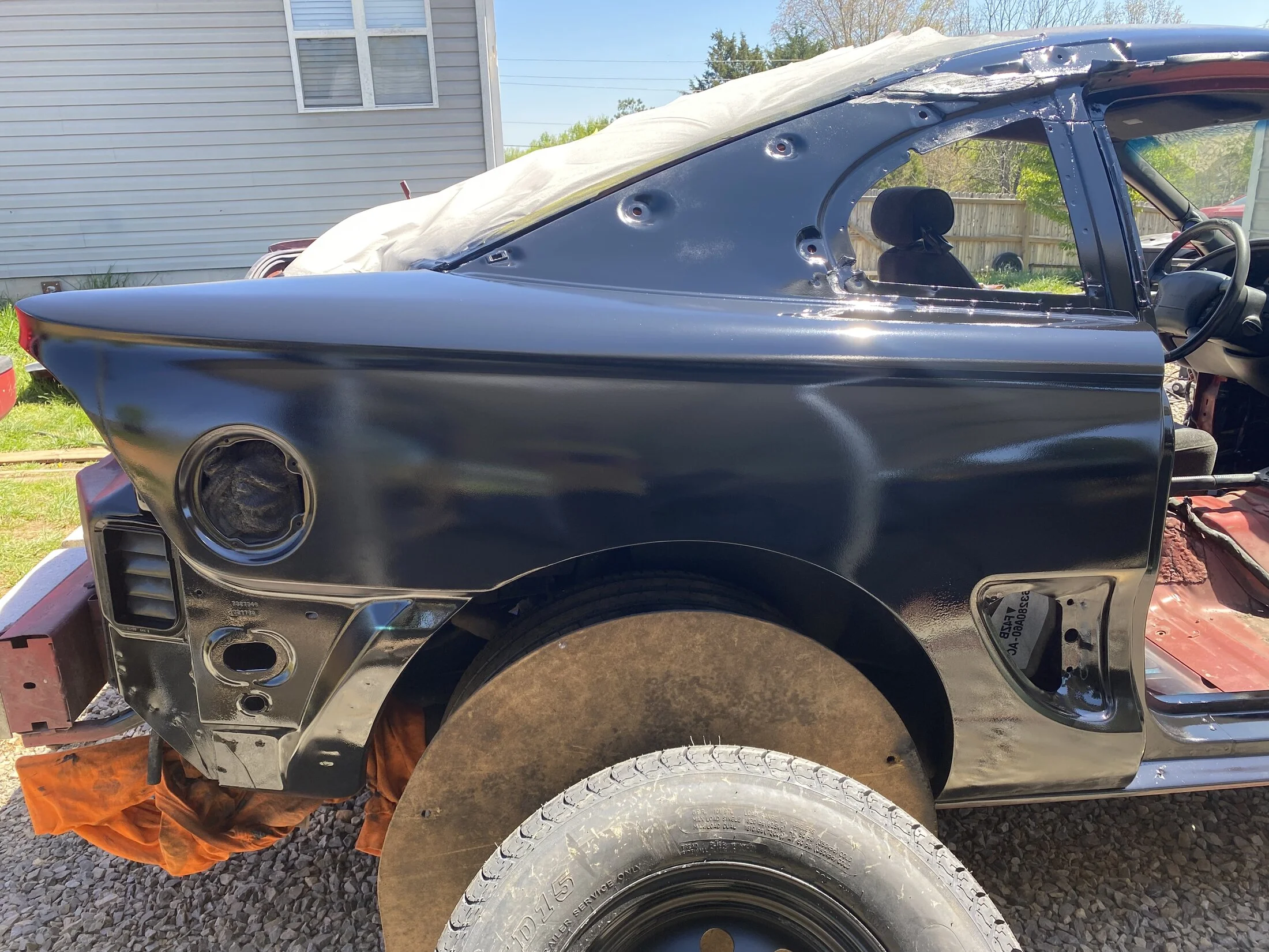

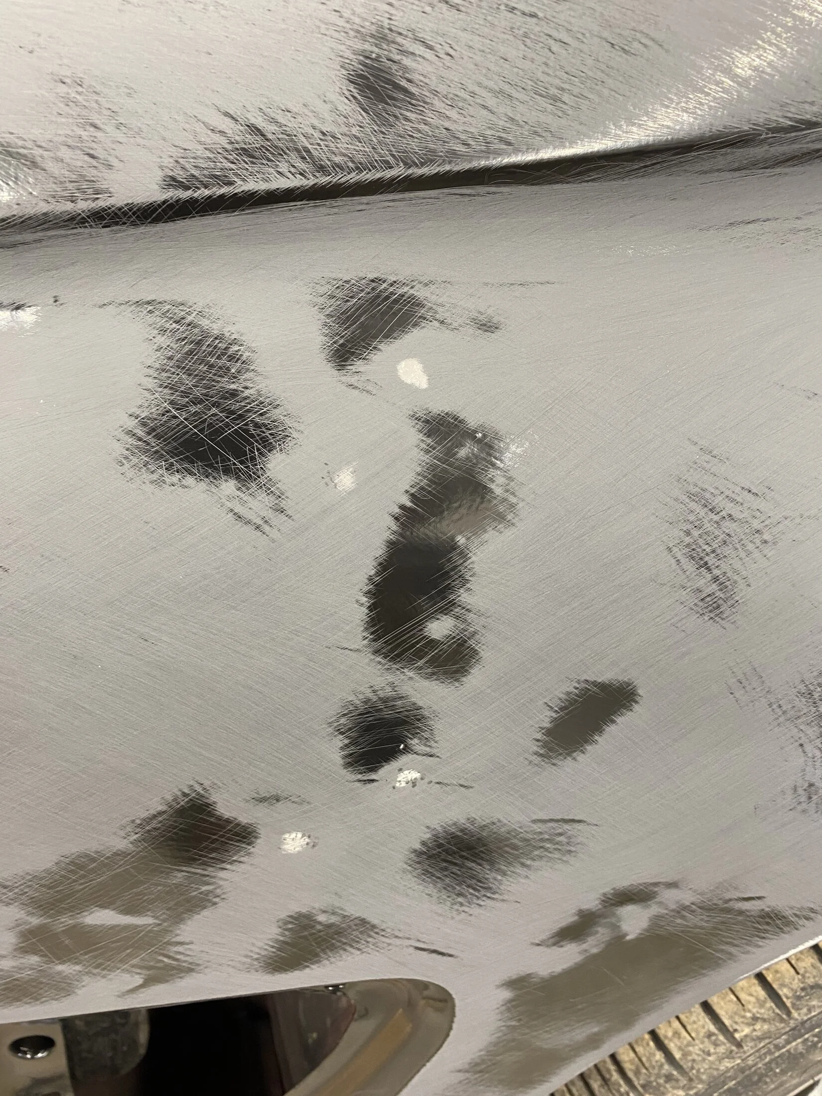

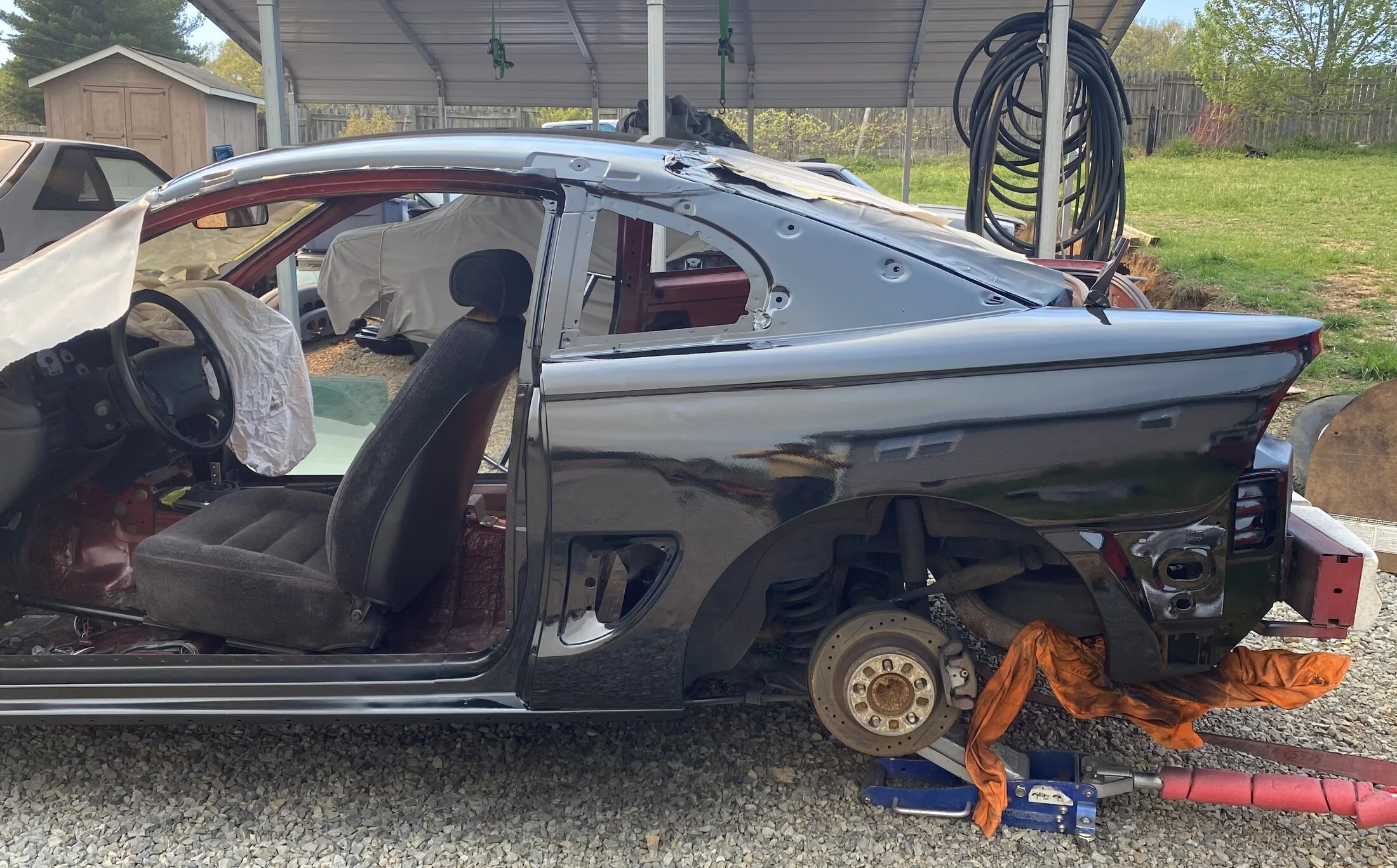

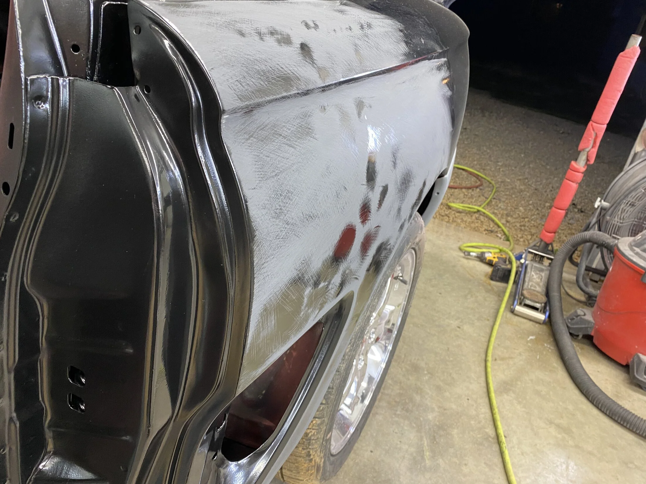

So here’s my metal work 101 for the day. The quarter on this car had 2 gallons of mudd I ground off to get to metal. They put it over bare metal so had some surface rust starting underneath. Anyway. Here’s how I attack a dented up quarter…

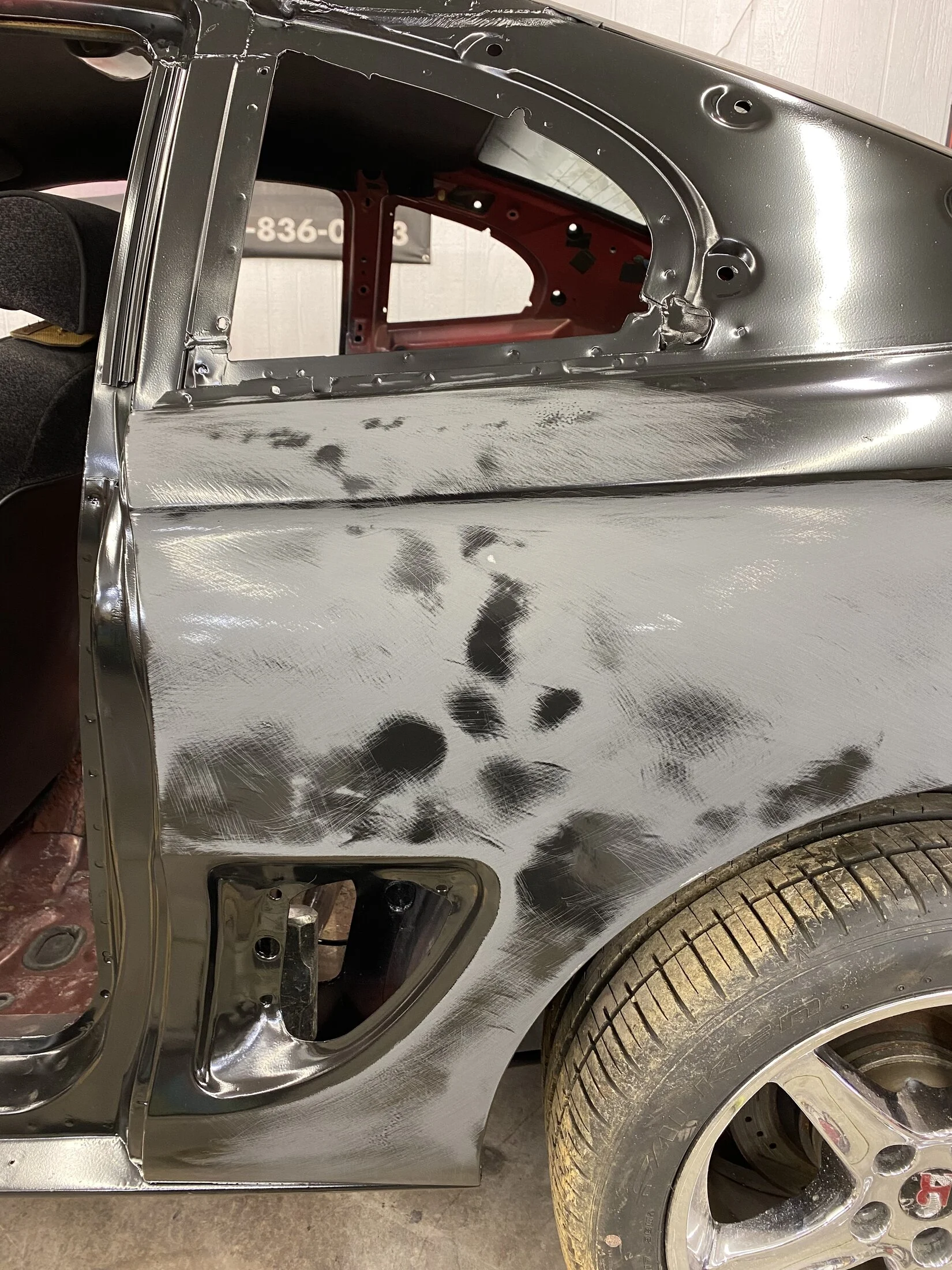

I pulled the damaged out as good as I could before epoxy the put 3 coats down. Let cure out. Then take my block and start revealing the remaining low spots and any highs. The low will be shiny because the block is not touching them. Then just start working those areas with a body hammer and dolley slowing getting the lows level while tapping down any highs. All this resulting in only a thin coat of filler to block out.
@95steedamustang I get places do it the cheap way to get the car in and out quick but it isn’t crazy time to do it right.
It actually take me less time to work the metal but more patience…then speading a gallon of bondo and working that down. I think patience may be the issue…or maybe no skill with metal

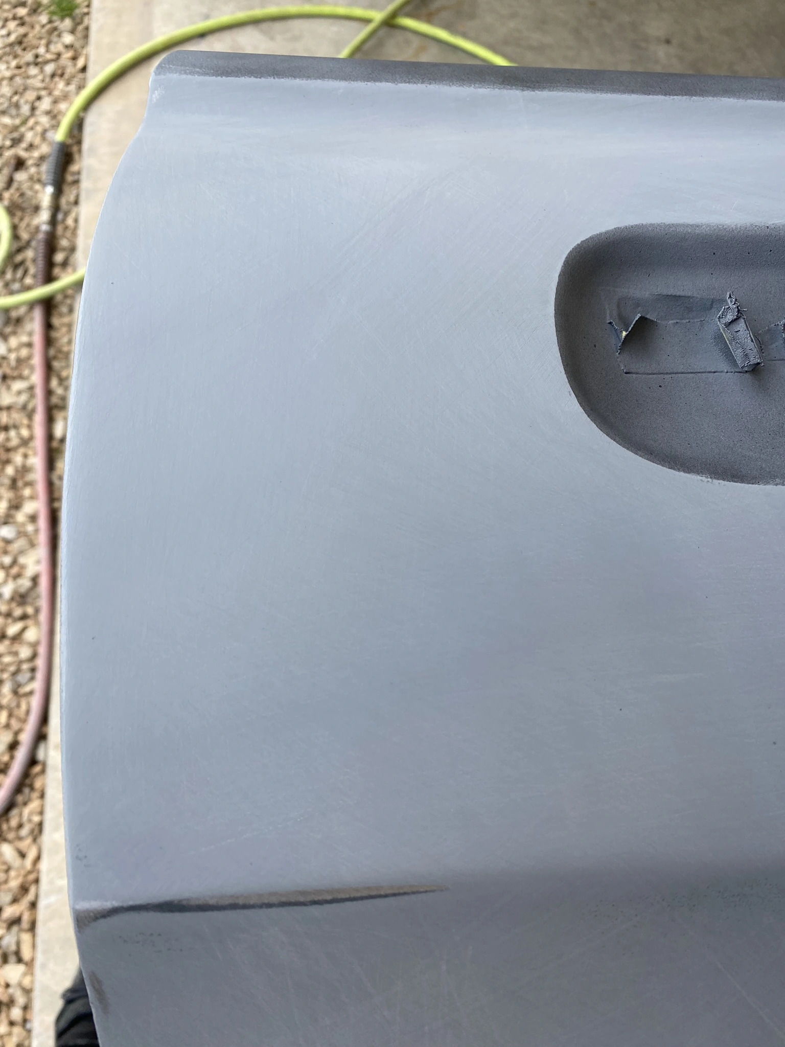

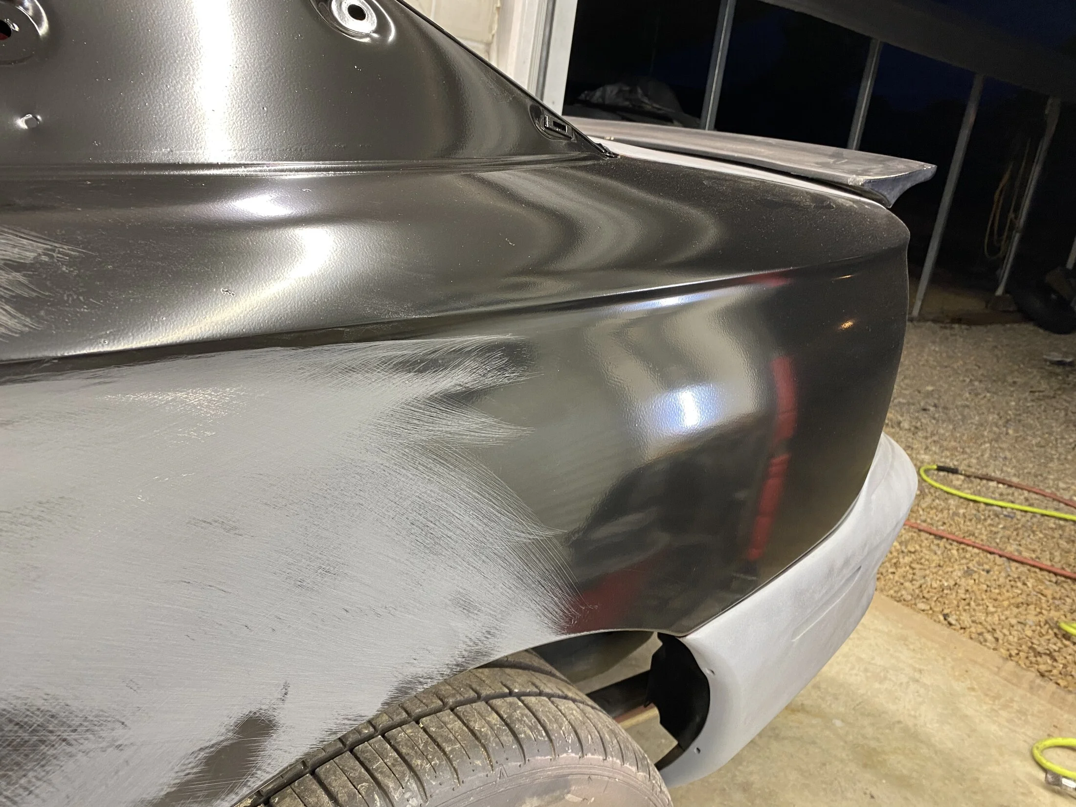

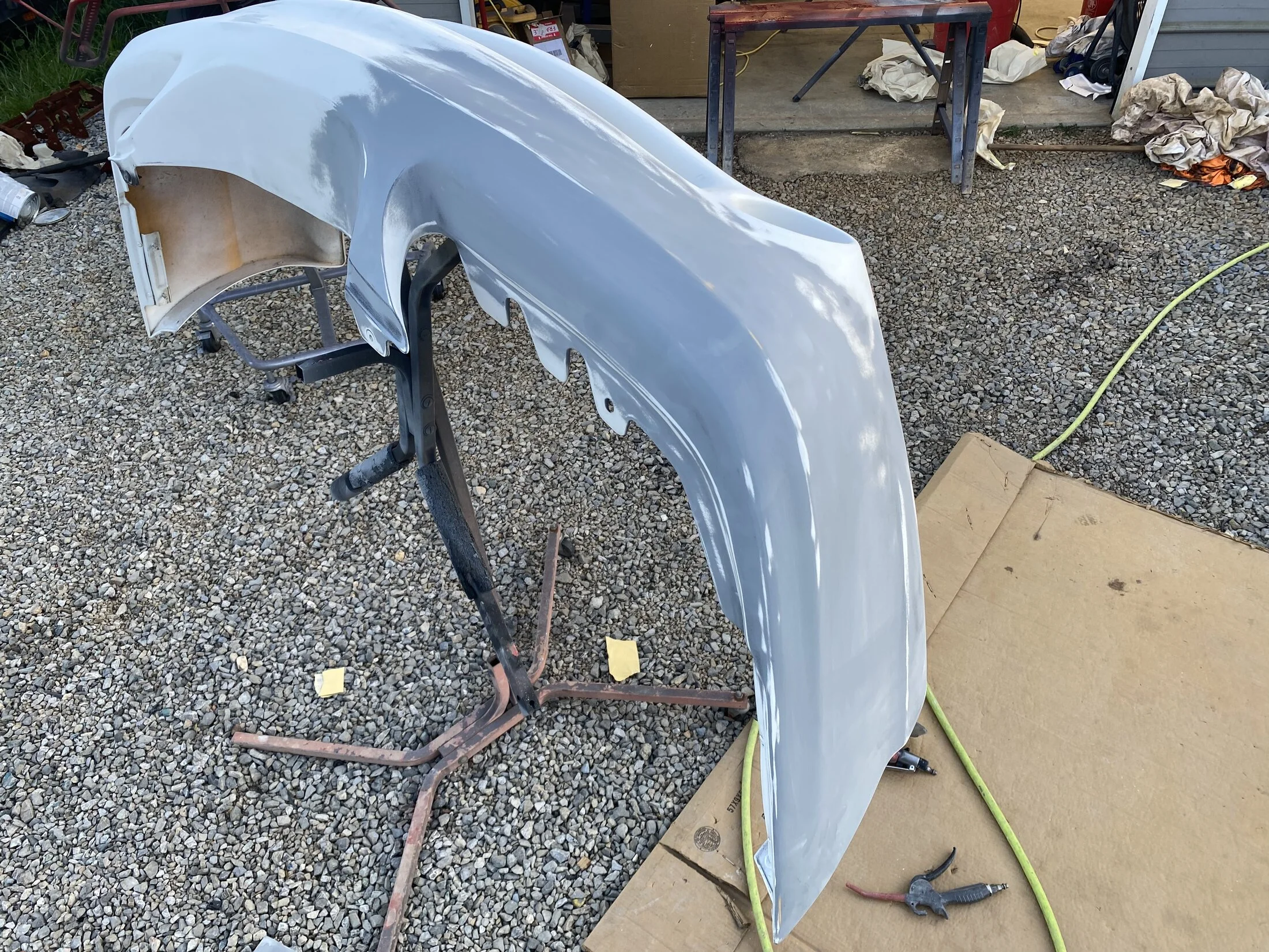

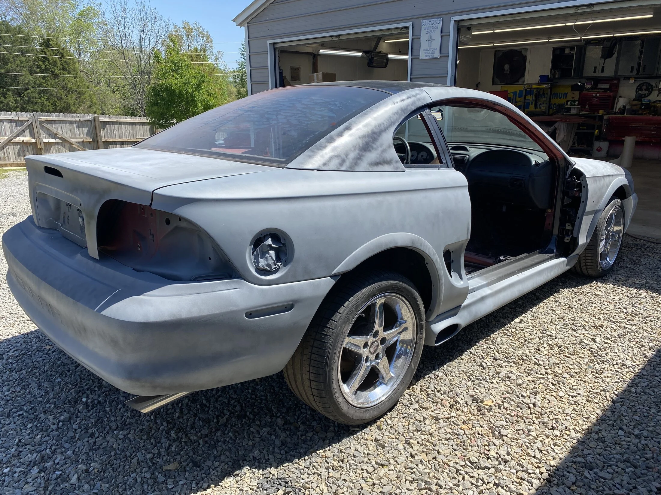

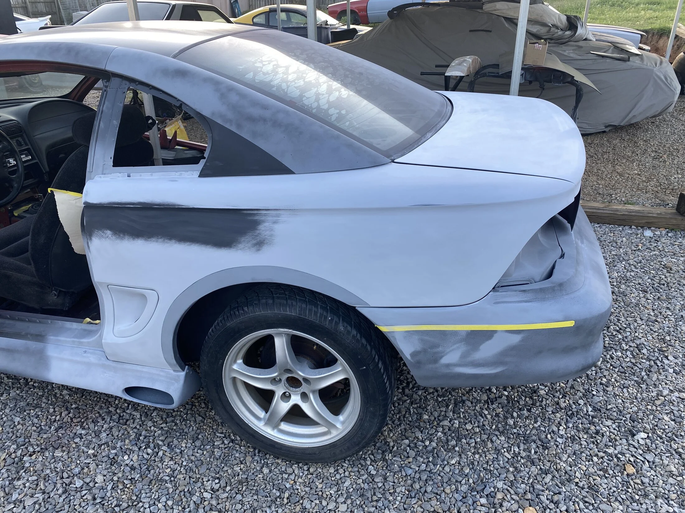

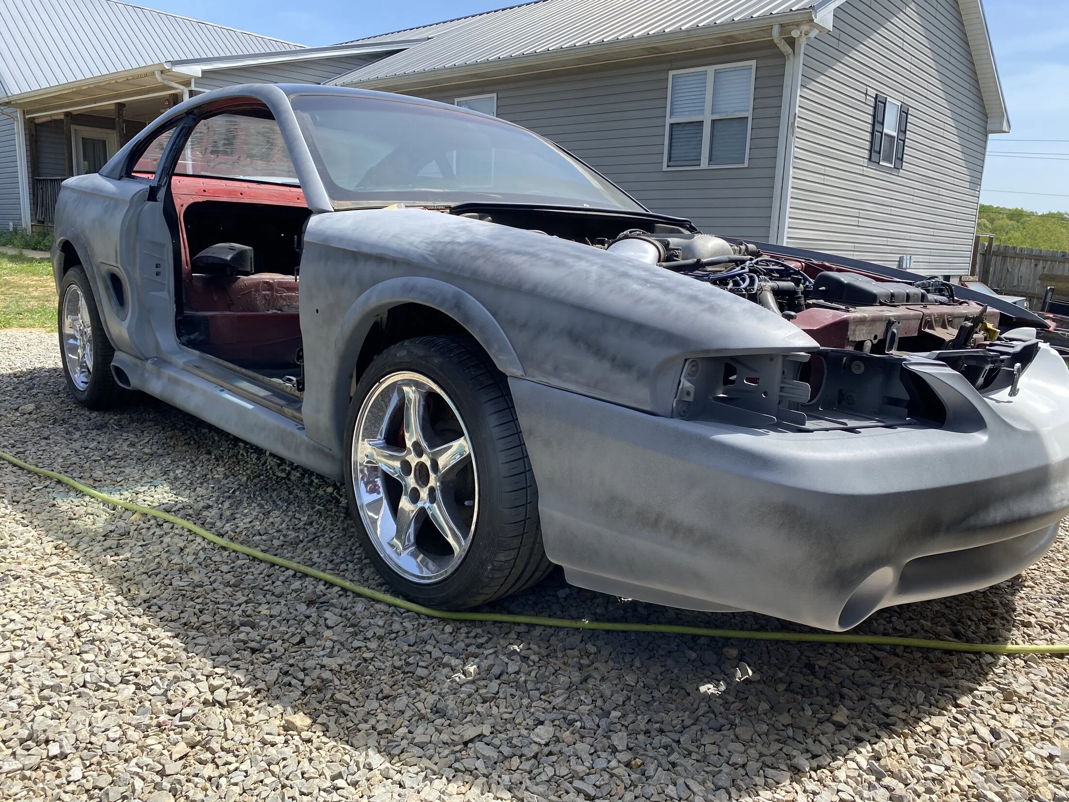

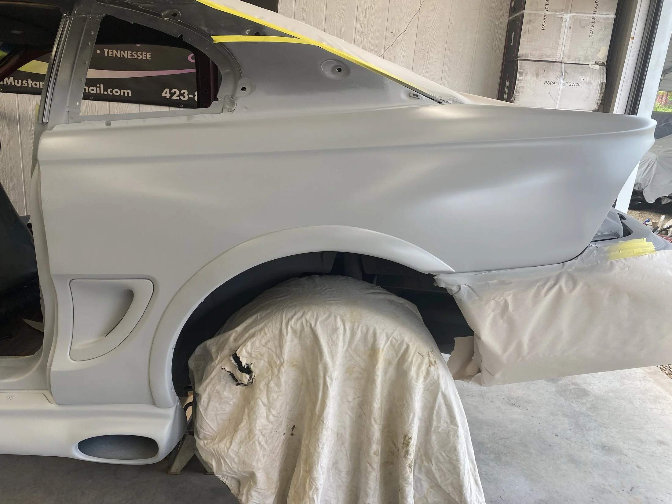

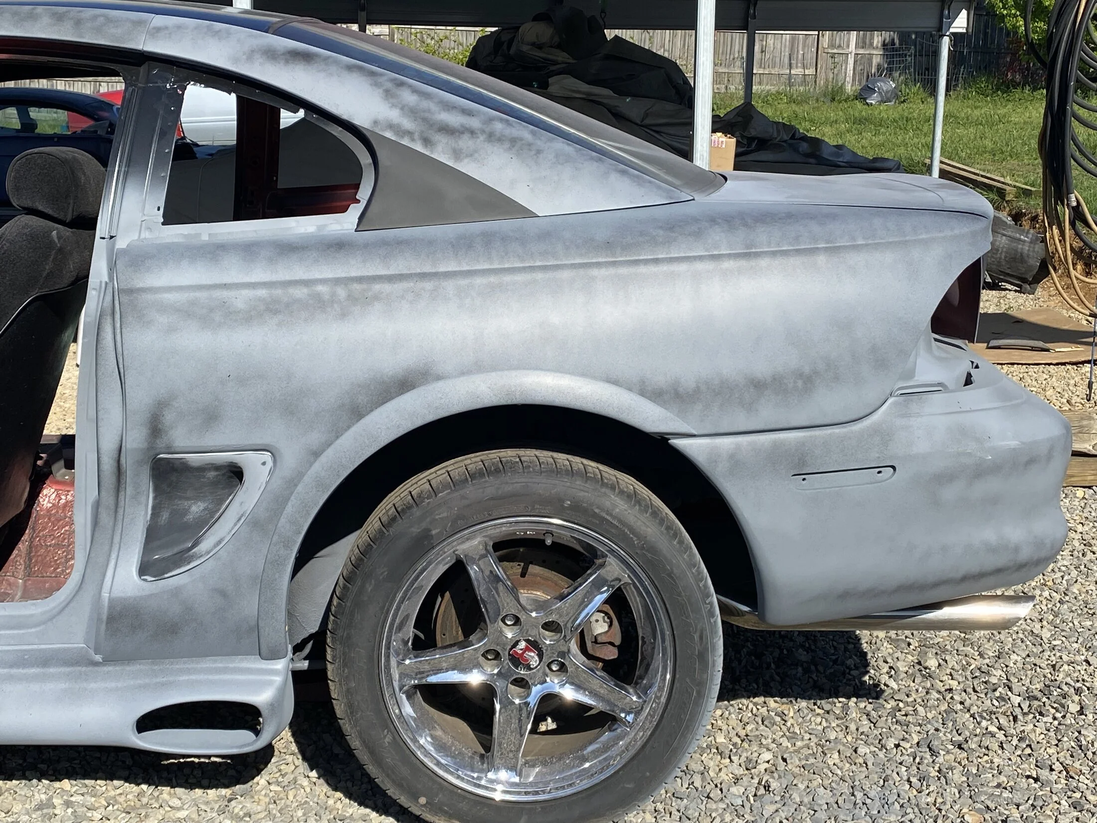

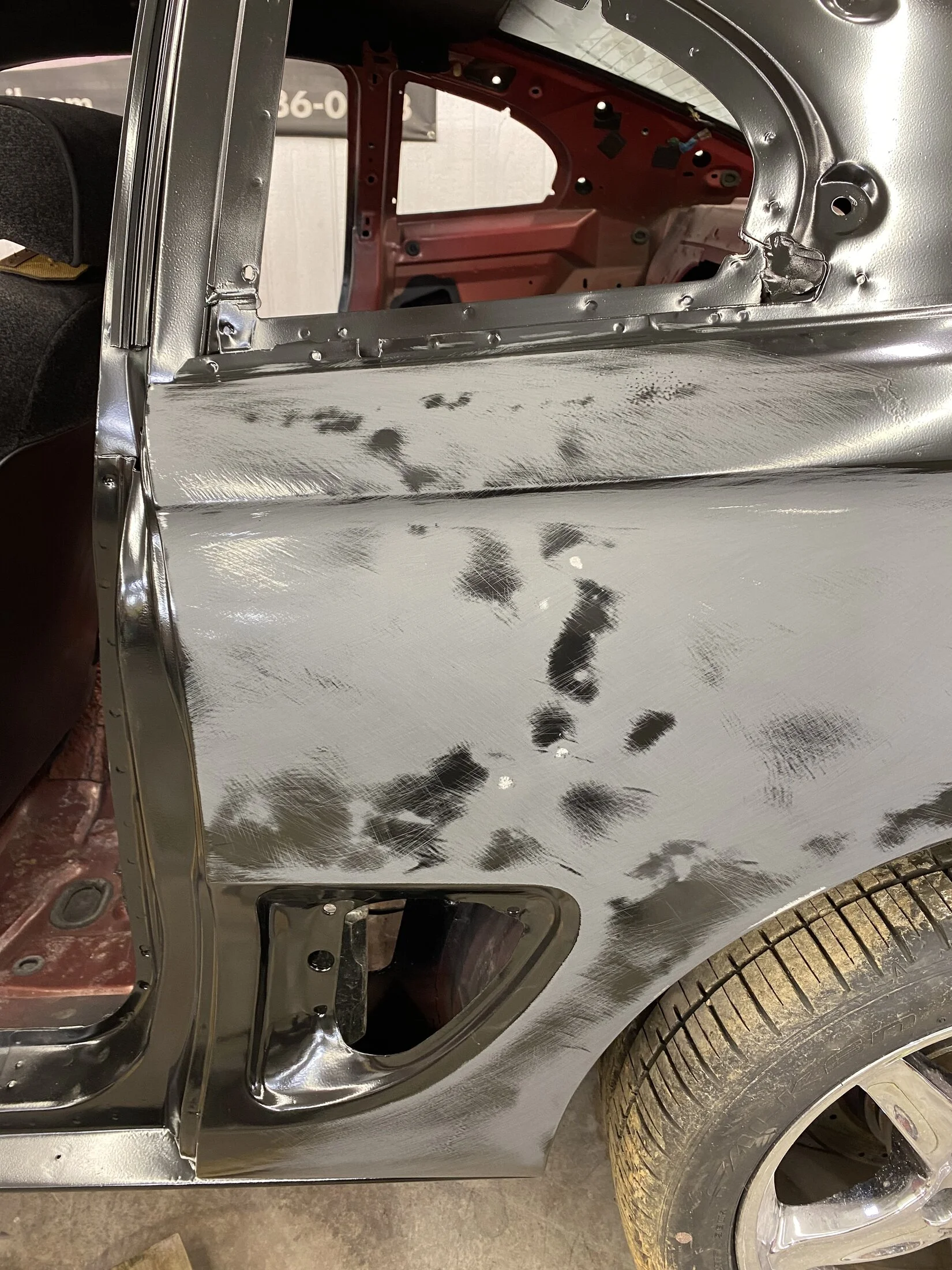

Got the quarter in shape. After 5 coats primer. Blocked it down and only a couple highs and lows to deal with. Your over eager body guy would throw the bondo on but I just block it as far as I can and am doing 5 coats. The thing with filler is you can only cut it with 40/80 or maybe 120 and it actually straighten. Anything higher and your just polishing. But those grits leave sand scratches and you fighting those and they like to reappear so I primer and block that with 180 and 220. No sand scratches and it cuts primer perfect.

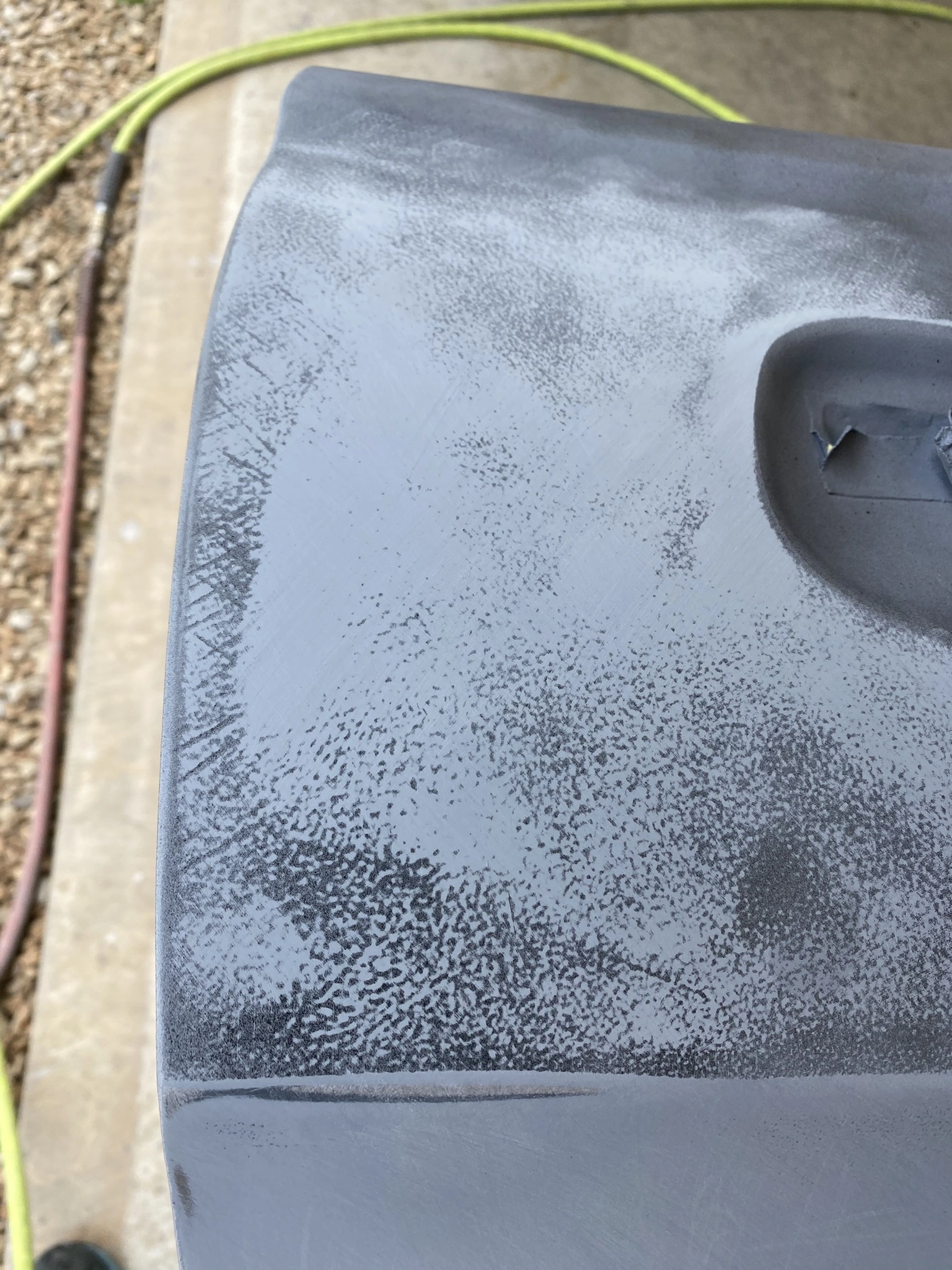

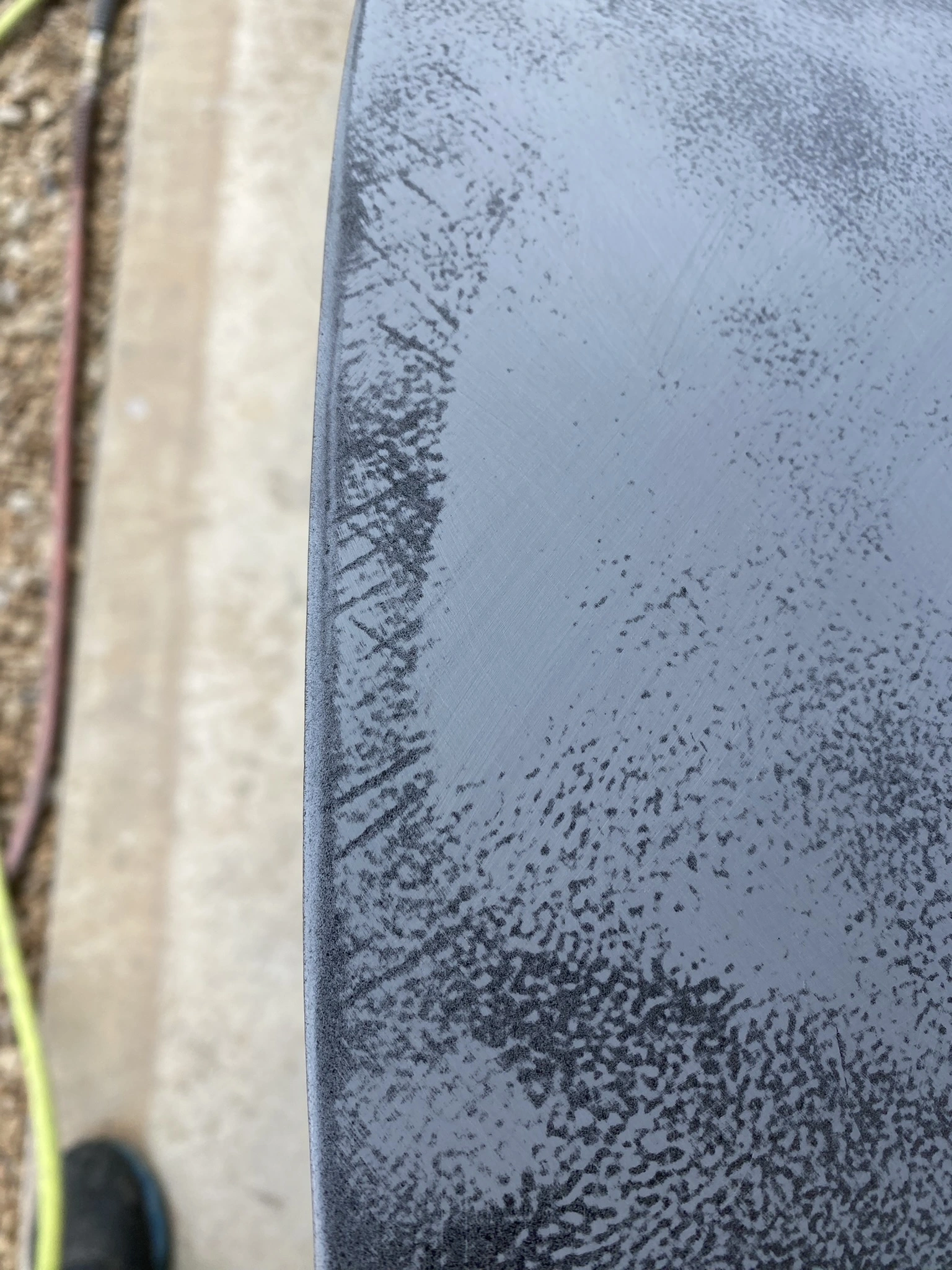

“3-6 months cure time seems excessive. What is shrinkage anyway?”
Well…here it is on a panel that has sat and cured. If this was painted you would see this under your paint. And a total redo in order. But I just block it out and reprime.

Yep. I've seen that pattern before. :)
I'm certain I have samples of it laying around :chin
