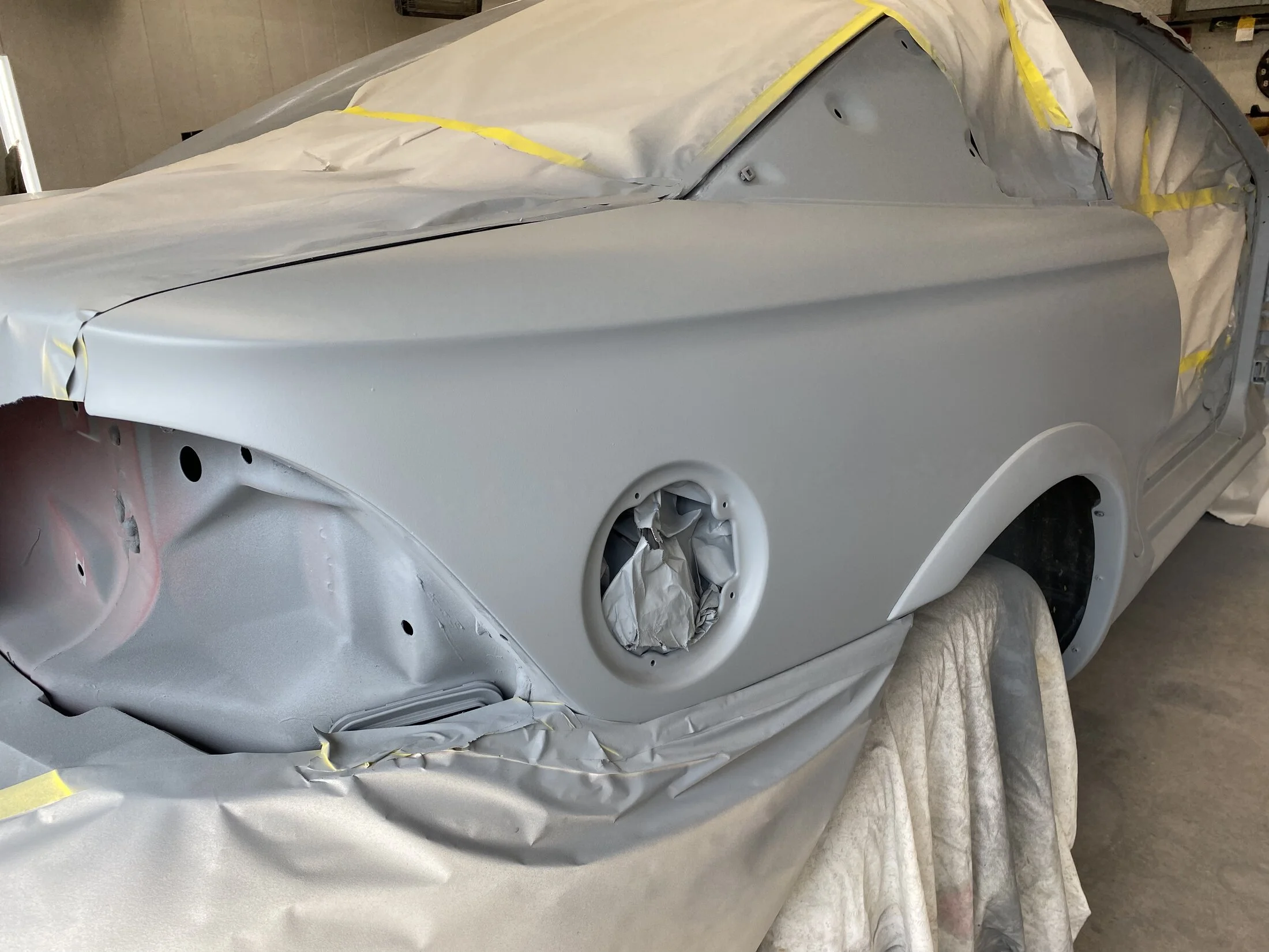

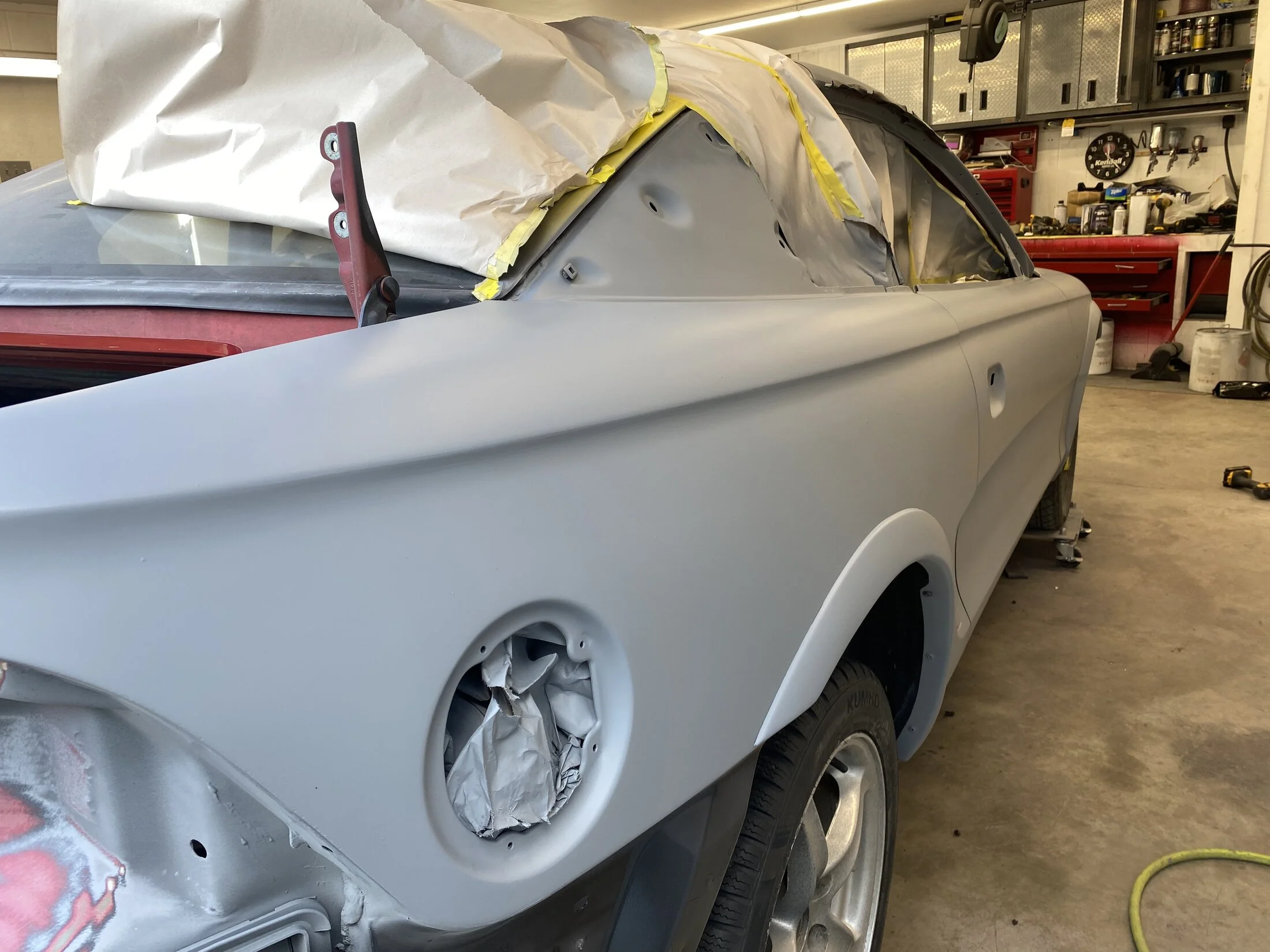

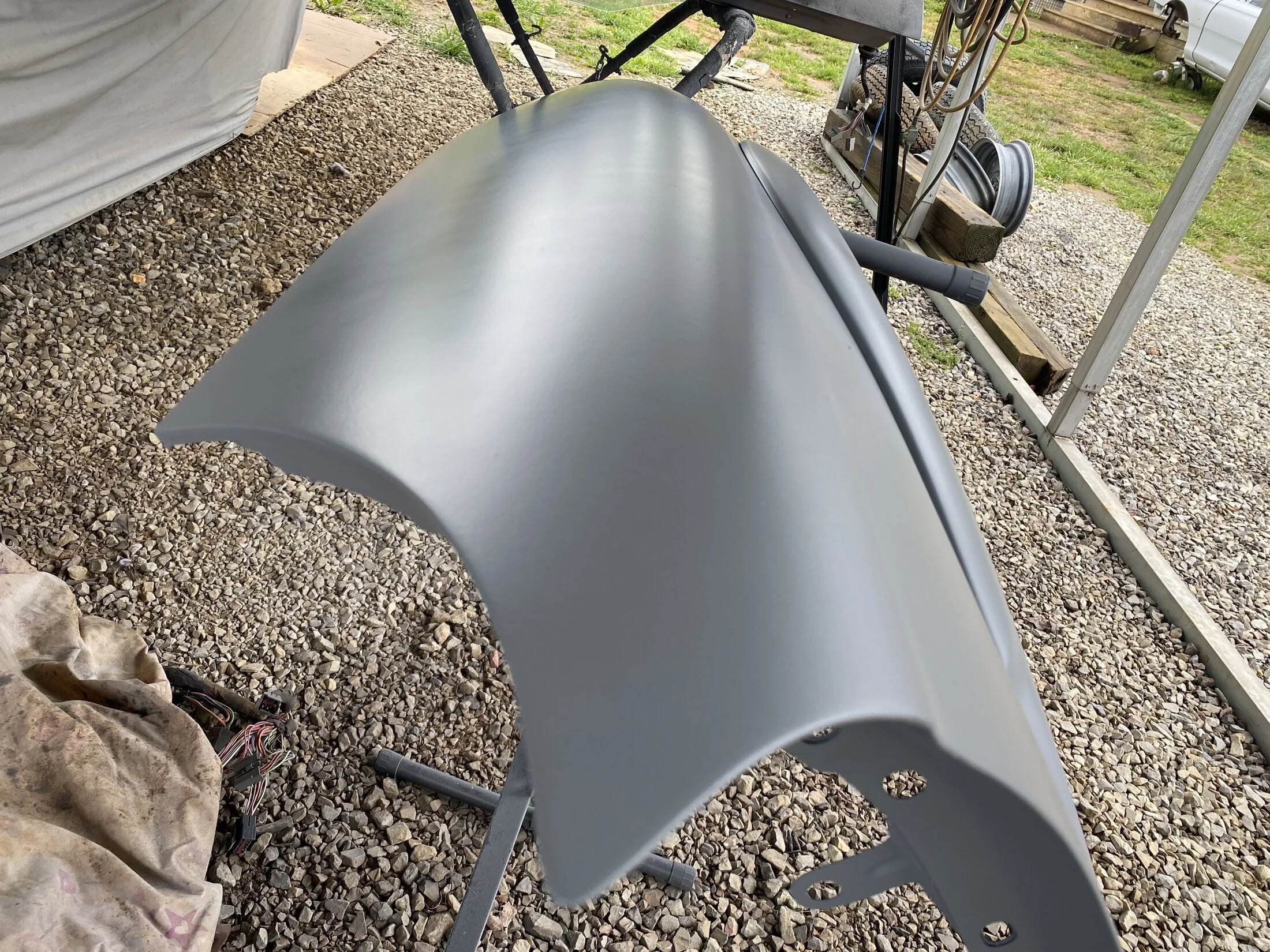

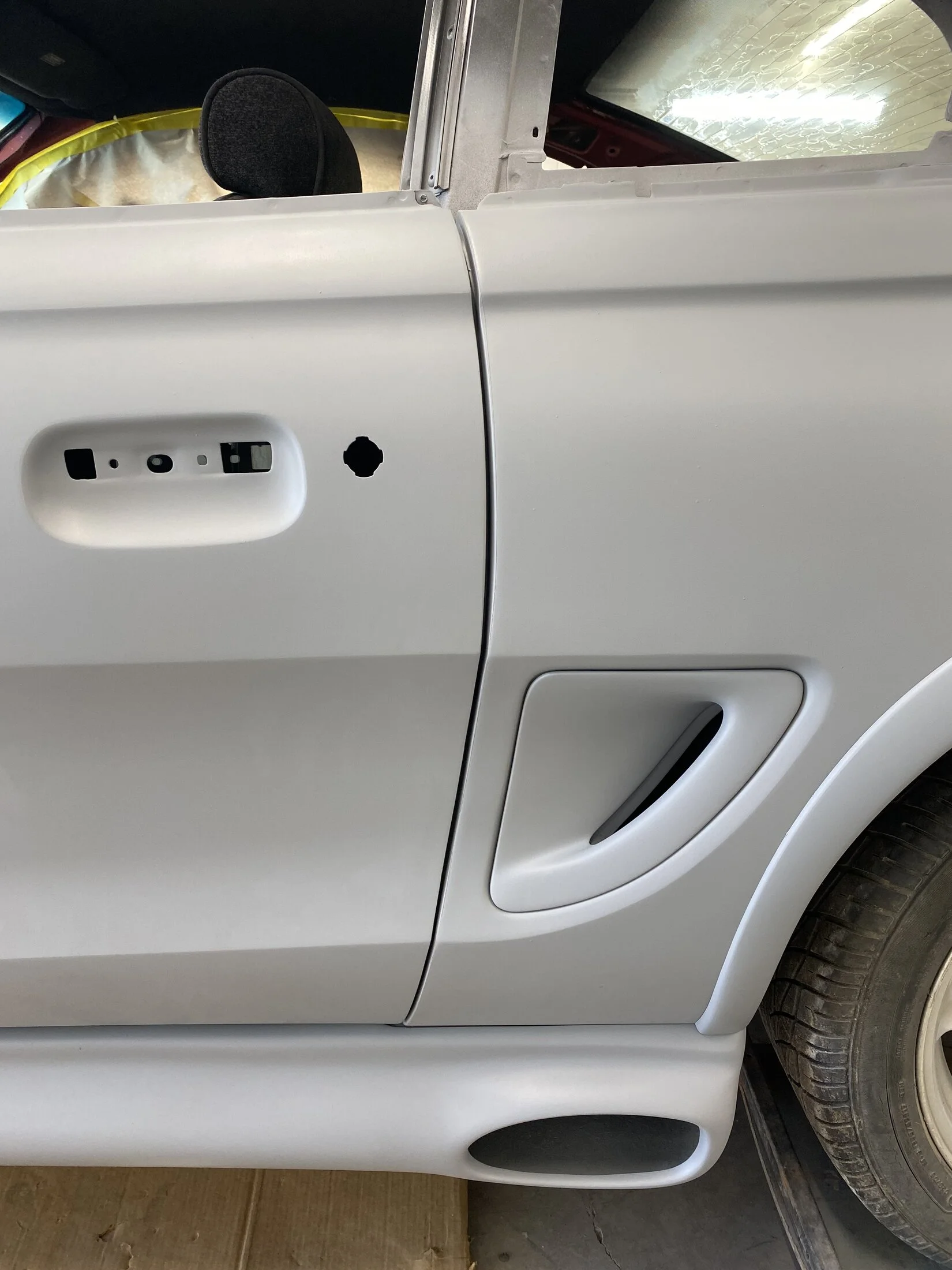

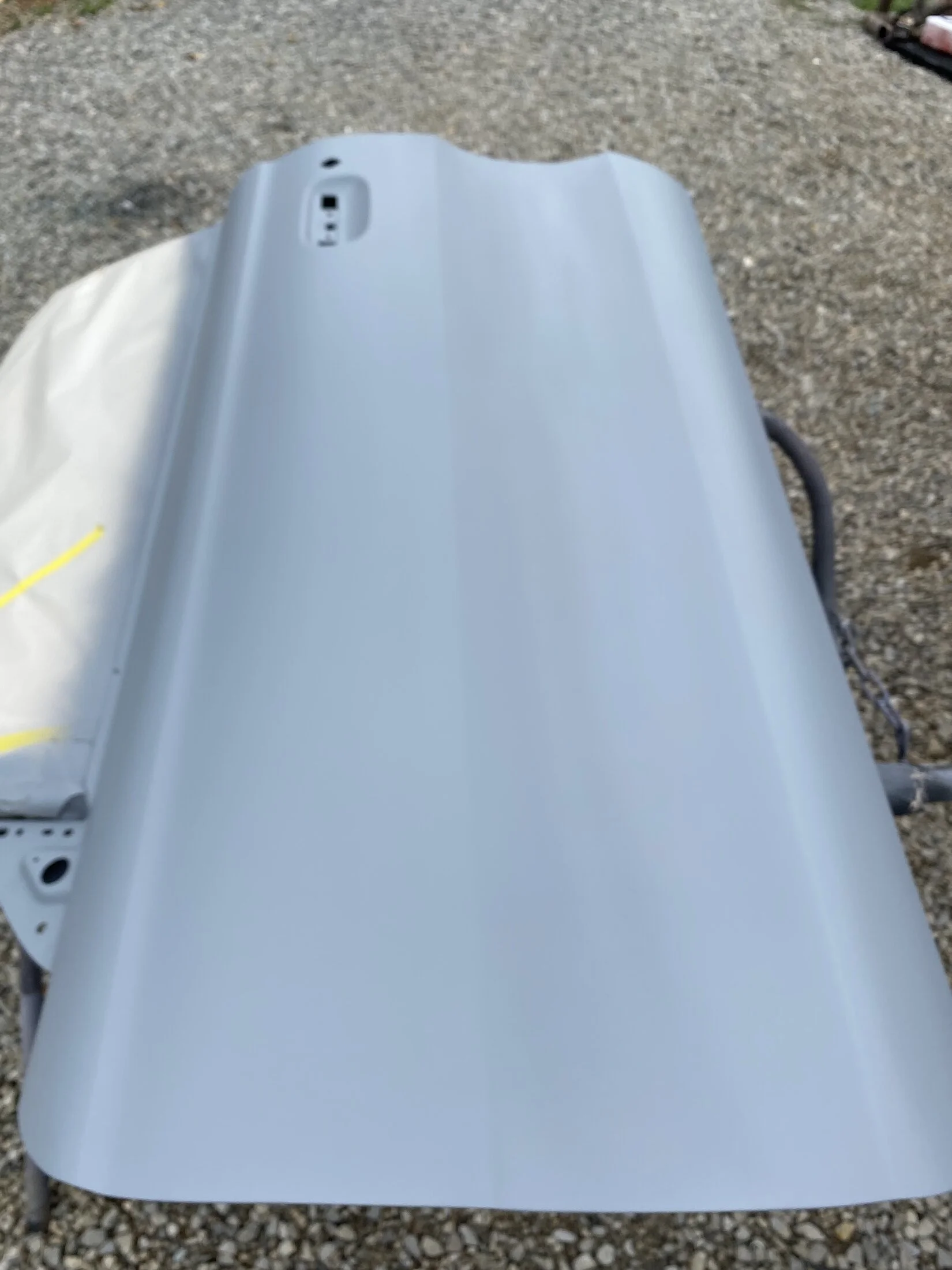

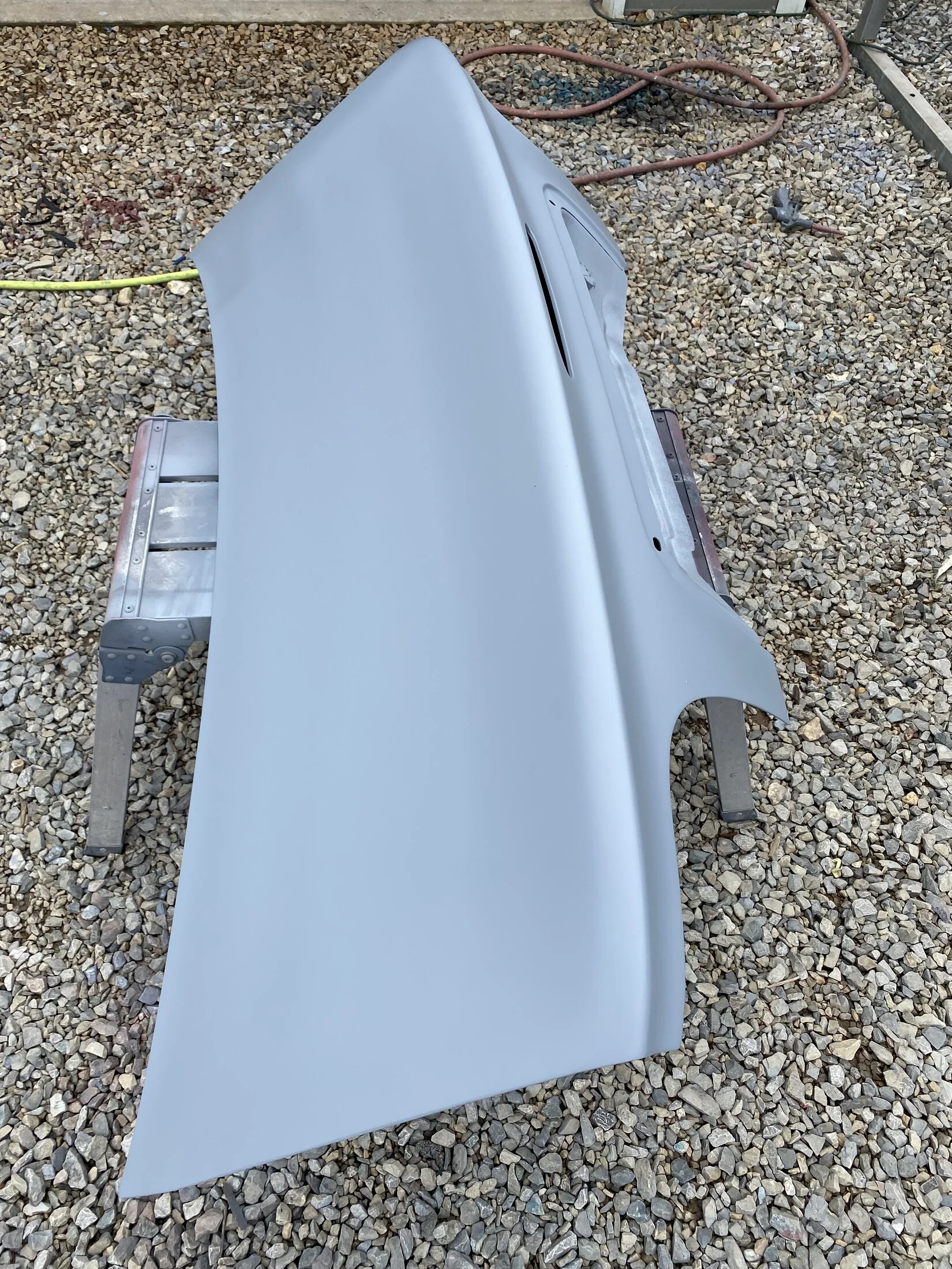

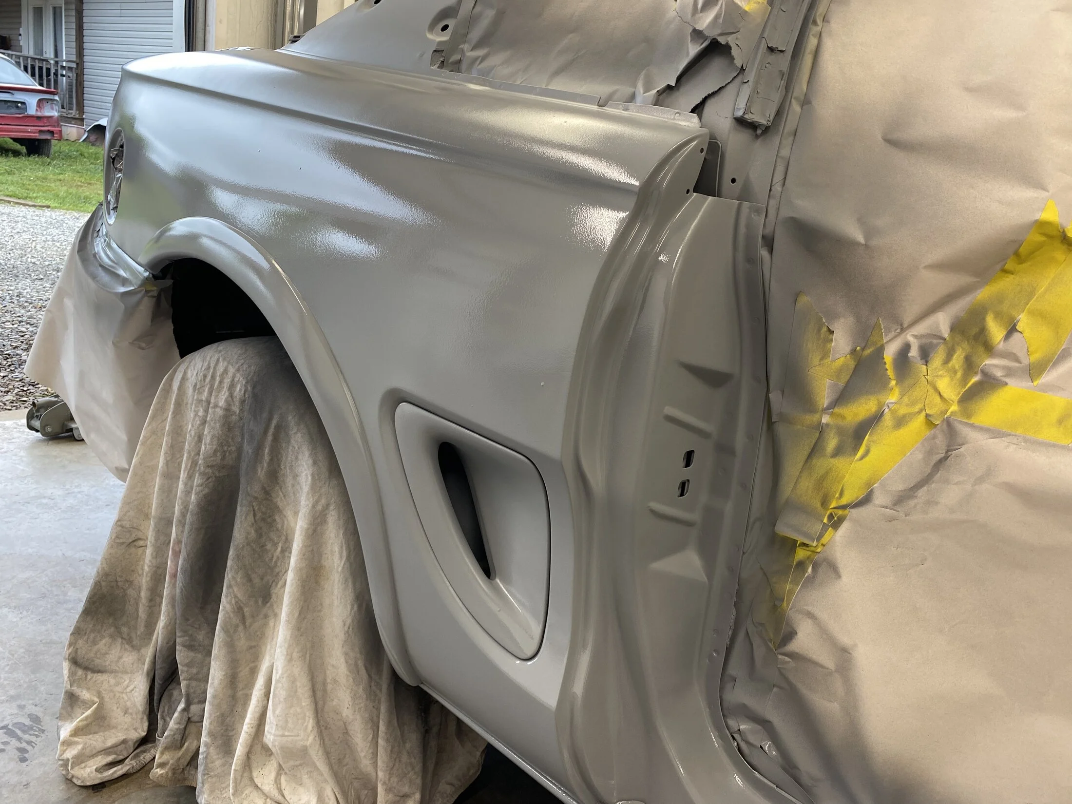

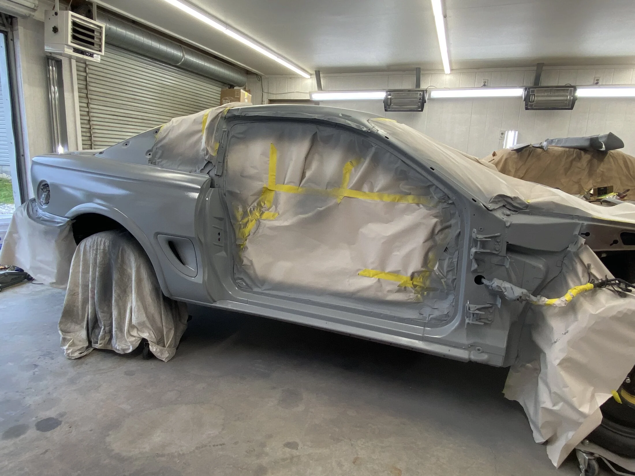

Yes they do. I like to body work them in with the quarters and prime on some of the sessionsLooking good man! Do the rear quarter panel "air scoops" seperate from the sheet metal?

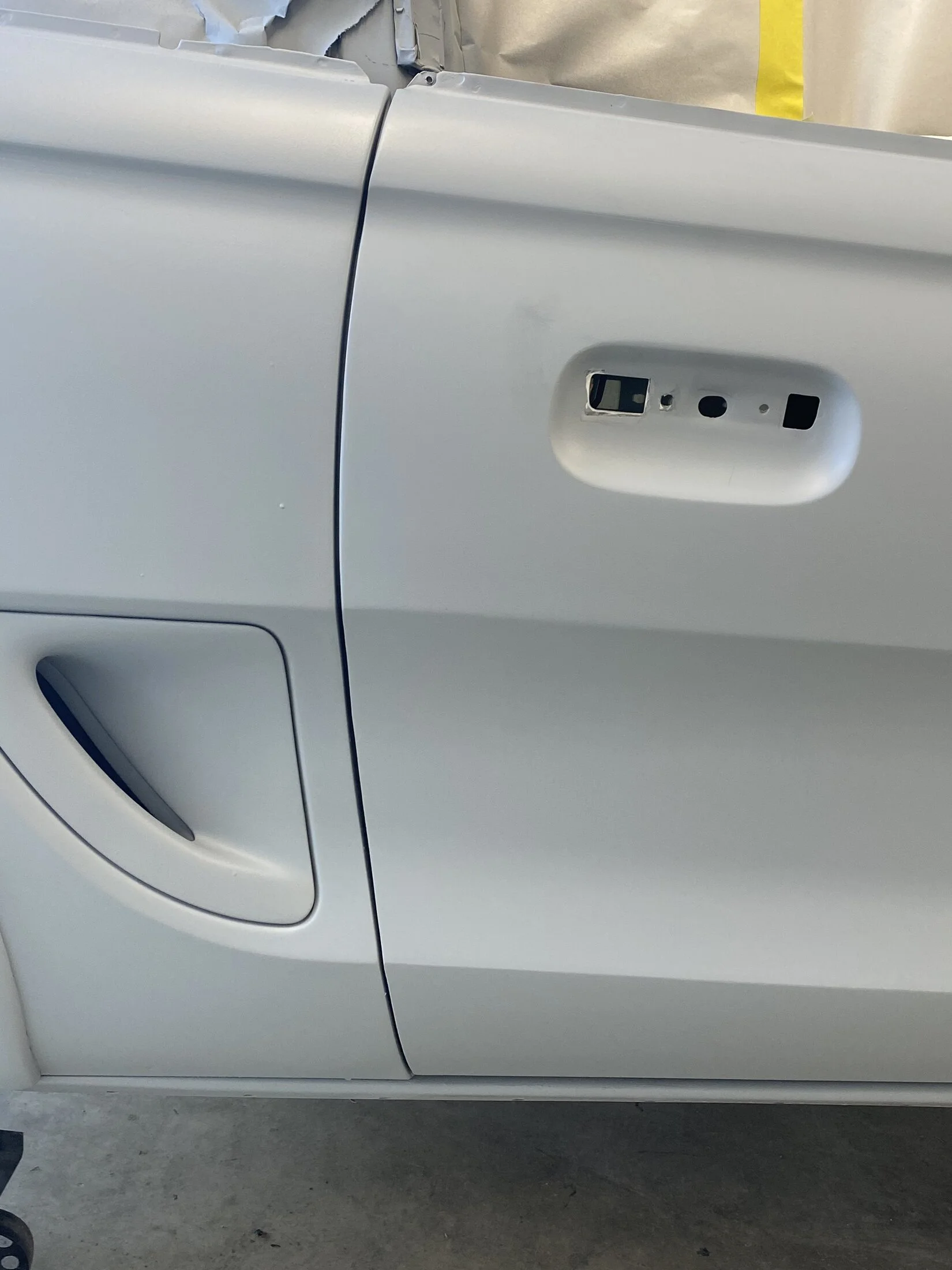

Couple weeks then block and prime again. 6 months after last prime to do final block before paintI see the orange peel
How long does that have to cure before you go nuts on it?

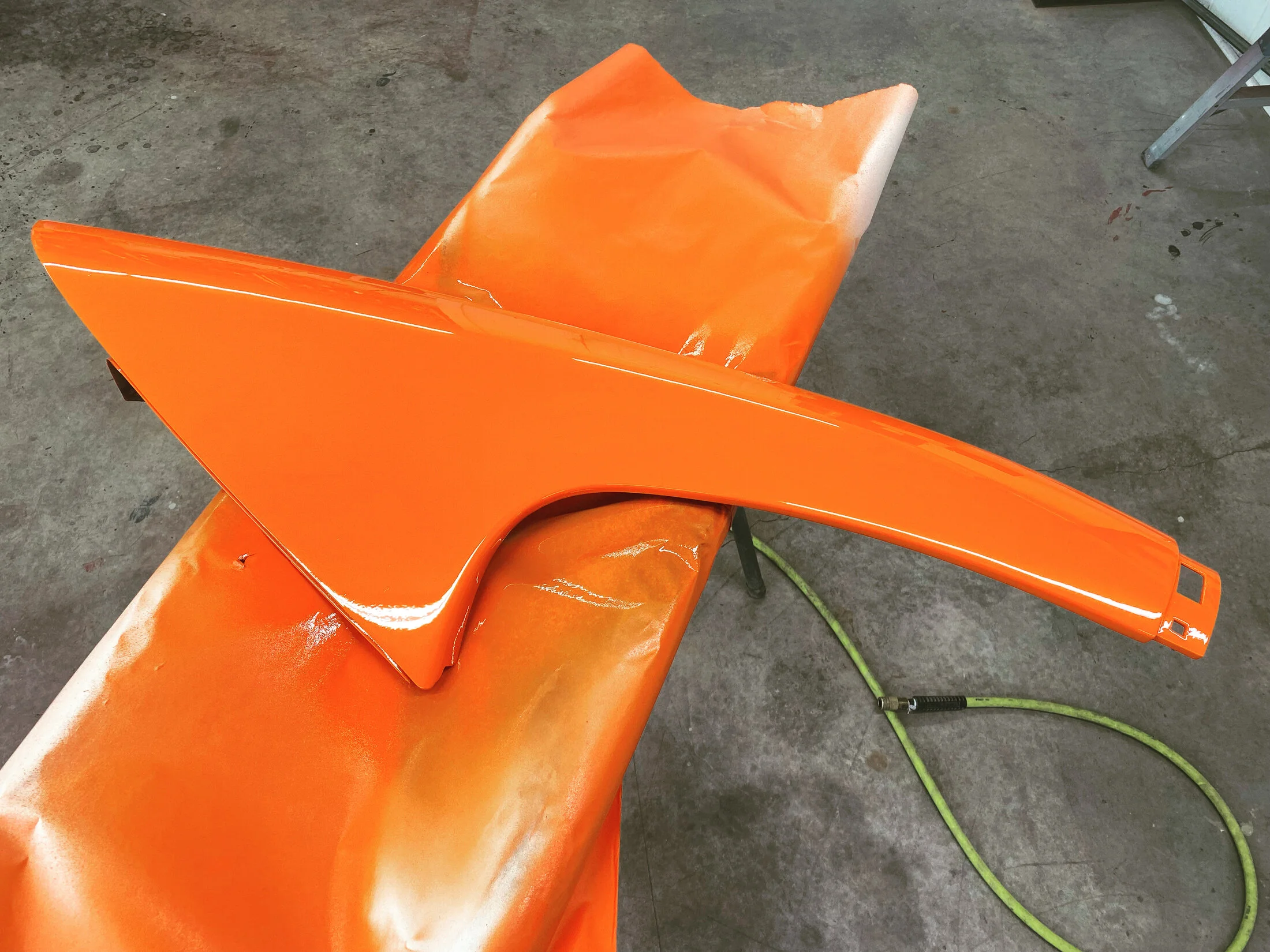

Definietly the difference between a quality custom paint job and an insurance job at the run of the mill body shop.
