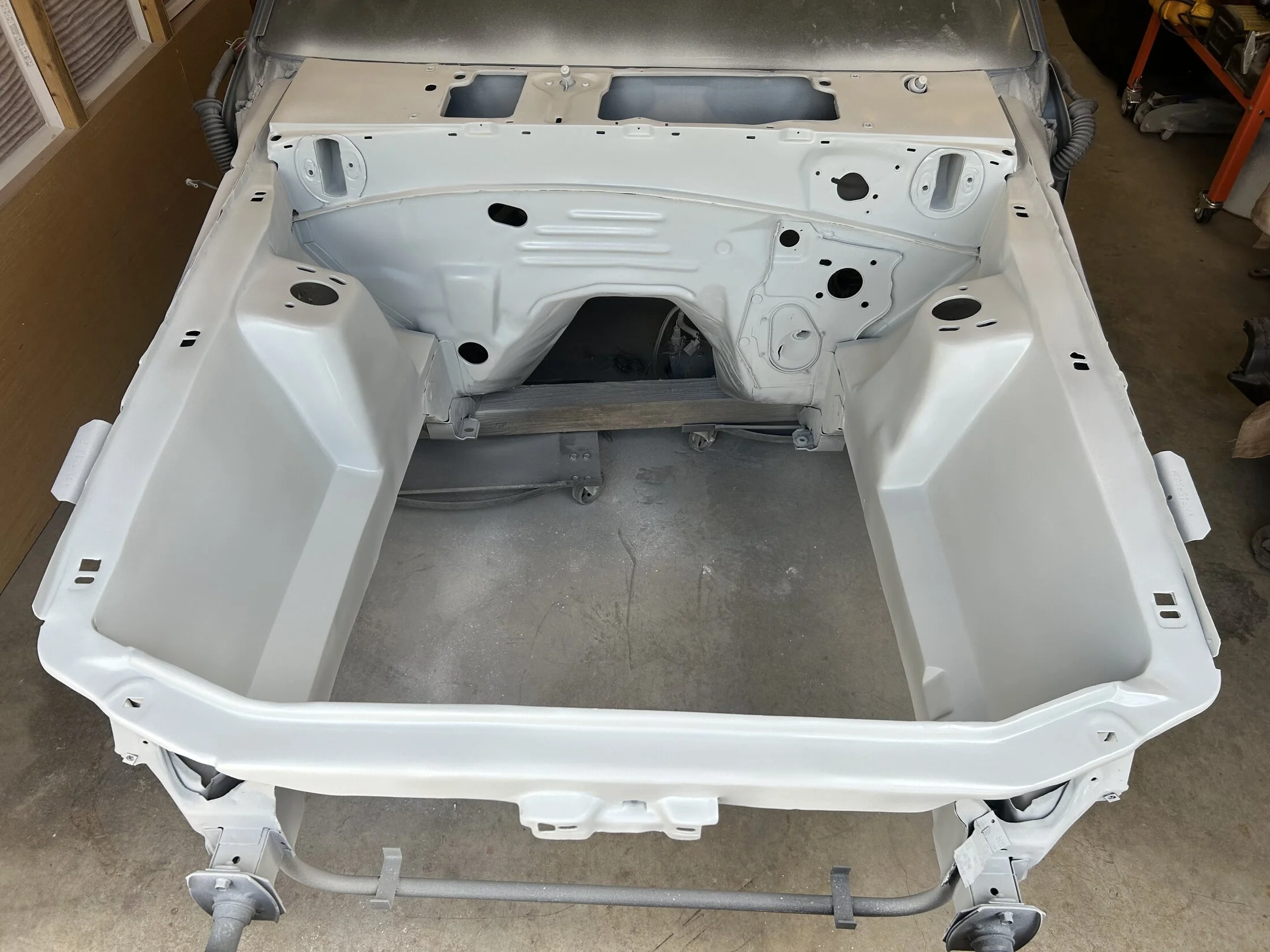

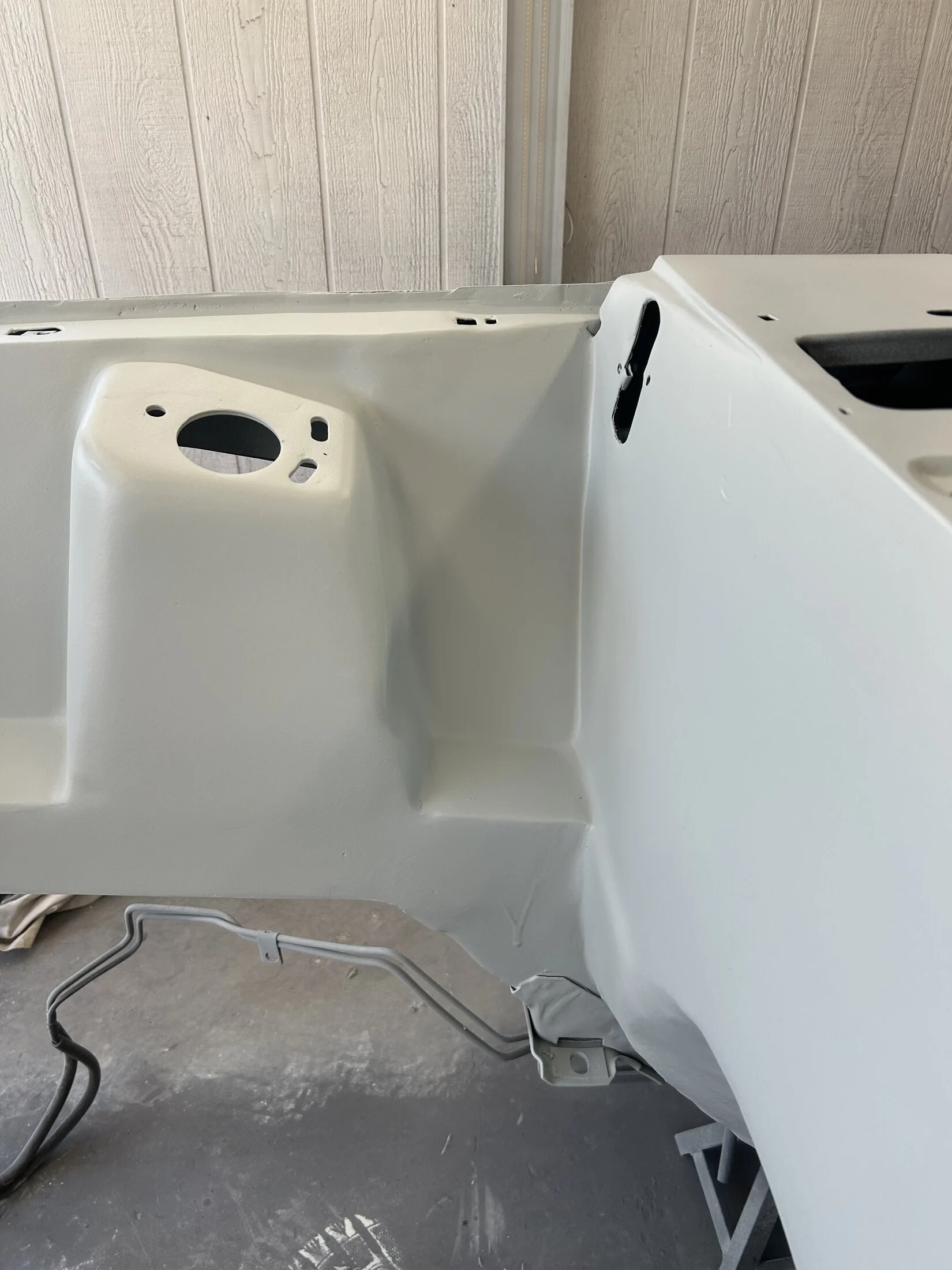

Surely you're gonna do something to that dog house header panel, I don't see you leaving it all wavey/wonky like that. Covering it up?
Or are.my eyes deceiving me?
Just wait until this hot-tub time machine hits 88 MPH.
Thats where the machine guns are coming out

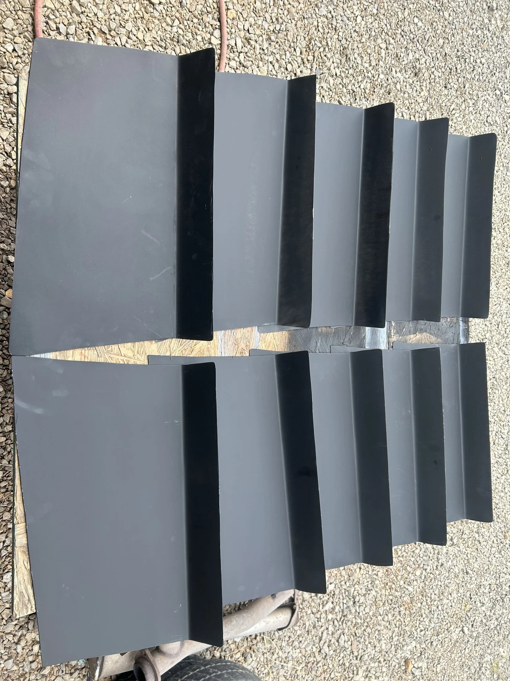

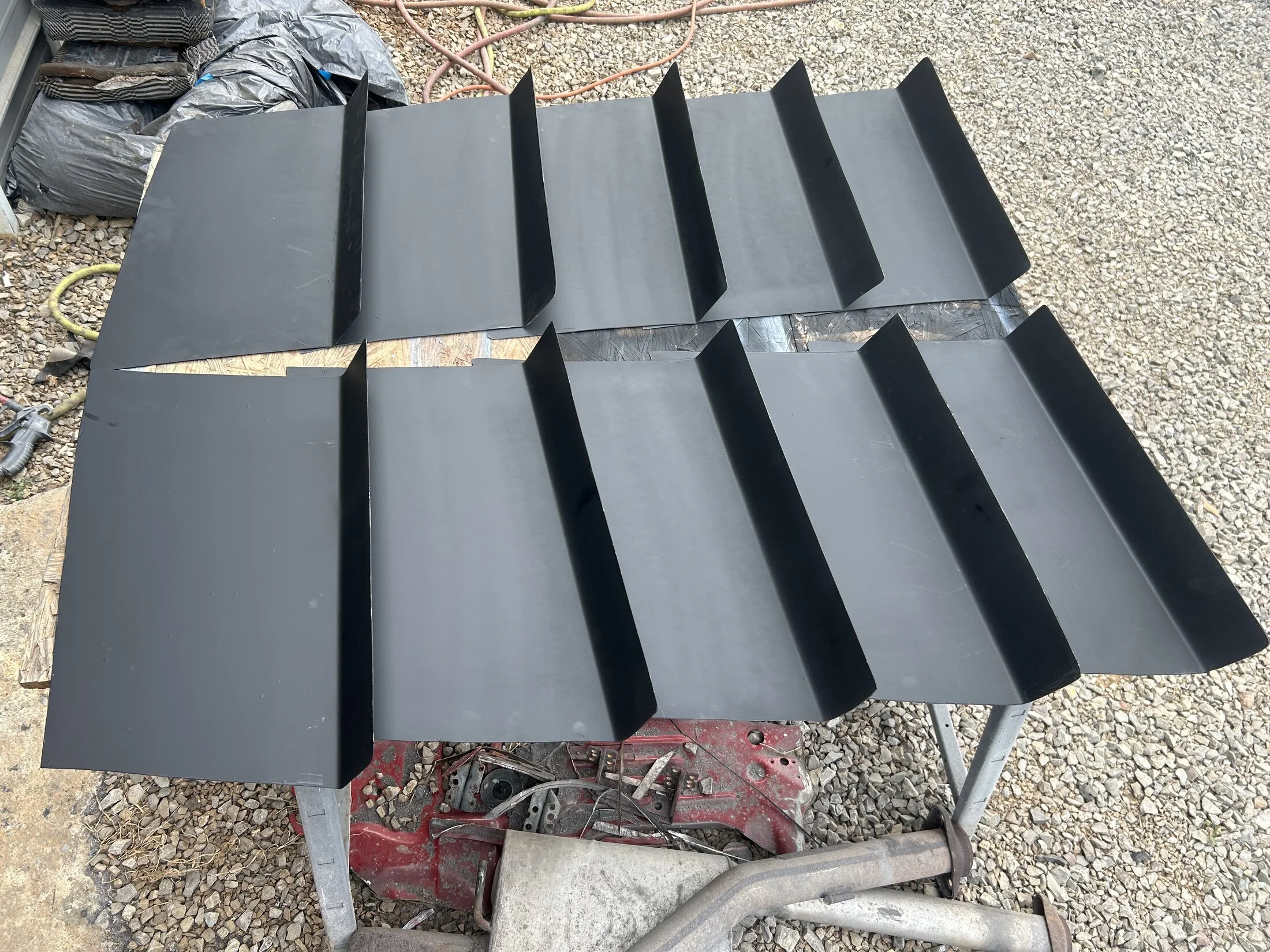

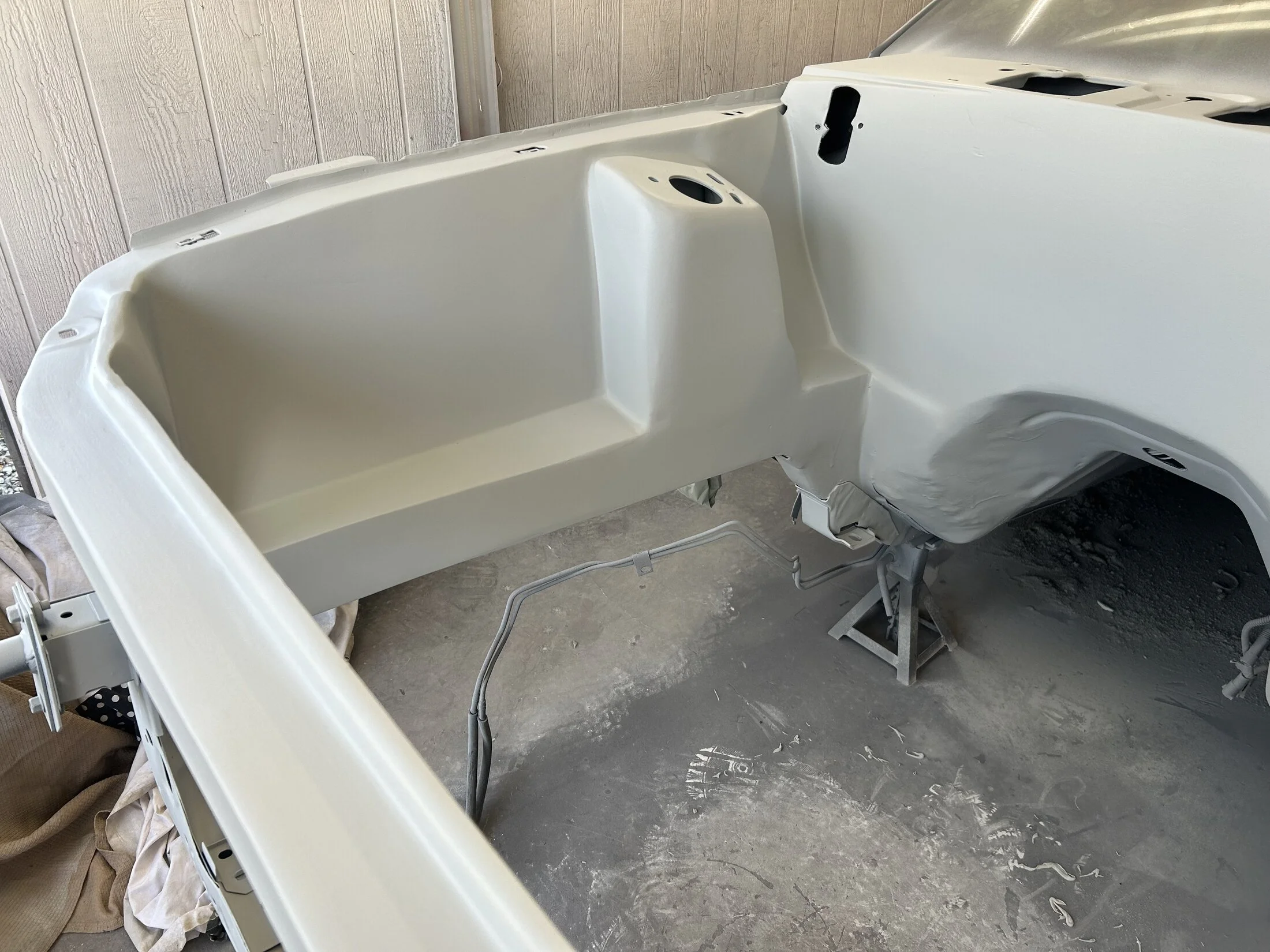

At first I thought you were going to try to make a rear window louver, then I thought maybe it was for a heat extractor hood... THEN I figured out those are engine bay smoothing panels, lol.
Machine gun maintenance covers.
Reactions: bird_dog0347 and General karthief
Yep. Had a bunch of people
Request them so made a few extra sets but I thought the arrangment looked cool

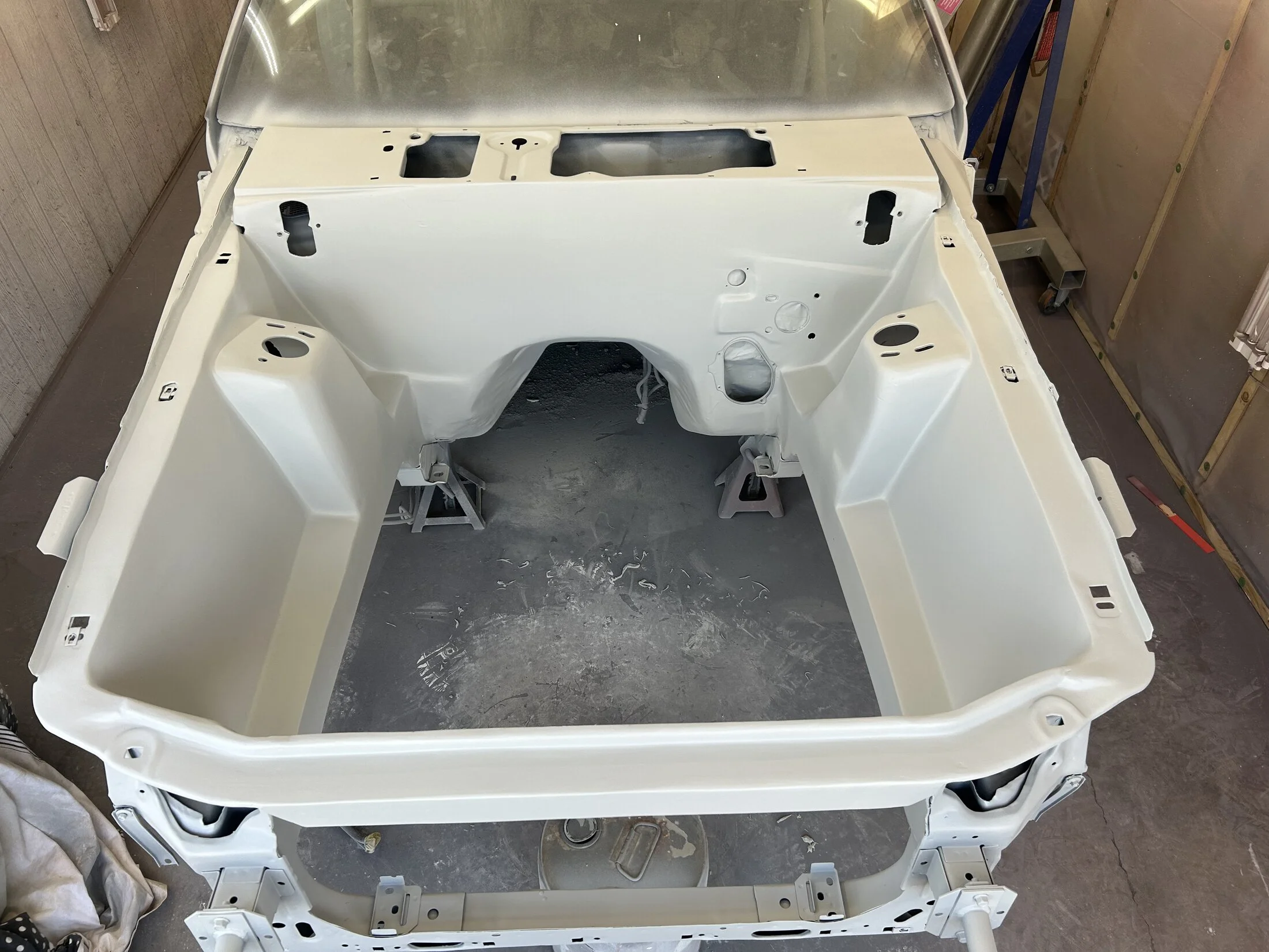

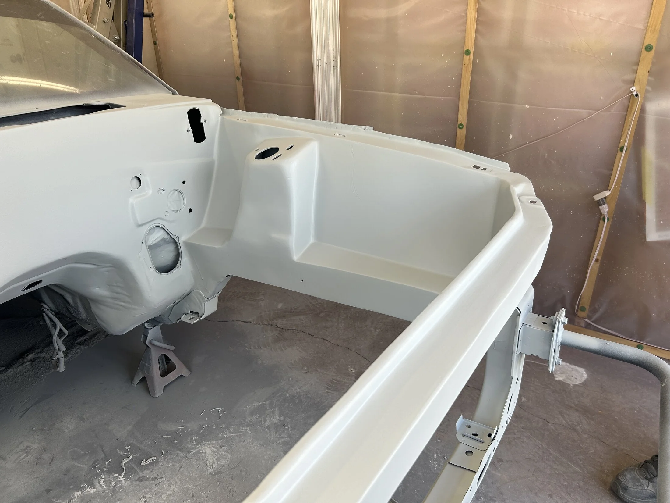

95 hrs in
Reactions: Flatfoot, rednotch, General karthief and 2 others
rednotch
I'd like to remain having one chocolate starfish
Aug 14, 2000
1,395
627
143
south jersey
Jul 15, 2024
#152
  • Jul 15, 2024
  • #152
I want this magical high build primer that does all the filler work since it goes from epoxy to that...
Reactions: 95steedamustang

It's soooo smooth! Damn, art work man!
So how much weight does this add to the nose of the car? Just curious if you know.
You ask chicks the same thing?
PFFFTTT!!!! This is just the first round of about 100 primer coats (trust me, I know), and that is how it is magical.
We cut out alot of metal and then plate it so I doubt its adds much. Like the stock firewall metal is all cut out and gone.
The stuff Im using is basically sprayable bondo but is direct to metal as well. It requires a 2.0 tip and your looking at a half gallon. To start
Maybe .75 gallons with that run in the 2nd to last pic! Doesn't matter though, it's all gonna end up as dust on the floor anyway.

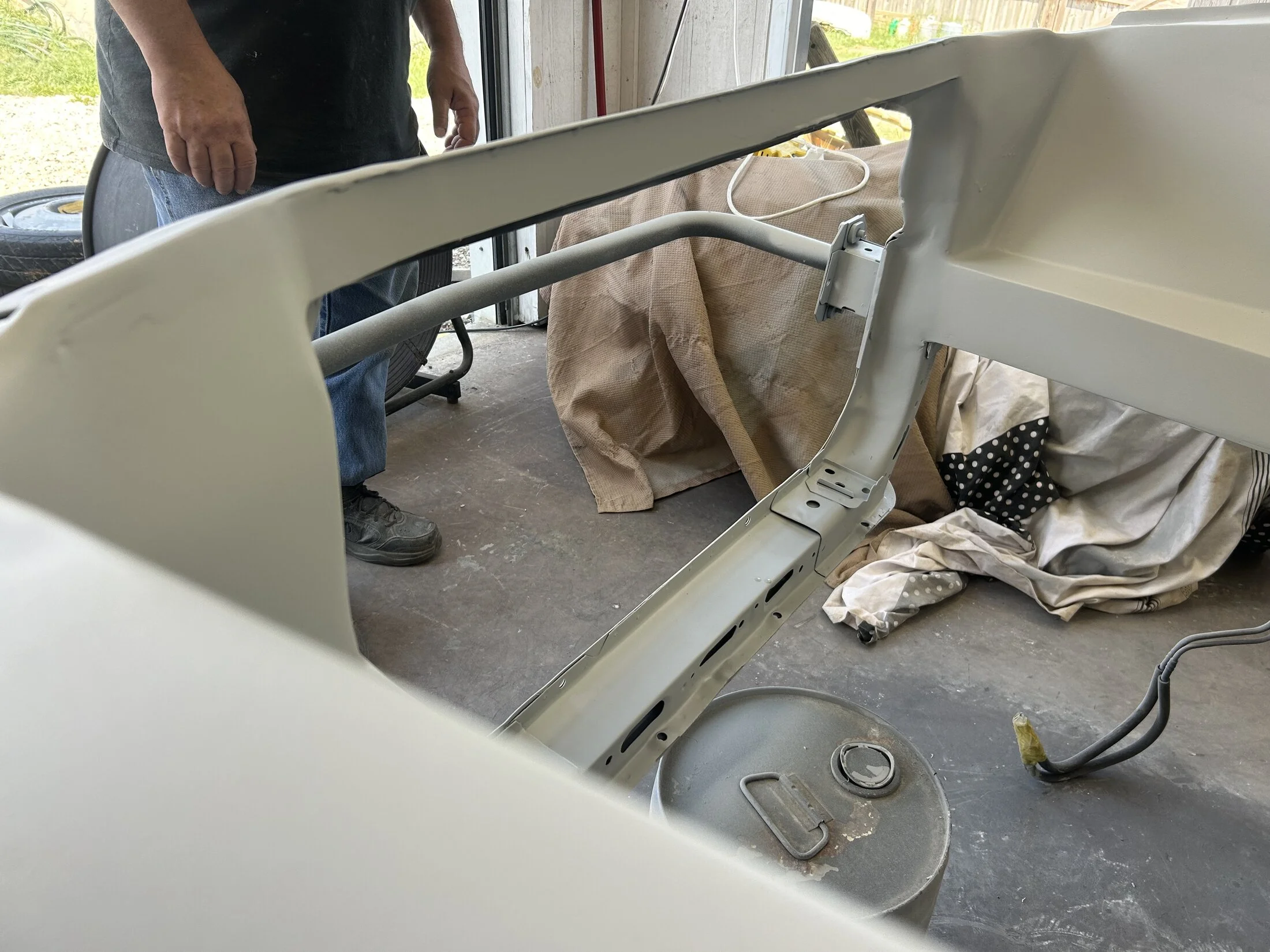

You bet man. We hosed it on. 90% will be blocked off and prime…prime again. Like this guys bay. Know him?
