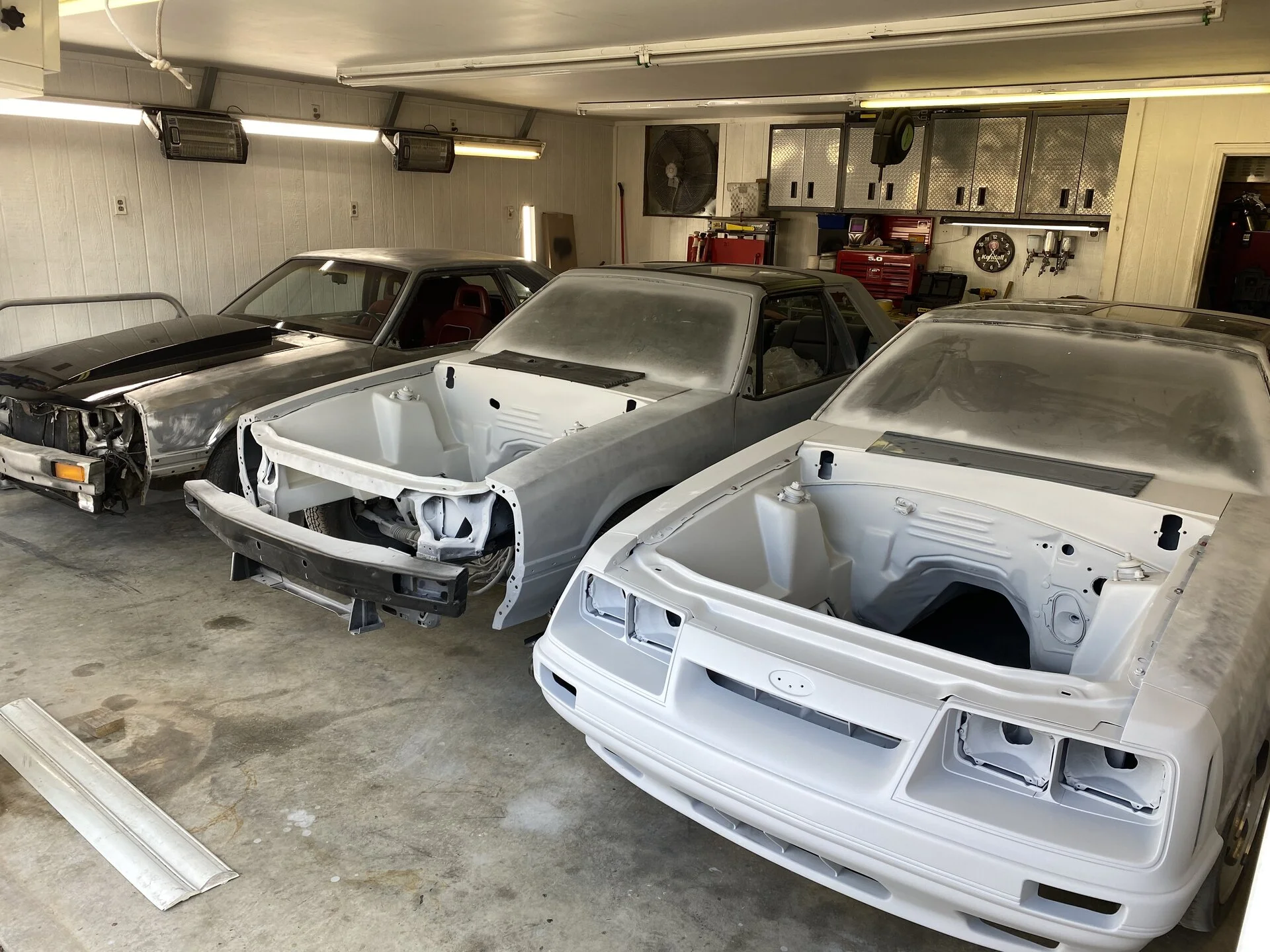

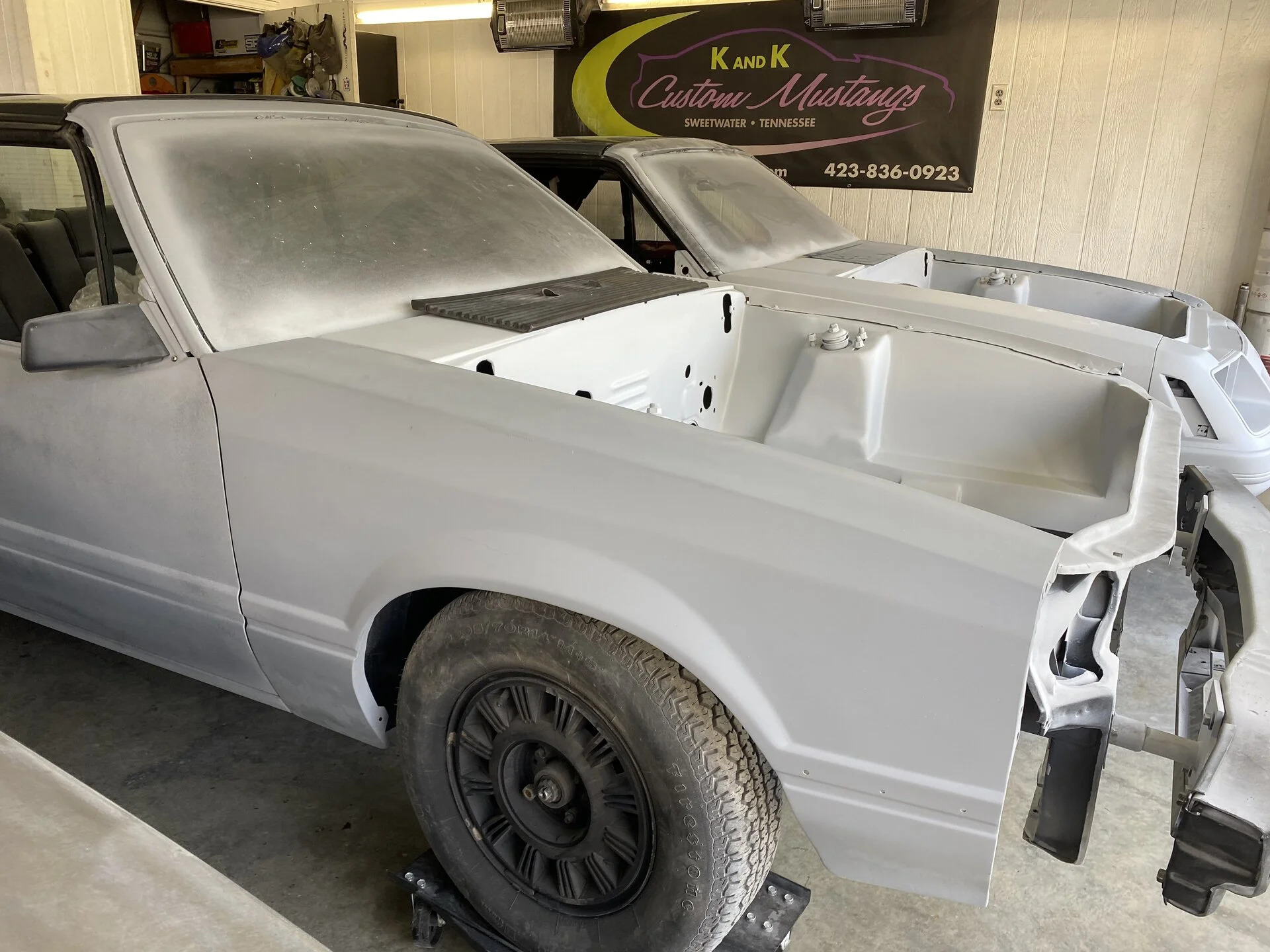

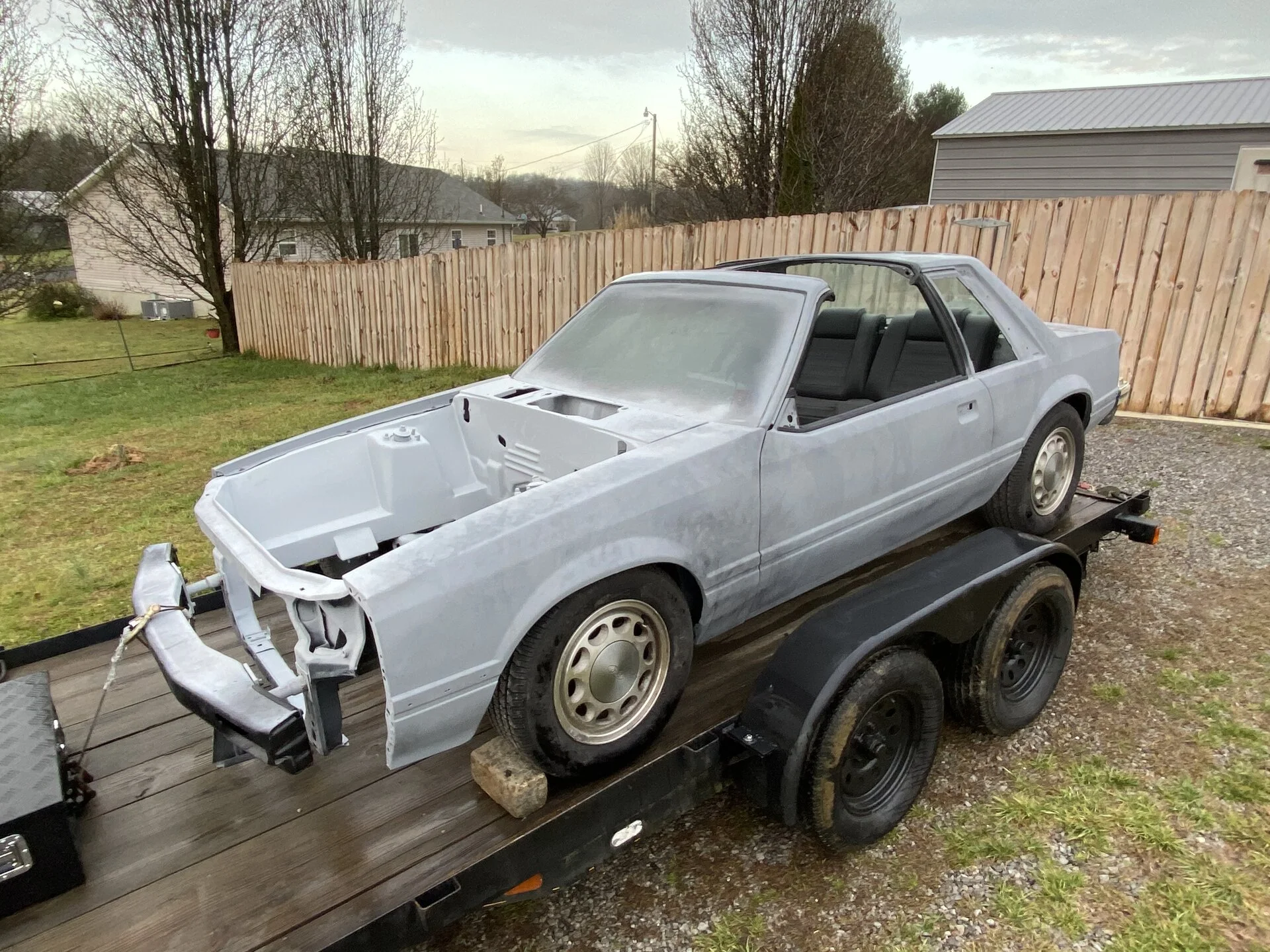

Lined up the passenger side fender.
Getting the front bumper ready for primer. I decided to mold the pace car cowl to the hood so primer on that is next

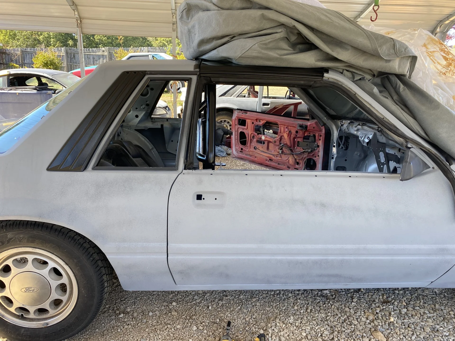

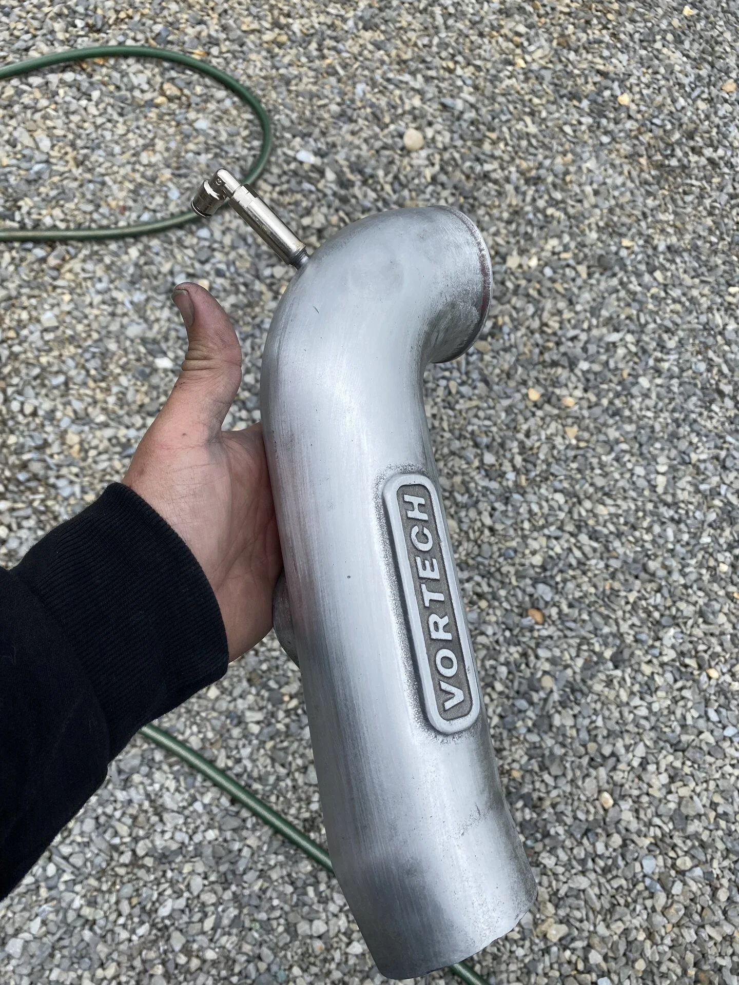

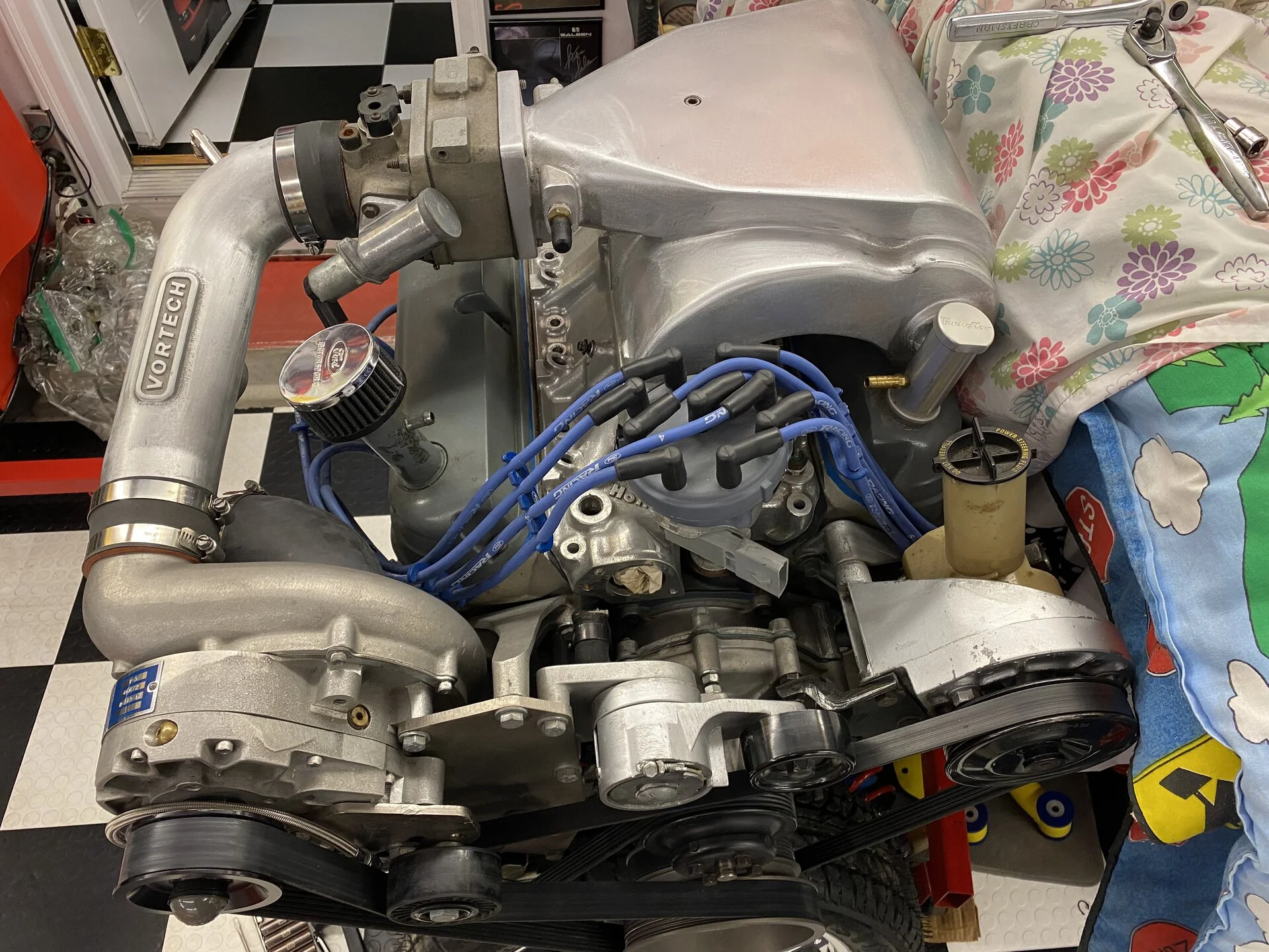

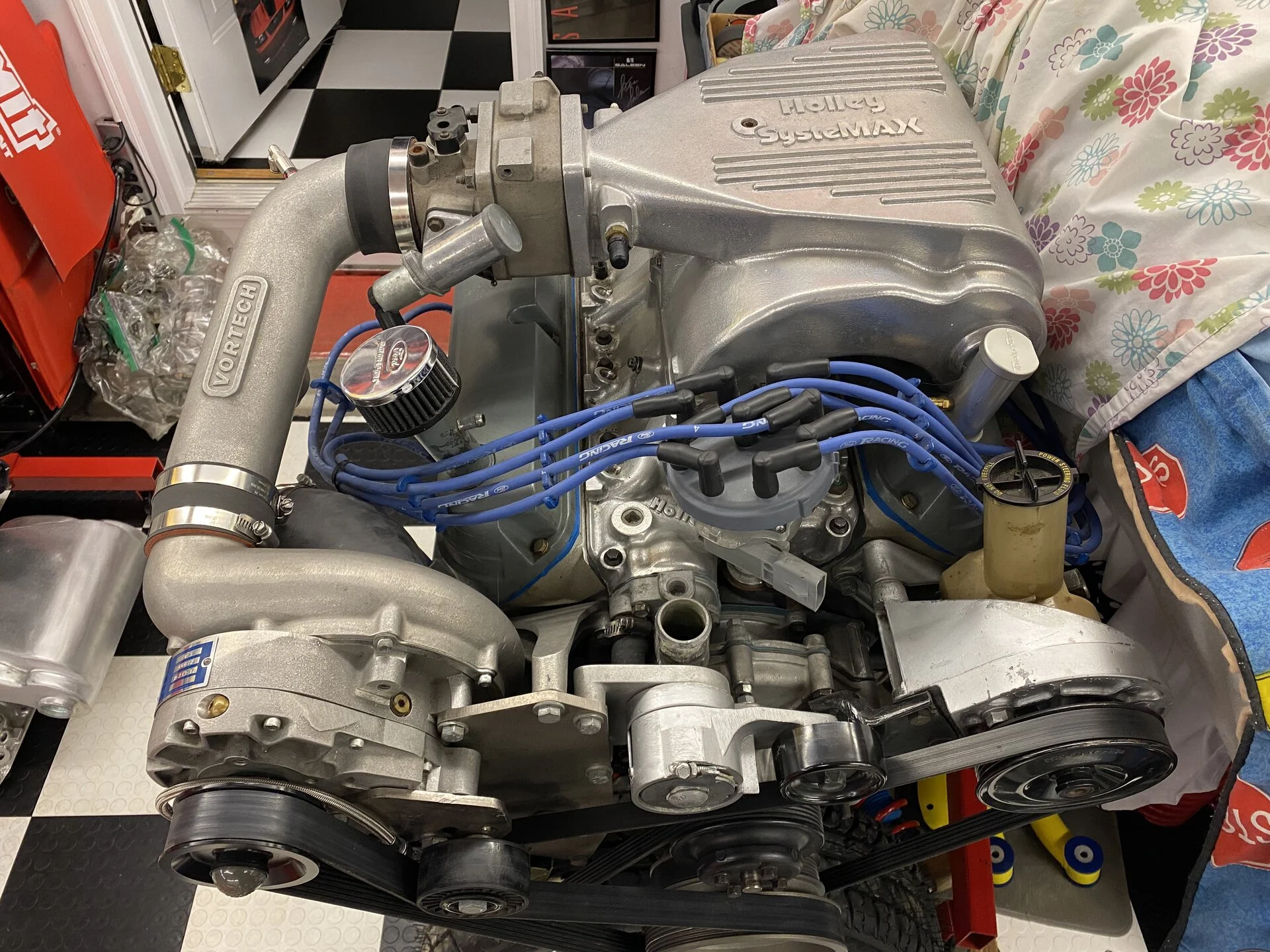

I built this engine which is a Boss block 347 Stroker with stage 3 ported aluminum heads custom ground blower cam and every forged piece available paired with a V-3. I built it for a customer 4 yrs ago. When we dynoed the car it hit 740. The engine found its way back. Its got about 700 miles on it and Ive had it sitting on the stand for about a yr and a half. I’m sick of doing coyotes so Im using this one in the T-Top notch. Time to start making it K and K build worthy.

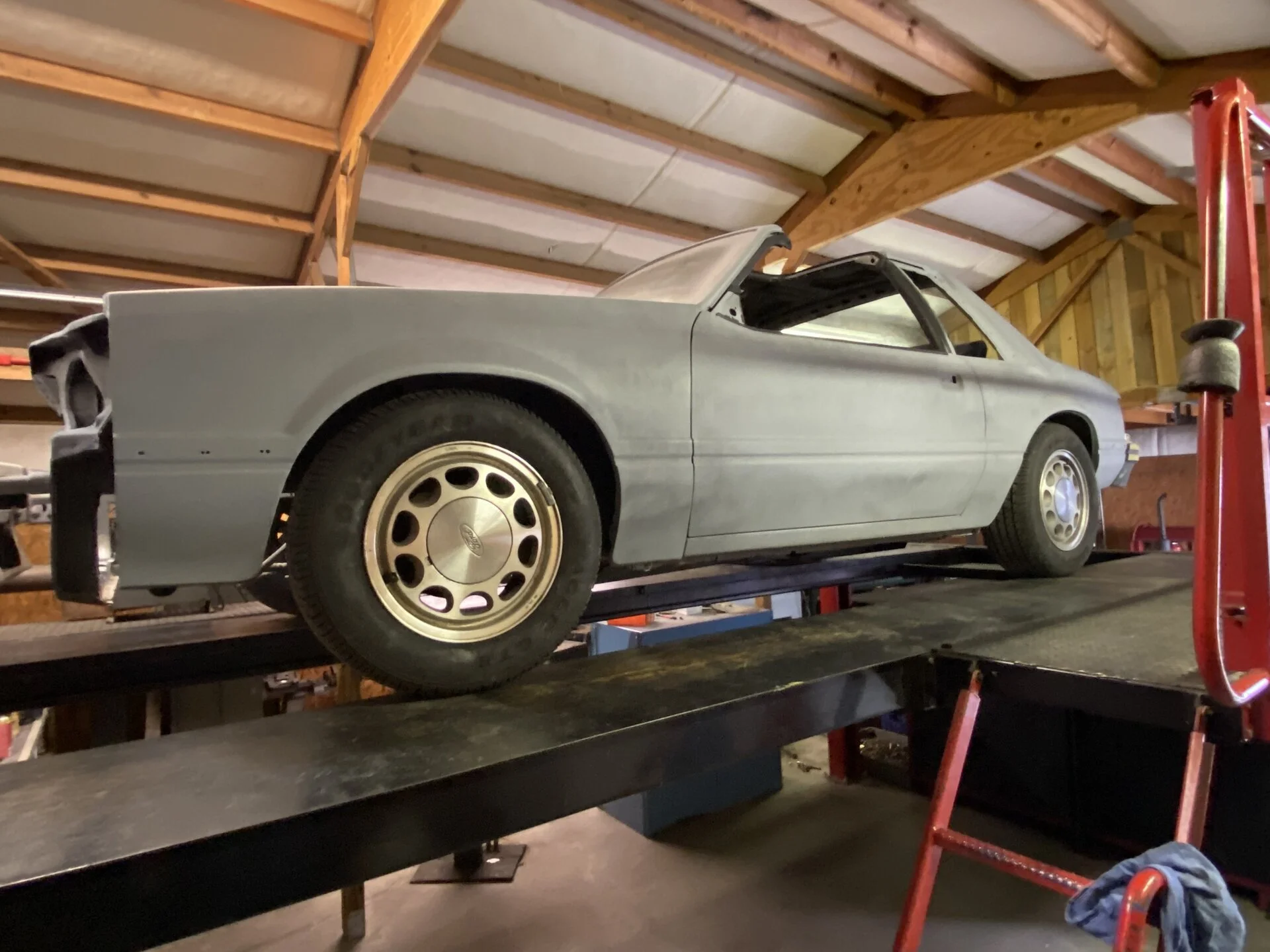

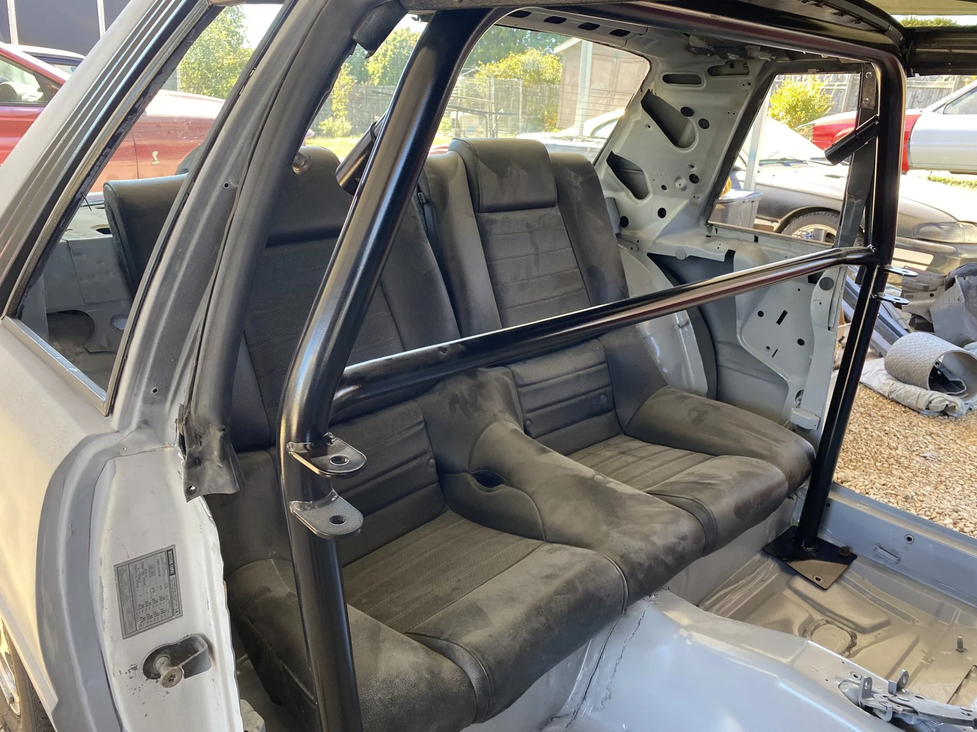

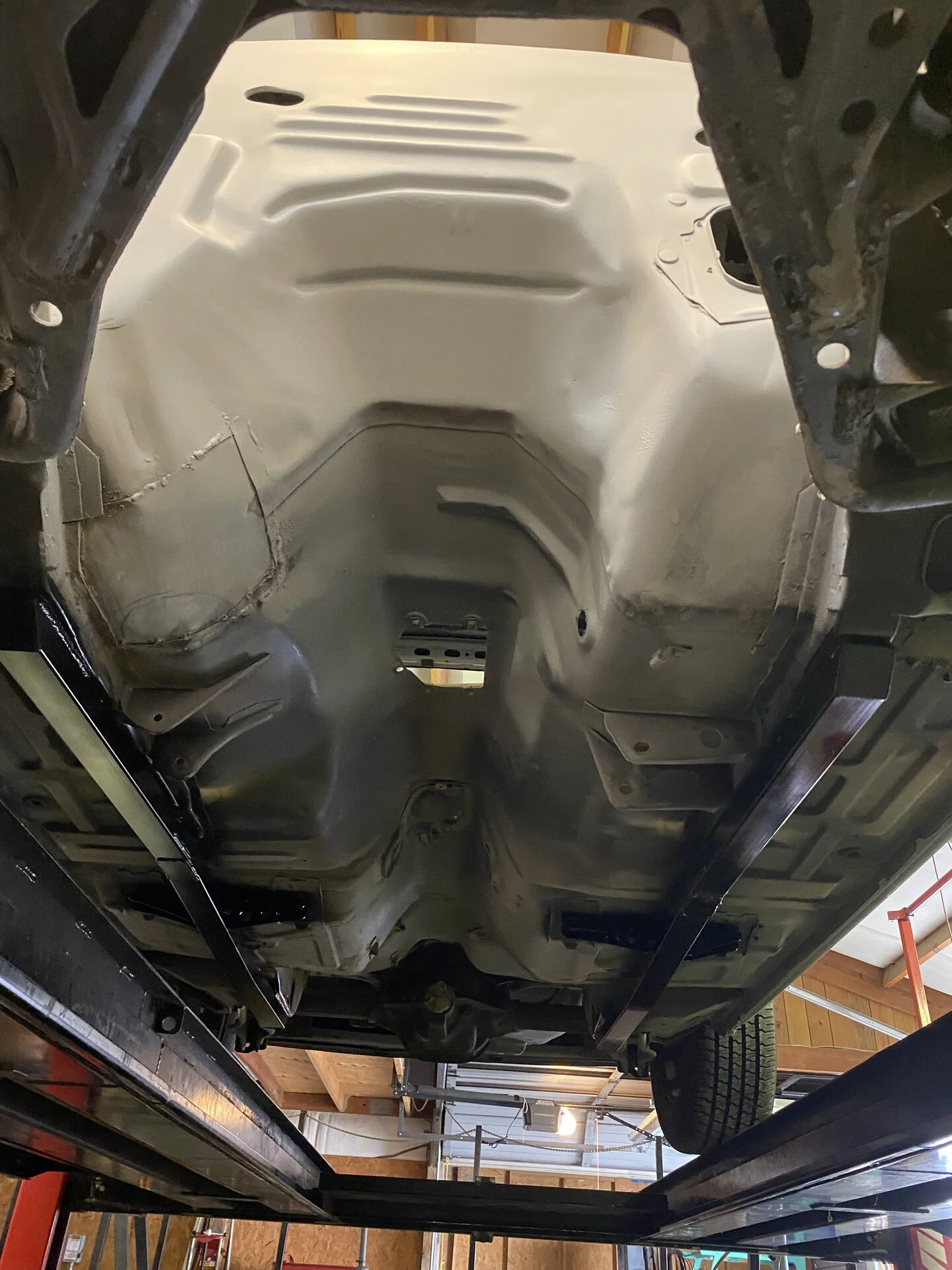

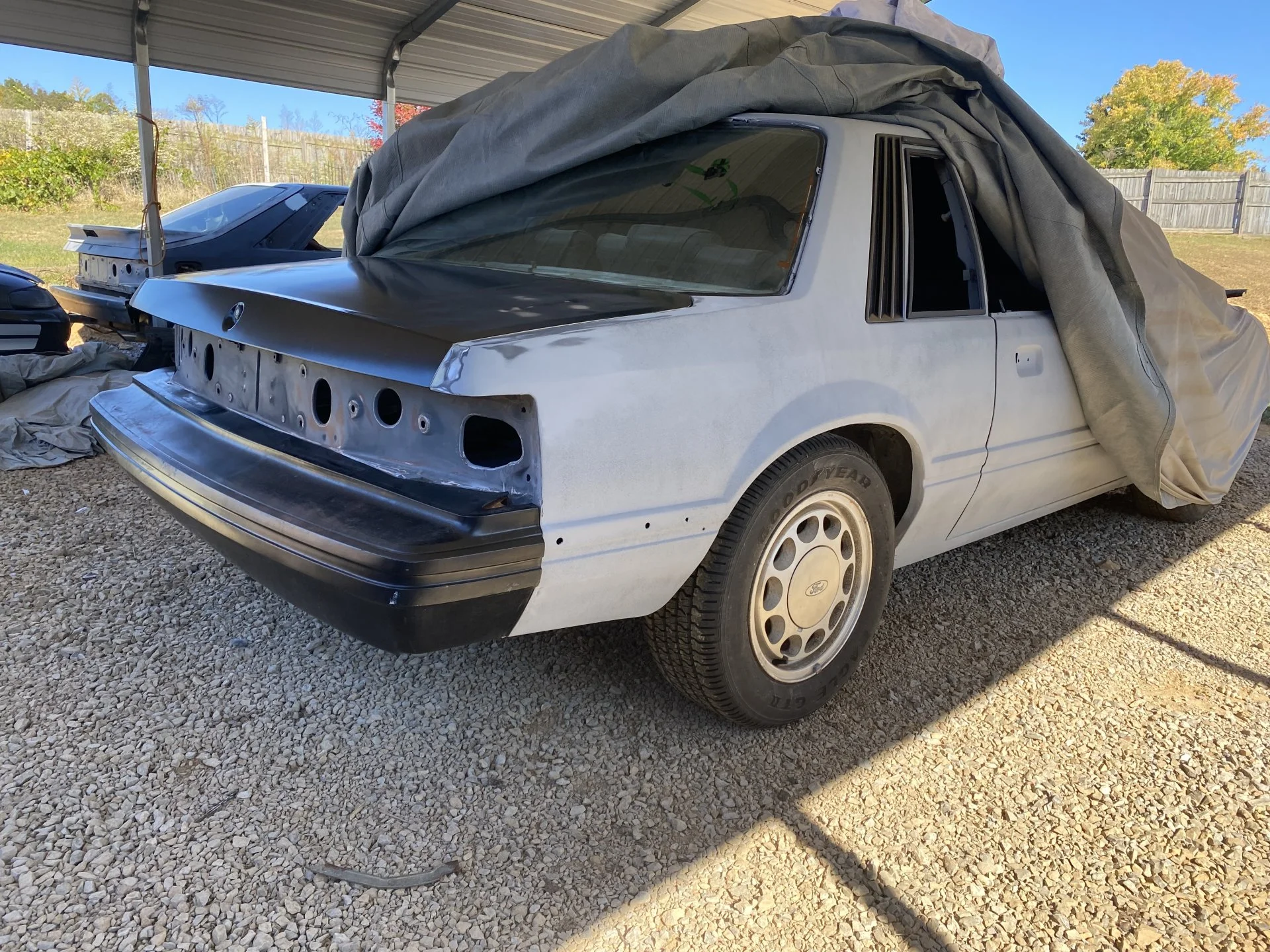

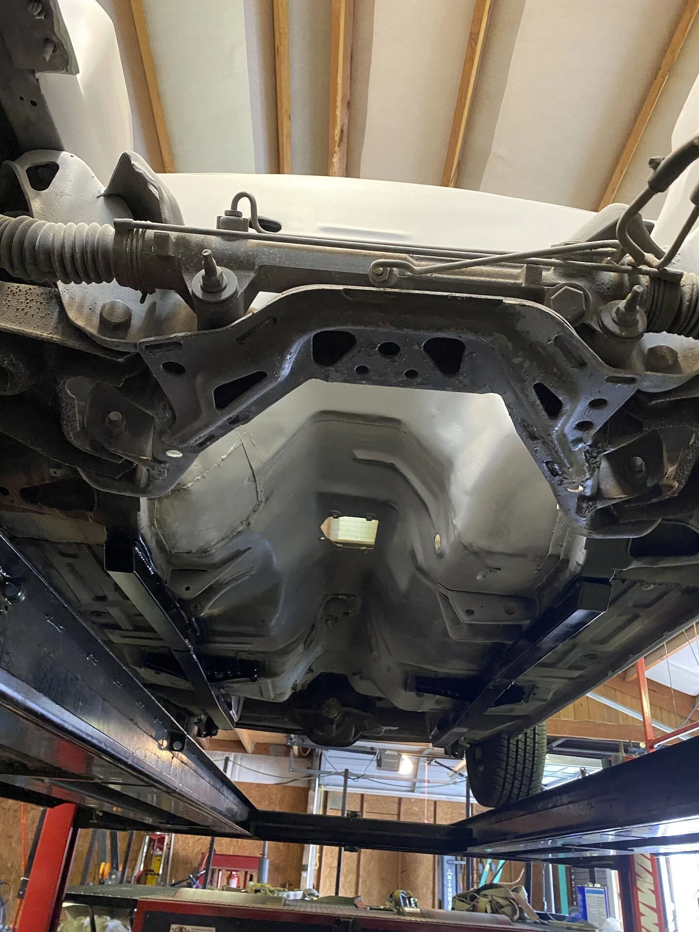

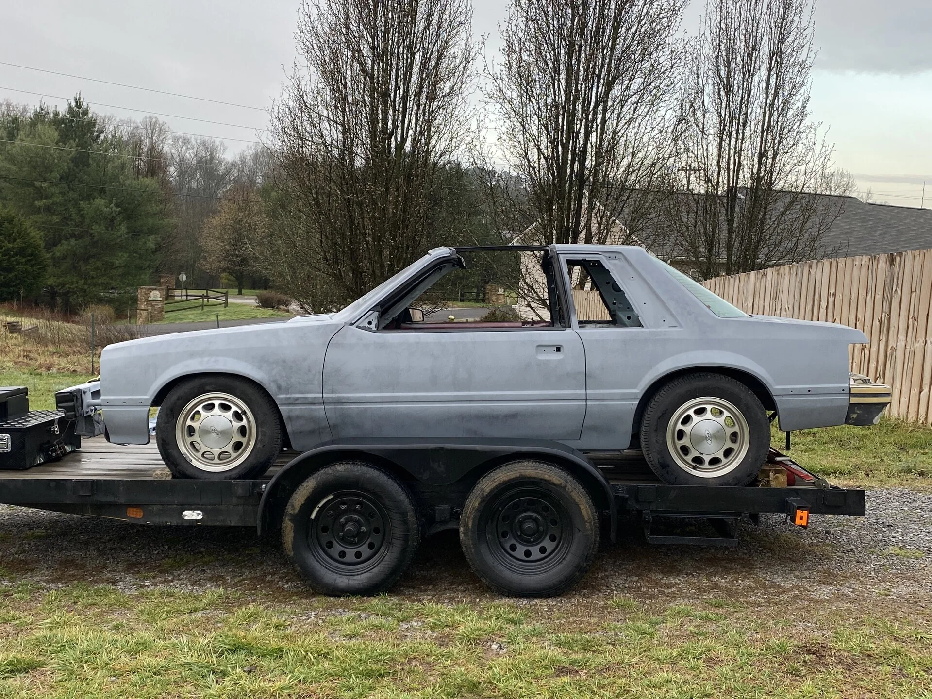

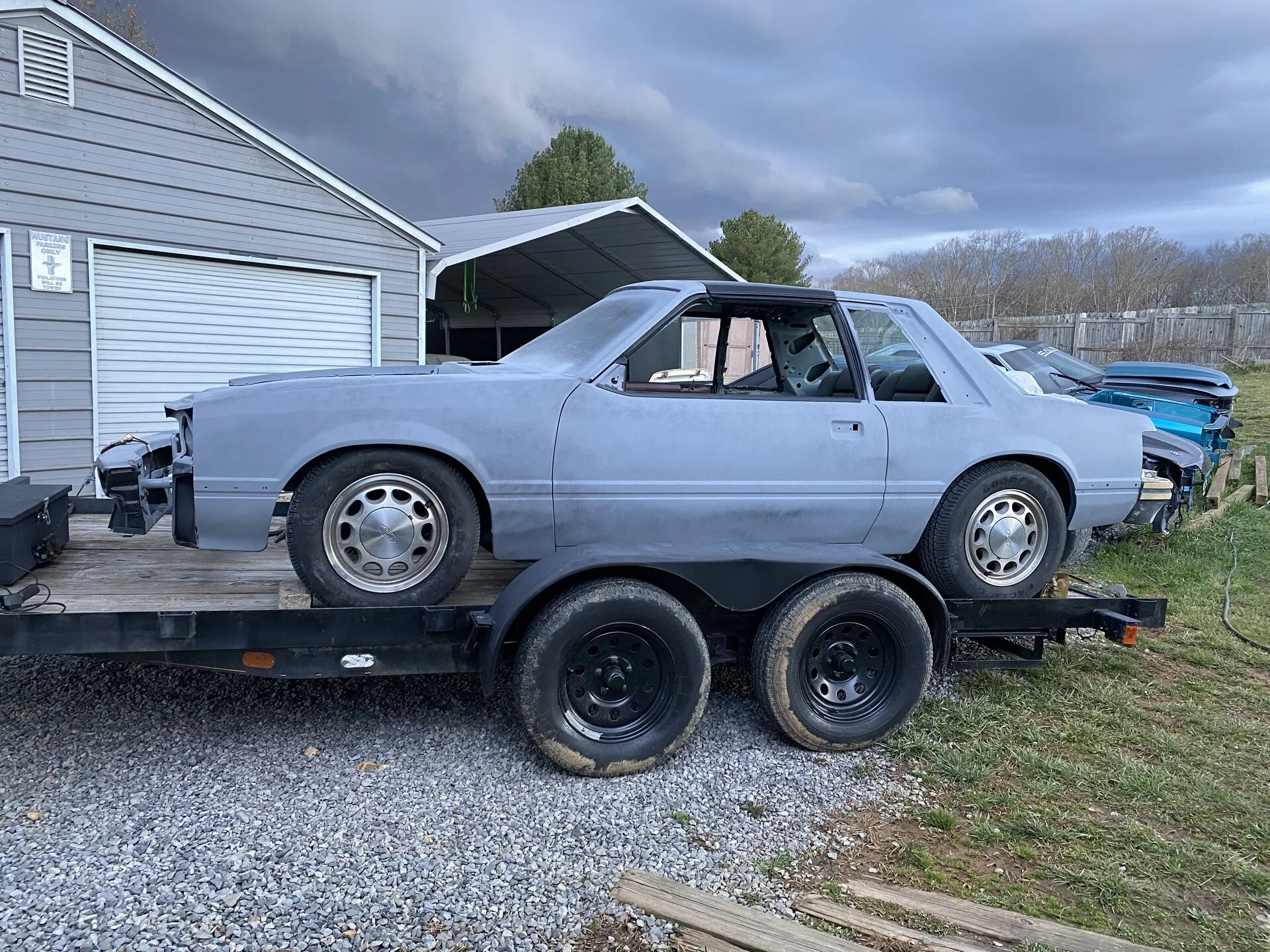

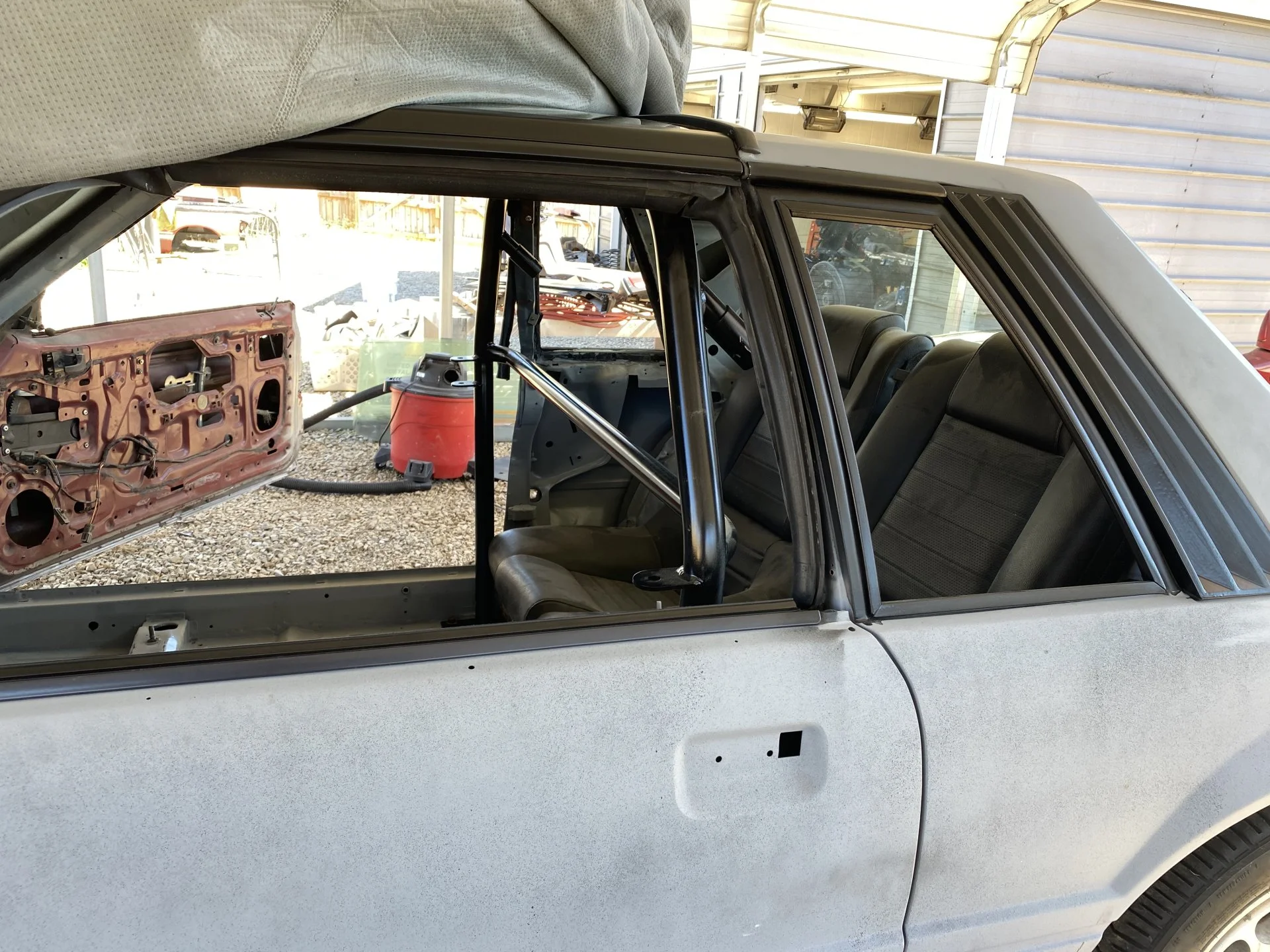

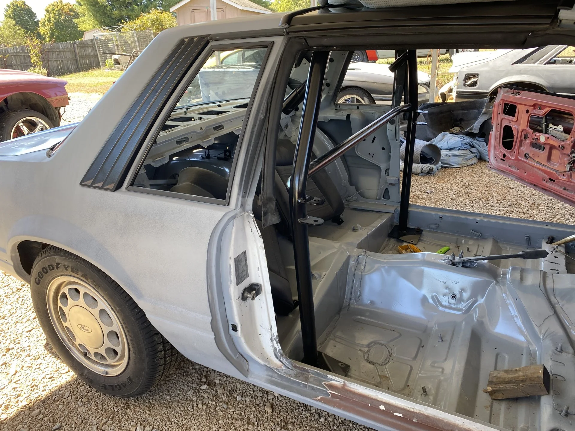

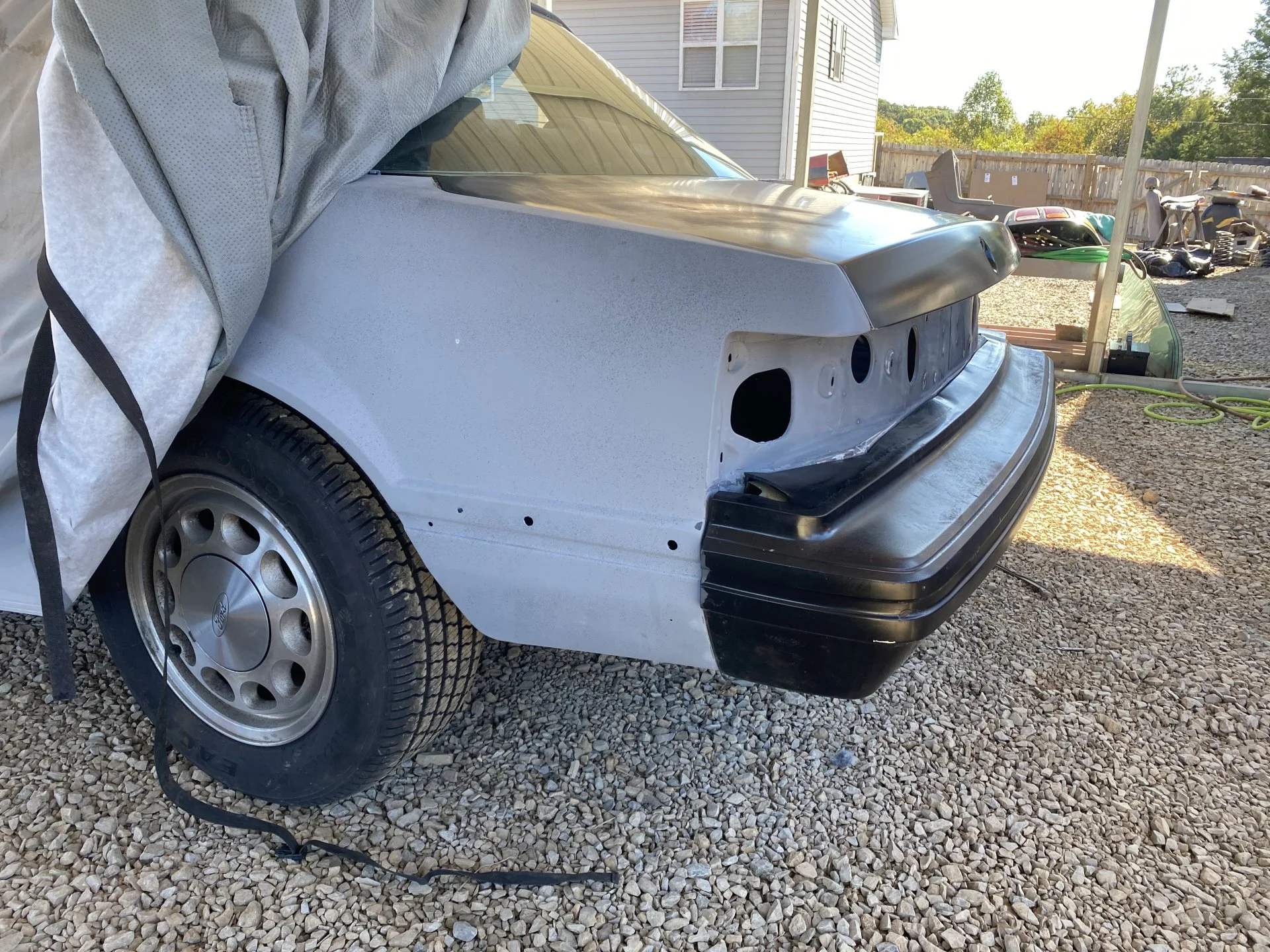

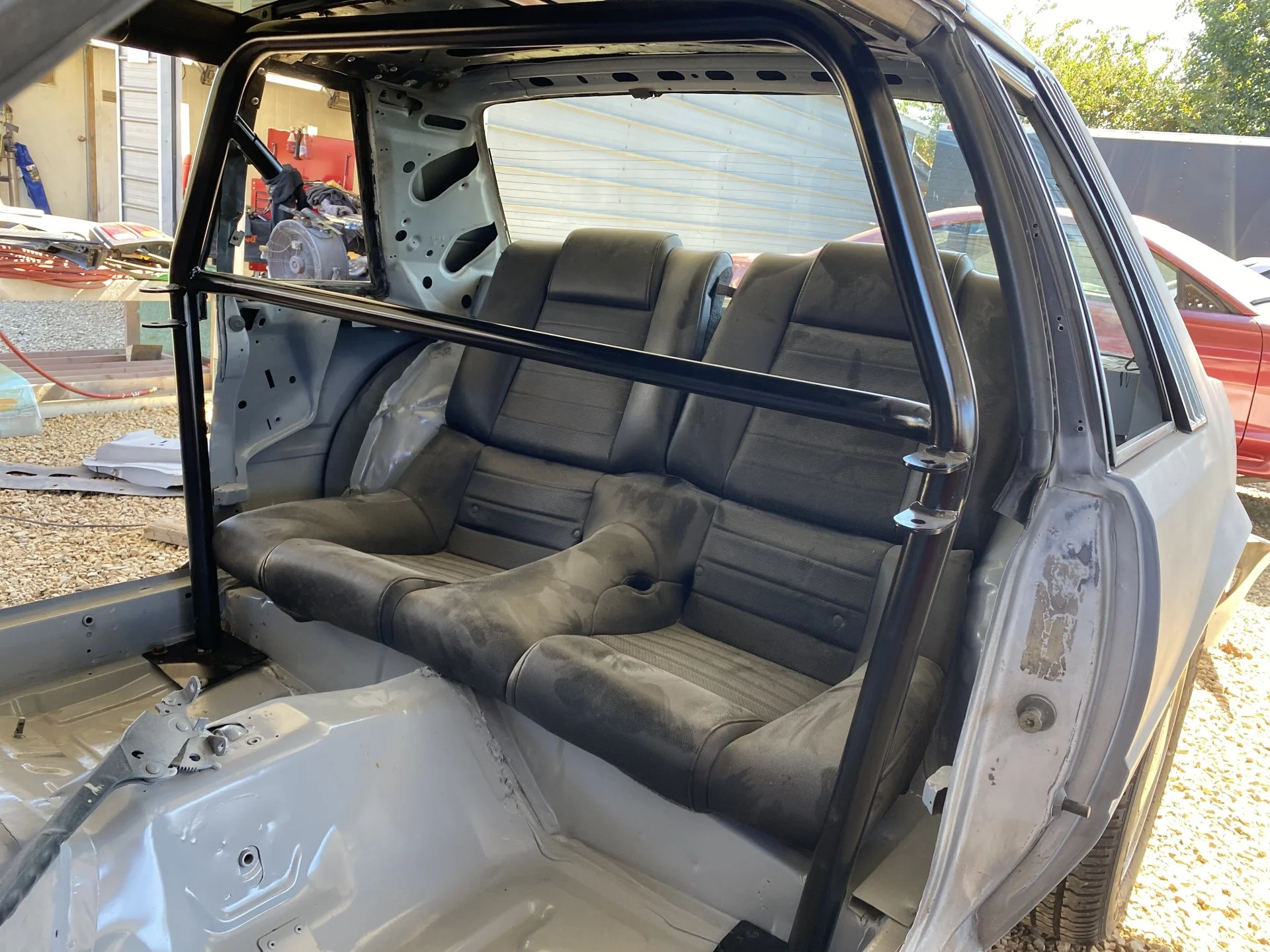

Recent work on the 86. I recently (if you call 6 months ago recent) picked up a good rear bumper for the car and finally got it put on. Started working on my roll bar rear seat mockup. The bar is a copy I made off the MM
One but I changed it to make more room for my rear seat panels.

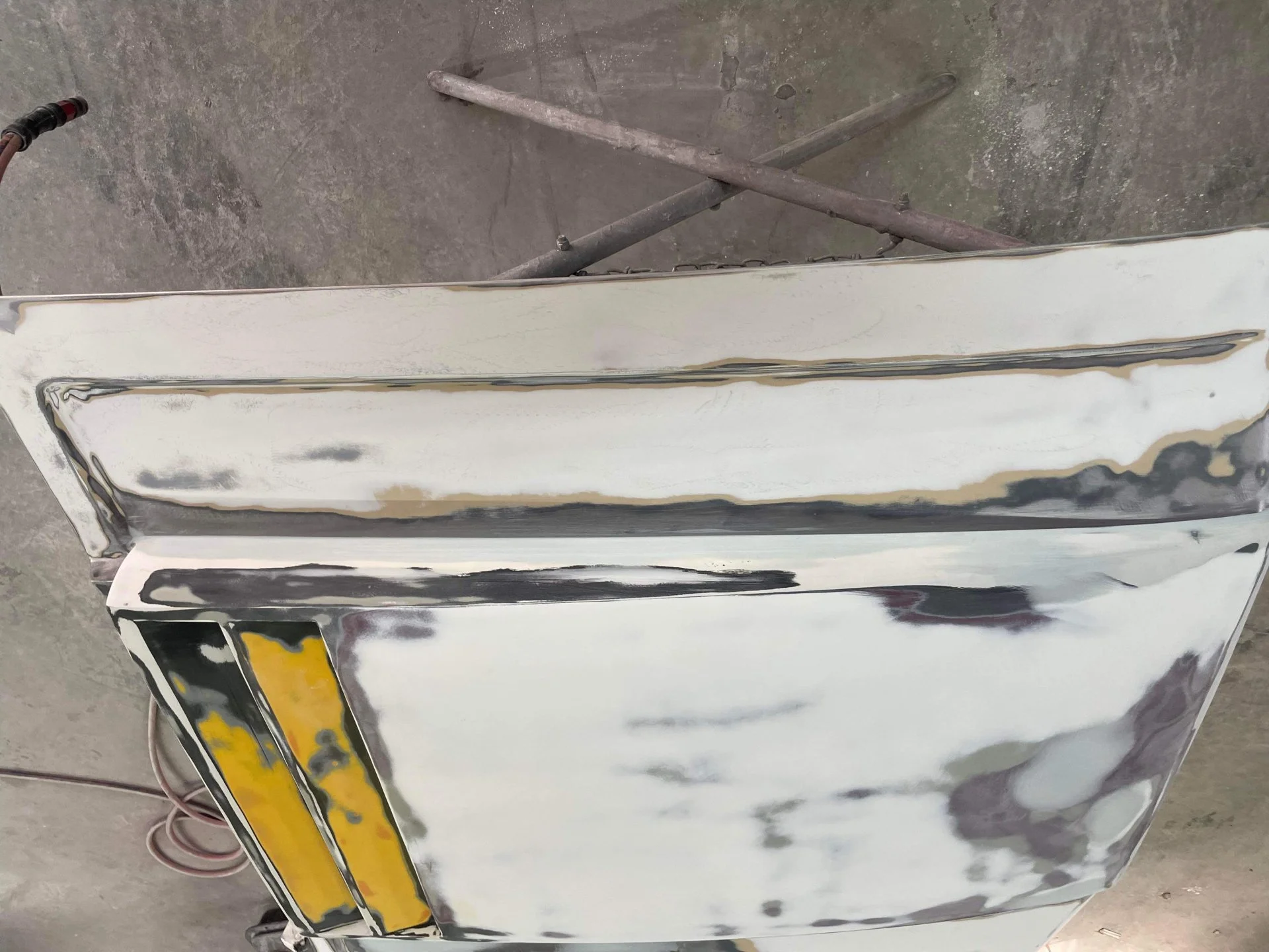

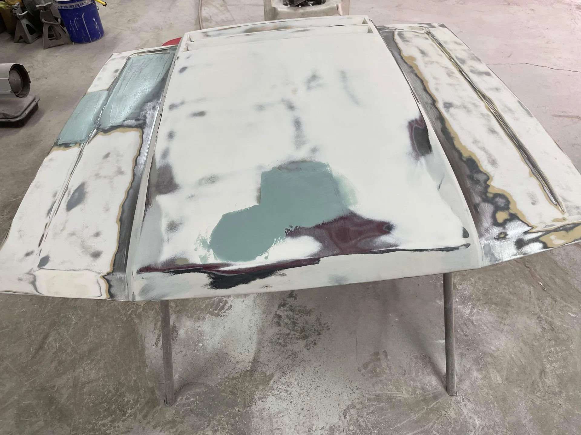

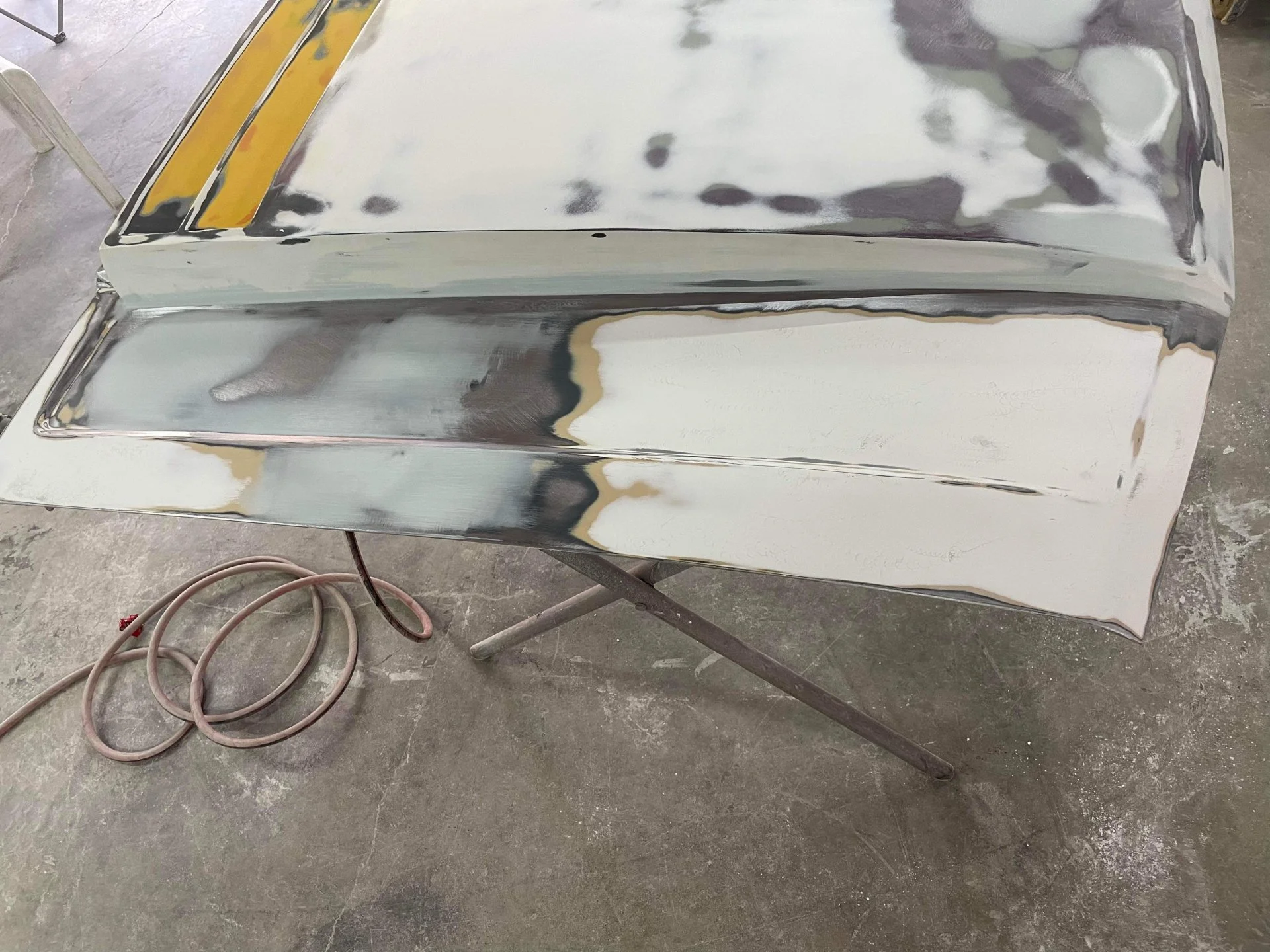

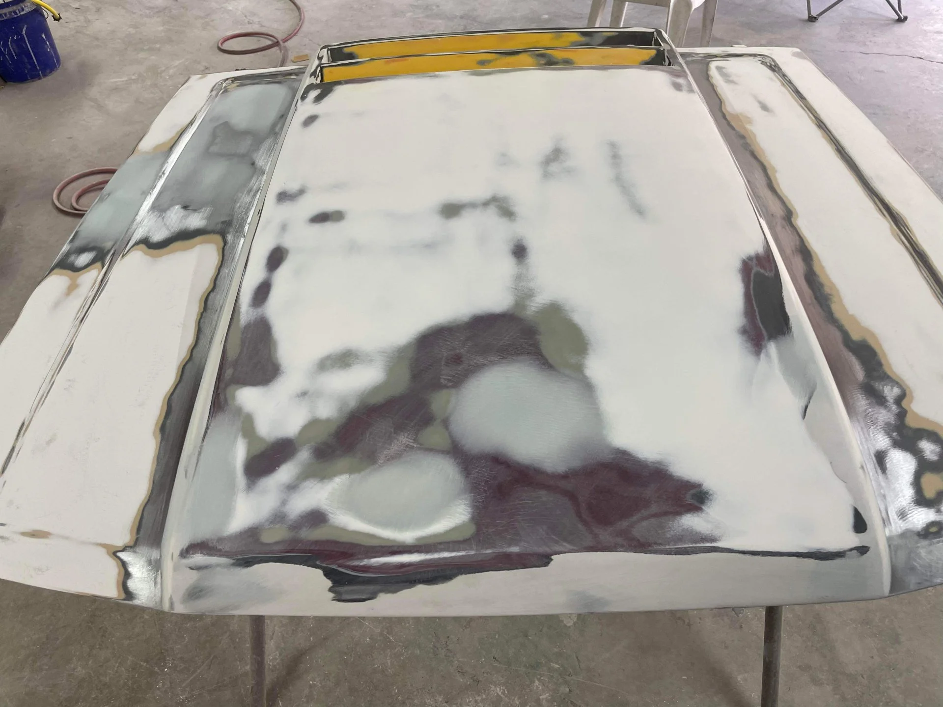

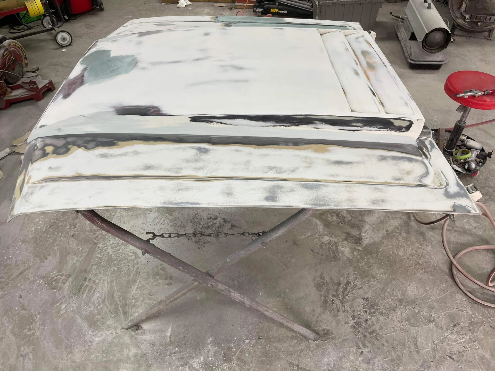

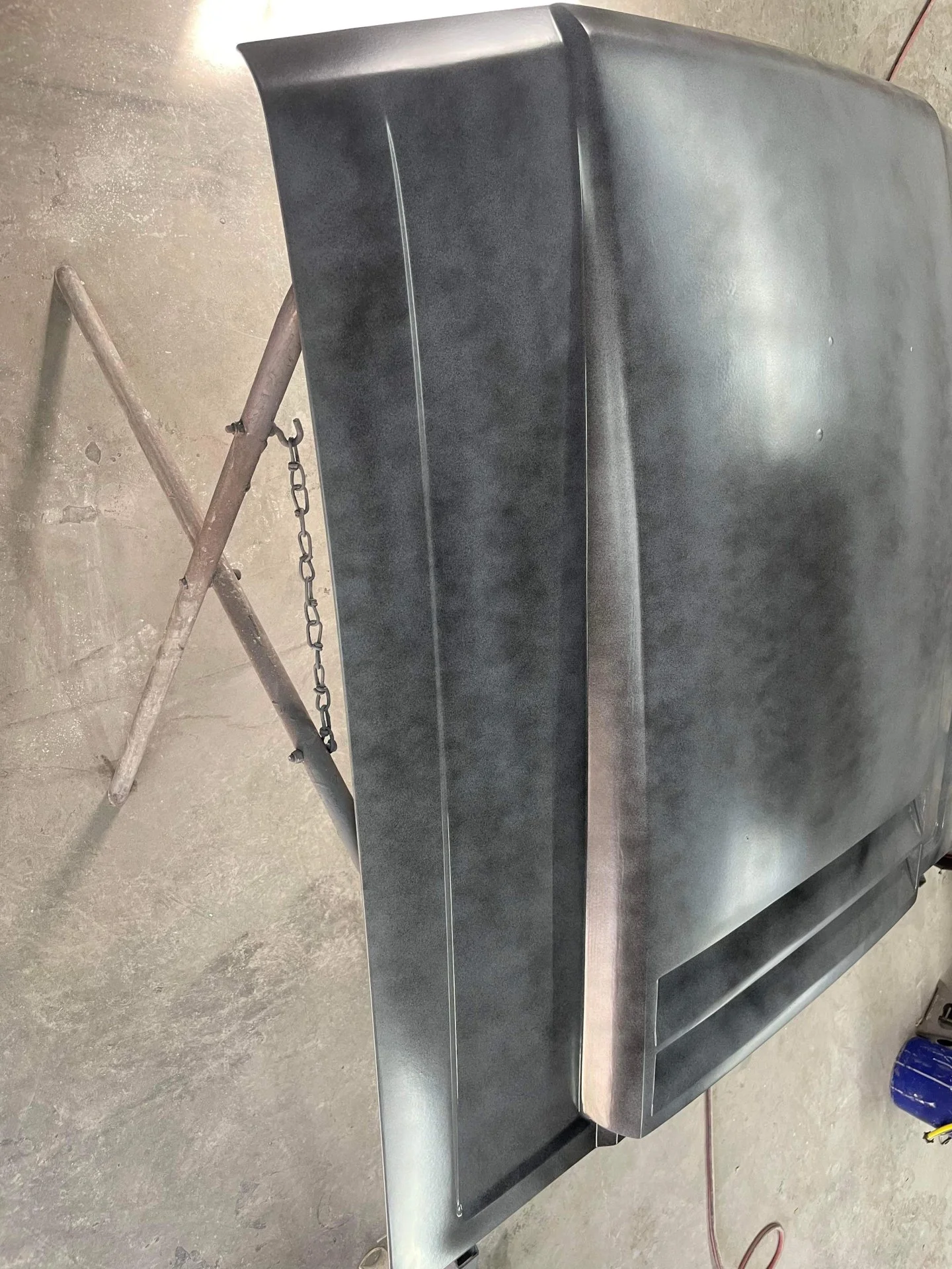

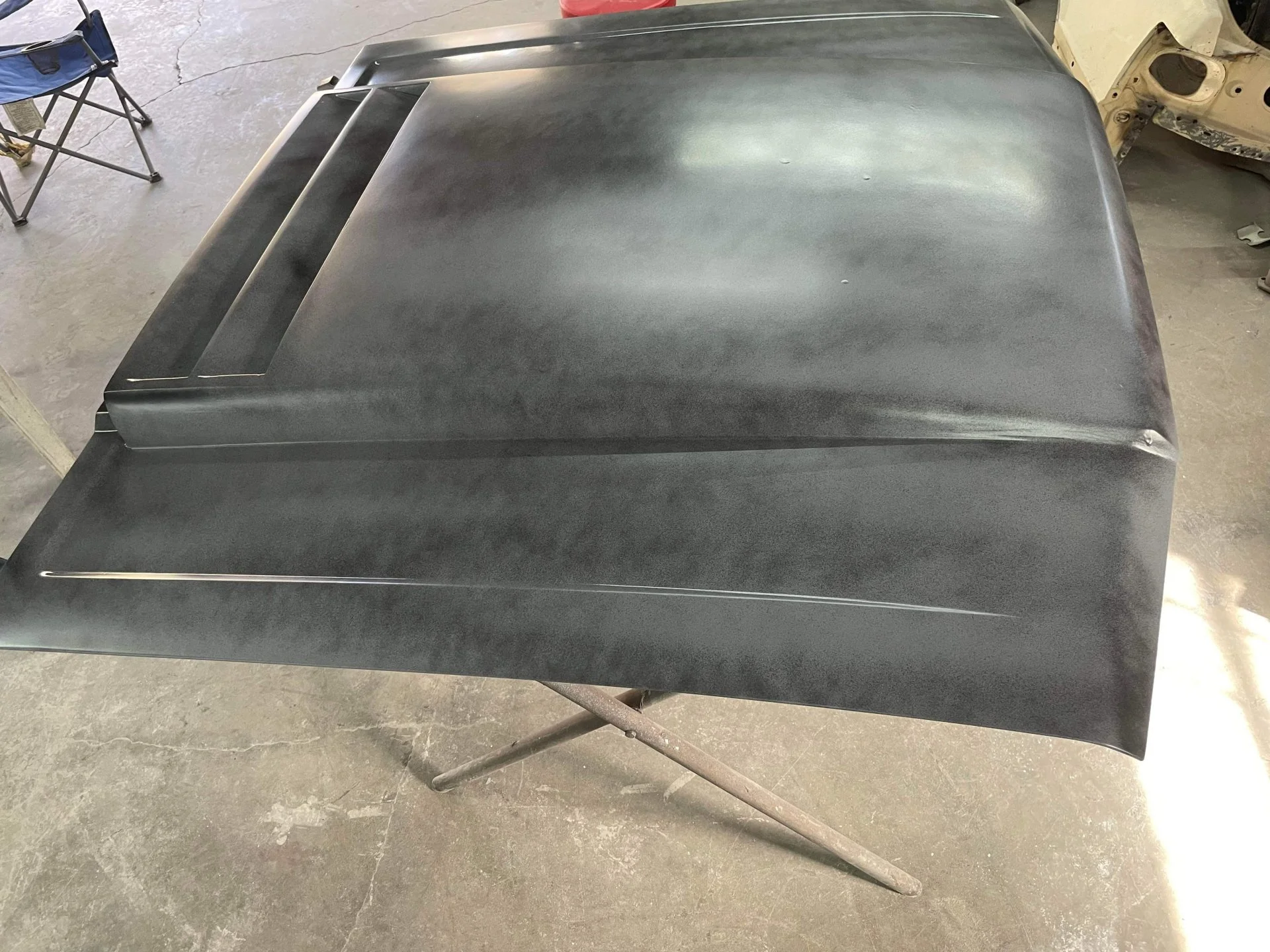

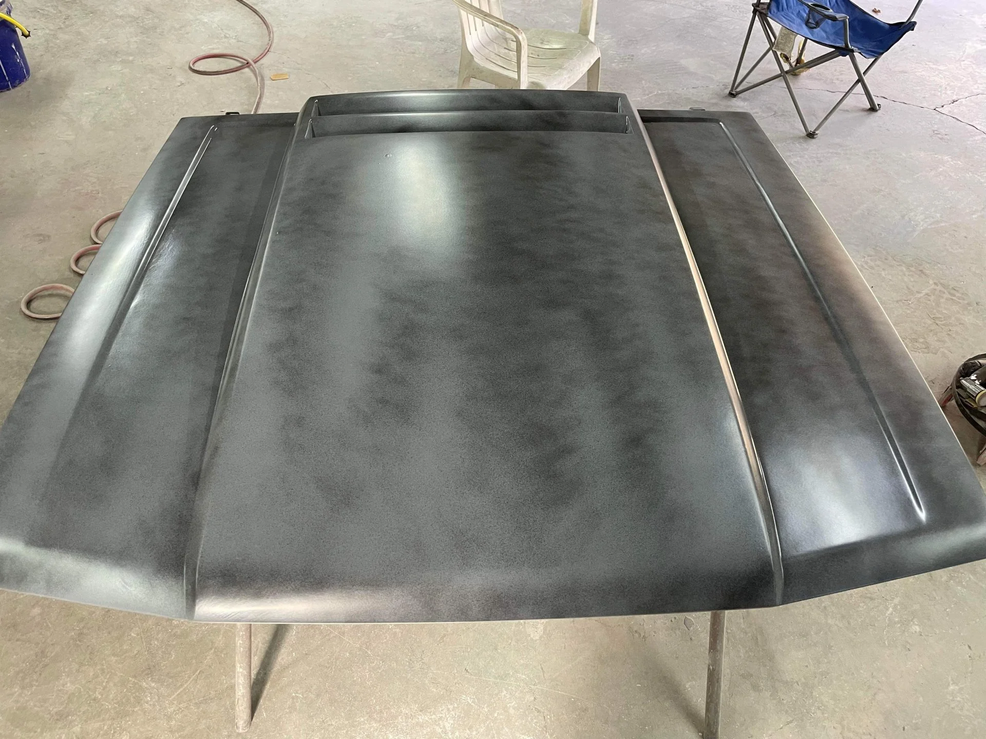

Hood time. The scoop was pretty rough had tons of layers of Paint.. the hood was no gem..

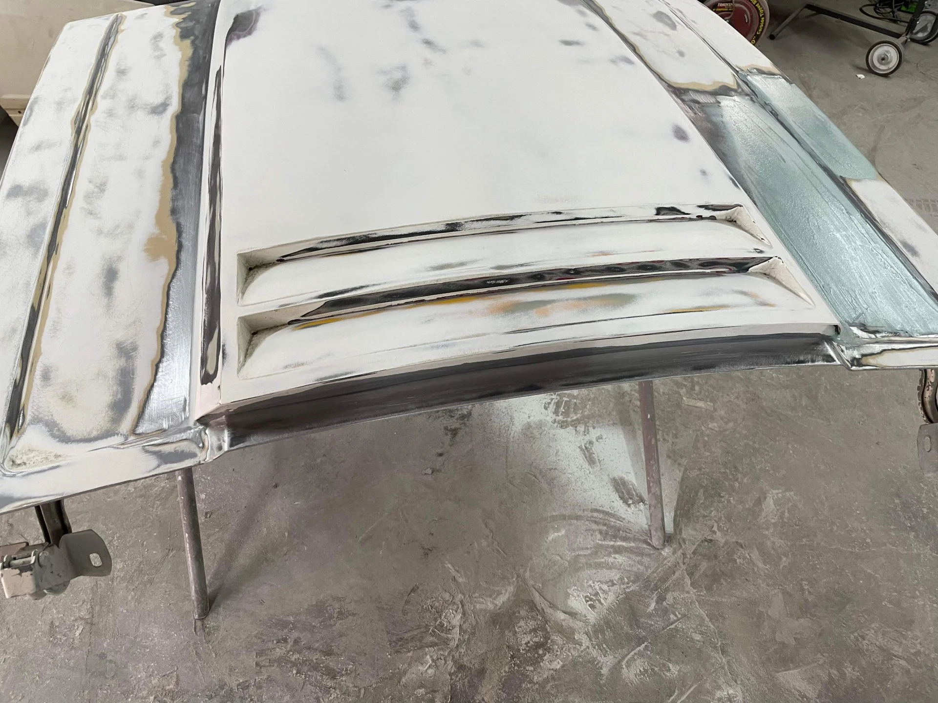

now it’s all molded and on its way to perfection
