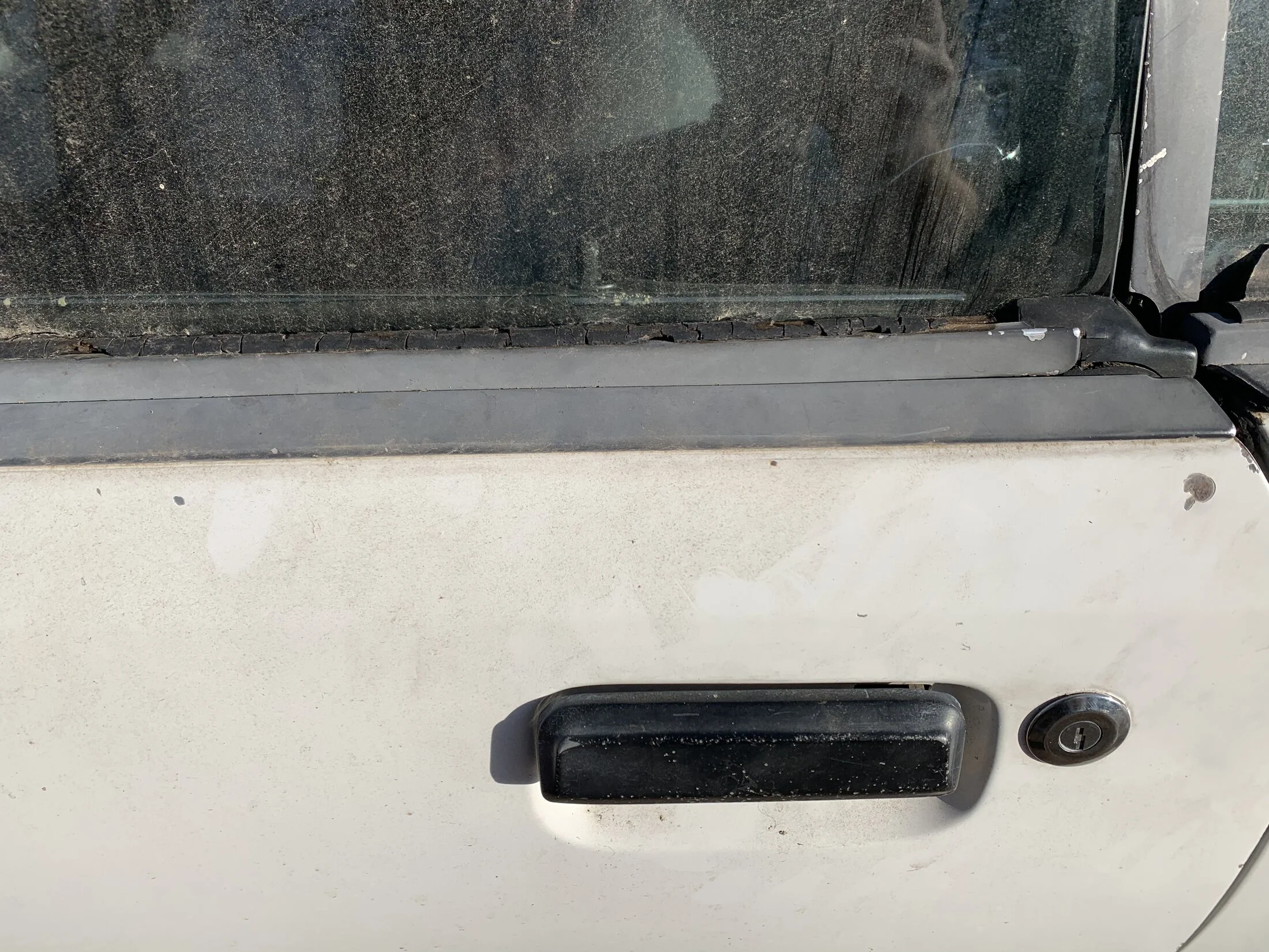

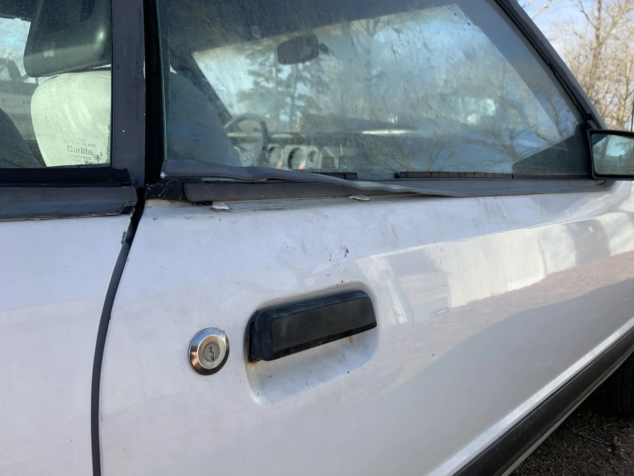

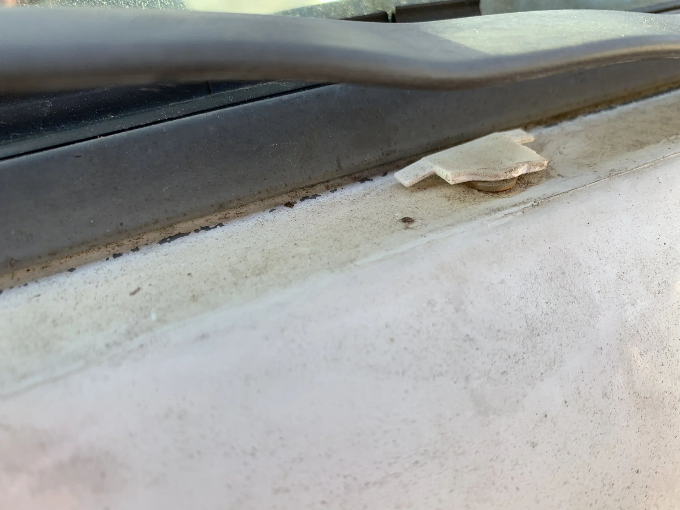

My 85 gt convertible has a “special” door belt molding just below the outer weatherstripping. It’s all bent up (my fault) and I need to remove it and straighten to reinstall. How does this molding actually come off without further damage? It doesn’t slid back or forward to pop off like newer door belt molding. Thanks!
You probably need to remove the door panel and see if you can get a look at them from the back side. They look like push in clip type. They have probably hardened over time.
I've never seen a molding like that on a fox. The clip looks familiar but I can't remember what it was on.
You do have a few options to resecure them. You can use layers of 3m tape or universal screw stud type that use a nut on the back side. I'd rather go the 3m tape route after straightening it back out.
