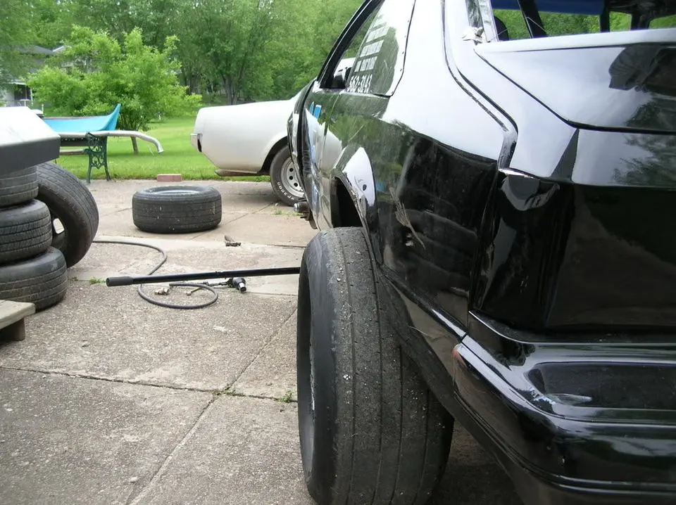

01 gt axles. They are really to long to run rear brakes so i plug off the rear brakes so these are this length without drums. They are aero 15x8 rims with a 4 inch back spacing. I should have went with 5. But the rear tires stick out a good bit more than the front and i couldnt imagine what it would look like with drums on. Not sure the size of the tire

yeah if you got 6 in back spacing it would sit in there more, but i have about 2 inches before i get into the qaud shock. Then once you and the drum youll stick out some more. And if you go with ranger drums with the 01 axle youll have to grind out the center of the ranger drum. Have fun with that. Really its just best to pick up some ranger axles. It will look stupid with your rear wheels sticking out and your front wheels tucked under.
