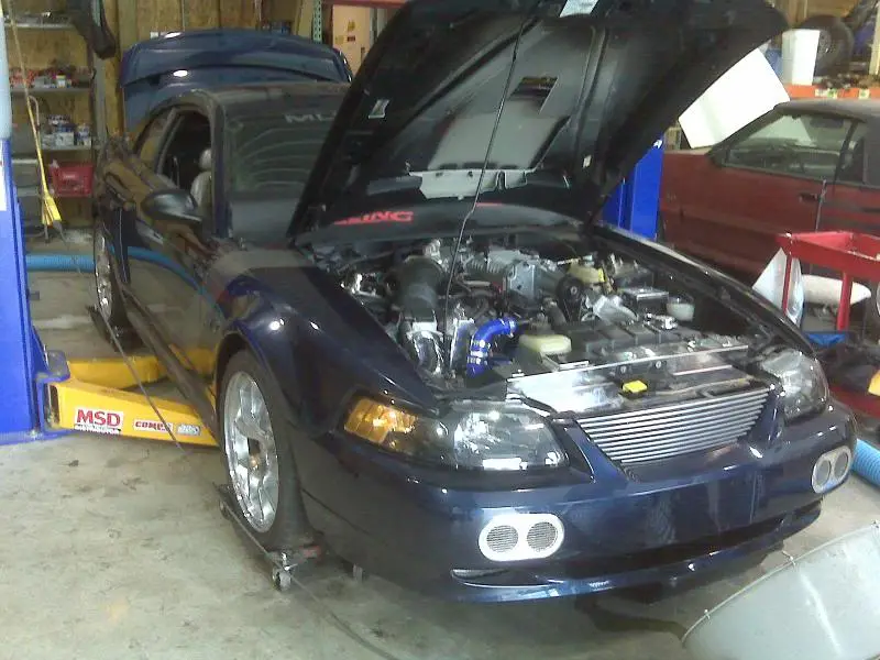

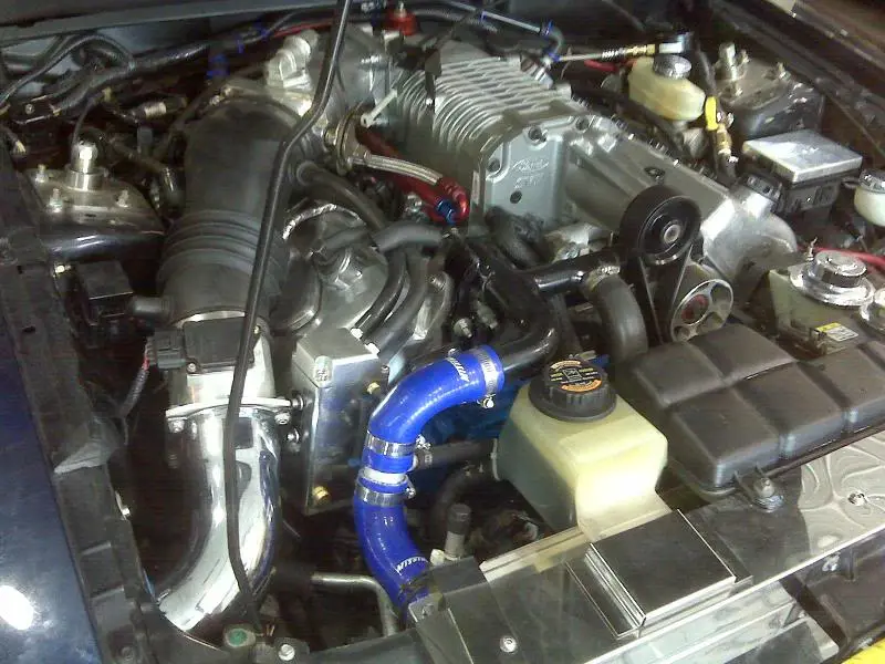

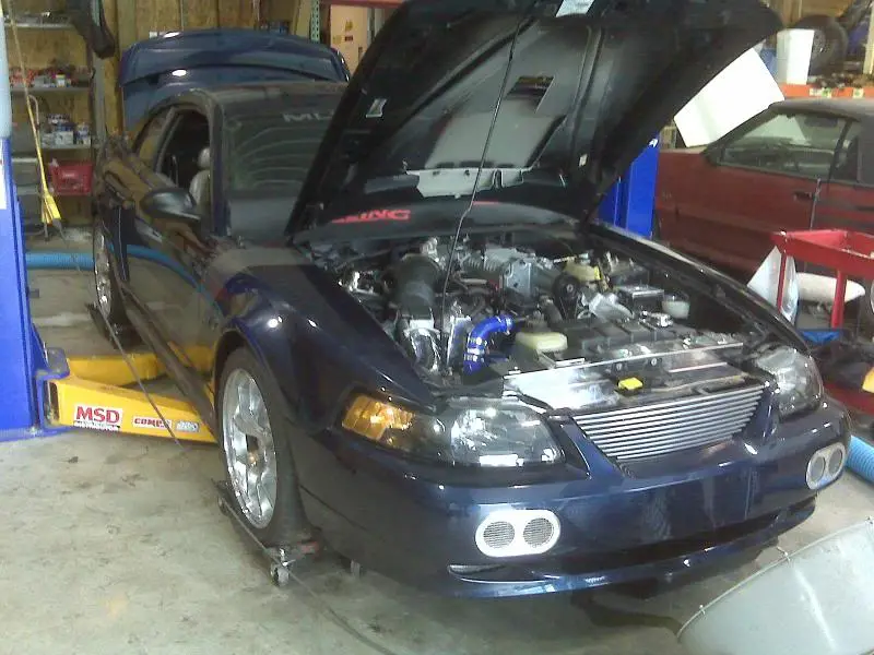

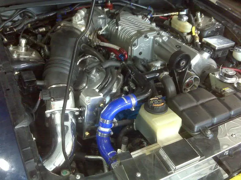

Just thought I would share what I get to tune in a couple weeks , I put a start up tune on it Saturday so the FR500 cams can get broke in and drive it around to seat the rings before we put it on the dyno
Alot of work has went into this , and guy wants to see if one of the magazines wants to do an article on it

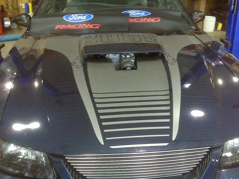

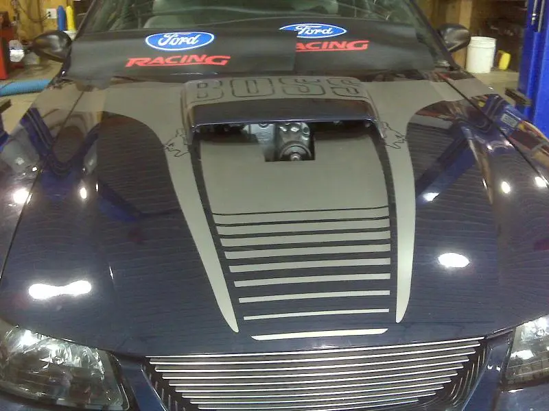

Other than the retarded BOSS graphics and whatever the hell those are on the front bumper, it looks decent. The motor is badass.
Never seen so much hate LOL , the car was like this when he bought it , the chrome things in the bumpers are actually holes for brake duct hose for the front brakes , the car was road course raced, I think the owner has plans to do 03-04 cobra body parts on it once the car is back on the road

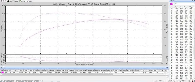

well we finally got it on the dyno today , we got a baseline tune on it so he can drive it more to bring the engine in , the rings have not seated yet so we may get more aggressive with the tune in a few weeks

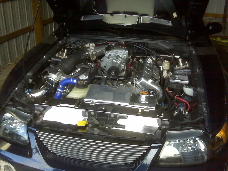

It fell way short of 600 and even short of 500 by a good bit , I have no doubt with more aggressive tuning , porting the blower and better elbow for the TB that we could get closer to 500 but I think the biggest problem is the 03-04 cobra blower is too small for the 5.4 and DOHC heads , this thing is making close to GT500 torque numbers but the HP is low because the boost is dropping off after 4300 rpms from 15 down to 10 , oh and by the way , if anybody does this swap the IAC valve goes on as pictured in this picture
429 RWHP 509 RWTQ
