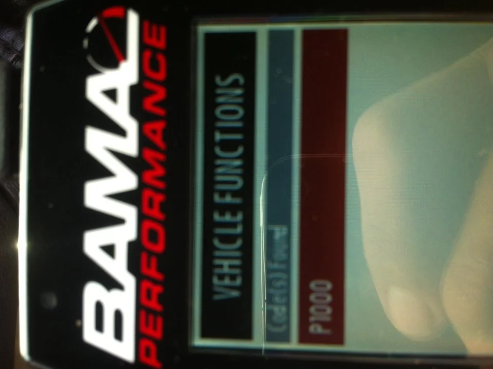

Both the tuner and o'reily found the code P1000
Ford P1000 DTC Drive Cycle
Clear the codes with the scanner and drive it normally. DO NOT clear them before running the scan, finish the test to the end and don't unplug the scanner mid scan......
Otherwise it may be mechanical, like a bad converter
Wow. It's like a brand new pony. It takes off quick and when I turn or come to a stop it no longer stops while revving. The sluggish feel is also gone. All with the street tube and clearing the p1000 code. Can't wait to try the race tune.
