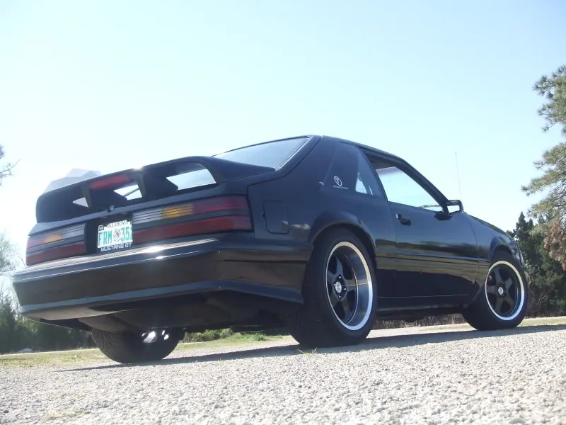

here is the car. since this pic, visually its got a 2.5" cowl, smoked head/tail lights.
Are we talking about the Fox style Saleen wheels or the newer slim spoked Saleens? Either way go with the Saleen theme. Honestly want to build a clone after seeing your car.
I'd go with the chrome '03 Cobras. Not sure what saleens come in 17"...prob the fox style right?
If you are concerned with staying with an all Saleen theme, then you should prob remove the side stripes. Those are SN95 fader stripes and are incorrect on a Fox
im not worried about staying 100% saleen correct. i just didn't want to hear it from the fobra/faleen people.. it was a faleen when i got it. so i loosely try to keep it oriented there.

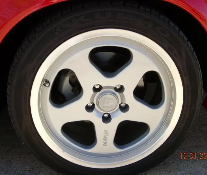

Those rims American Muscle sells are loosely styled after the 90-93 Stern/Speedline Saleen wheels put on the Fox Mustang
Wheather you get the Speedstars or the SCs I would say Saleen. I loke the Cobras on the Fox but since the car is "Saleened" already I would keep the theme going. :nice:
