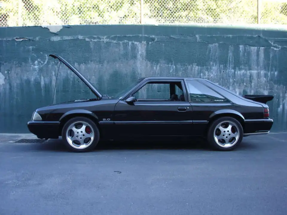

Mach 1 springs here. F&R. I do have adjustable rear arms, so ride height out back has been tweaked a little. No isolators up front.
Ride is firm, but not harsh. I like it a lot. Plus it's nice to be back at a decent ride height where i can actually turn my front wheels without rubbing, or banging my h-pipe on speed bumps.
Feels like a normal car again...not some lowered POS i am afraid i'll break on the next pothole

Yeah, that's what I wanted to avoid. I have mm adjustable rears, so I wanted the front to be slightly lower than the adjustment range I had. I've lifted the rear a bit since the pic, and have a full size spare in the trunk, so when I finally find a cheap 17" spare, I'll prob have to bring the rear down a tad
