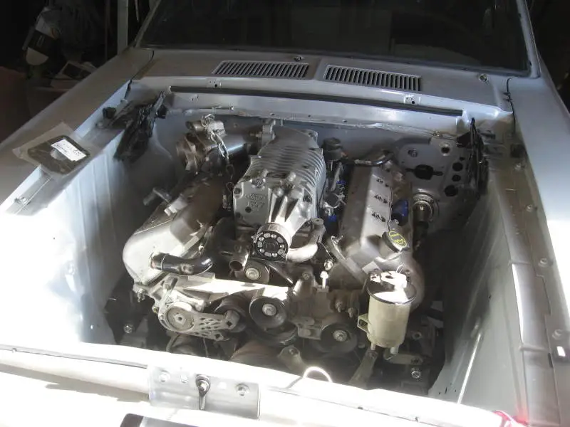

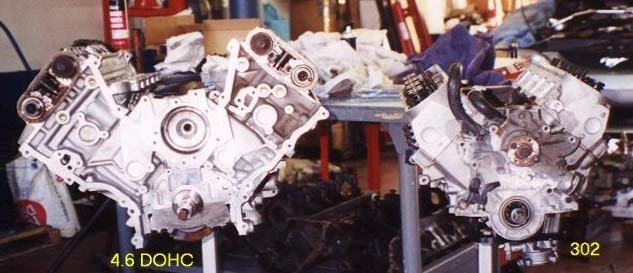

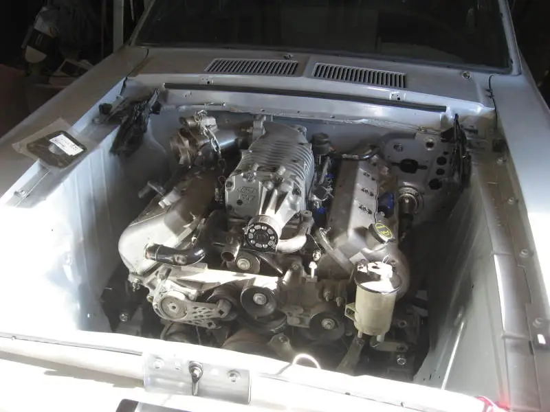

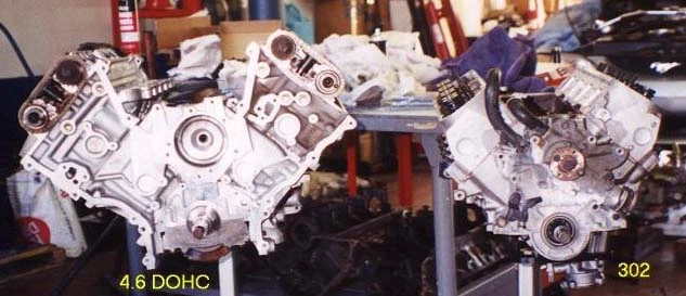

I'm putting a 4.6 dohc in my 67 coupe. I'm using the complete drivetrain from a 2003 Cobra. The DOHC is wider than the 2V but they are both very wide. I wouldn't do this swap again. If I had used a 351 based stroker it would cost less and I would probably have the car finished by now.
