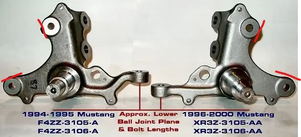

When I did my Sn95 spindle update on my 83, Member 5L5 on here cautioned me to make sure the caliper or the bracket was not rubbing on my " new to me" spindles . Sure as heck, two spots on each one... Just a smidge that you might not notice without looking.... Couple of scuffs with a grinder takes care of it..
Be advised......

Yes, if installing 99-04 GT calipers on an 94-95 spindle, you need to clearance the ears slightly for the caliper pistons. Mock it up on bench first and you will see where they contact.
Basically you are removing a little material in side the red lined areas because the two pistons will sit in this valley and contact them.
