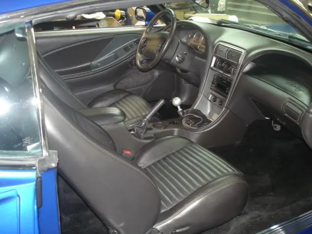

I'm a big fan of the SN95 dash in a classic.
Here's the finest example that I've found, in a 69.
The full buildup of this awesome machine can be found at
http://www.svtperformance.com/forums/showthread.php?t=246184 (you have to register to view)
