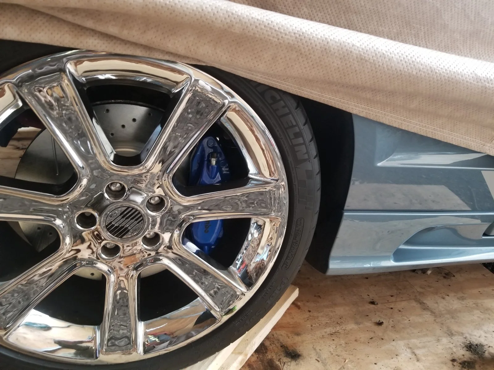

Doing the 2011 gt brembo package brake upgrade to my 2005.
Drivers side assembled easily, fits perfectly.

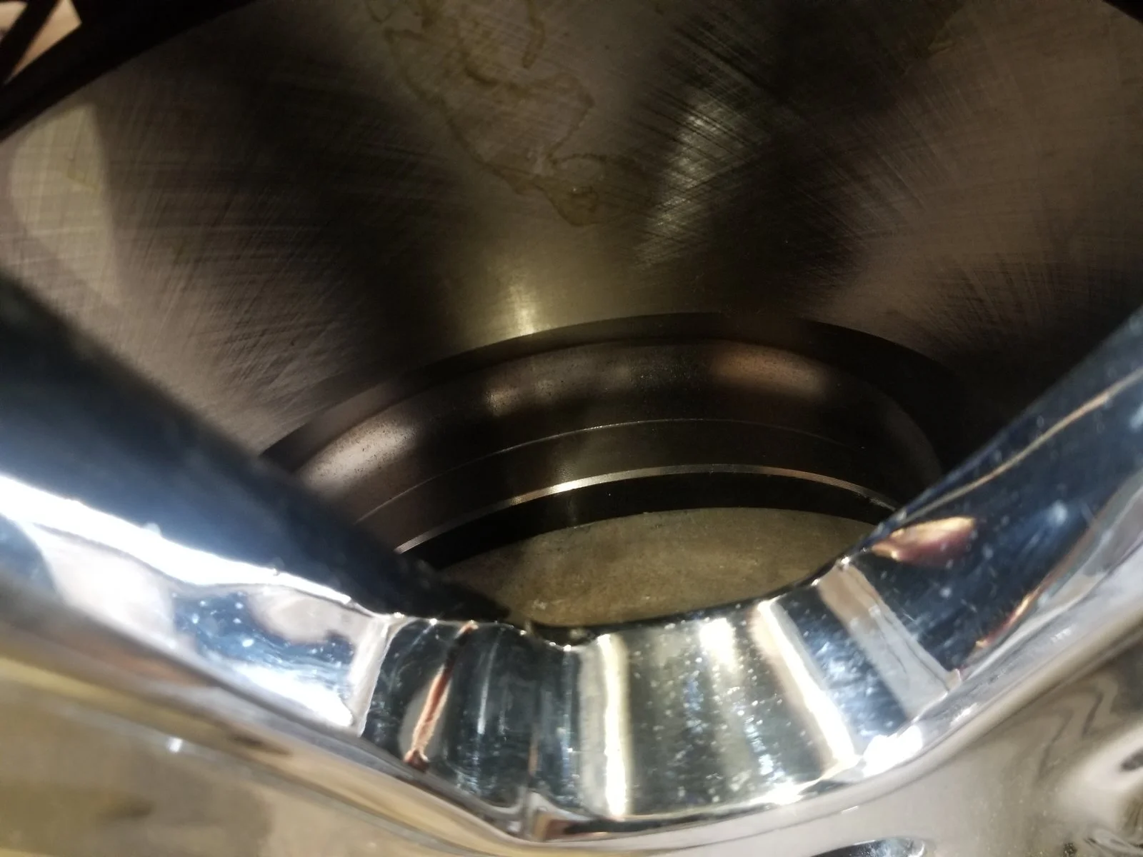

Pass side wheel hits caliper no clearance! Needs about another 1/4" so it wont hit. Am I missing something obvious? I tried another rotor to double check. Still didn't solve the problem! I'm loosing my cool here, any help is appreciated.
1st pic is drivers side

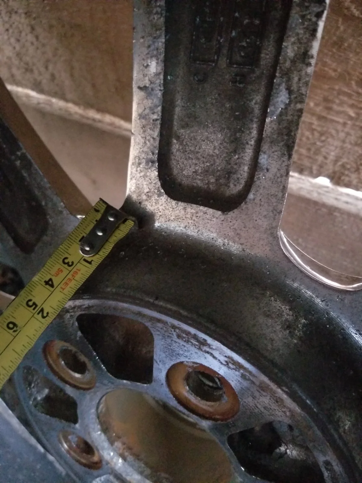

2nd pic is pass side & the space needed between wheel & rotor to allow clearance.
Cars a 05 saleen, 20" wheels, low miles, no accidents, no bent wheels.

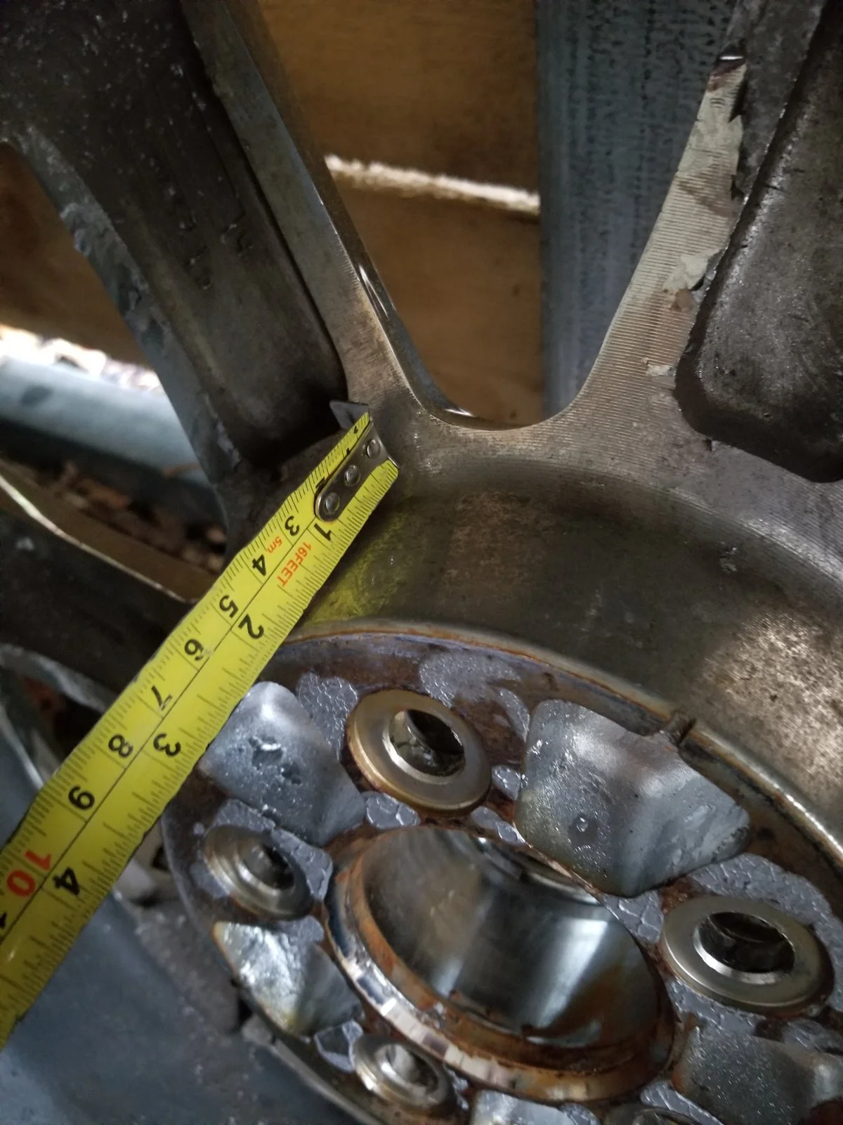

After a lot of parts swaps and head scratching....
The wheels have 2 different offsets. The drivers side had more than the passenger side does by 1/4" both front and rear wheels.
So my thoughts are...
A. When I got the wheels balanced last yr they mixed up & or rotated.
Or
B. Saleen intentionally did it to correct the rear end tracking when u lower the car. Its pretty slammed.
Thoughts????
I'm gonna hang a plumb from the rear tomorrow and take some measurements to see if the rear is centered

Same size rims it appears. Def same size tires. Tires look the same on ea rim as far as stretch / bulge.
Some cars came with 20x10 rear & 20x8 front. This car was originally n.a. so it looks like it came with 20x8 on all 4 corners.
