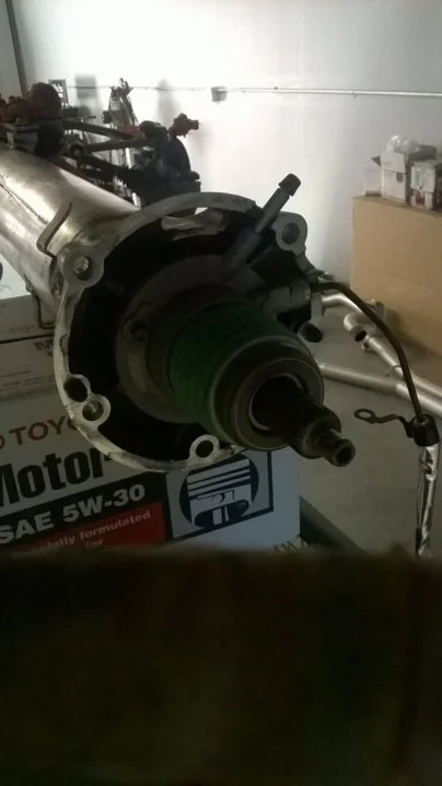

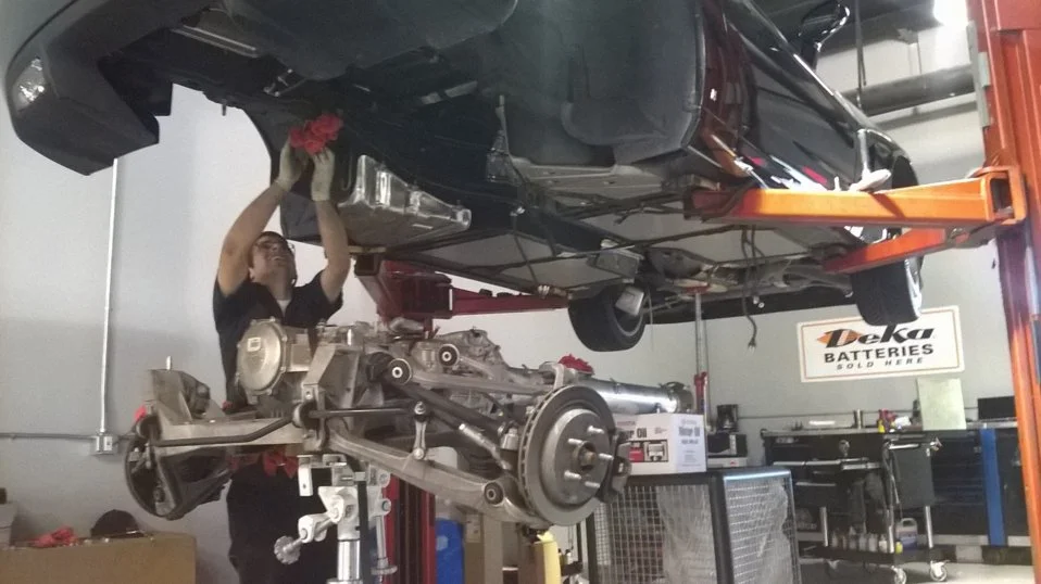

We just had a c6 Vette in the shop, I had to change the Slave Cylinder. It's an 06 with 25k miles on it. Seems like somehow moisture gets in the system after time. Was kind of weird. Normally the reservoirs are located on the firewall near the BB and Master.
