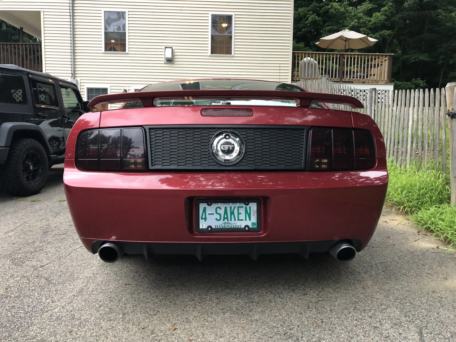

Check engine light came on. P0430 code. Brought to ford dealer to confirm bad cat...and it is. My question is, is there any cheap way out? Everywhere I go is between 700 - 1,000 to replace since you have to replace the pipe from the mid back. I’m NOT mechanically inclined so I can’t do the work myself. I saw some direct bolt ons from American muscle but not sure what would work. Kind of want to keep it close to stock. The car has ford racing gt500 exhaust on it. Any help is greatly appreciated!
