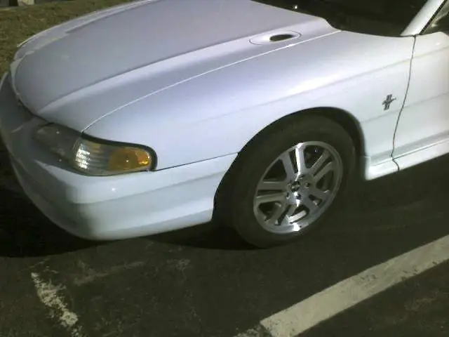

Below is a pic of those wheels on my '96 V6.Sorry for the quality,it's from my mobile.They just don't sit right on SN's.The offset is pretty deep and I've had rubbing issues with the front tires against the swaybar.By the way,the tires are stock 07 GT 235/55/17's and I'm using 1/4" wheel spacers.Way too much IMO.
