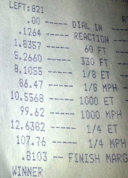

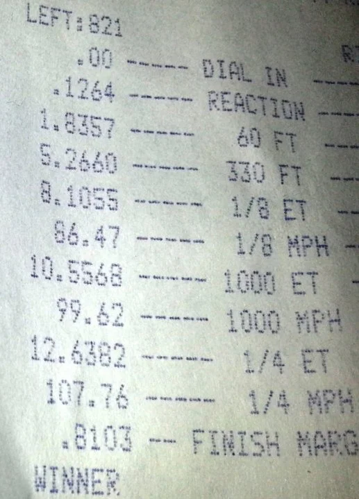

I'm in your class with Black Jack. Best so far was a 12.63 on a 1.83 60' running stock-ish (225/50/16) Goodyear Eagle GT tires.
Anyway, if I were you, I would be looking at a good set of drag radials. Mickey Ts, M&H, Nitto, and BF G all make good ones, and I think you'd be surprised what kind of times a drag radial can pull out of the hole. With some simple suspension mods, a good drag radial, you'll be struggling not to bog with those gears. With your current set up, you might consider going up to 4.10s or even 4.30s. Drag Radials are more controllable (less sway), can be run on the street, and actually have less rolling resistance.
Disclaimer: running sticky tires and more than stock power through a stock T5 transmission will eventually lead to violent tranny death. So, if you're going to do it, avoid power shifting.
