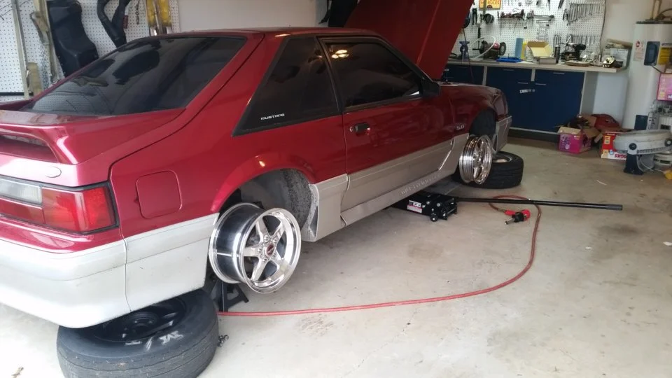

You and me both. Just bought a new set of wheels and I am fixing to buy some new LCA, then I am letting someone who knows more than I do work on setting up the suspension.

Nothing fancy, Just Some Racestars. Like everything else on my car, there is always a compromise with budget. I haven't had my tires mounted yet, this was just a preliminary test fitting.

Pics of wheels ??:)
15X3.75 up front with MT Sportman skinnies, 15x8 in the rear with 27X10.5 ET streets.
I will eventually pick up a set of 15x10's and deligate the 15X8's to wearing some 555rs full time. This car sees maybe 1000 miles a year, so I think the skinnies will become it's normal shoes.
