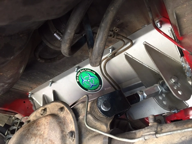

You will want to check the suspension geometry judging from that picture. Without seeing the ride height it's hard to say but I would guess that your instant center is in front of the car with the upper control arms in the top holes

Good eye. The shop that I took it to for the welding installed them there even though the instructions said the stock position was in the center holes. Ive since replaced the uppers for some regular tubulars and put them in the center hole. Fixed some vibrations because of that
