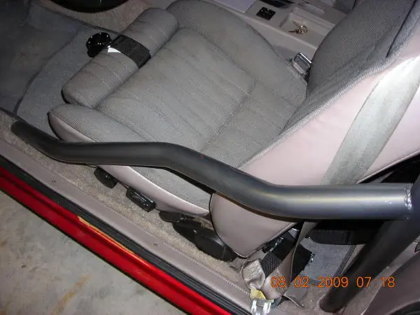

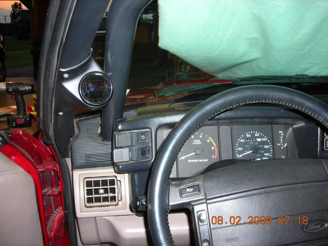

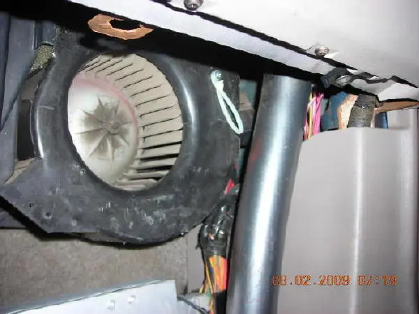

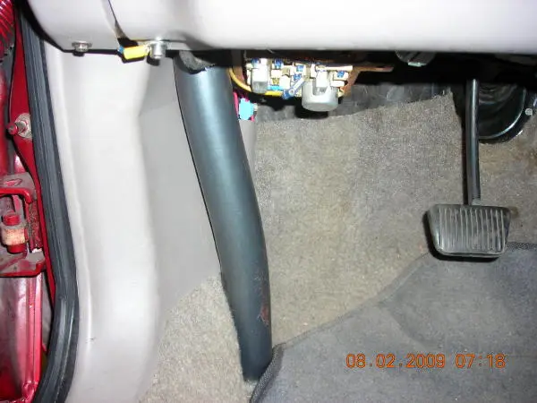

I did mine and yes the vent ducts have to come out and part of the duct work for the heat/AC. Also you will want to remove the ecu from the kick panel before welding the tube to the floor, depending on where you locate the tube attachment point on the floor you might not get it out after. Another suggestion, see if the installer will bend the bars to clear the arm rest. If not you'll have to notch them or remove them. I bent mine and it looks way better. Hope this helps. Mike

How much work is done to the heat plumbing? Does it remove the ability for the heat to work in those side vents?
Thanks for the help! Got any pics?
OK let's see how these pics turn out. Bone Stock, I do get heat however it comes out at the top and bottom because of the duct work I had to remove. Mike
