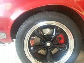

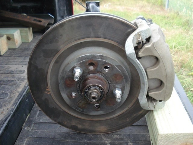

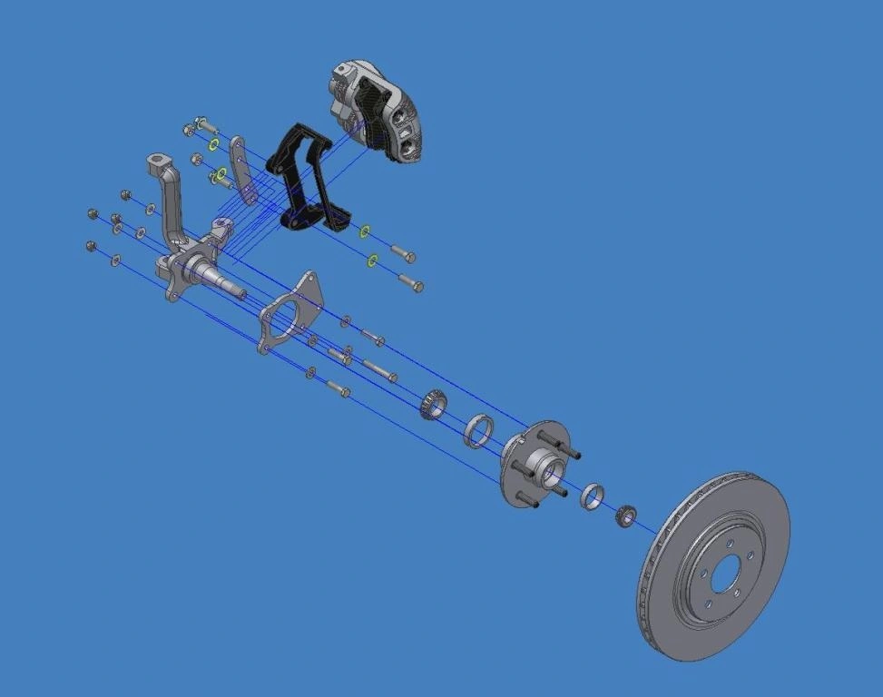

Who would like 12" rotors on 64 1/2-73 mustangs and similar spindles? This kit I made uses your oem drum hub which may need to be machined down 1/8" due to casting differences. It uses sn95 rear studs. 2010 crown vic rotors and calipers for an awesome affordable big brake set up.

The wheels here that they are on a 17" rim. With 1" space reason why a spacer is needed is because this brake kit does not change your track width. So when using newer mustang bullit rims and other new mustang rims a 1" spacer is needed because they do not have proper back spacing

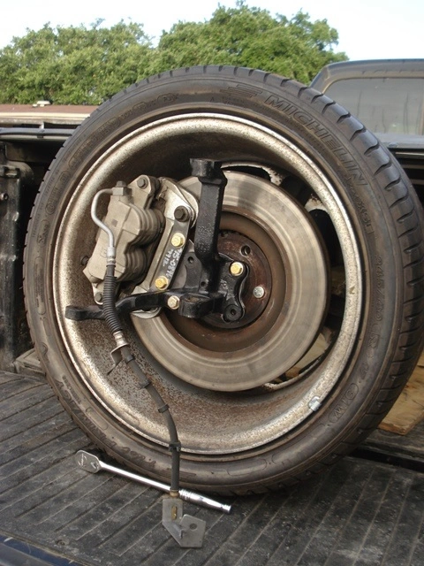

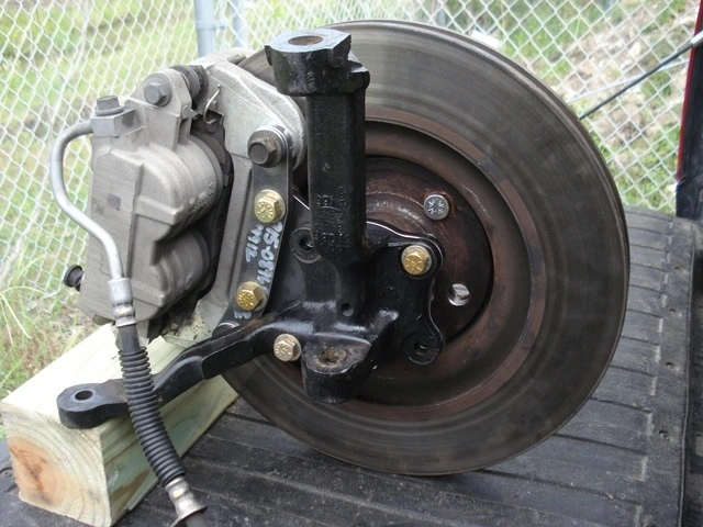

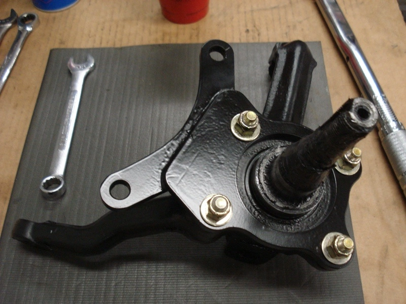

My comment was to Isky. The parts vendor was trying to sell you parts that are absolutely not needed. Factory 65-57 KH disks on an early V8 Mustang is a very easy swap. No special machining or techniques needed. The parts are a simple bolt-on off a donor. The 67 hoses are different where they connect to the chassis but a swap to the 65/66 hoses takes care of that. Thousands of miles on mine (2 cars) with no issues.

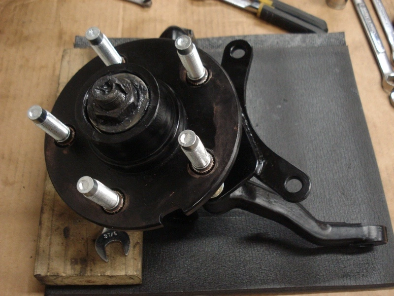

iskwezm Would this be something youd be interested in? I was actually gonna see for the people who have or switched to the factory four piston Kelsey hayes and then later single piston Kelsey hayes. Would want a set up I know whith the early 65-67 four piston set up the hub in the rotor has a greater out board offset though but this would make it easier to source hubs so people with early factory set up don't have to source new or used hubs as well to do their disc conversion. If you wouldn't be apposed to sending the hubs from the rotors I could see how well is works out with the 12" rotors and everything on it. When you send the hub I could also machine down the od of your stock hub if needed if you'd like to do that it's an option.

Dennis, I already have the KH 4 psiton calipers, that my dad traded Corroll Shelby back in the day for.But being manual brakes they feel weak to me(or im used to braking of my 06 GT)
True 74-That does sound cool, but if its increasing the the track width, i dont have a lot of room.Due to being as low as i am, i run a couple degrees of negative camber to get a little room.I might have some old rotors laying around, let me check.
