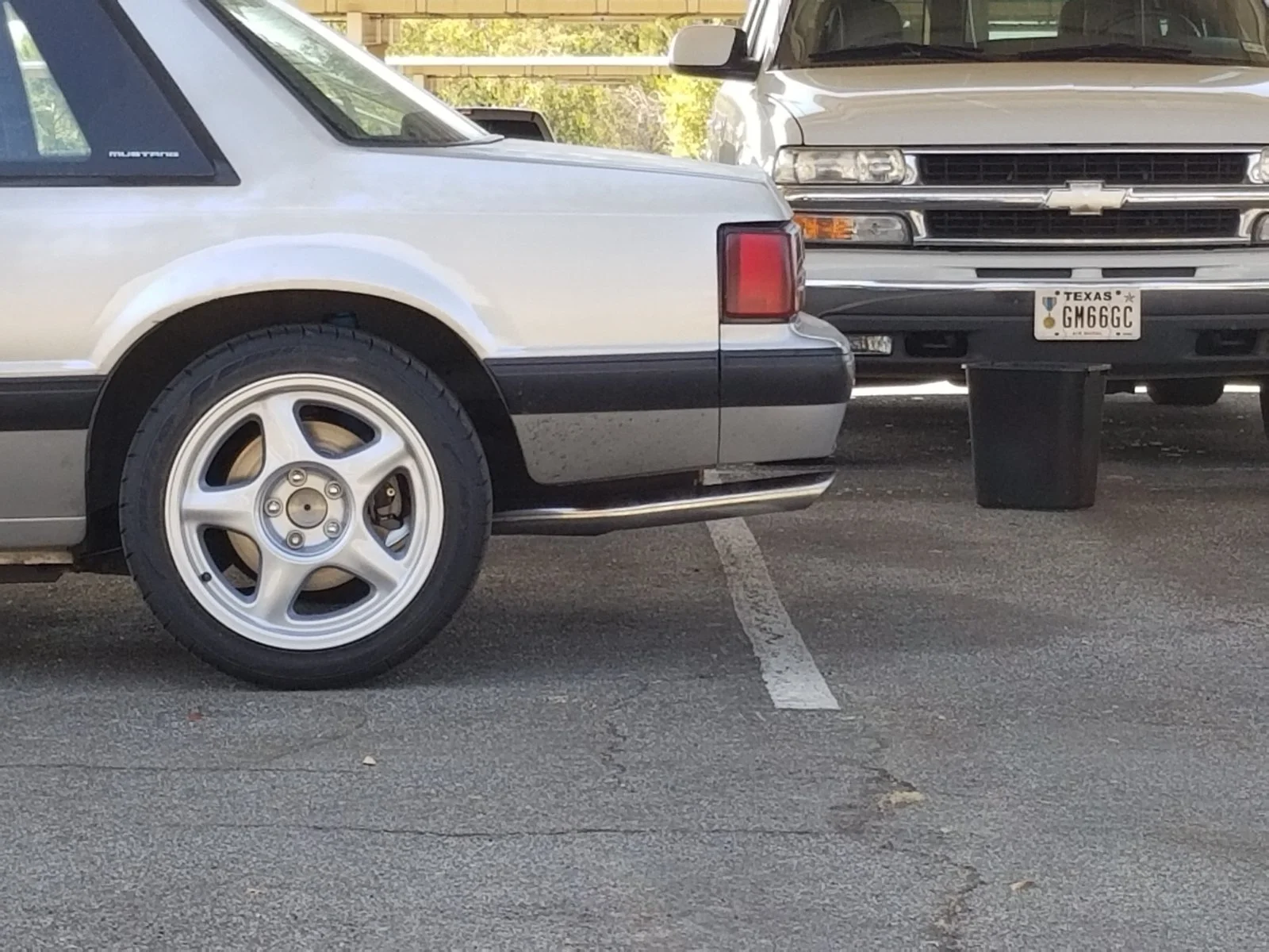

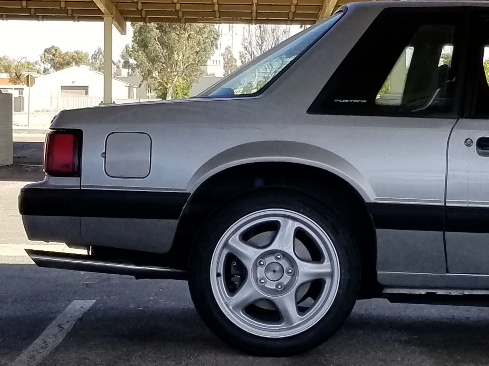

I had the tailpipes pulled down about 3/8" yesterday.
Car is receiving an alignment as I type this.
I may pull the rear Lower Control Arm urethane isolators this weekend as the car sits a little high in the rear.

When you say “pulled down”, what exactly did they do? Just loosen bolts, adjust, and freighter? Or something else?
Seems I’m always fussing with mine to keep them even on either side.
My local exhaust guy cut the tailpipe hangers and welded in an extension thereby pushing down the tailpipes while ensuring their symmetry. They have about a finger and a half of space between them and the bumper cover.

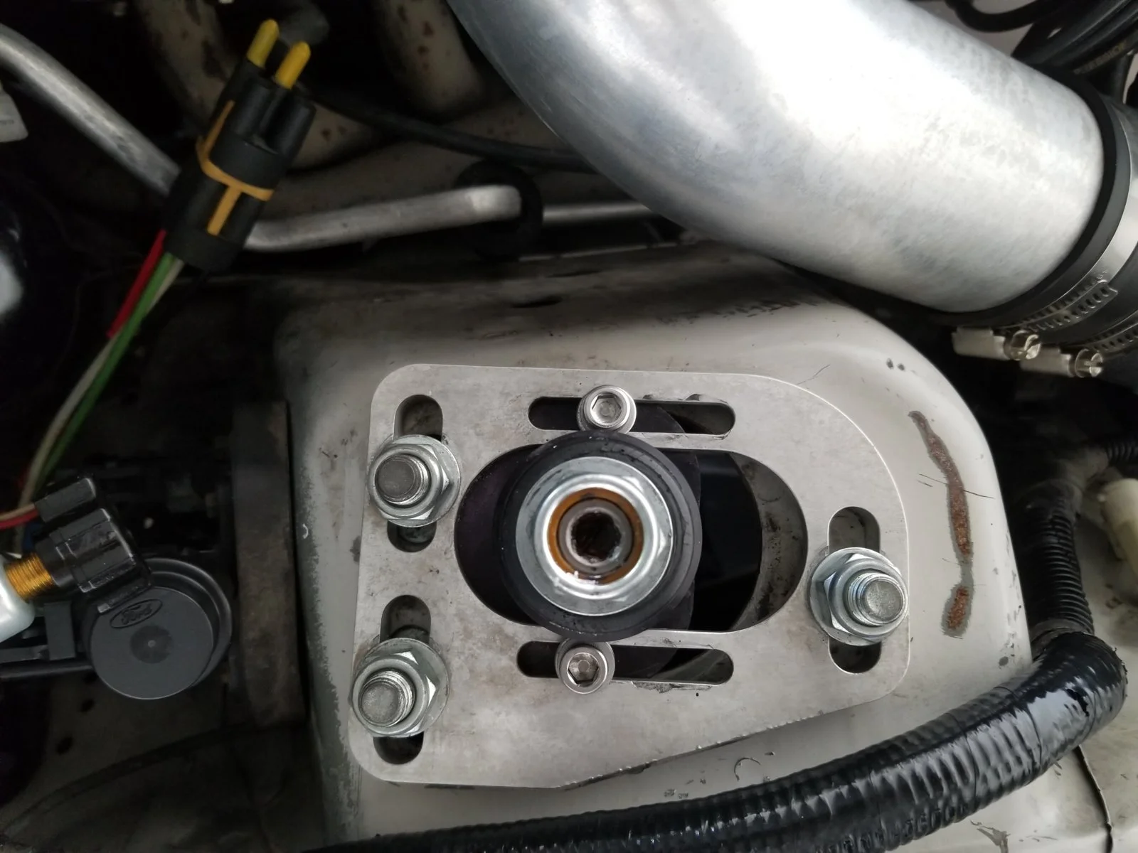

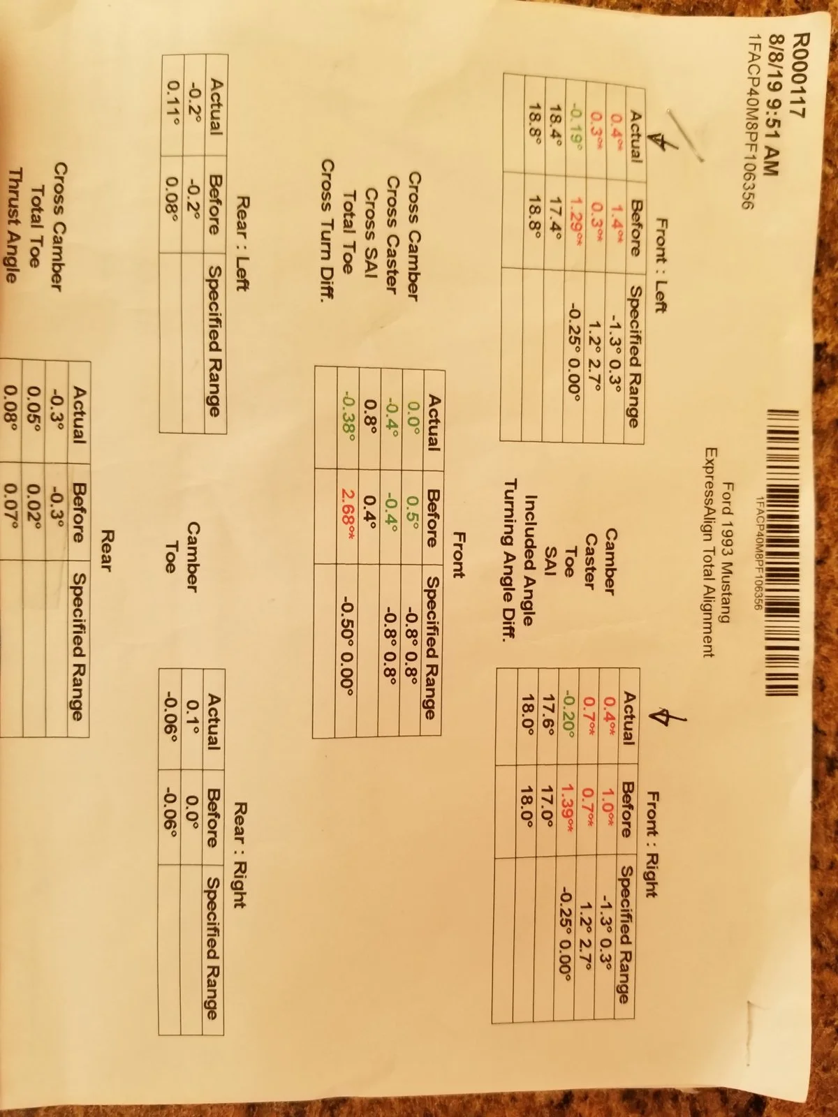

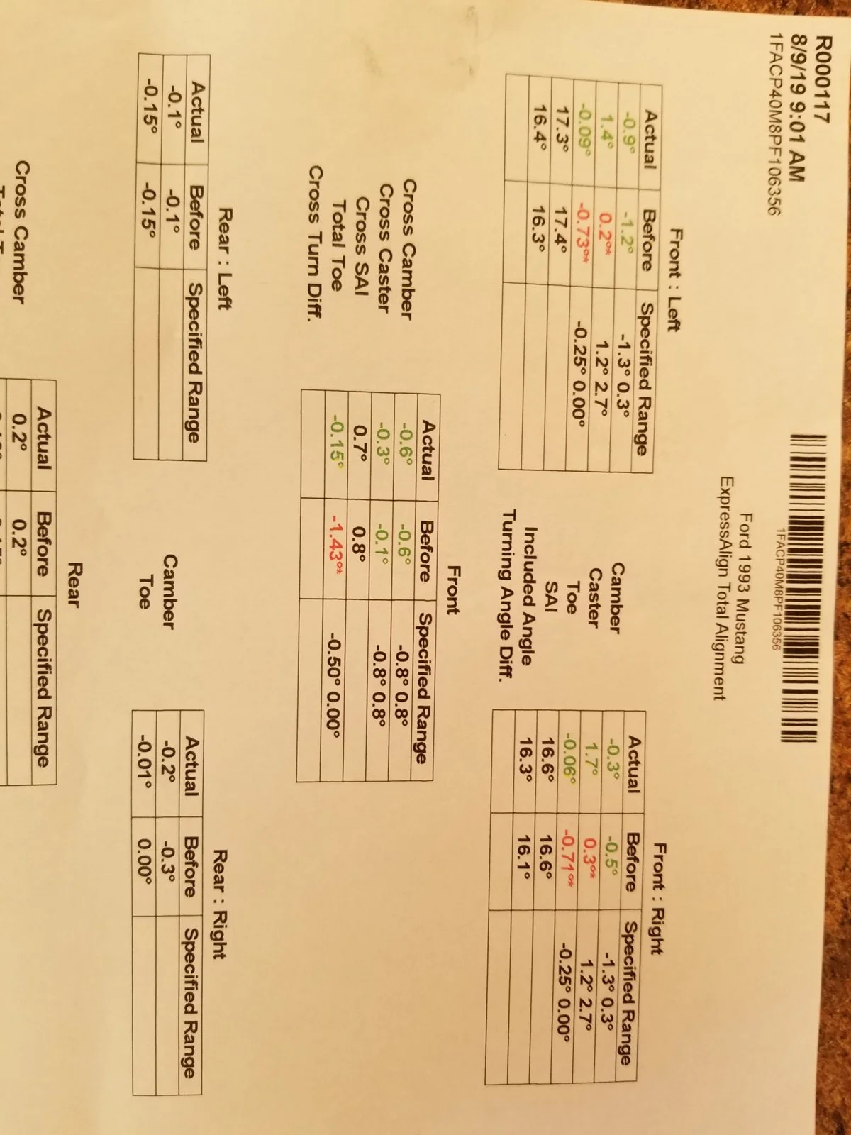

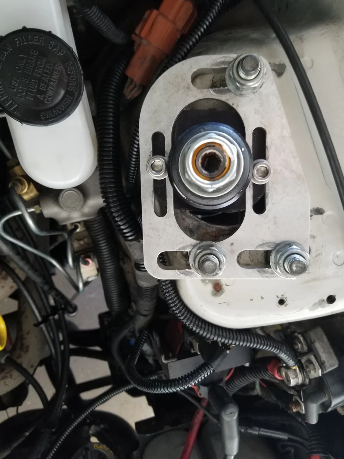

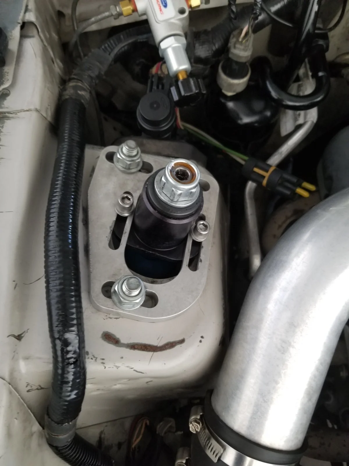

Since completing my brake and suspension upgrade this past week I've been trying to work out some of the bugs. I got my car aligned, but the results have been....underwhelming. Either the suspension shop is incompetent, or my car's frame is very twisted. I'm leaning toward the former as it tracks straight down the road and brakes in a straight line. After speaking with Maximum Motorsports today, yes I talk about them a lot and no I'm not shilling for them, I was told my caster camber plate cups were misinstalled 180 degrees (see attached photos). This was quite a shock to me, but not completely unsuspected. So I'll be pulling the aluminum plates off, spinning the black plastic cups 180 degrees and reinstalling the aluminum plates. Hopefully this will help address my poor alignment issues. In the meantime Maximum Motorsports is graciously researching a competent shop in the SoCal region. Hopefully the cost won't be prohibitive. I'm also going to remove the rear lower control arm urethane isolators as the rear of the car sits too high.
I was thinking over the weekend that this thread could be easily turned into a Progress Thread with my upcoming tune, eventual paint and body work and interior reinstallation after that. Please let me know if you think this is a good course or not.
Ah..i see it. Well that's going to limit your caster setting and make the car feel like it wants to turn when you don't want it to.
Did the first shop give you a printout of the settings?
I don't understand, you say the car tracks and brakes straight, but you sat the alignment is underwhelming? What is it doing to make you feel that? "Underwhelming" is just what I want an alignment to be. When I did my 95, I replaced everything, control arms, struts, tie rods, inner & outer, drop springs and MM caster camber plates, even hubs, I just put the CC plates in the middle of travel to get to the alignment shop. When it was done, I could see the before and after numbers on the sheet, but, honestly, couldn't tell that it drove any different.
