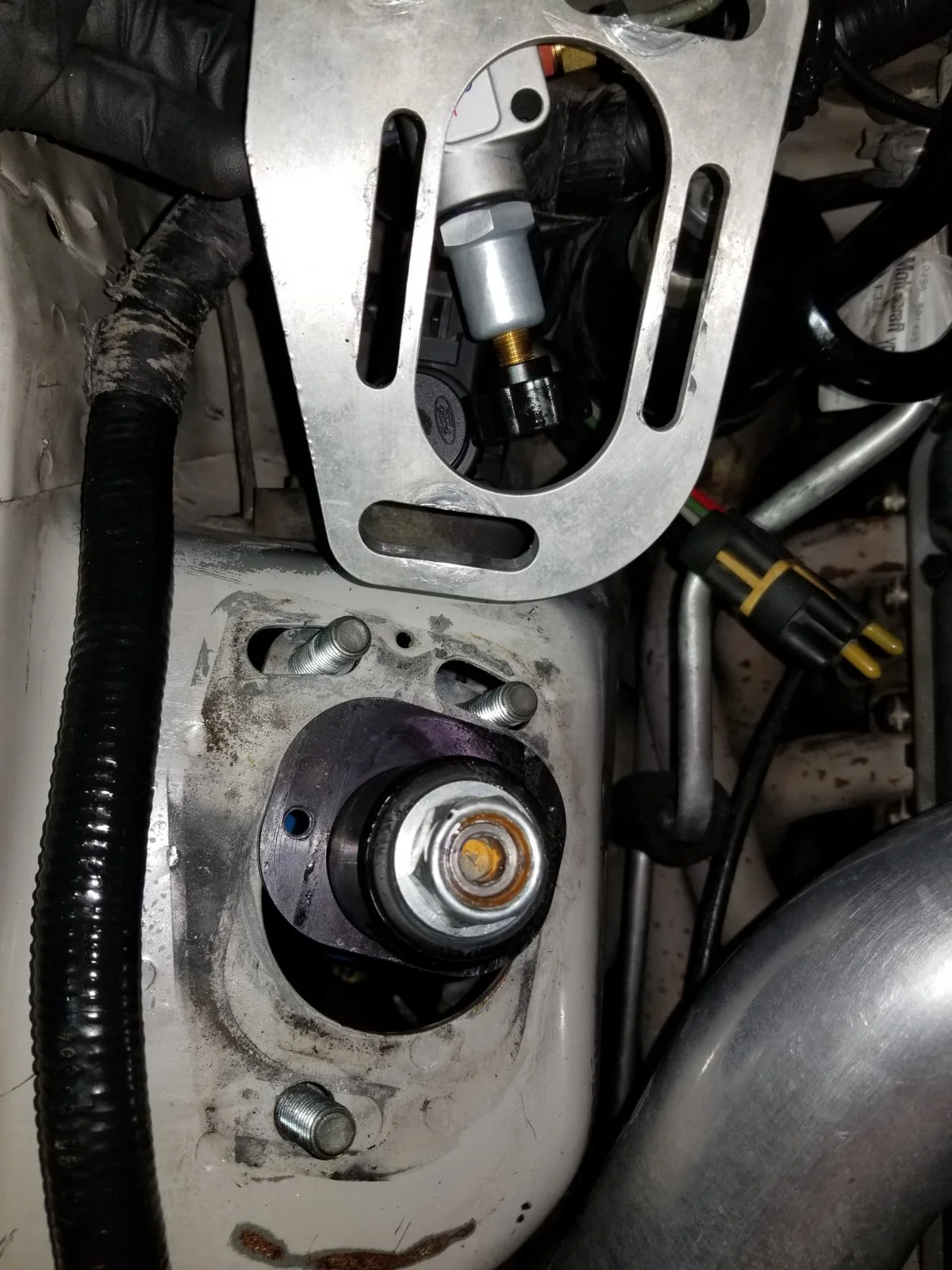

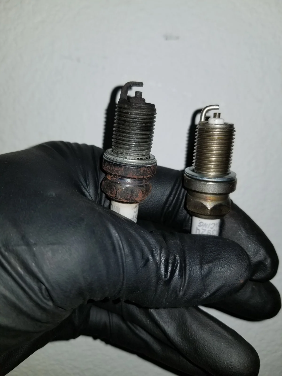

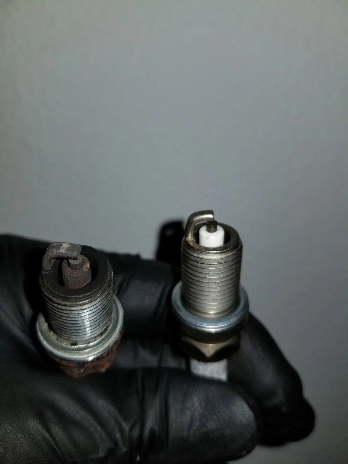

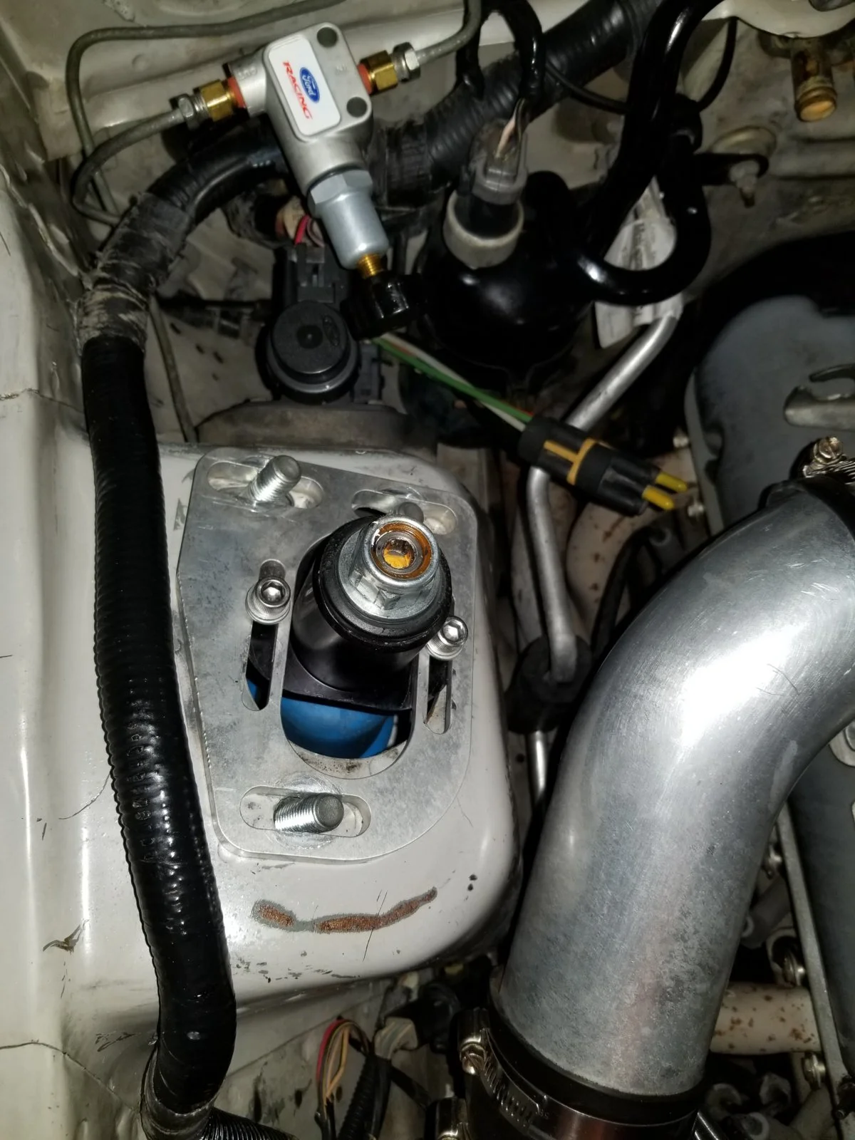

Pulled my rear lower control arm urethane isolators tonight which lowered the car slightly. Also flipped the caster camber plate "cups" around 180 degrees and even had time remaining to swap the driver's side spark plugs.
Is it possible that the car is lower on the driver's side front due to the poor alignment? Otherwise my car would have to be bent and I don't believe it is.

Very rare to find a fox with all 4 wheels at the same plane. Even MM states that setting ride height is a crapshoot. You'll get 3 in a certain spot and one will be way out.
These cars flex just looking at them wrong
Thanks. Removing the rear isolator helped. I think getting a good symmetrical alignment will help as well.

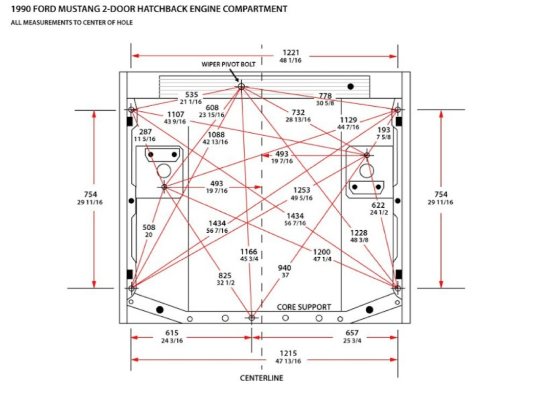

Those camber caster plate positions make me think the k member is not square. Alignment settings can affect ride height but not dramatically.
These are some measurements that can help you telk if the car is twisted or not.
Reactions: darkfader
