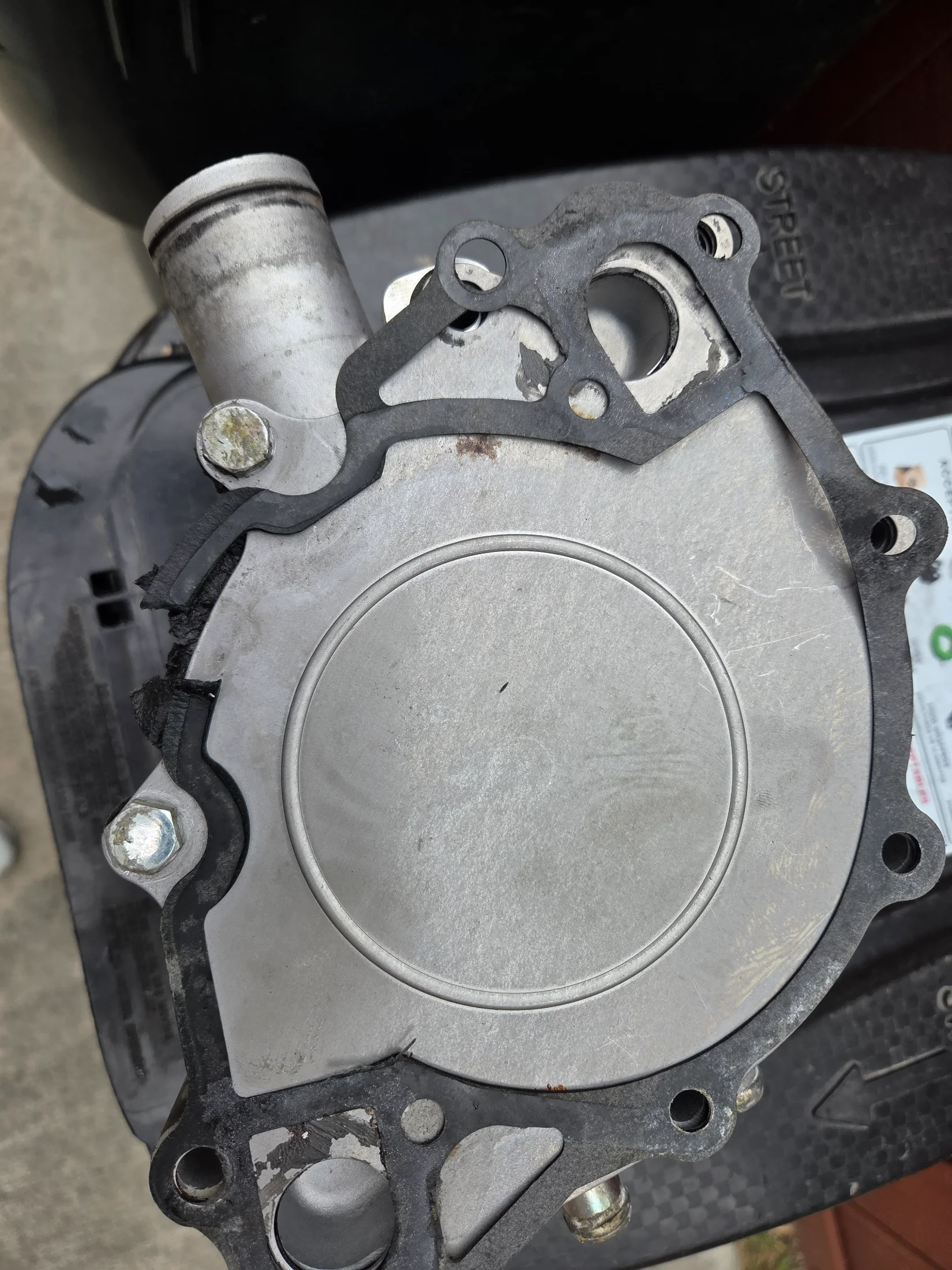

After nearly a month of my car up on jacks doing trial and error on the new Box R intake and replacing the Kirban adjustable fuel pressure regulator with a stock style, I took it for a spirited drive. Assessing and listening the whole time and then got into it a bit. Stopped to listen and heard and smelled radiator fluid belching out the lower front half of the engine just above the main crank pulley. WTH?!?! Nursed it home and looked underneath and it appears that the water pump gasket blew out just above the main pulley. I even added fresh water to the radiator and sure enough it's just leaking out. Is this a thing? Ugh!!

So the only part of the gasket that actually holds water is the parts around the two long bolts i.e. the water passages. If the bottom blew out then one or both of the water passage seals let go.
I just rethought my previous statement and between the water pump backing plate and the timing cover my thought is correct but between the pump and backing plate it could leak everywhere.
I have literally found that after a couple heat cycles you can retorque the bolts on the water pump as they generally need it. Hopefully it was just that.

I'll take photos once I pull the water pump.
Reactions: AeroCoupe

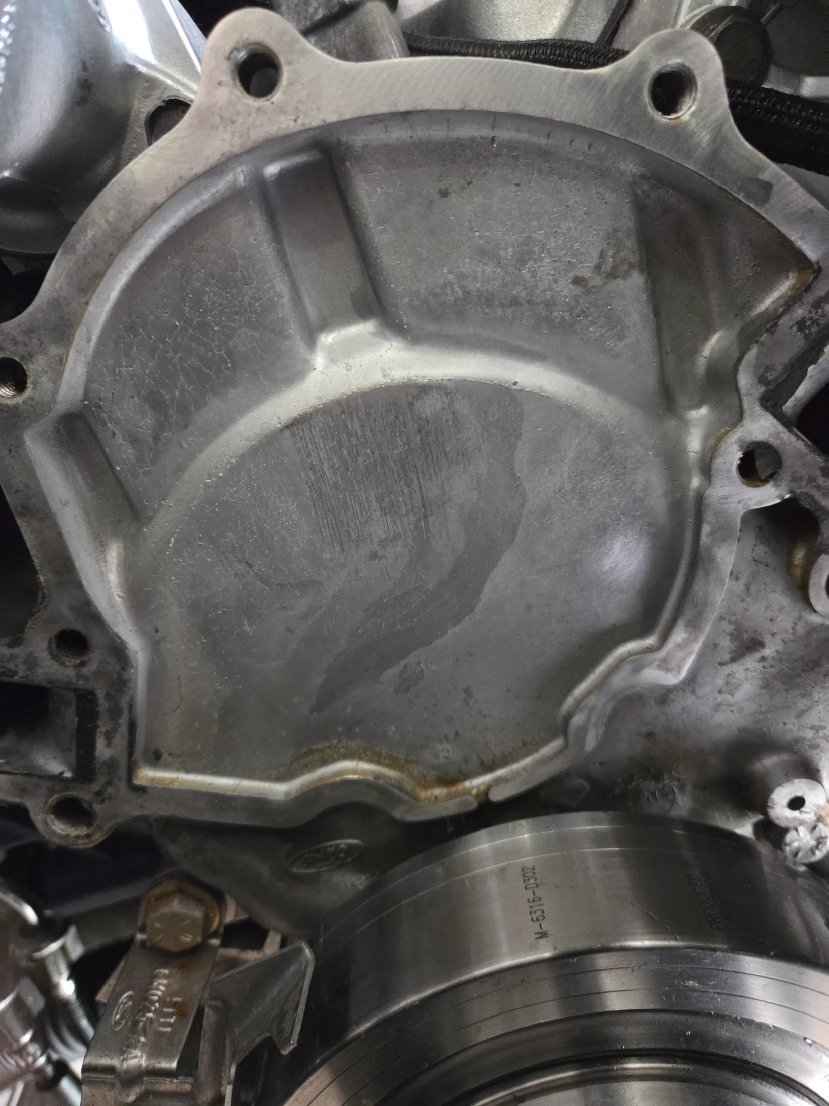

Most definitely blew the water pump gasket. And thinking back for the past few days, l do remember a slight leak ever since initial engine install by my mechanic.
Any suggestions from you all how to reinstall this securely so I never have to deal with a leaking water pump again is much appreciated. Stuff like, dry install or add some sealant? Thanks
