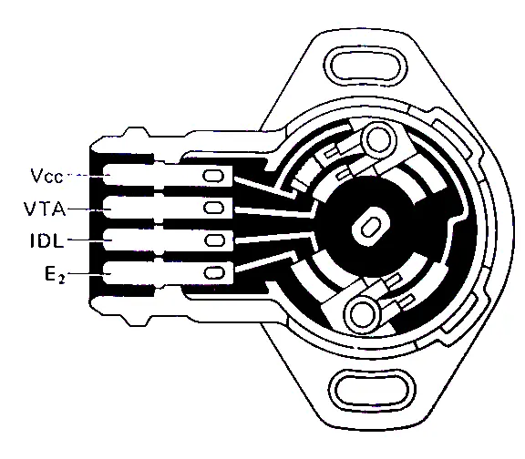

Ive never heard anyone doing that, however as long as the tps is functional and can still provide a "sweep" should be good to go. How much clearance did you need?
Well, my current TPS has no front bolt and still rubs the underside of the hood. I'll probably go big and sand all of that lower oval portion away.
You mentioned the TPS provides a "sweep". Can you expound on that? Your explanation may help in my determination of how much I reduce the TPS height.
Its a potentiometer. Essentially the action of the throttle blade opening and closing provides the ecu with voltage range signal (within .5 to 1.25 v idle voltage) (WOT near 4.6 -4.8)
I hope i didnt confuse maybe "sweep" is not the right word...as long as the throttle blade/tps is free to move you should be alright.
There is a sensor housed in the plastic casing that is made up of a resistor and coil.
If you're shaving just plastic where the tabs are, you should be fine. If you're shaving down the top of the sensor and break into the case that houses the coil then it's toast, even it it works for a little while. If you get through enough of the casing that you can see the "spinny parts" from the top, it's toast.
In your case (and this may sound like a silly idea...
I might try to loosen the hood hinges and latch and try to bump the entire hood [up] juuuuuuuuuuuuuuuuuust a hair. If it works then you can adjust your bump stops accordingly.
I only mention this because it sounds like you need just a skosh.

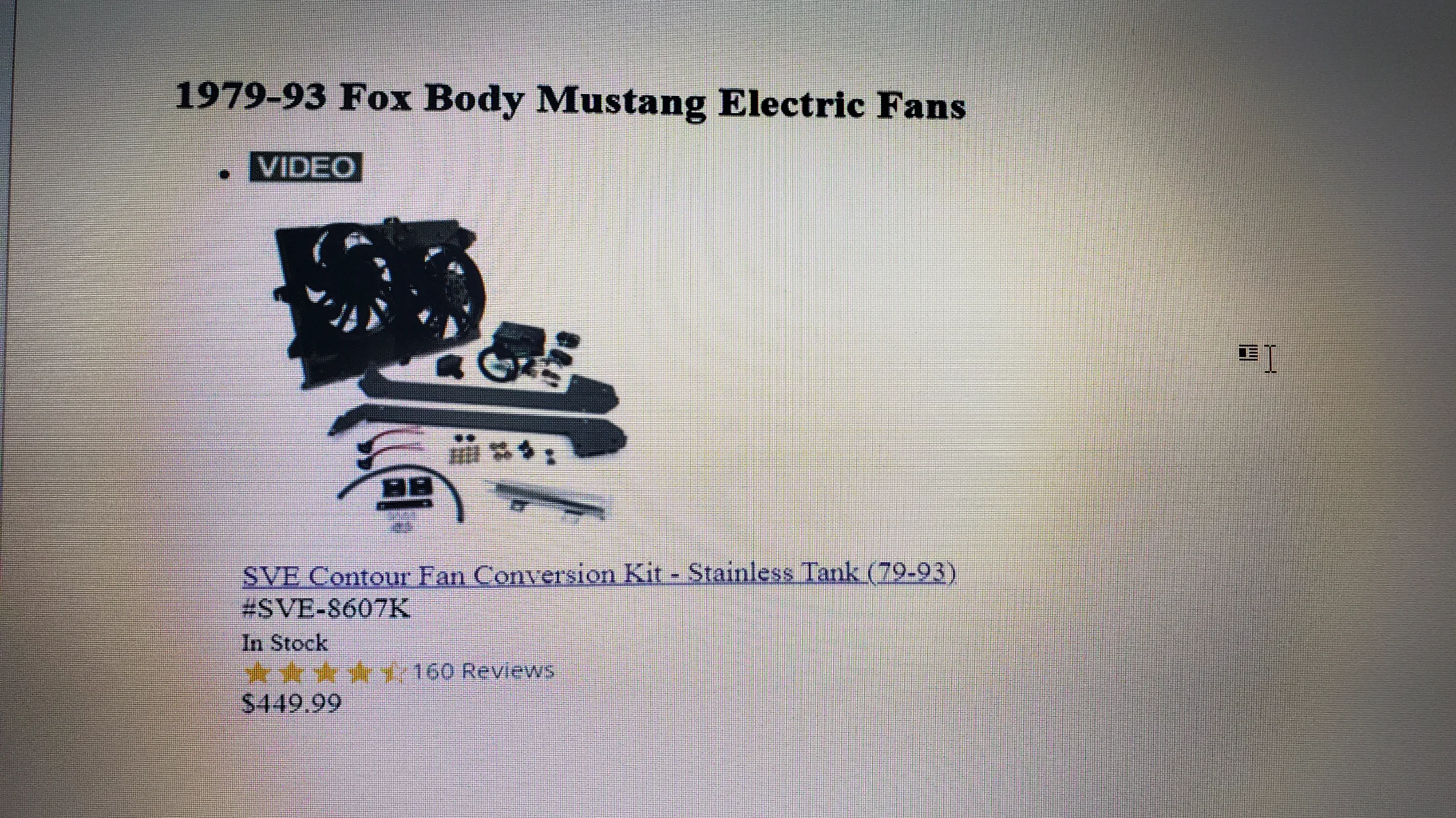

My next mod/purchase is to install twin electric fans. I'm asking for input on what you guys suggest. The easy route is LMR "Contour" fans, even though they're Contour style. I saw that Rock Auto has something similar. I'm just looking to finally complete the cooling piece and not have to worry about overheating again if I get stuck driving home late from a Summer Cars and Coffee event.
Haven't posted in a while as I've been in Hawaii on military status.
My car is on my mind though and I continue to do upgrades from time to time when I make it home on a long weekend.
Contour fans should work fine

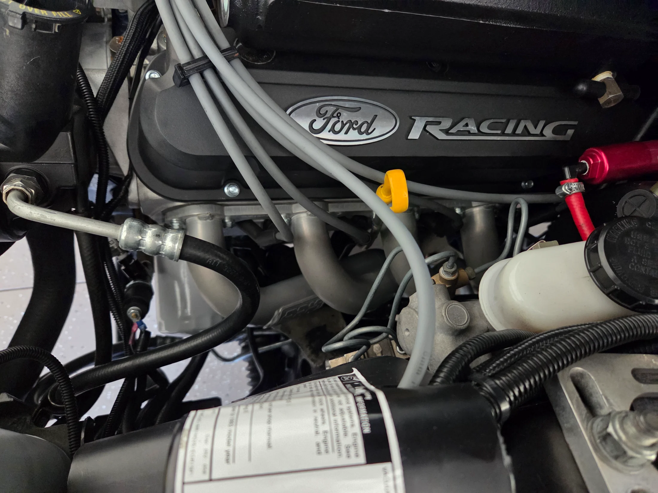

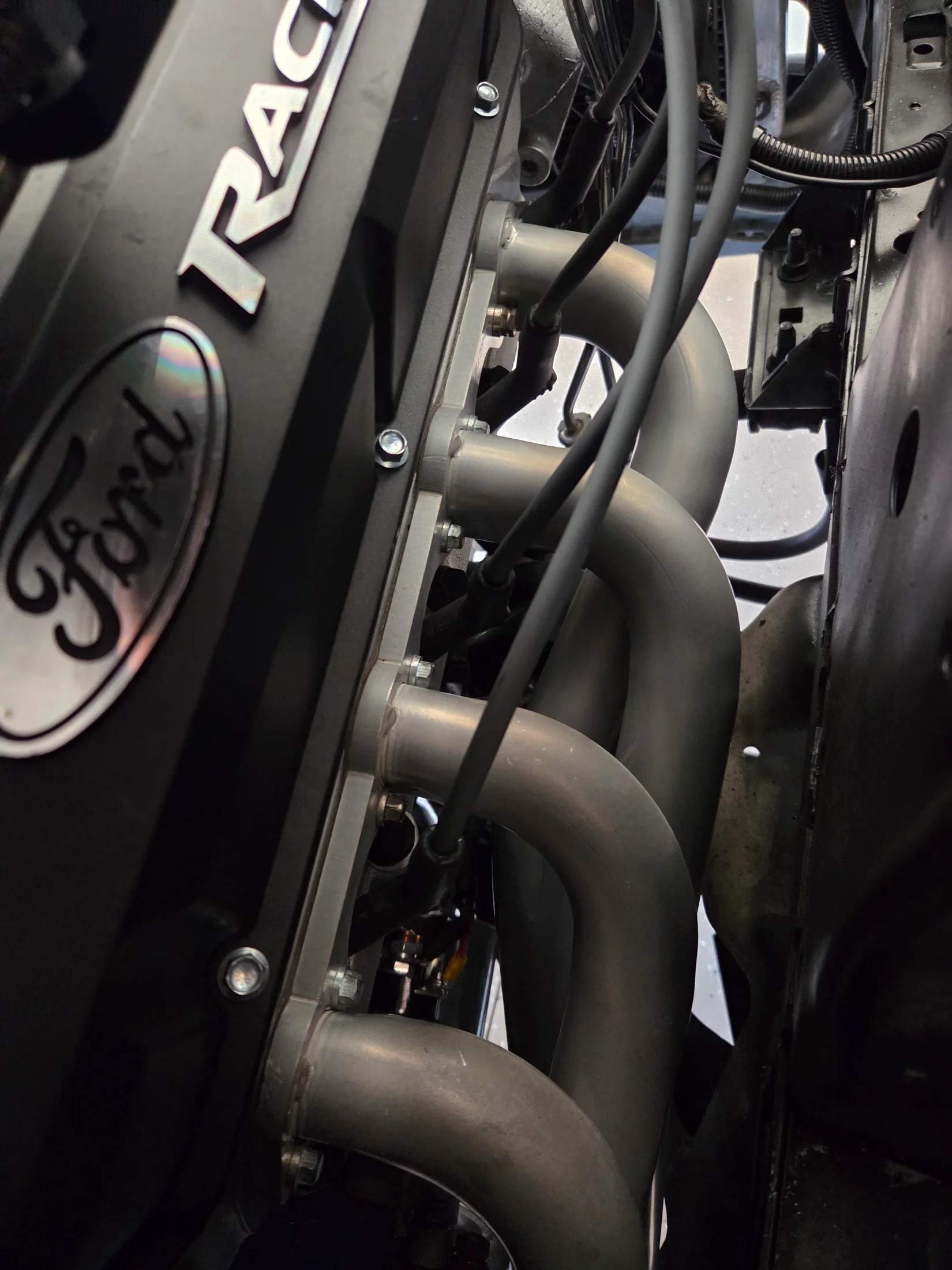

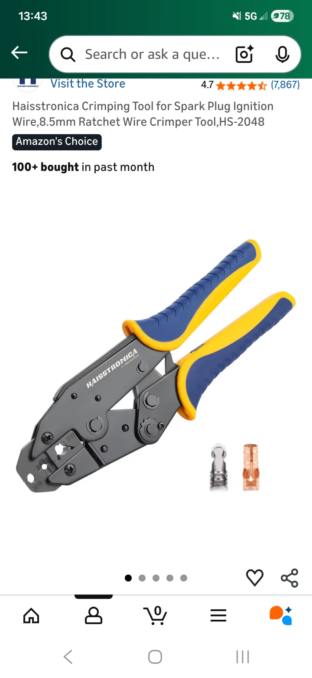

Such a small item, but it bothers me how long spark plug wires come from the manufacturers. They're practically lying against the side of my engine bay. So I researched the process and spent $22 to purchase a spark plug wire crimper. Easy project, learned a new skill and cleaned up the engine bay a bit.
