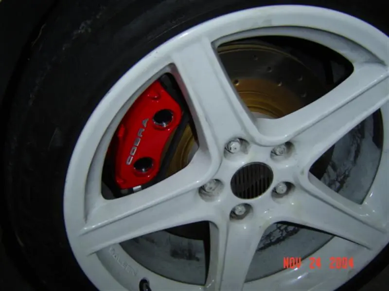

well my project/dilemma is over. Thanks for all that helped. You guys are great. Turns out that in 2003, Ford changed the banjo bolts to a different threading, so since my car is 2000, I couldn't reuse my bolts, and the new ones sent in the package were also the wrong ones. So after doing research, it turns out I needed 10mm x 1.5" banjo bolts that are not fine thread. The 2000 came with the fine thread bolts. These will work with any of the other brake upgrades such as Bullitt or the black Cobra brakes. But it just so happens I got the red ones, and they don't work only on the red ones. I hope everyone can use this thread as a reference when doing this upgrade, so you don't run into the same problem as me...
