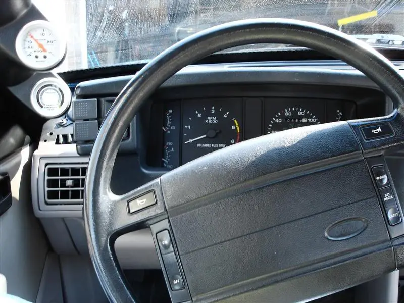

If all you want is the 140, its not that much work, Its the white faces that are a pain. I kinda wanted white faces too, but that was going to be alot of work. I love having the 140, espically with the turbo, here is what mine looks like, its a bad picture to show the speedo, but its the 4cyl tach, and the v8 speedo.
