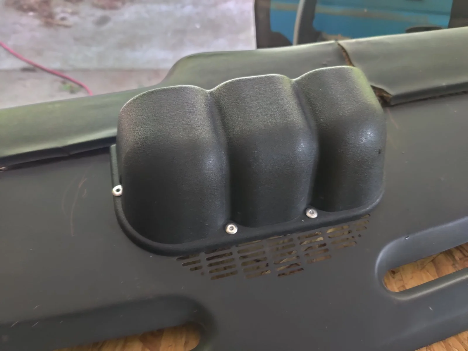

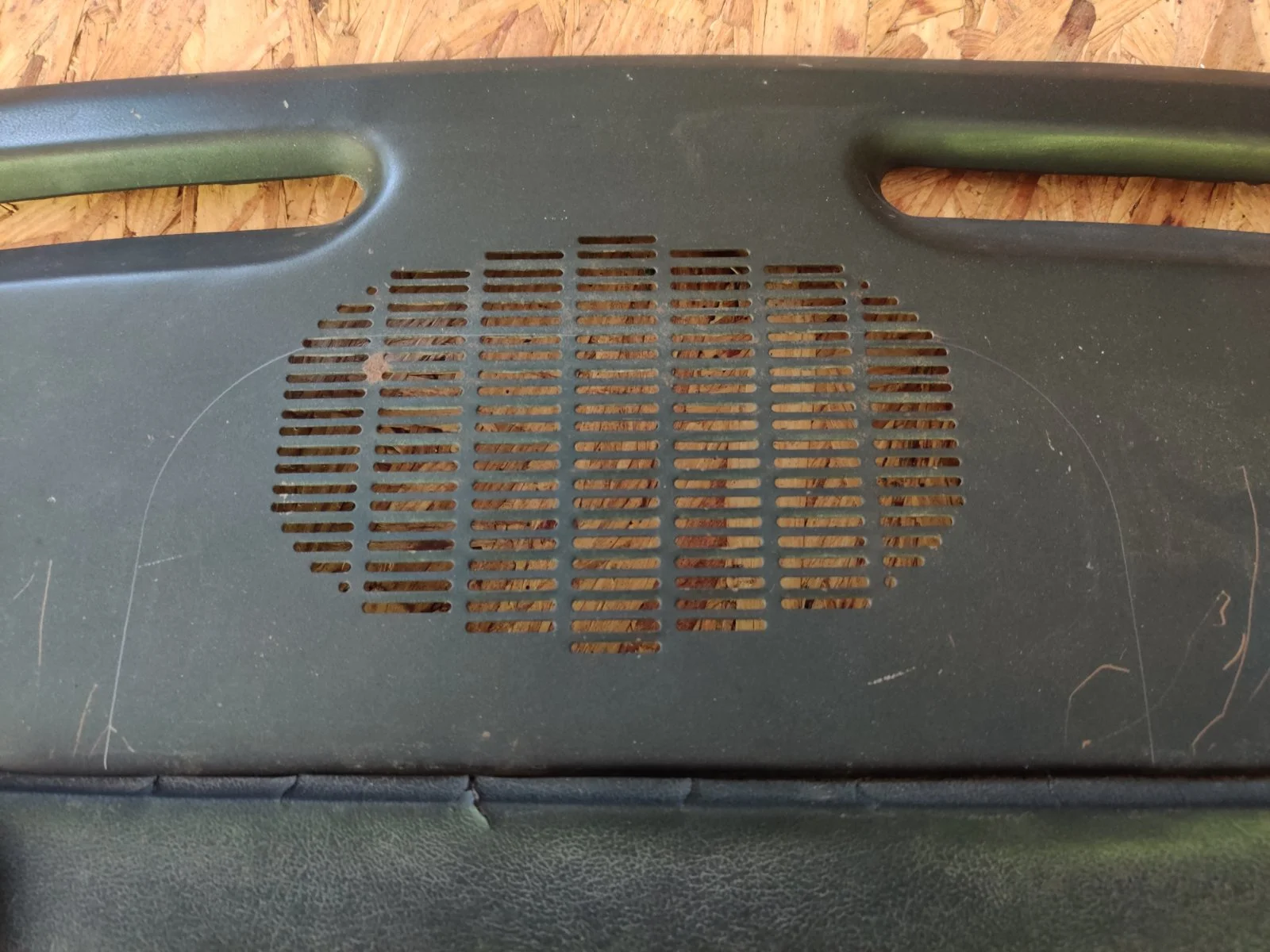

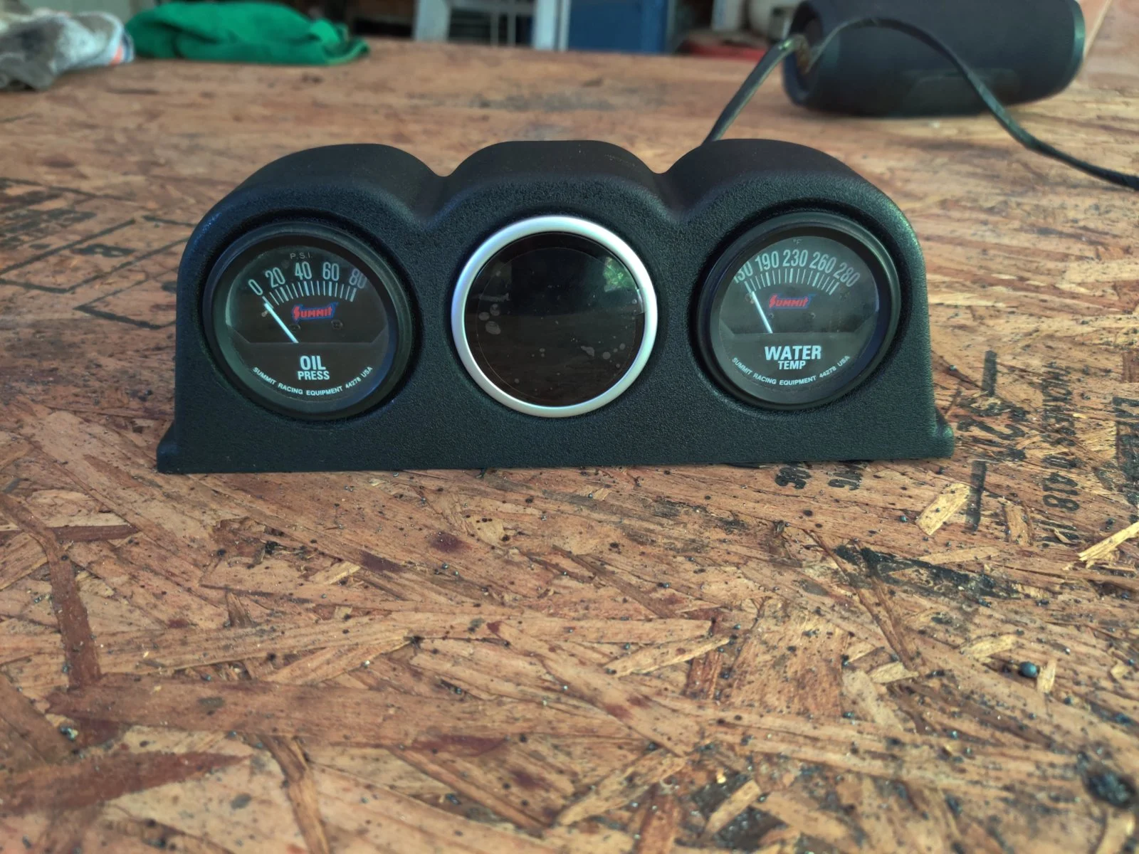

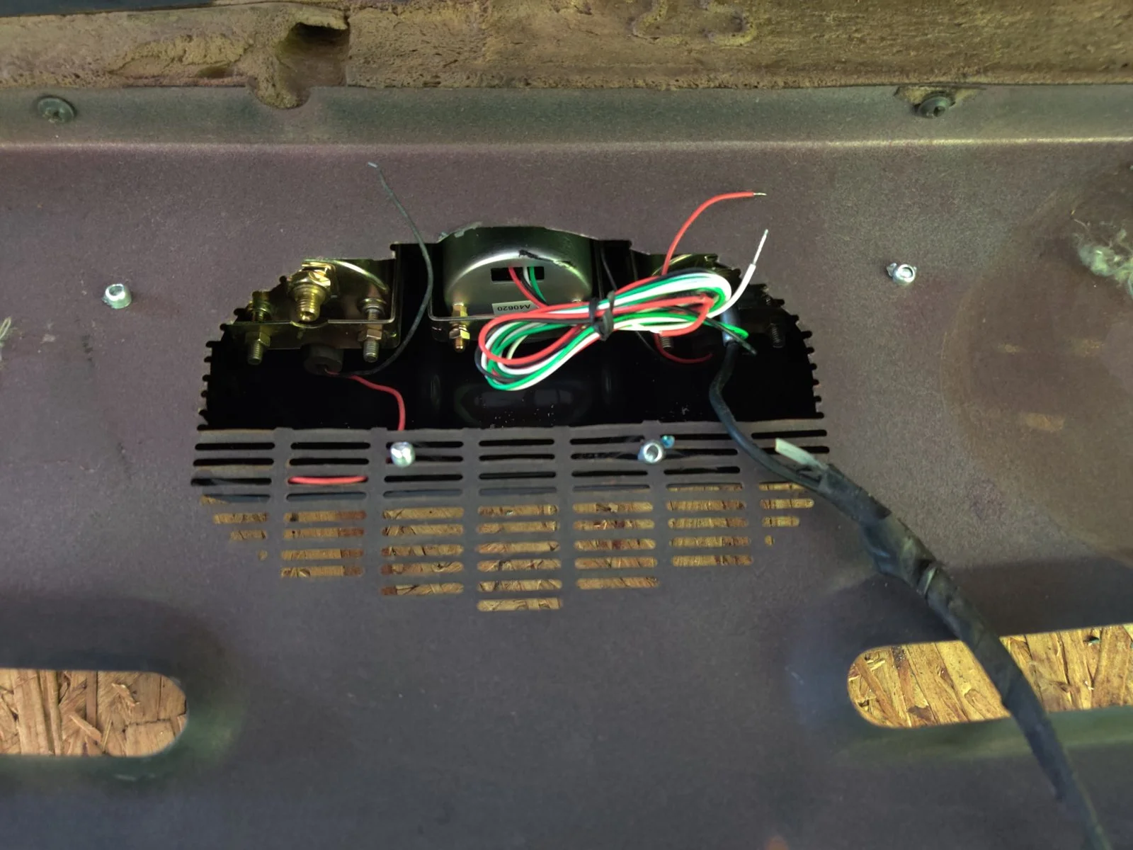

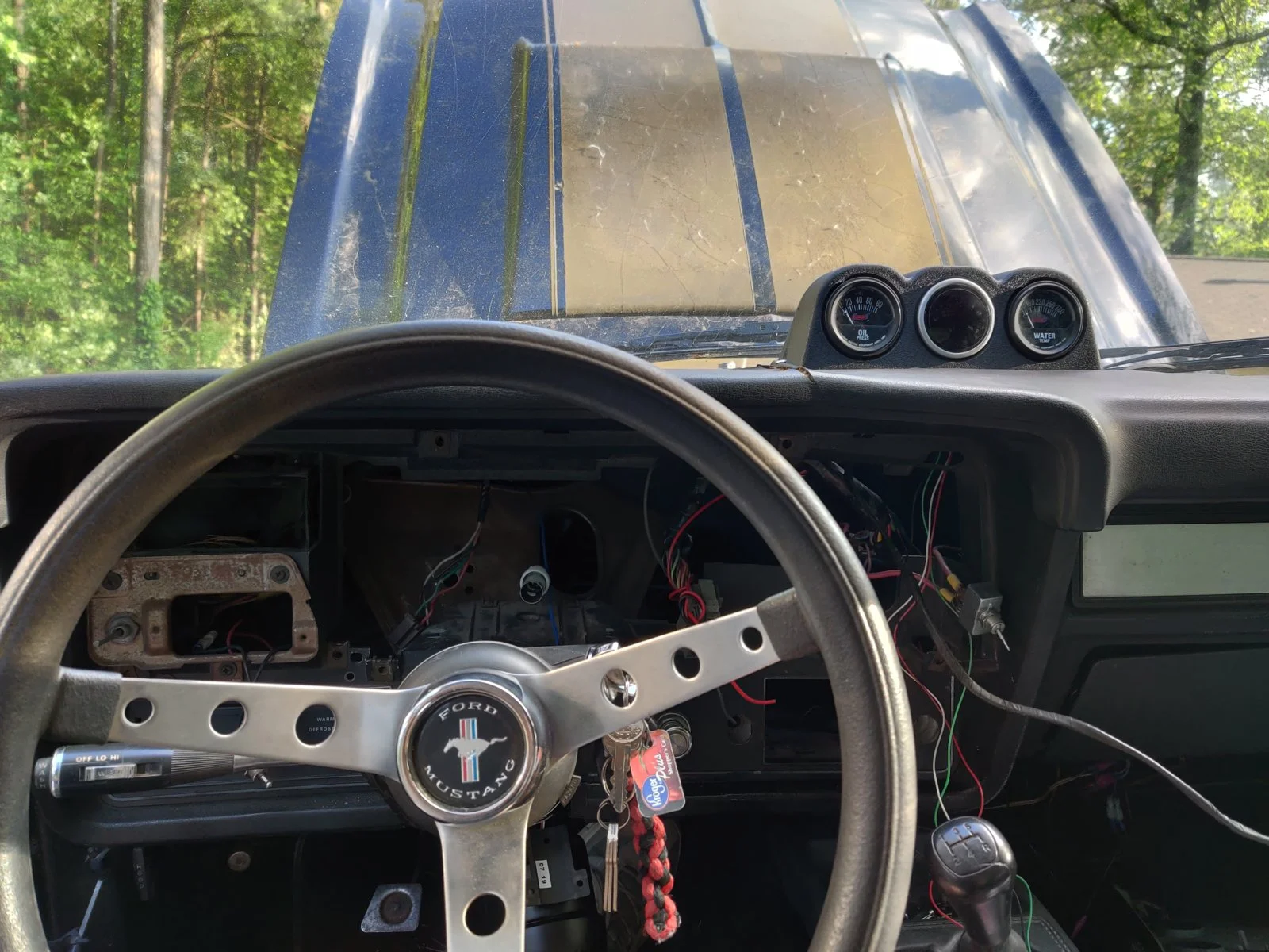

I got the gauges mounted in the pod and on the dash. Tomorrow will be connecting everything and finish wiring it up. I might even get a test drive in to note the initial A/F numbers. So tune in tomorrow, same bat time, same bat channel!!

First start up: confirmed idle mixture screws were 1-1/2 turns. Initial A/F reading ranged from 12.5-13.3. Cold idle vacuum was 8-9. Took the idle screws all the way in and it died. If memory serves, that confirms the power valve is good. Took the idle screws back to 1-1/2 turns out. Upon restart, A/F gauge reads 11.7-12.0, vacuum is up around 11.
Continued to let the car idle and adjusted the idle mixture 1/4 turn at a time. Final results were about 3/4 turn in, idle is now at around 800, A/F gauge reads 13.8-14.3. a touch rich, but a lot closer to stoichiometric.
Adjusted idle speed to around 7-750 RPM. Vacuum now reads around 15. I believe I need a LARGER power valve, not a 4.5 as I was thinking.... I think I still have the 6.5 around somewhere, if not I'll have to order ANOTHER power valve.
BUT - I then noticed that my fan hasn't kicked on. I have one of the thermometer type radiator caps and saw that the radiator temperature was reaching 240+ whereas the temperature gauge in the car was still reading 190ish. So I shut everything down and will have to go through this all again. So far though, I REALLY like the gauge!! If you haven't gotten one, I HIGHLY suggest it! I'll update this as I continue tuning later.
