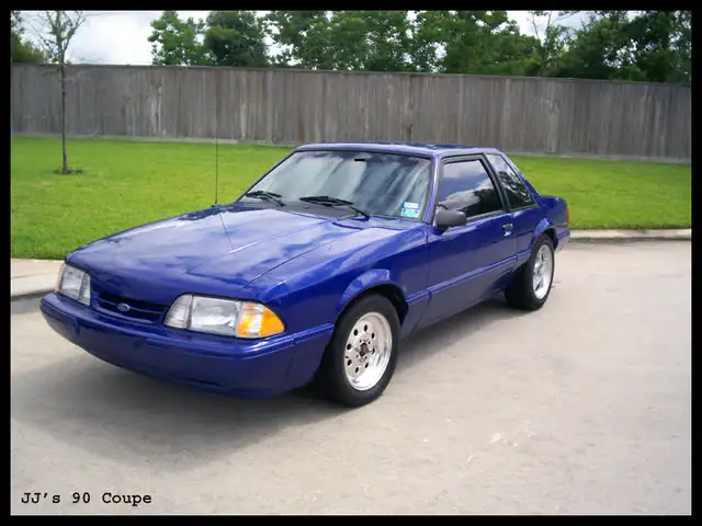

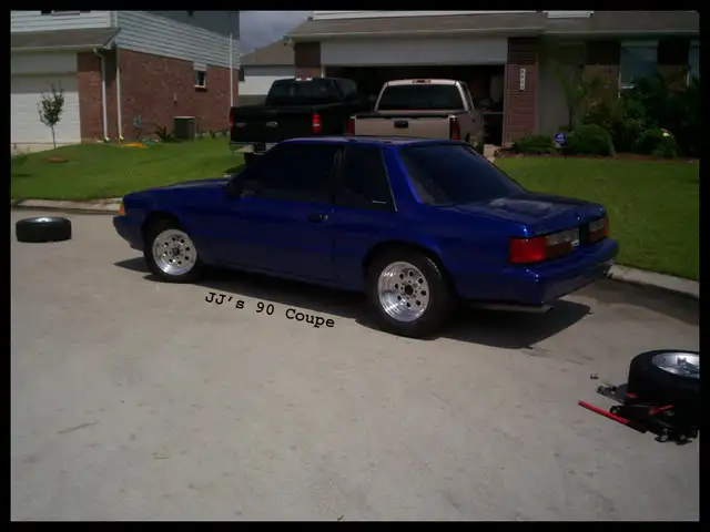

I had 245 * 60 * 15 out back and then a 180 * 60 * 15 up front mounted on 15 * 8's out back and 15*5's up front!
I have more photos if you want any. if i ever get to buy new tires it will probly be 275 * 50s out back and another set of 180 * 60 up front It may be 185s up front but im not sure right now! i know its around that! Hope those work!

That's my car w/ 10" and 3.5". No tire sticking out the side, and no rubbing.
I used to get some rubbing when there was a side-to-side movement of the axle, and the body was dipping down, but a little hammering (not even a 1/8") and now no rubbing anytime. you could see a defient line where the rubbing was, looked like where the wheel housing was meeting the trunk pan.
Are you sure those are 10's, not saying they aren't but they look like 8's in the pic.
