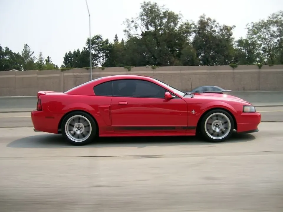

You can put nitto 315s on the back of a 9 inch wheel no problem. It will buldge and some people may complain about that, but whatever. Here is 17x9s with nitto 315s.
