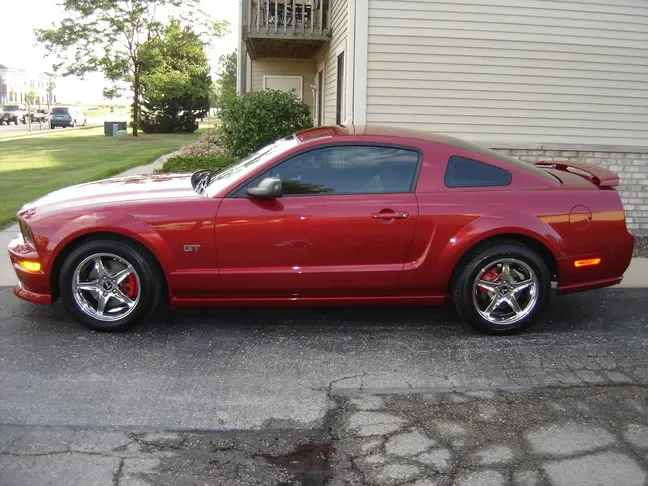

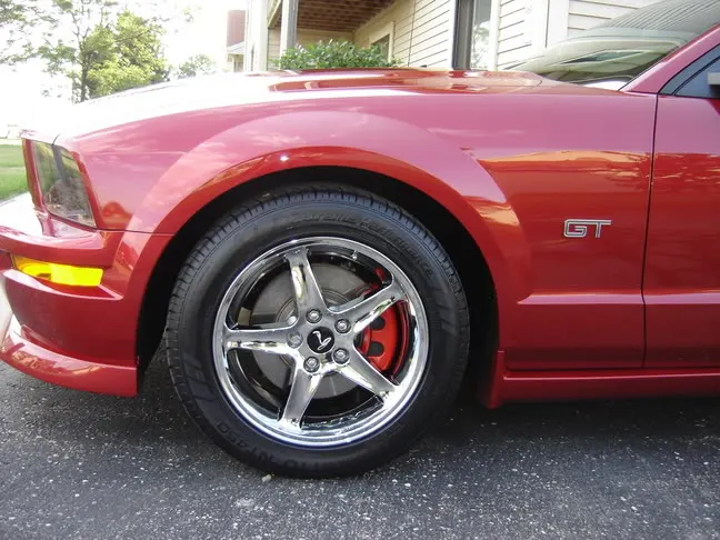

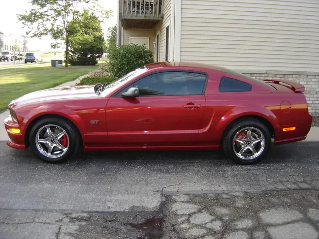

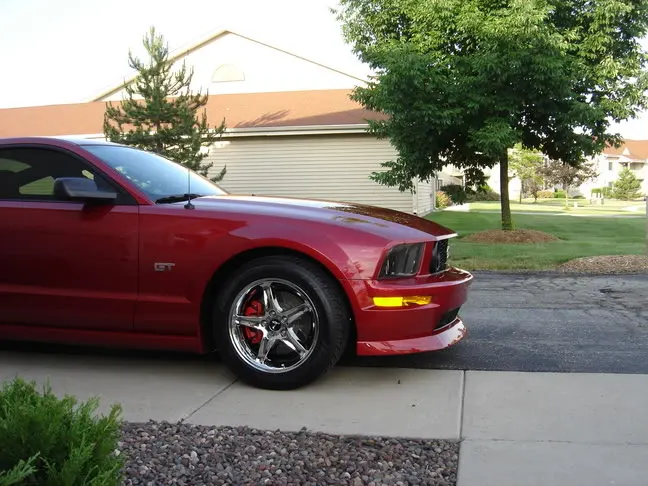

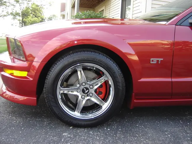

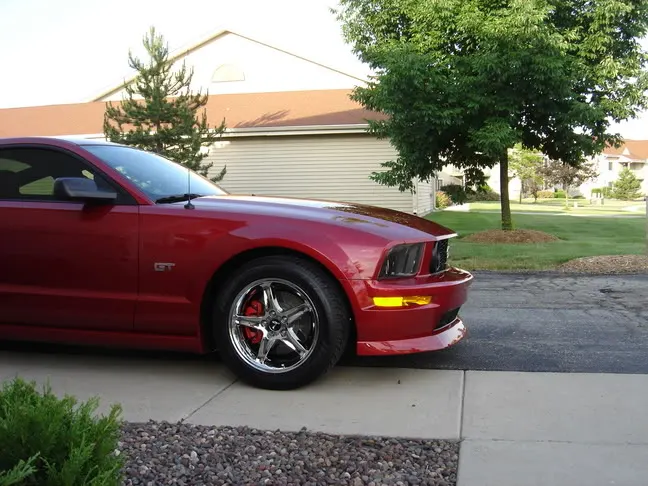

Hers some pics of my '95 Cobra "R" style wheels with 45mm offset 17x9 made for the '05.....
Nitto 450 extreme's 255/50 all around total diameter is nearly exact to stock setup

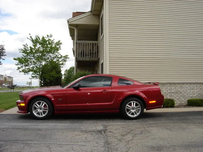

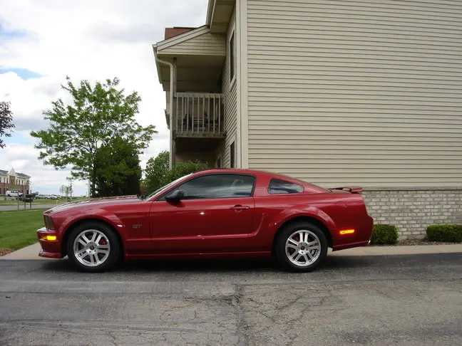

Here's a before shot
kd05gt said:
JM2005:
Any reason you didn't go with 275/50 Nitto's all around? I'm still trying to find out if they will fit...
Yours looks great...
Thanx kd05gt
Just a personal preference, but the 275/50's will easily fit the 17x9's with no problem. They will fit fine on the car as well as long as you keep the factory offset(45mm). If you go with the 275/50's they'll be slightly taller than than stock but it shouldn't be enough to cause much error in the Speedometer. If you go 275/45 they'll be slightly shorter than stock in total Diameter.
