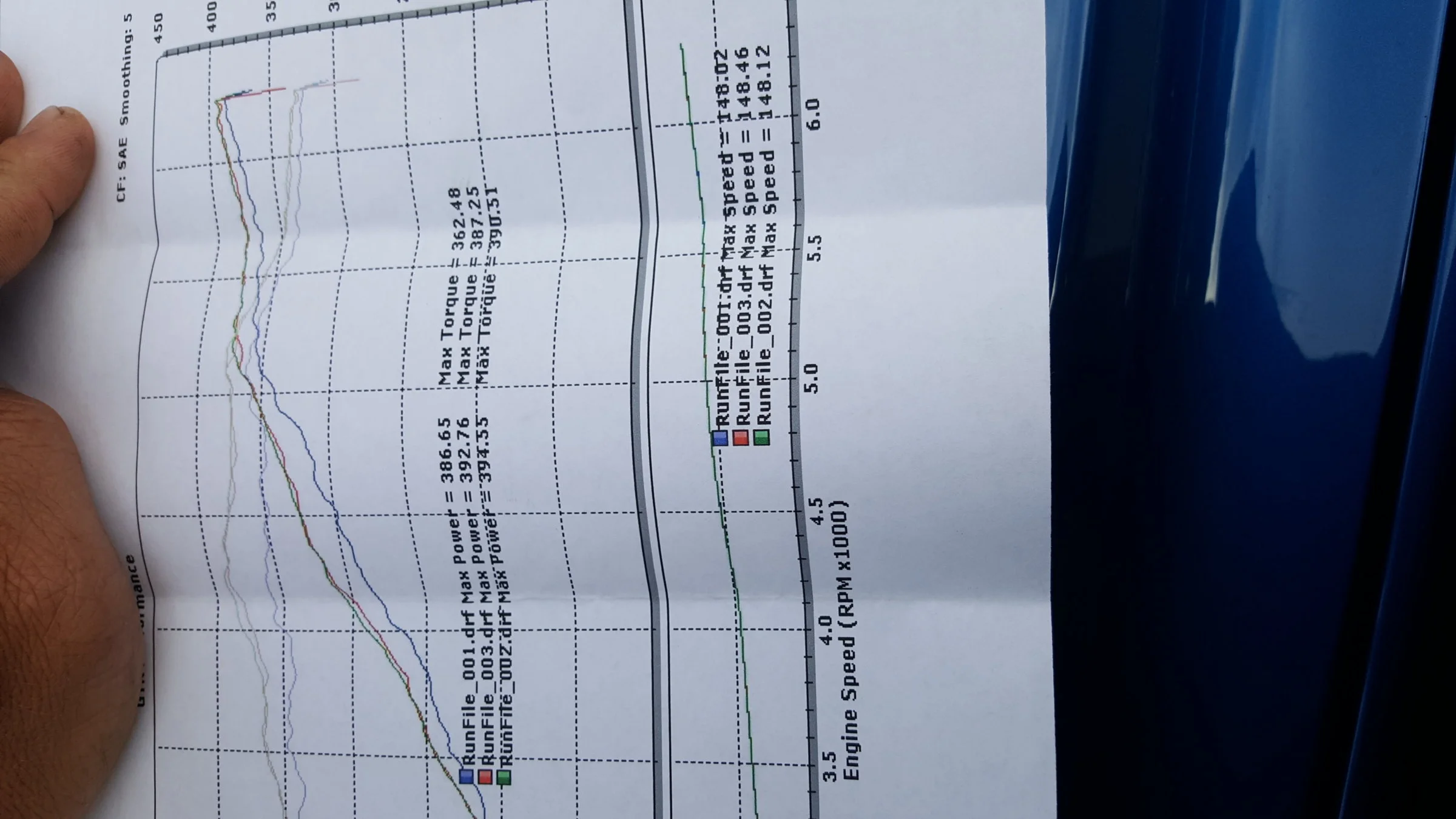

Dropped my gt off at GTR high performance in ranch Cucamonga ca for some upgrades.. got sct tuner, CAI, magna flow cat back.. ended up getting 394rwhp on the dyno.. what would be the best bolt on upgrade next?
Keep in mind I live in california with smog.. want to stay legal..
