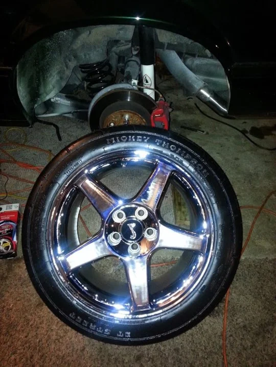

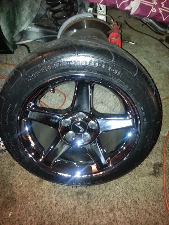

I have a set of 03-04 Chrome Cobra wheels with 255/40/17x9F and 275/40/17x10.5R. I have a set of Sumi HTRIII tires and the rear have little to no rim protection. I just added a pair of 275/40/17 Mickey Thompson ET Street Radials and there is NO rim protection at all. In fact, the rim of the wheel protrudes about an 1/8th of an inch. I hate the way it looks but if it hooks I don't care! I'll post pics later

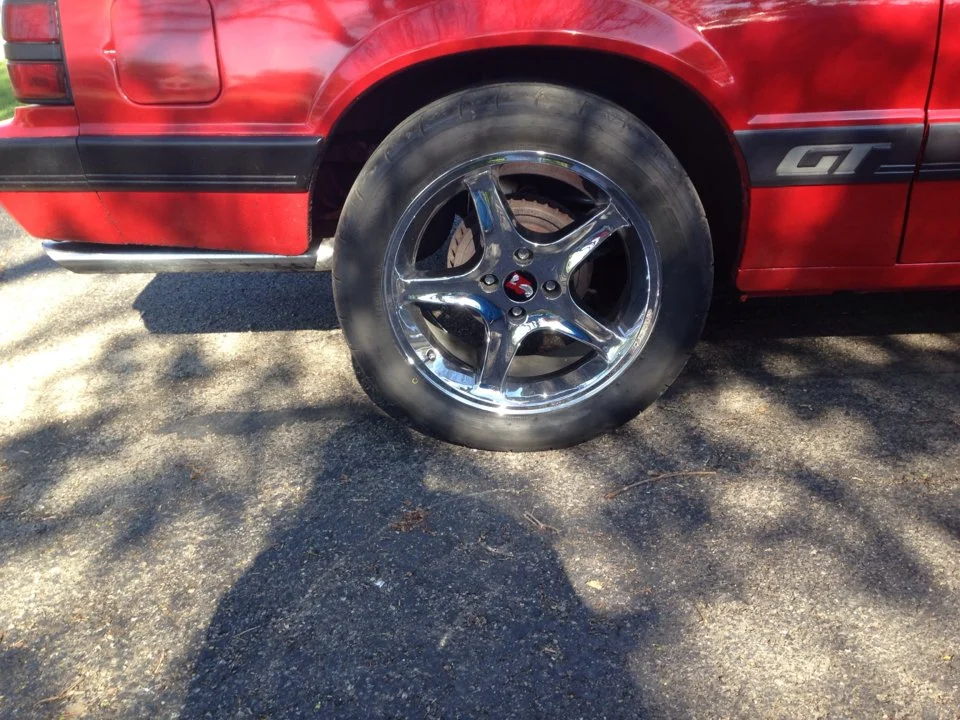

Last weekend I put on my quad shocks just to see if I noticed any difference. I have plenty of clearance with 17x9 cobra R's w/ Nitto 275/40-17s w/ Team Z Motorsports drag springs(basically stock height) not a lot of curb protection though.
