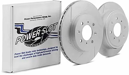

I don't have any pics of the brakes but I can take a few and post em. Any one know the size of the stock front rotors??? I can probably do a quick measurement.
iwashmycar said:
they are like 11 or 11.4ish or something like that
stock:
The rotors on my car are stock size, no doubt in my mind. They are the Power slot OEM replacement rotors. The car also has stainless lines front and rear. For having a 95% OEM brake system the car stops pretty darn good, especially when you take into consideration it's a portly convertible with 18's. :D
