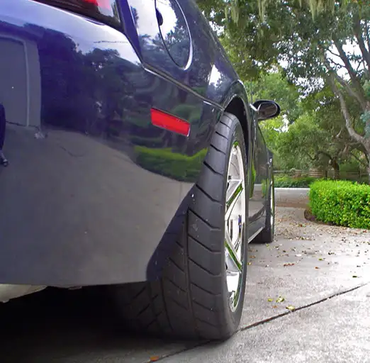

you definately DO NOT need wheel spacers in back for 18x10 saleen replicas...with a 295 tire, they sit flush with the fender :nice: they sit out far enough to the point where i had to roll my fenders because they gashed my tires.
