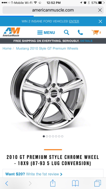

Yay? Or nay?
Doesn't somebody else have these?

@Boosted92LX has them.

Beat me to it
They look awesome on his car! Go for it!

I'm a deep dish guy, so Ney for me. But ey, thats just my preference.

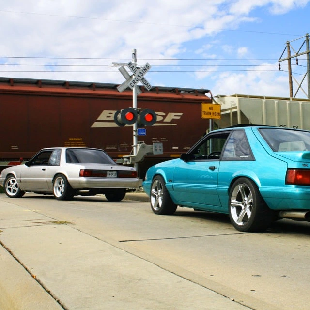

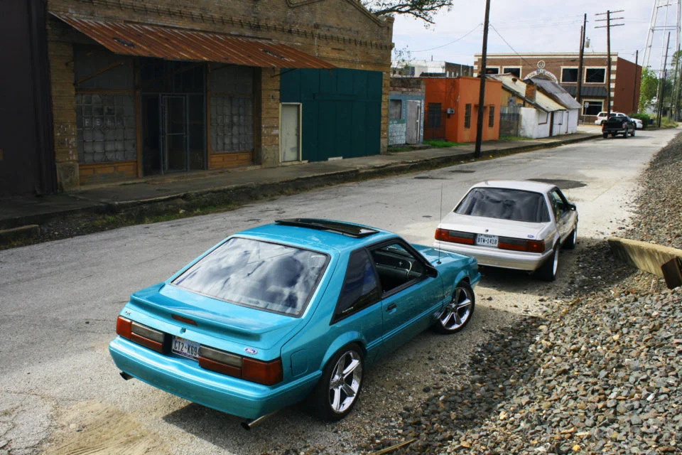

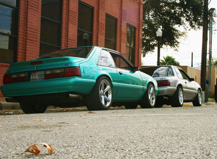

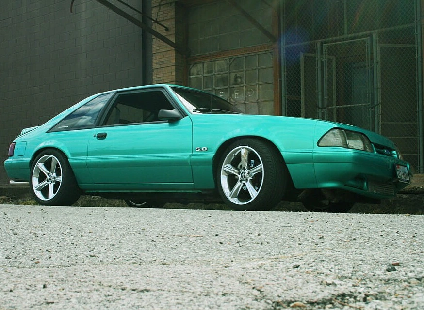

LMR used this image for advertising.
All photos courtesy of @hoopty5.0 studios.

What spring,spindle,tire,etc are you running with those? I really like those on your car.

Thanks man!
Uuuuuuummmmm.... 94 gt spindles. Eibach sportline springs/koni str.t shock. The fronts are 265/35-18 nankang somethings...rears are 275/35-18. Nitto NT01.

Wow, how did you fit such fat rims & tires on there. Doesn't it rub ?

The only time it rubs is in the front in a really sharp fast right hand corner... And it's not terrible. I plan to eventually pull that wheel to see where it's touching and give it the old hammer adjustment.
