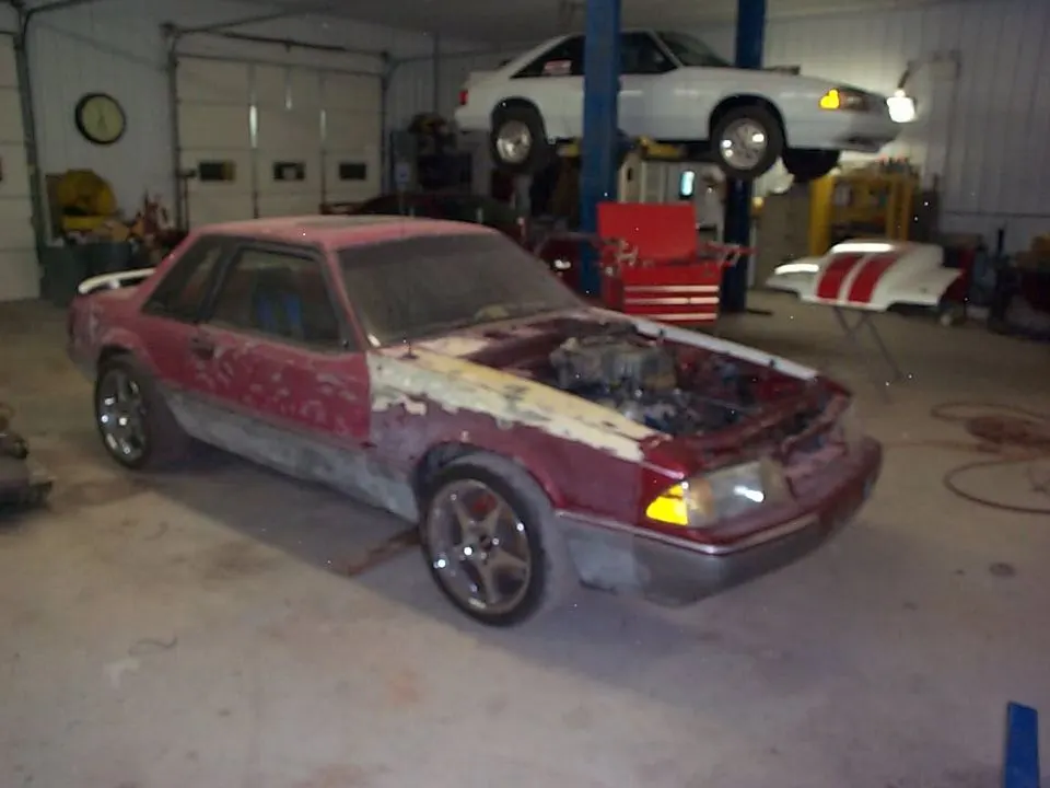

Just to give you and idea, I put my Y2K 18X9.5 Cobra R's off my 00GT on my 91LX with SN-95 spindles on the front and SN-95 axles with disk brakes on the rear with 275/35/18. The rear wheels would stick out past the fenders a bit along with the front.
