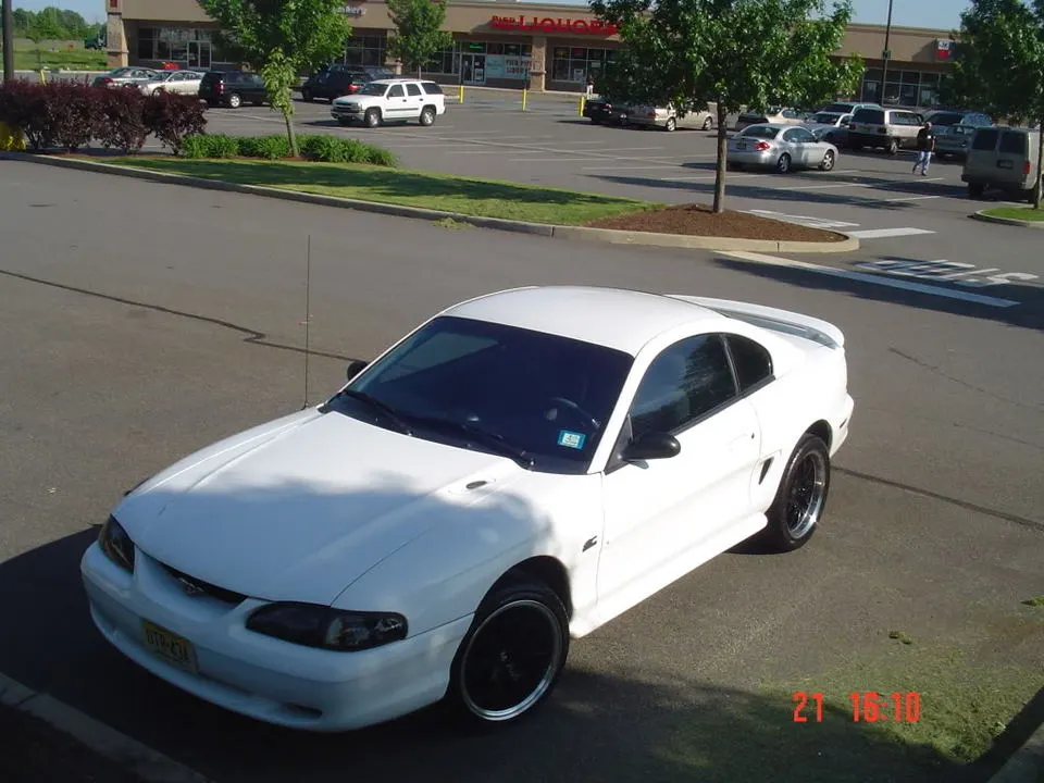

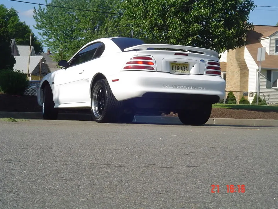

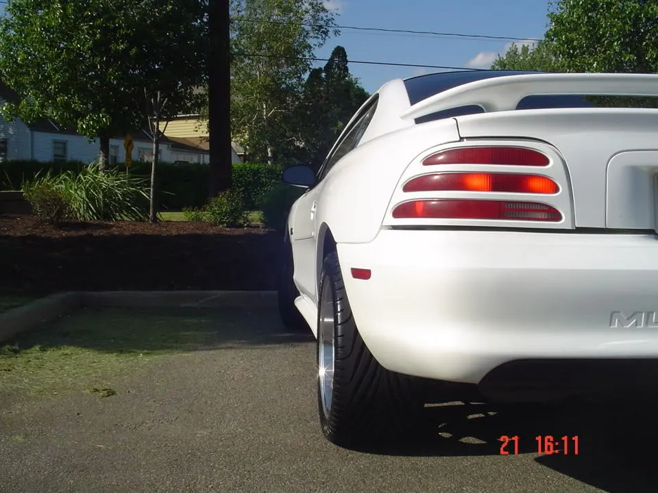

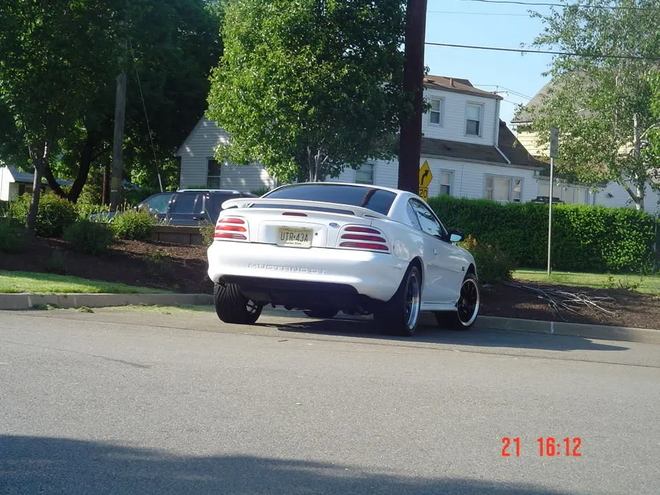

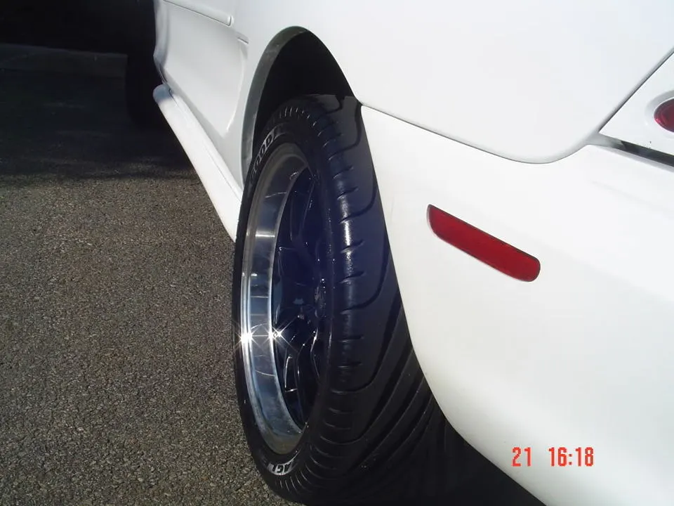

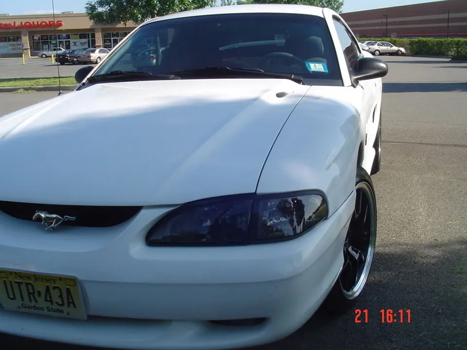

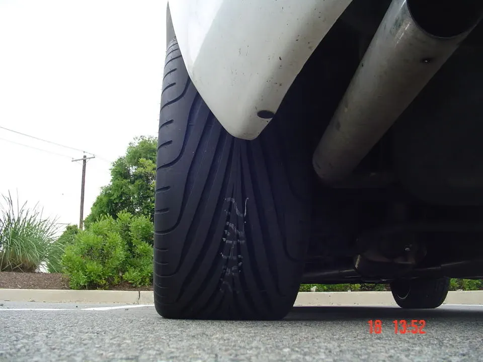

UPDATE
Finally I stop being lazy and took some pics of the car , it's not lowered yet , had to take out tail pipes cause bassanis were to close.
thanks again for help guys.
