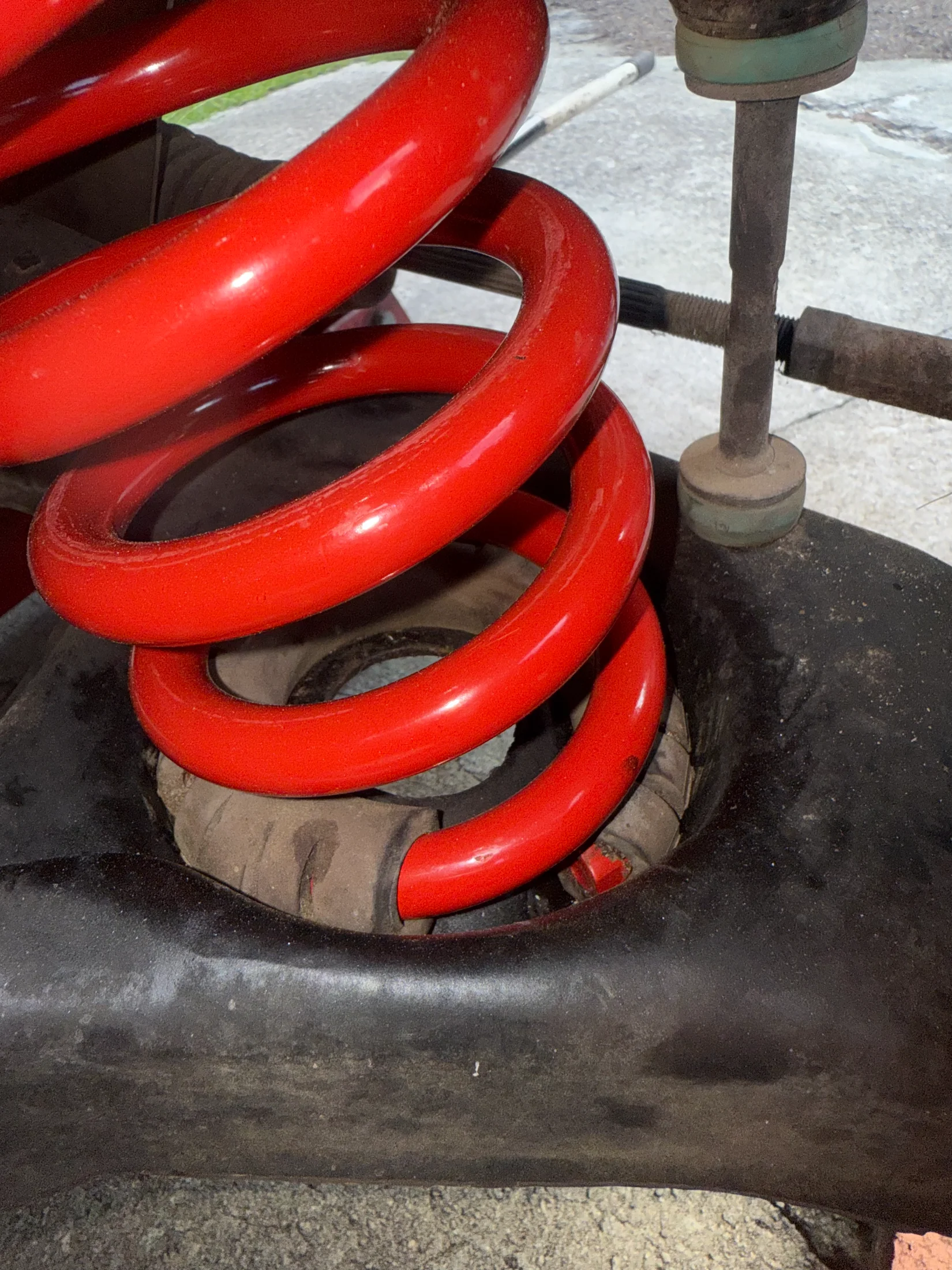

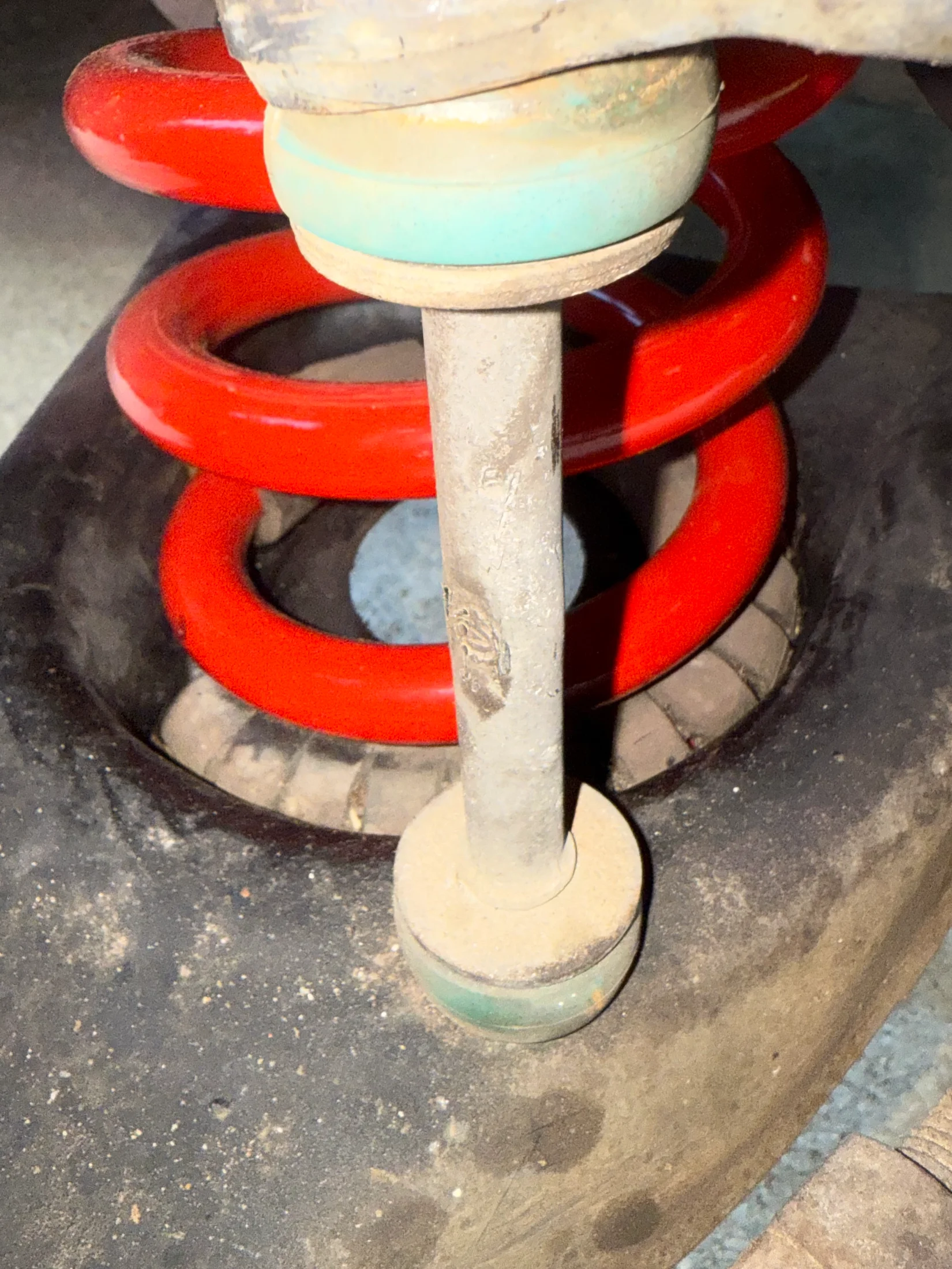

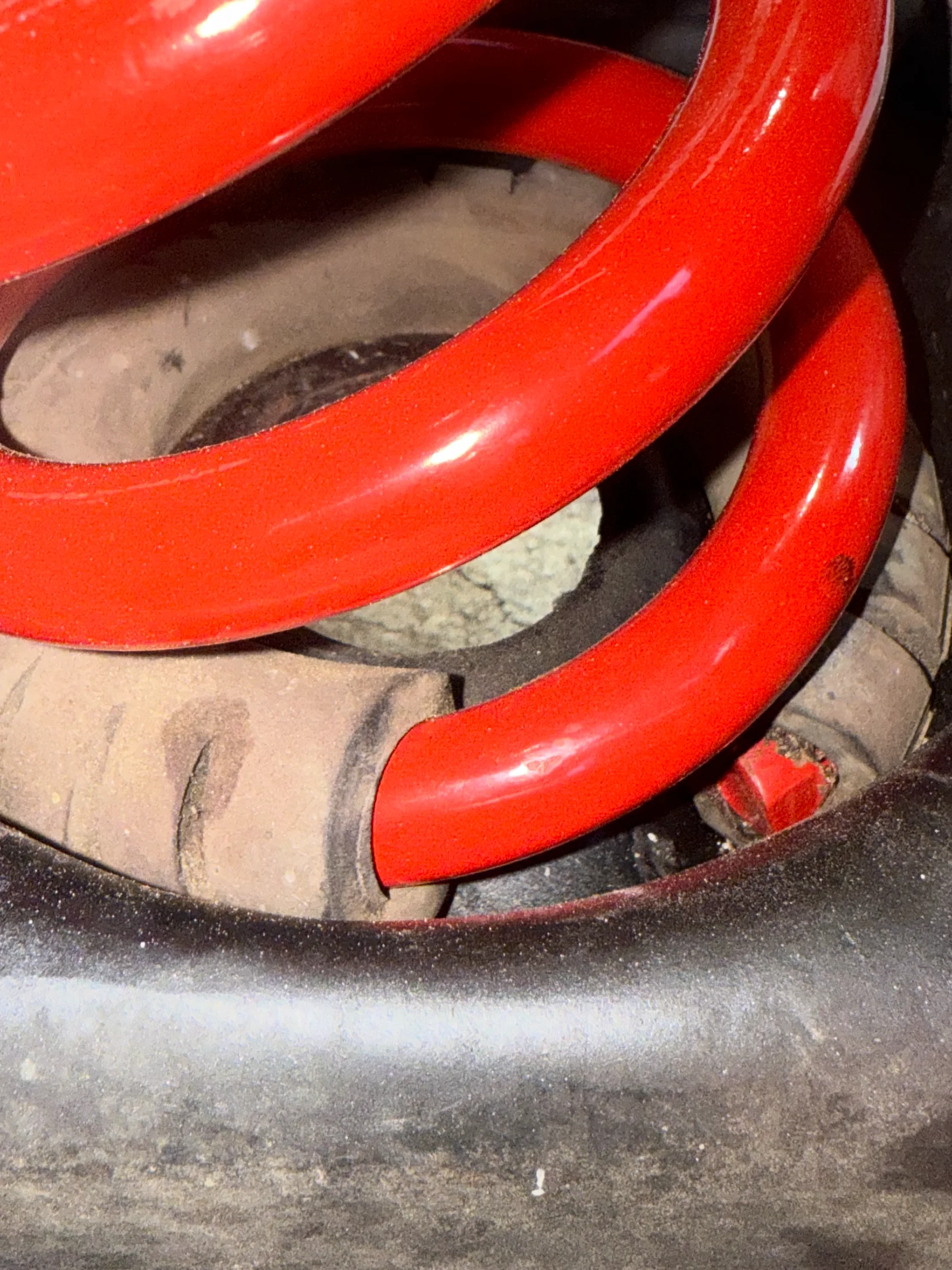

He measured each side from ground to wheel well. he checked the springs too I attached the pics below of the springs sitting in there. Do you have to have to the rubber around the springs? would that maybe be the issue maybe? I know its hard to tell without seeing the car in person. hope this helps thank you! @squeak93
Driver side front - 26" 3/4
Driver side rear - 26"
Passenger front - 27" 1/2
Passenger rear - 26 1/2

Hard to say - but springs could but OVER clocked and sitting on the raised portion of the control arm. There is a hole in the bottom (some have 2 holes iirc) for drainage. Thats usually my stopping point for end of spring. Also - I do NOT run isolators so I can get car lower - creaks a bit more but no issues otherwise. Opinions vary on that though.
Have you driven the car since lowering or has it been stationary the whole time? Your pass front looks off the rest look about in line with what I'd expect. For reference, Sportline's in front (03 mach1) and no isolators my car sites right at 26 ground to fender well arch. level both sides and rear is all adjustable so it's not a good gauge.
it was moved from the driveway and back in the garage. So the isolators can be taken off with no issues? he is going to break everything back down this afternoon and see what is different the springs are sitting over both holes. when looking at it from the back/front it looks like it sits up alittle compared to the driver side. this is what I want it to look like below. I found someone's car I want mine to sit like this. @squeak93

Update. he took out the spring isolators and the measurements didnt change much. the springs sit in the bottom of the arm in the little grove area its not over lapping at all. i dont know what is wrong. it looks so weird the front sits up more than the rear. thanks @gkomo @squeak93
driver front 26 1/2
driver rear 26"
passenger front 27"
passenger rear 26 1/4
Could drive it around for a while and see if the suspension settles? Maybe the passenger side springs just need to settle to what the drivers side is. It looks like your measurements got a little more close removing the isolators, but one would think they would remain the same ratio between the sides.
