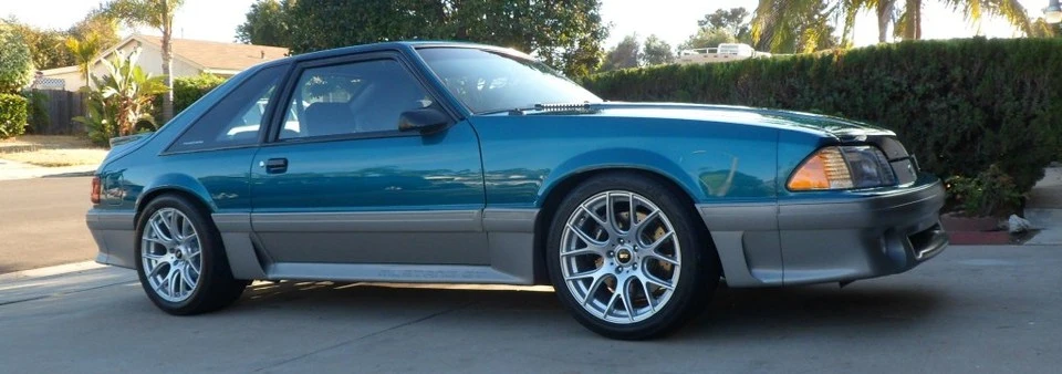

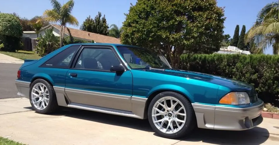

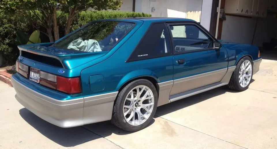

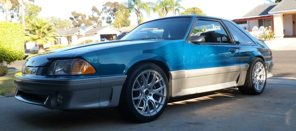

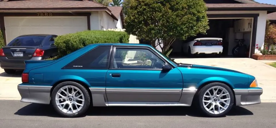

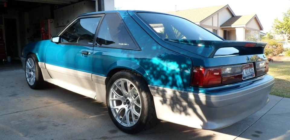

I like 1992Hatch's car with 18"s. Why all the hatred?
I'm going to hijack his pictures he just posted over in his paint thread. Everyday I have to talk him out of painting them because he keeps asking me o_O
^ true story. I mull over painting the insets Black, or White, or Gold on like a daily basis.

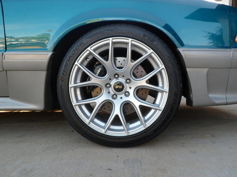

PS. I'm happy I went with 18's. I almost bought a set of 17" terminator rims before these, and i'm glad I bought these. With the Steeda sport springs, I'm happy with the ride and the stance.
18x9 255 35 up front
18x10 185 35 out back.

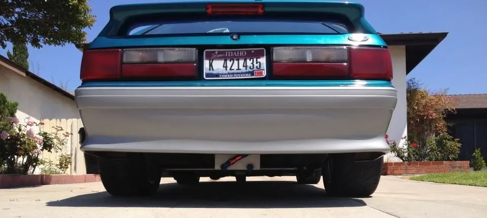

One thing to consider when purchasing rear wheels this wide is the clearance.
The rear moves under side load and from experience using rims and tires more narrow, it will likely take a panhard bar to keep from rubbing around turns.
I'm pretty sure groverdill has the entire MM catalog, so it's probably not an issue for him.
I run an 8.5 with a 275 drag radial and i had to buy panhard bar. Which sounds so simple, but it isn't, because most lx exhaust kits don't fit properly with one. The kit's that do fit are another $450.
My advice, if your pockets aren't deep, just run the 9's in the rear with a 265 tire.

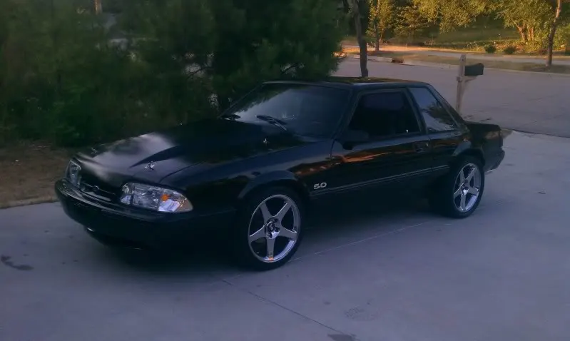

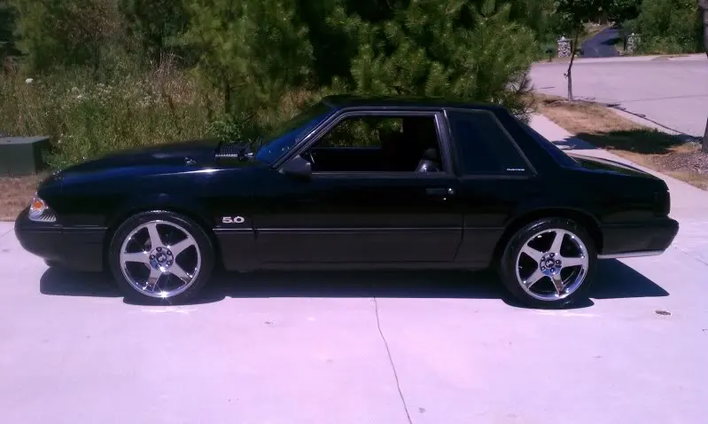

fenders are not rolled, and its a sn95 rear end svo front brakes. and my center caps fit the front also, tires only rub on a steep turn in a driveway or something, i rarely ever hear it, never on the road, now the fronts rub, i am going to run 245/35 up front that will fix that
The center cap won't work.
I don't see why not. The 94-04 spindles have the small dust cover cap. Those spindles allowed ALL wheel center caps to fit unlike the Mark VII conversion kits. Those rotors made many factory 17x8 wheels not work. Are you sure that's the reason? With a +24mm offset I would have thought they said no cause they'll be sitting out at the fender a lot. 18x9 FR500 wheels have a +22mm offset which is only 2mm difference. This means the Drift wheels will have .10 more backspacing and sit into the fender well more. They might be worried about rubbing when turning...but with 94-95 or 96-04 spindles, you're pushing the wheel outward anyways. I think they're wrong on their info.

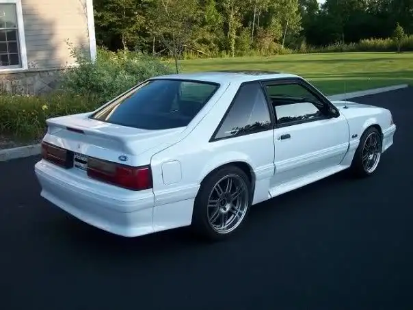

Always liked your white GT Kabuki. Reminds me of when I was 18 back in 2001 and had a mint Florida car. A White 1992 GT....black interior...5spd...all stock minus exhaust. Man that car was sweet!
Reactions: 1990Coupe
