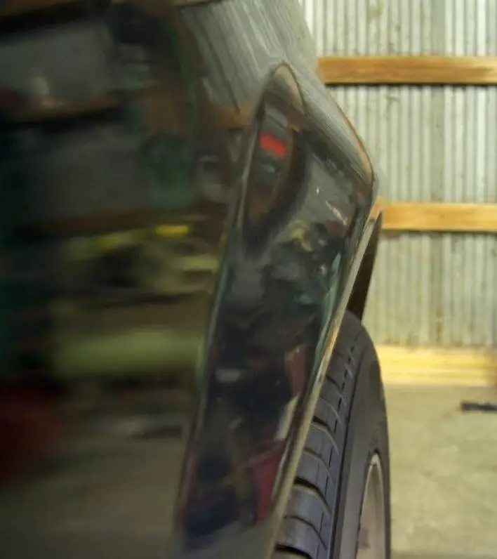

Aren't you running 17x9 Ford (not knock-off brand) Cobra R's on your vert with the M2300 kit??
Do you have any pictures you can post with a side shot so I can see how tucked/untucked the wheels are in reference to the fender lips?? This would give me a good enough visual aid to see whether the extra .03" will matter.

True, to an extent ... the front calipers are the same PBR 2 piston setup as the Cobras. Yes, the rotors are different (cross-dilled, slotted, zinc platted, 2 piece - if someone chooses those options) but so are the rear pieces. The rear PBR caliper is much bigger than the piece offered in the Cobra kit. Lastly, the Baer kit uses Dutchman axles that pretty much maintain the stock rear track width. The M2300K kit does not, this was something that really affected my decision for the wheels I was running. Both kits are nice but both have their differences. Just do the research to make an informed decision.
Does this help?
